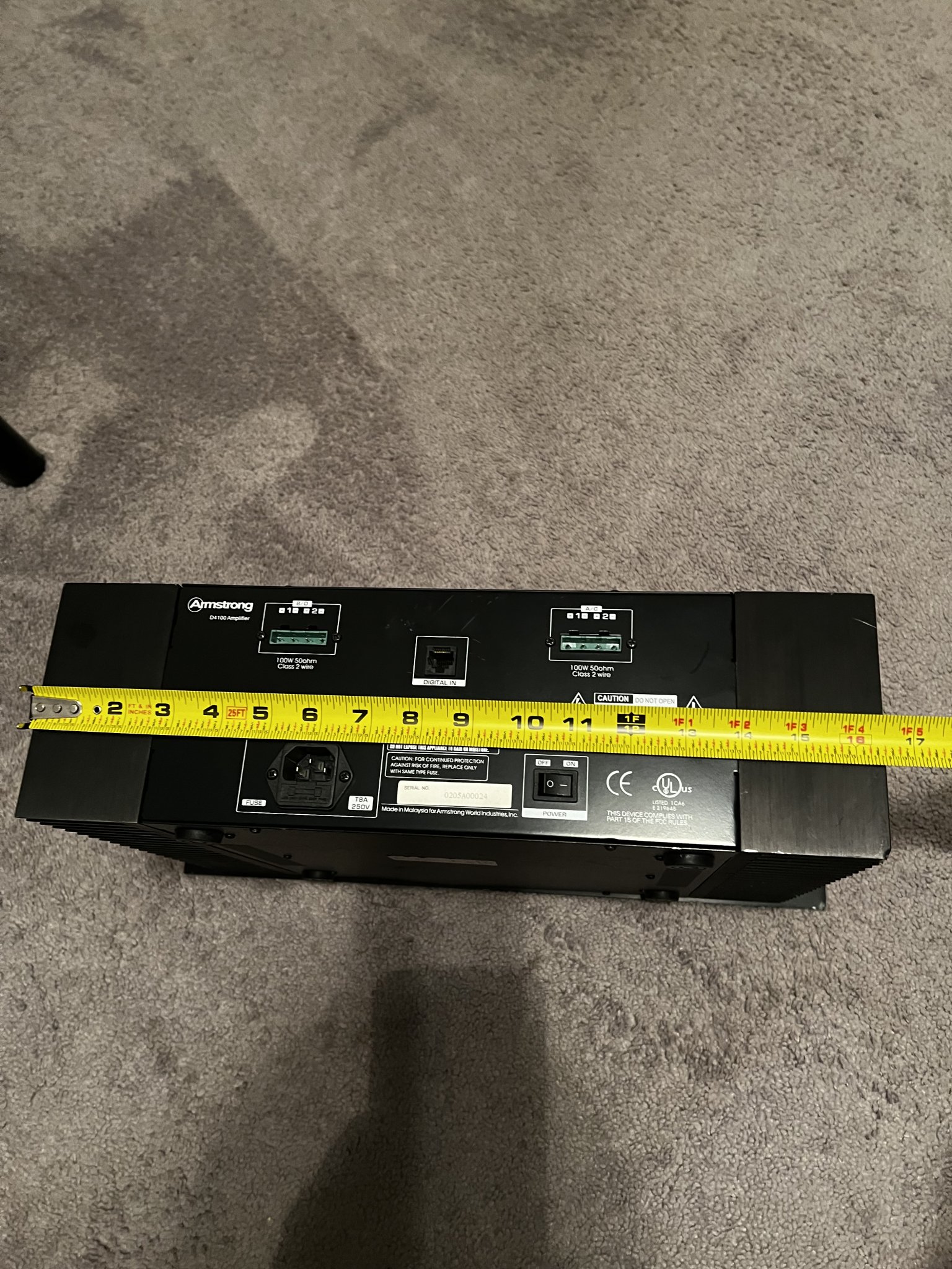

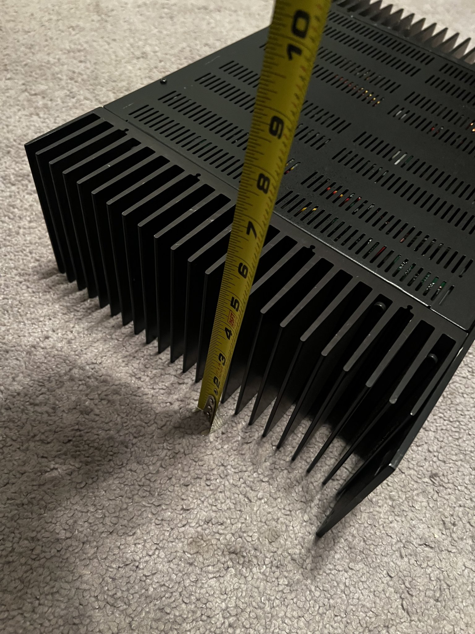

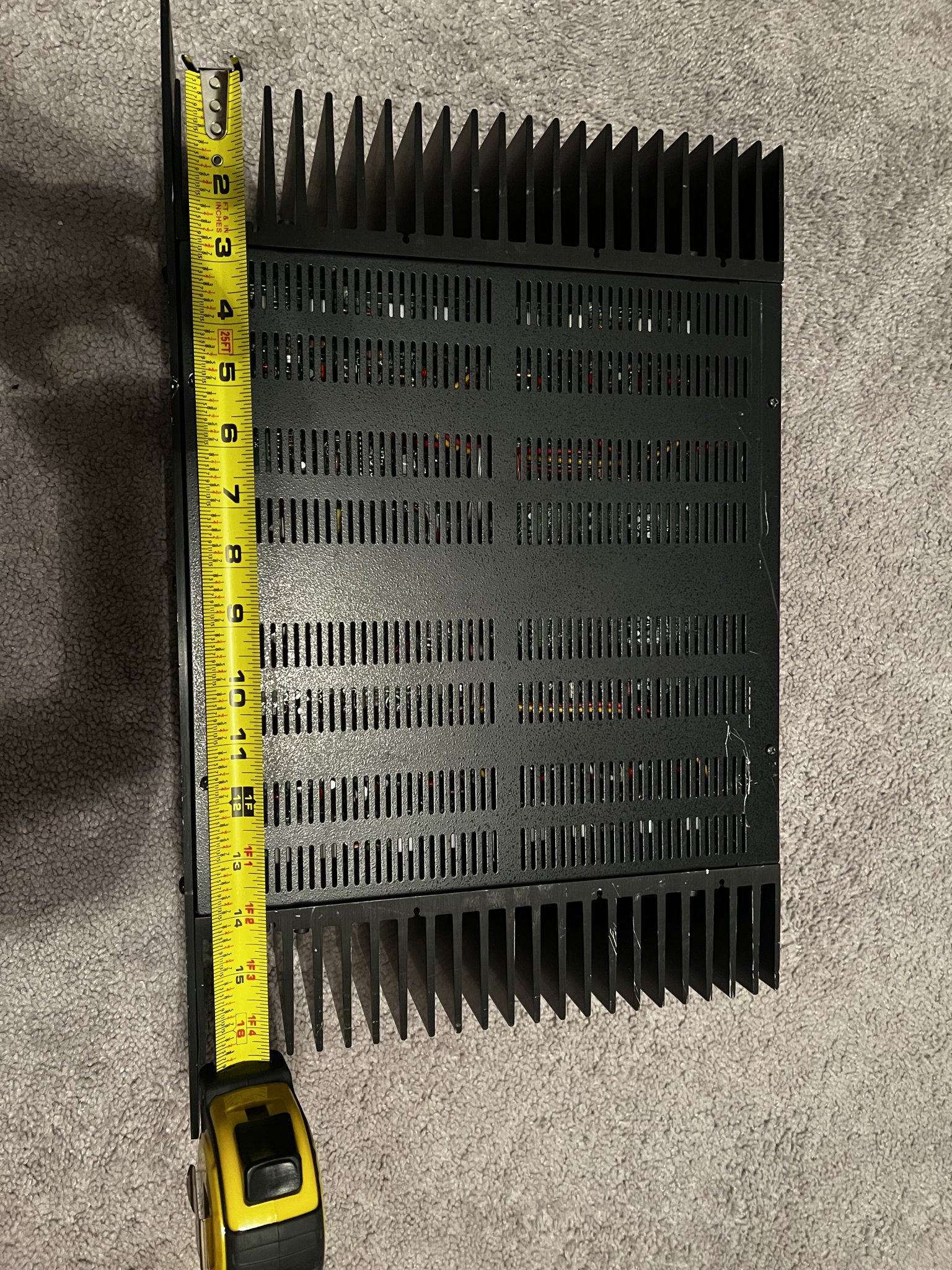

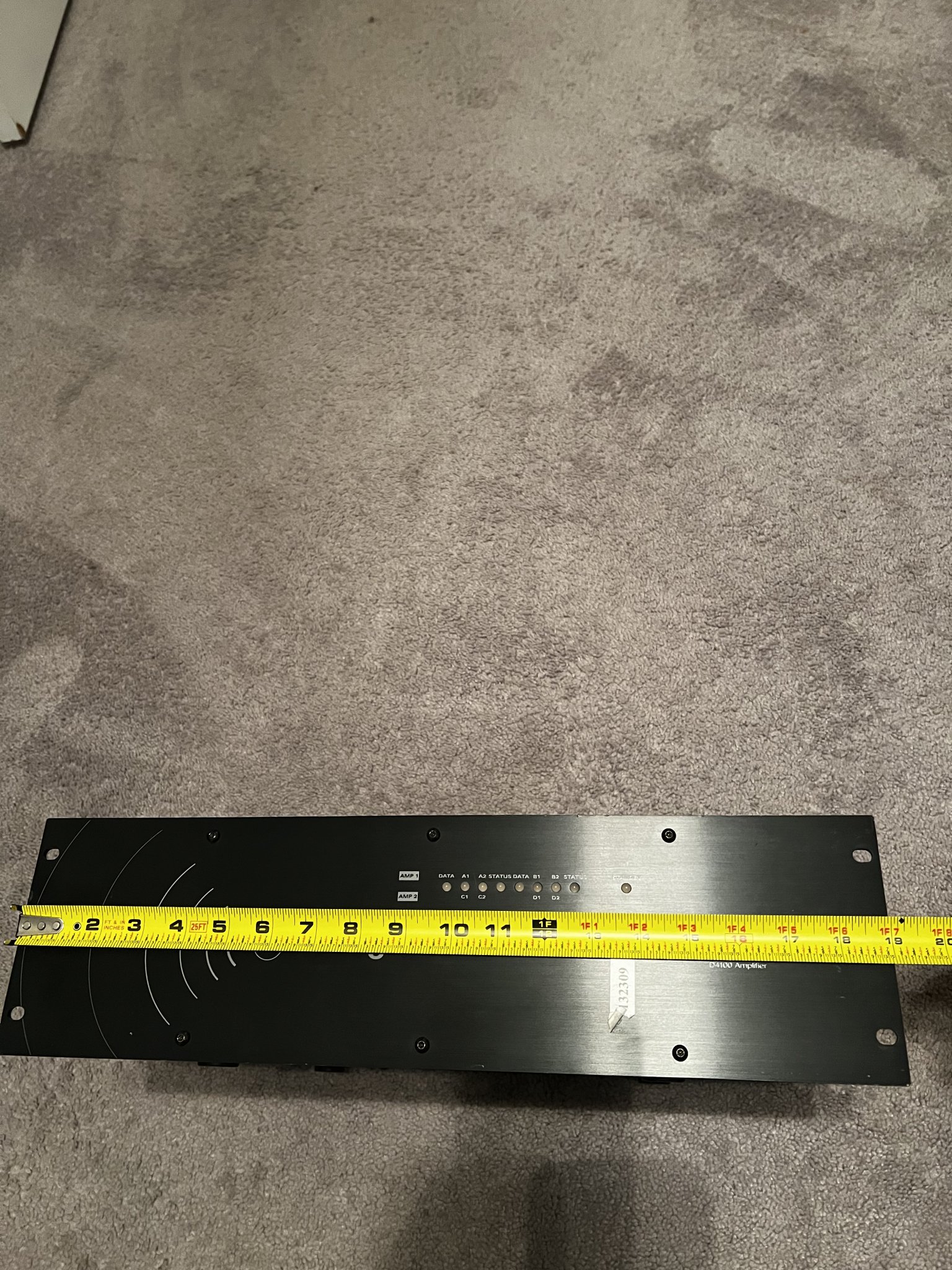

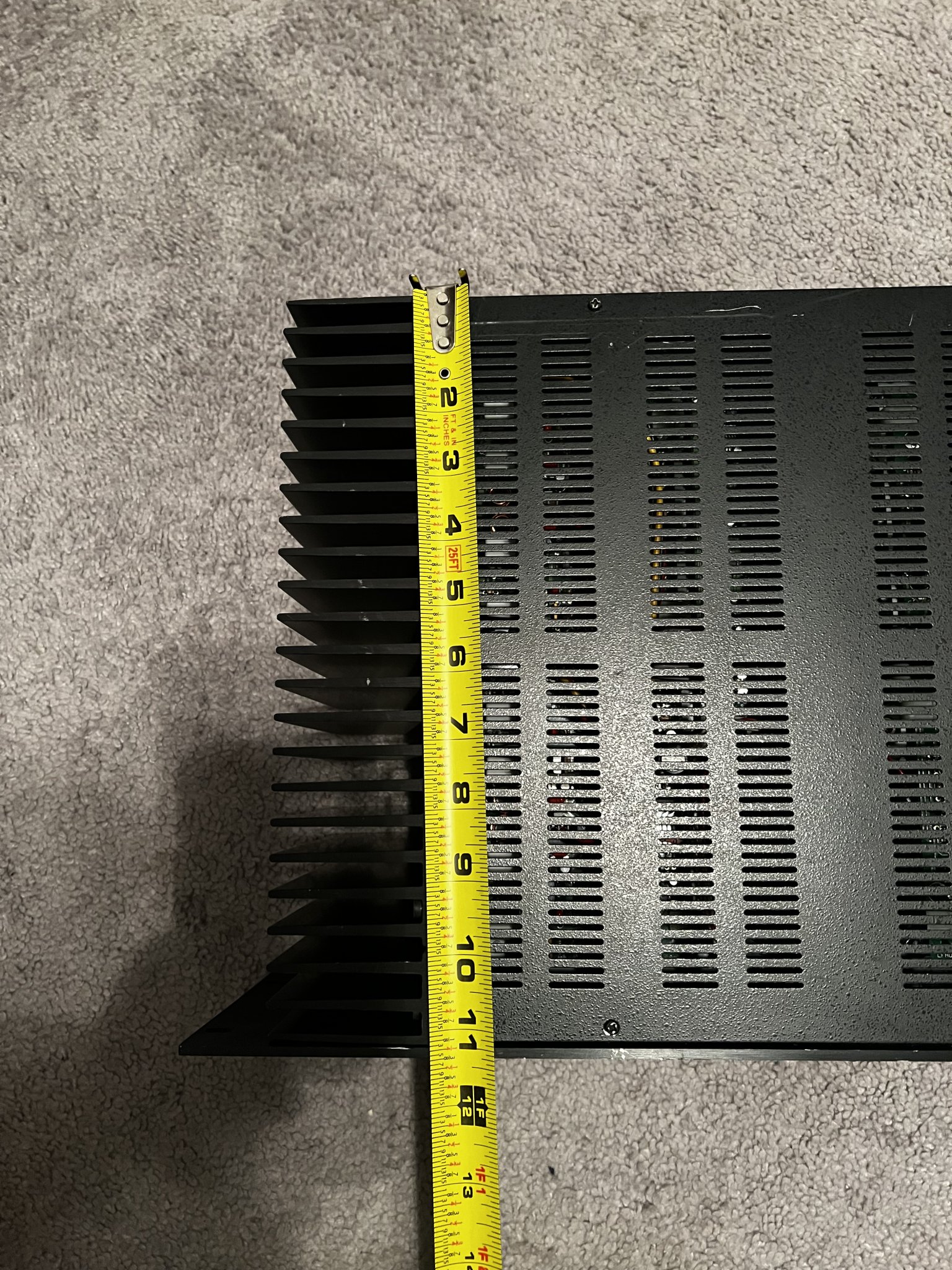

I also have a e-waste Chassis that is kind of the same size as a 3U but I am unsure if the heatsinks are big enough. I was planning on using it for another build.
Here are some pictures and dimensions.

Jacruzer787,
Looking at images of the tape measure held against the chassis, it looks like the internal dimensions of your chassis is 11" deep vs ~12" deep (300 mm) for the Dissipante, and also less wide (11" vs ~14").
The heatsinks look like ~62mm with base, and the base looks around 7mm thick. This means that the fins are longer than the Dissipante heatsink - this is better as there is more surface area.
The height of the fins if ~5" will be ~127mm, so slightly taller than the Dissipante 3U.
So all in all, thermally this chassis looks to offer similar performance to that of the Dissipante 3u x 300 mm chassis, but the internals are slightly cramped.
Look at the dimensions of the power supply board and transformer, and see if you can fit everything inside that space you have.

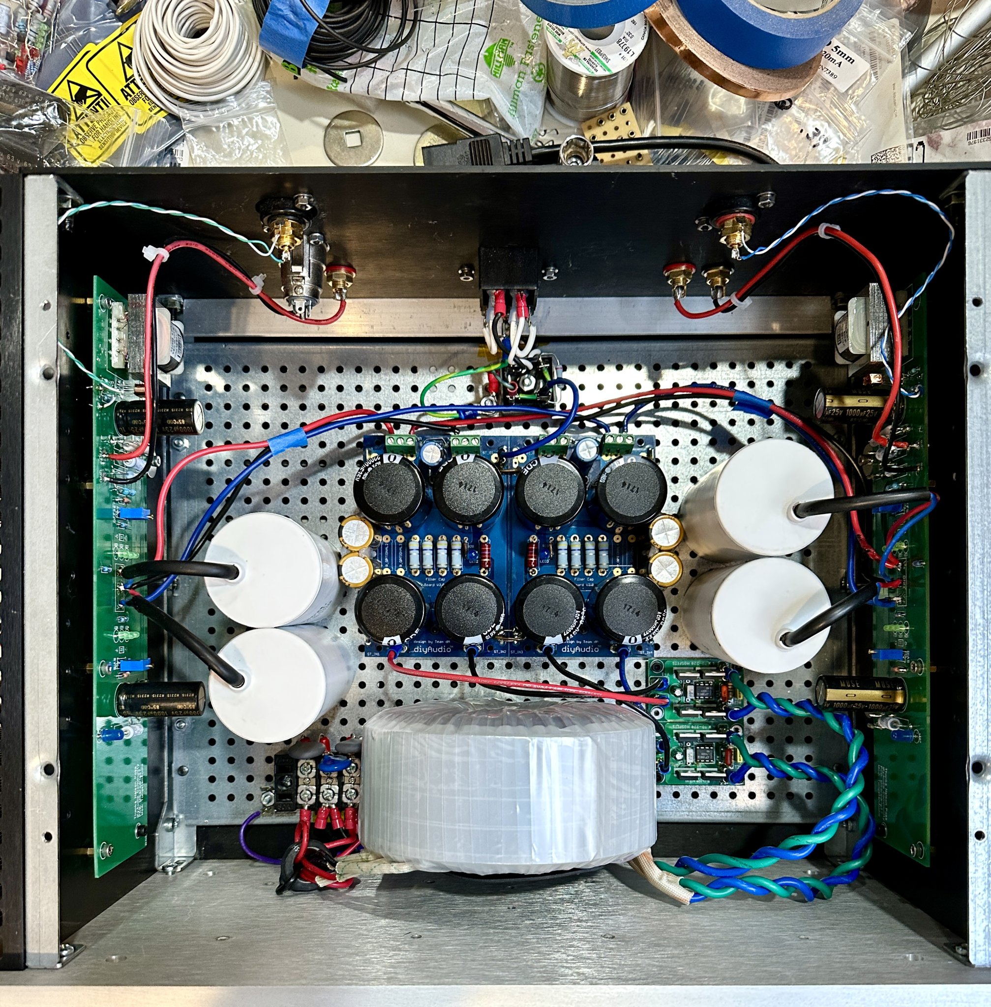

Fitting the F5m PCBs to the heatsinks will not be a challenge - the PCBs look compact enough. 🙂
I was referring to the power supply board and the power transformer.
Some transformers are larger in size than others... specially the Antec units are on the bigger side.
The power supply PCB looks to be roughly 140 mm x 125 mm - maybe someone can confirm that.
