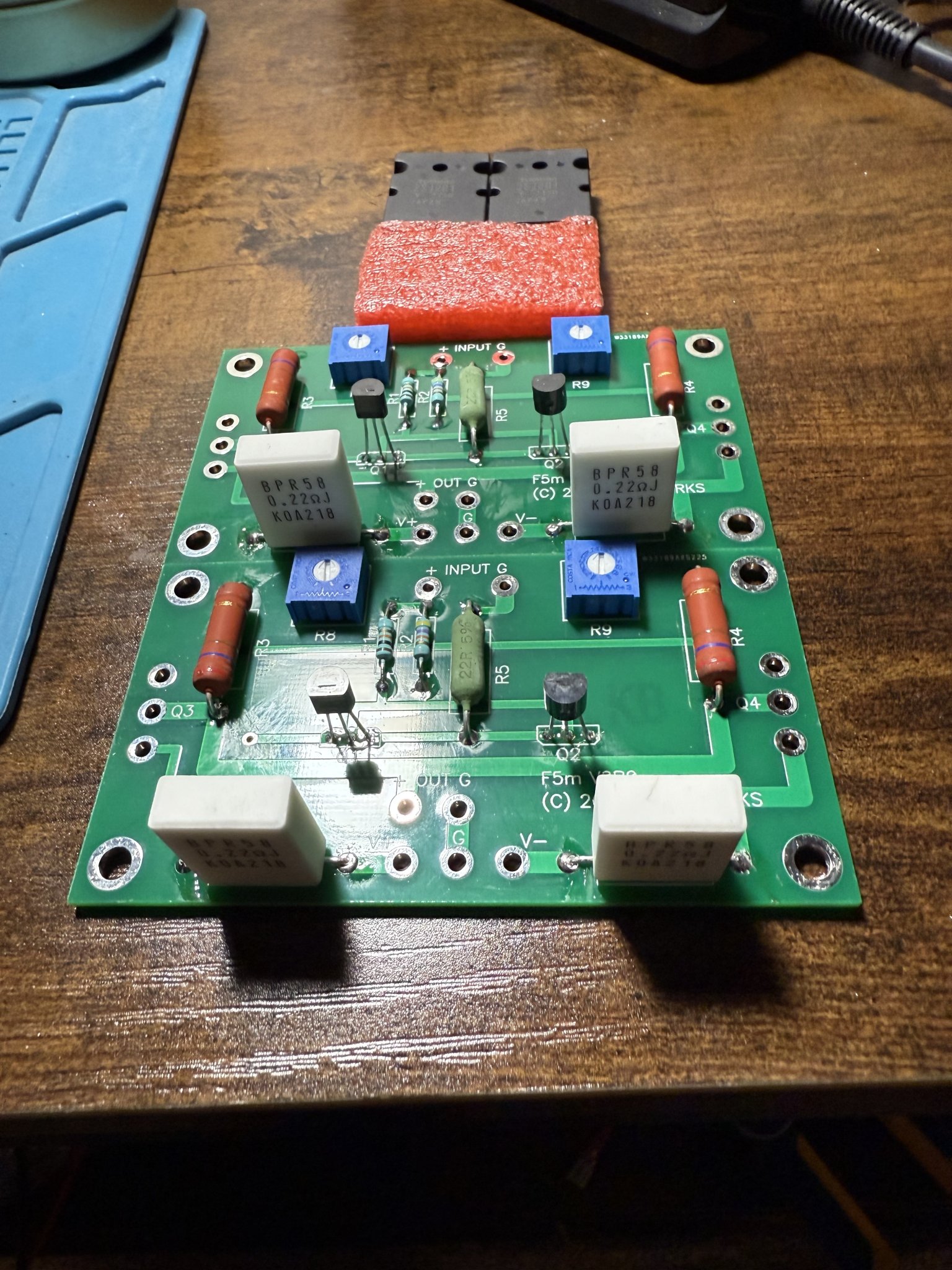

Well, I do really like the sound of my F5m as-is ... not really wanting to change anything ... 🙂
I still need to do the distortion measurements (REW and Focusrite).

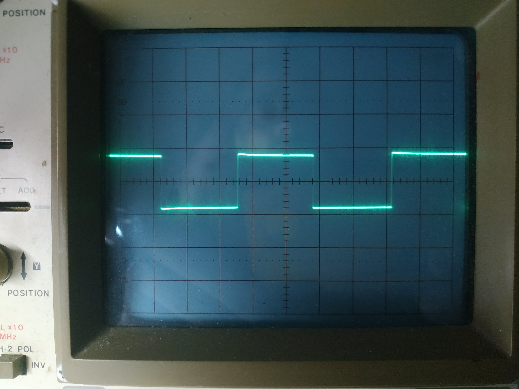

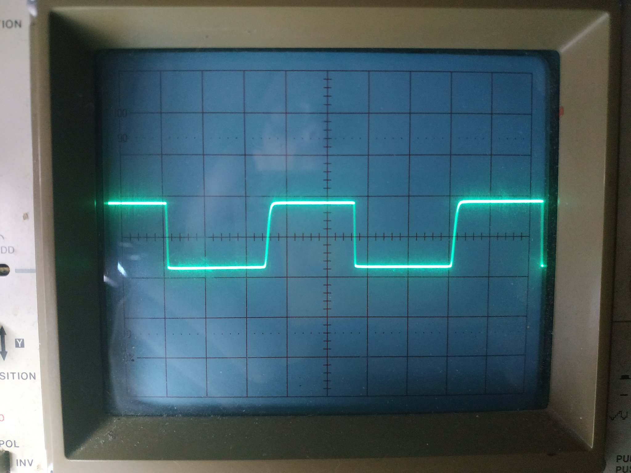

@Nikos I had just bought my first O-scope last spring and ran a square wave through the first 2 home brew f5m channels I built. I didn't save an image but apparently everything looked good enough that I followed up with multiple channels without any changes. The jfets were matched, as were the resistors but The mosfets were straight out of the tube. I need to re-bias and test a pair of channels in the near future and will capture a square wave image when I do.
@Nikos I'm pretty sure they were 7.9x mA and came from the diyaudio store.
I usually try to match to within 0.1mA but I've used pairs that were 0.2- 0.3 out without any noticeable problems. I've also used pairs as low as 5mA and as high as 10mA on other Pass amps. For piece of mind, and per Nelson's suggestion, I do add a small press-on heat sink to units above 8mA

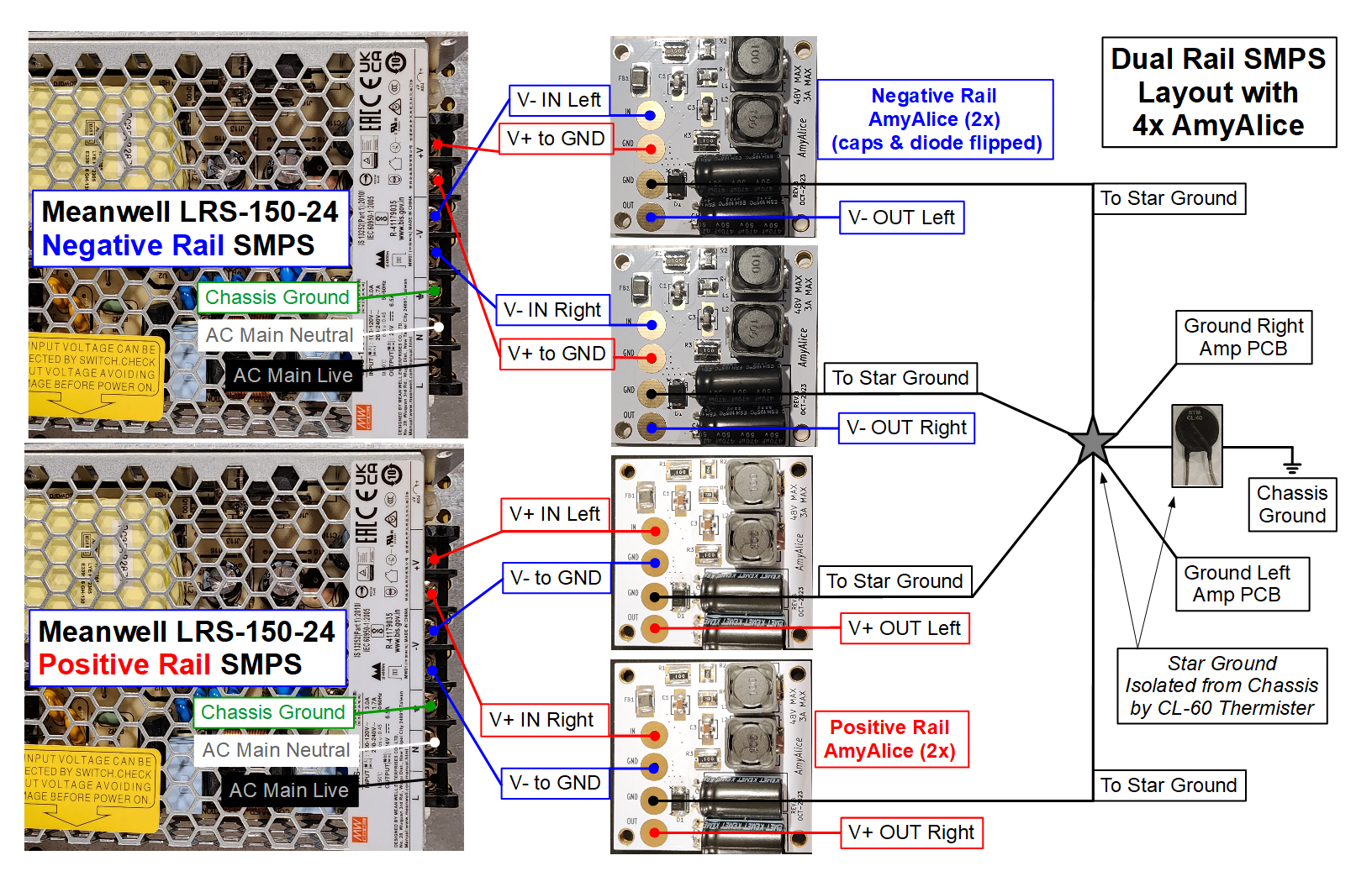

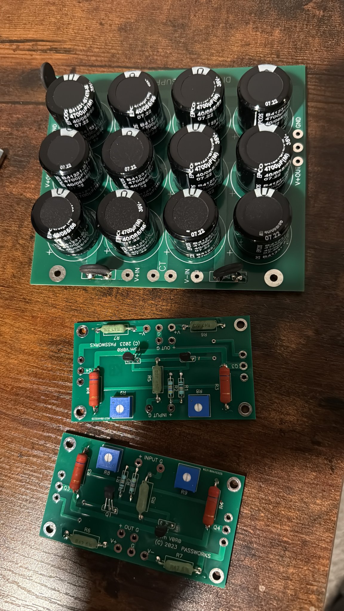

You need two Meanwell supplies for the F5m dual rails. Still less expensive and fits in smaller chassis than linear. I highly recommend using Mark's AmyAlice boards. I was able to squeeze it all into a 2U/300 chassis!!!
Yeah.... I was actually thinking of two external bricks... but that will do as well... thanks.
Time to search Mark's AmyAlice boards.
I was actually thinking of doing it in two boxes... put the power supply external so I can play in the future. A 2U 300 chassis for the audio signal ( enough heat sinks ? ) would be very nice and easy to stash in the rack.
It's an extremely tightly fit for the 2U/300. Making a separate PSU chassis would help. I was able to bias at 1.1A and had 55°C heat sinks in a warm room, however the build has two tiny 24V Noctua fans inside blowing air out from the Meanwell supplies. It got a little warmer without the fans.

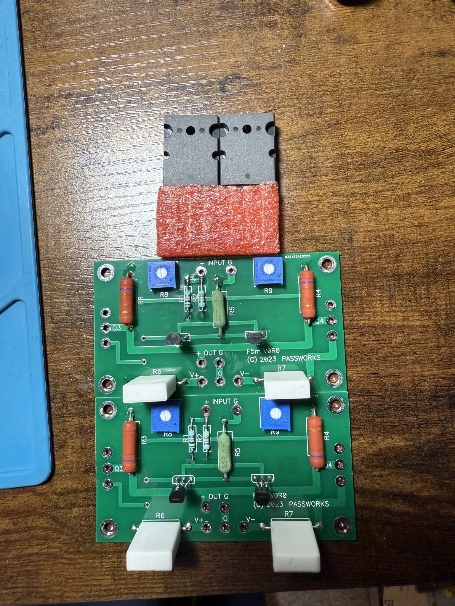

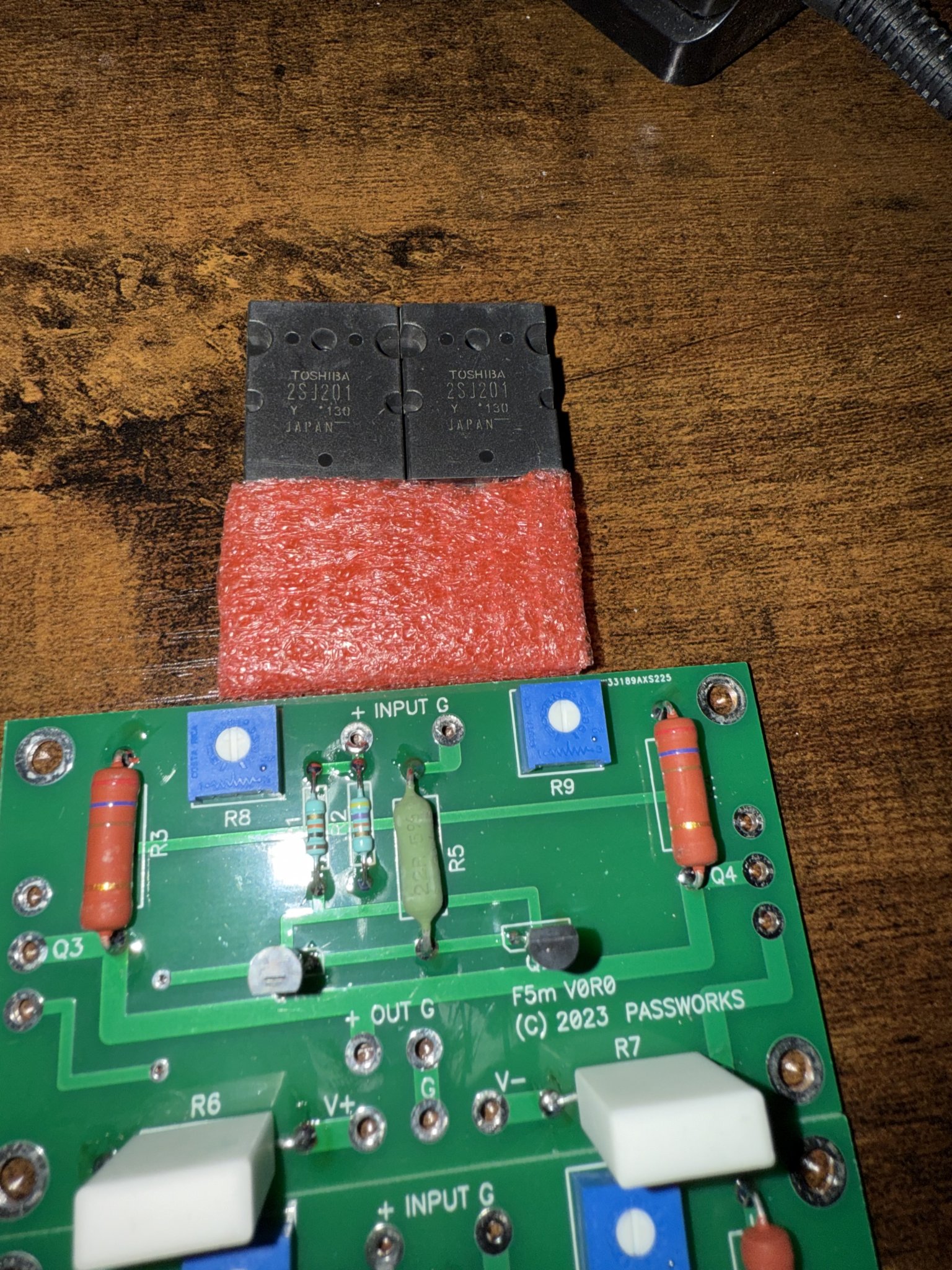

My build in progress thanks to @Russellc give away. Thinking of using Toshiba mosfets 2SJ201 / 2SK1530 from my stash instead of IRFP came in the kit. I do see that @chede used this pair and satisfied with the sound
Here are the waveforms from the 2sk170 2 sj74 GR 3.0ma idss without low pass filter in the input. Most likely the high idss Jfets 8.92 that i have To be responsible for overshooting ....

Yes, they do have SMD and they work fantastic. You probably can get away with two AmyAlice filters, but I went with 4 to just be sure I had lots of margin. The AmyAlice are limited to 3A max per board. It should be fine with two FETs on each AmyAlice (just two filters vs four) if biased at 1.1A = 2.2A per filter. With 4 separate filters, that's 1.1A per filter before music plays.

If you're referring to the "AmyAlice Quad Rack", yes I made that design specifically to hold the 4 filters in that tiny 2U/300 chassis. Works really well and also allows for the star ground approach. Happy to print one for anyone interested who doesn't have access to a 3D printer via a Makerspace or buddy. I can be the "buddy" with a 3D printer 😉
Here's the star ground scheme with 4 filters inspired by @lhquam .
