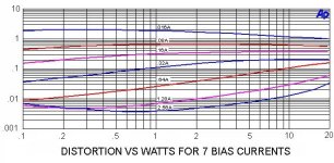

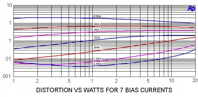

In general more bias=better performance when you're speaking of almost any of these Class A amplifiers using MOSFET output devices. Attached is a picture from NP's "Leaving Class A" article to demonstrate the point. As expected, you eventually reach diminishing returns, and we are obviously limited by the hardware on how far we can push things. Heatsinks @ a maximum 50 to 55C at thermal equilibrium, under worst case conditions (middle of summer, etc.), is a reasonable target.
Helpful graphic. Thanks.Attached is a picture from NP's "Leaving Class A" article to demonstrate the point
