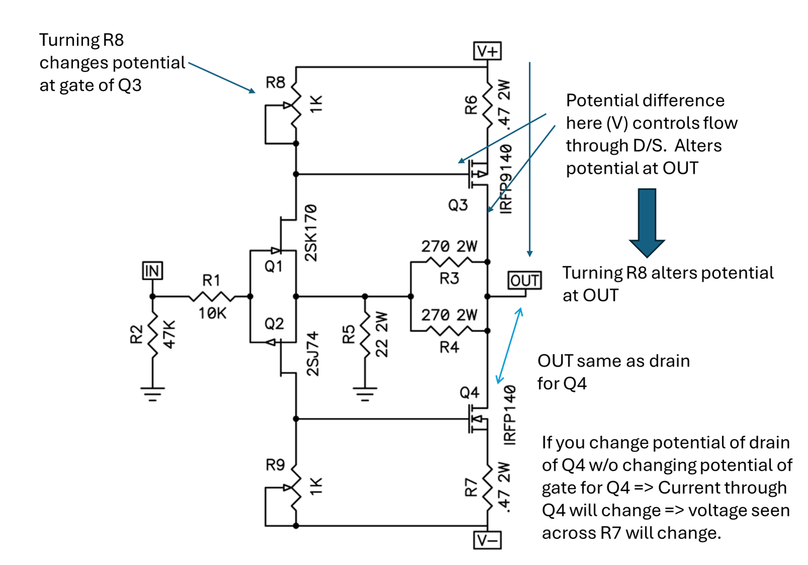

What I observe is that adjusting either R8 or R9, the current flows through both Q3 and Q4 change simultaneously.R8 / R9 set the voltage at the gates of the MOSFETs => alter current through Q3/Q4 respectively.

Since the MOSFETs D/S run from the rails to OUT. The MOSFETs 'meet in the middle'. So, if you're measuring across R6 (to monitor current through Q3) and you change the current flow through Q4 by twiddling with R9 => Let's say increased it. You're allowing more current to flow from the negative rail to OUT. So, you've also changed the potential at OUT which is the same as altering the potential at the drain of Q3. Since the gate at Q3 was unchanged... and MOSFET current flow is controlled by the differential between gate to drain... You've changed the potential difference between the gate and the drain of Q3... so...
The current through Q3 will change...

I'm AWFUL at this stuff, but here's how I think about it with a diagram. Those that actually know this stuff, feel free to shred it. I need to learn it properly.

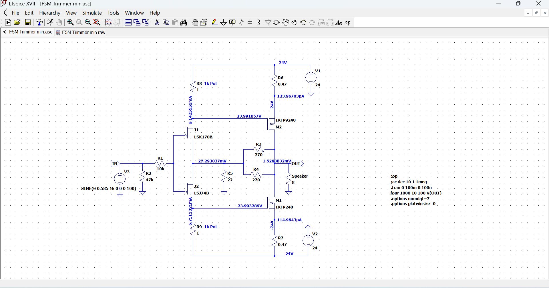

Here is a LTSpice model of the F5M to play with. The trimmers are set at minimum resistance so not much current is flowing. Have fun. 🙂
Here is Michael Rothacher's BAF2023 LTSpice presentation if you need some help getting started:
https://www.diyaudio.com/community/...-and-beyond-for-diy-audio.402932/post-7468621

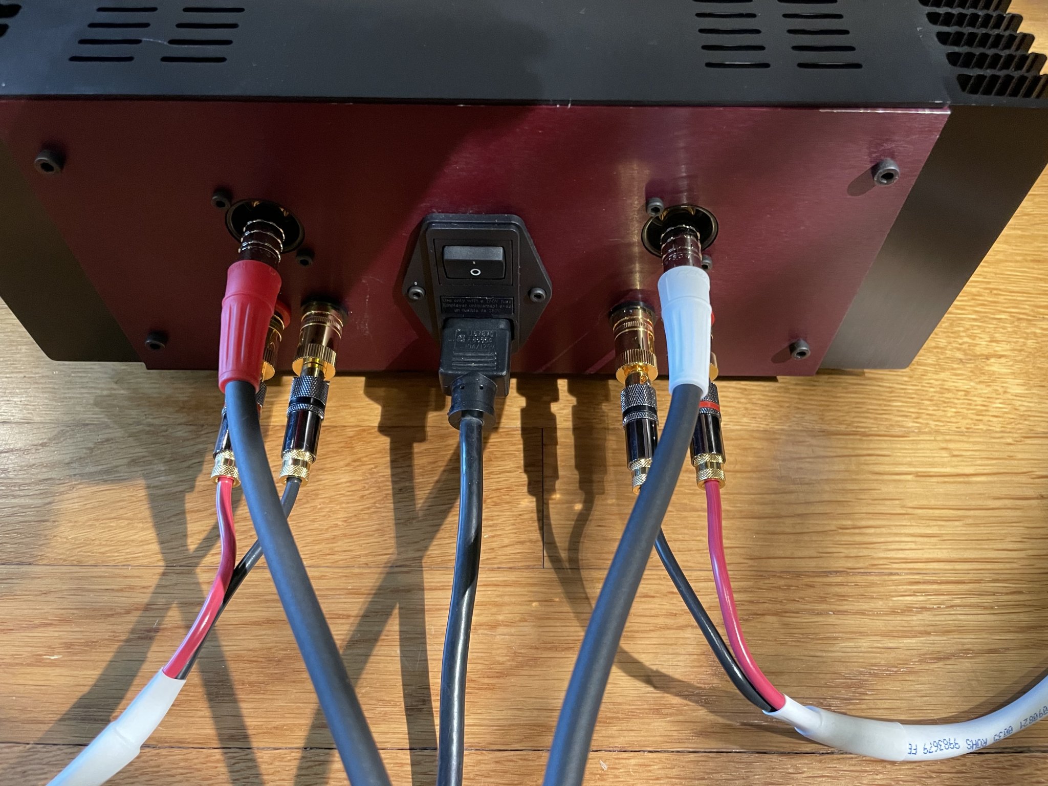

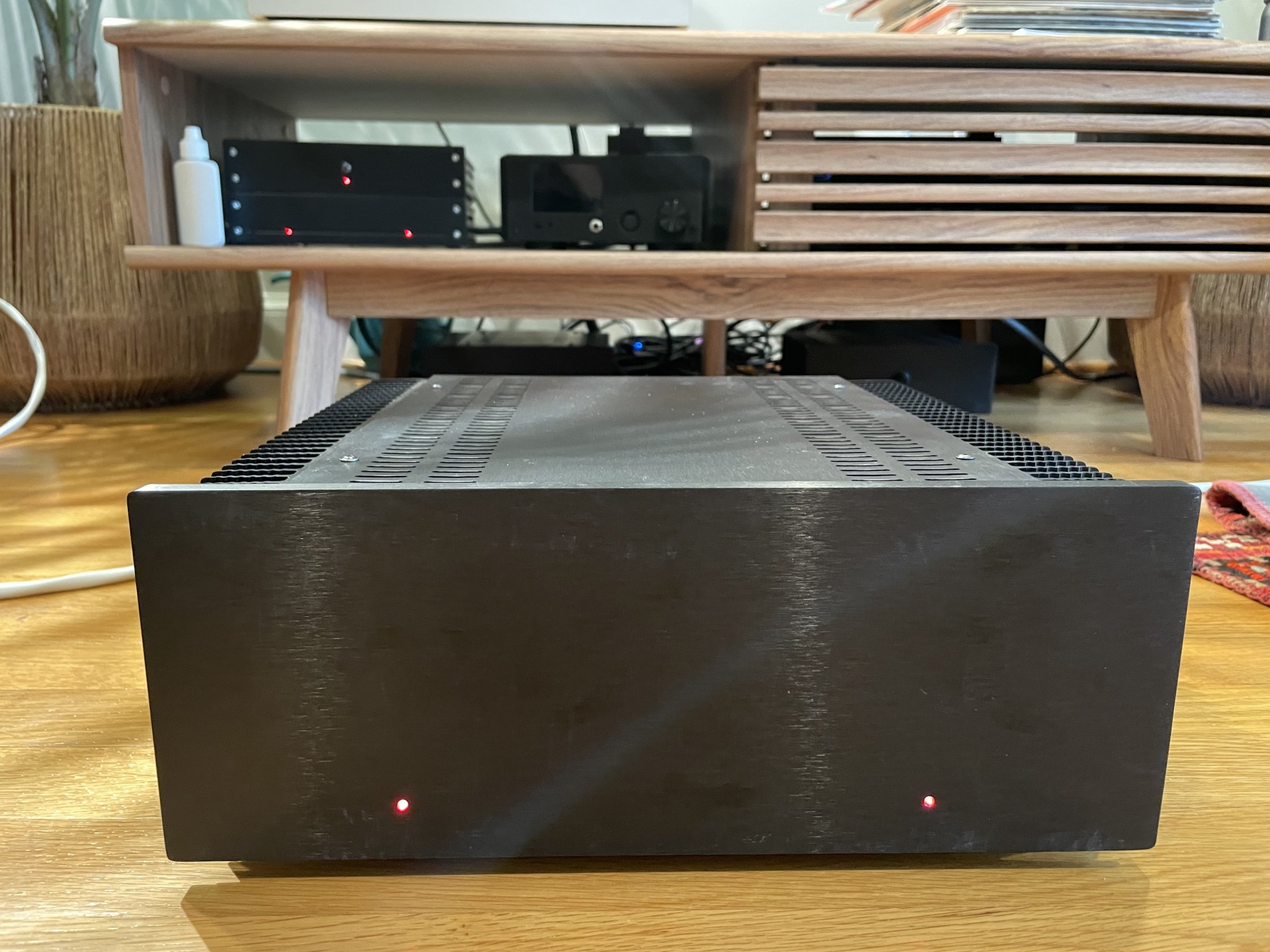

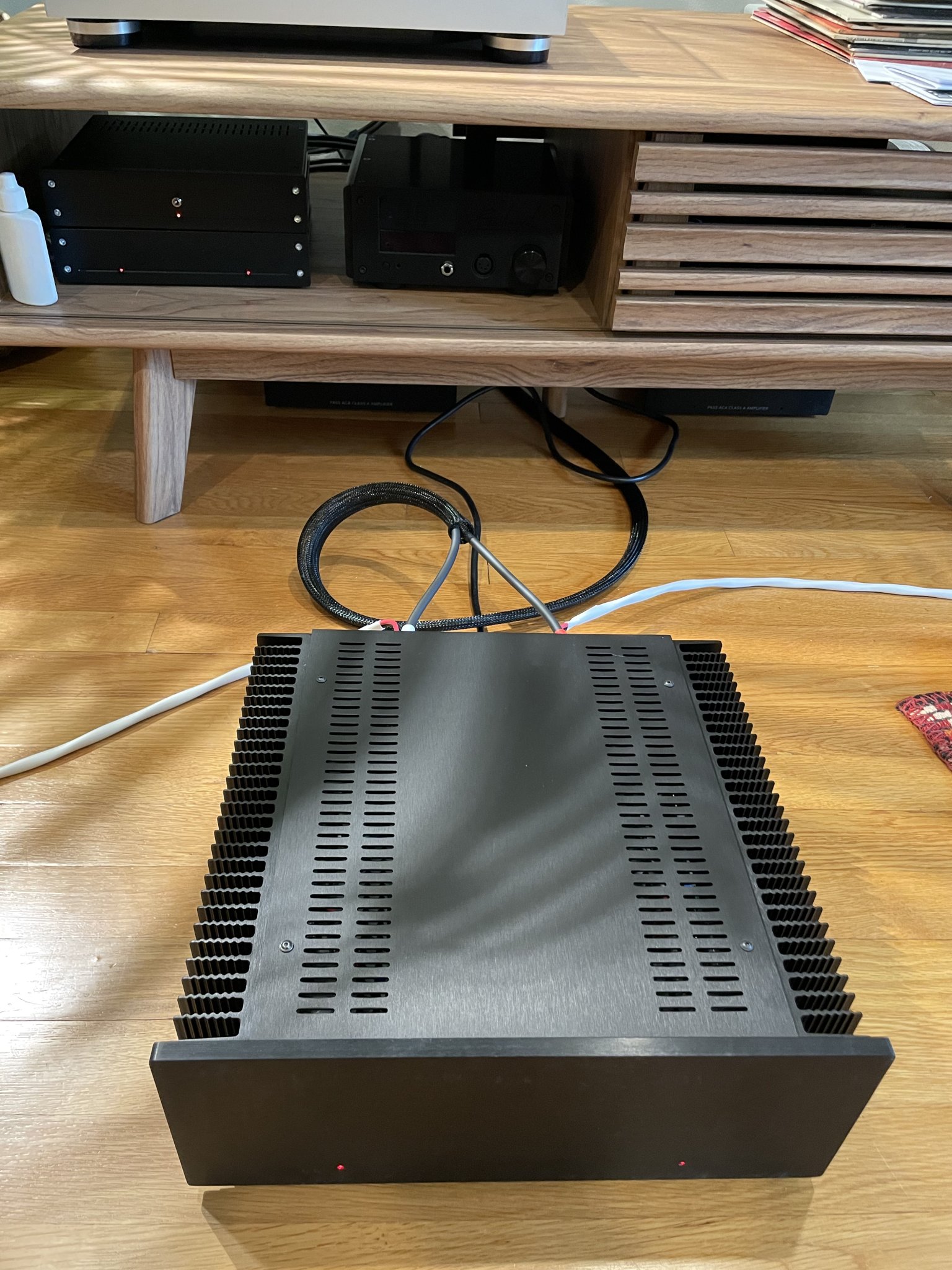

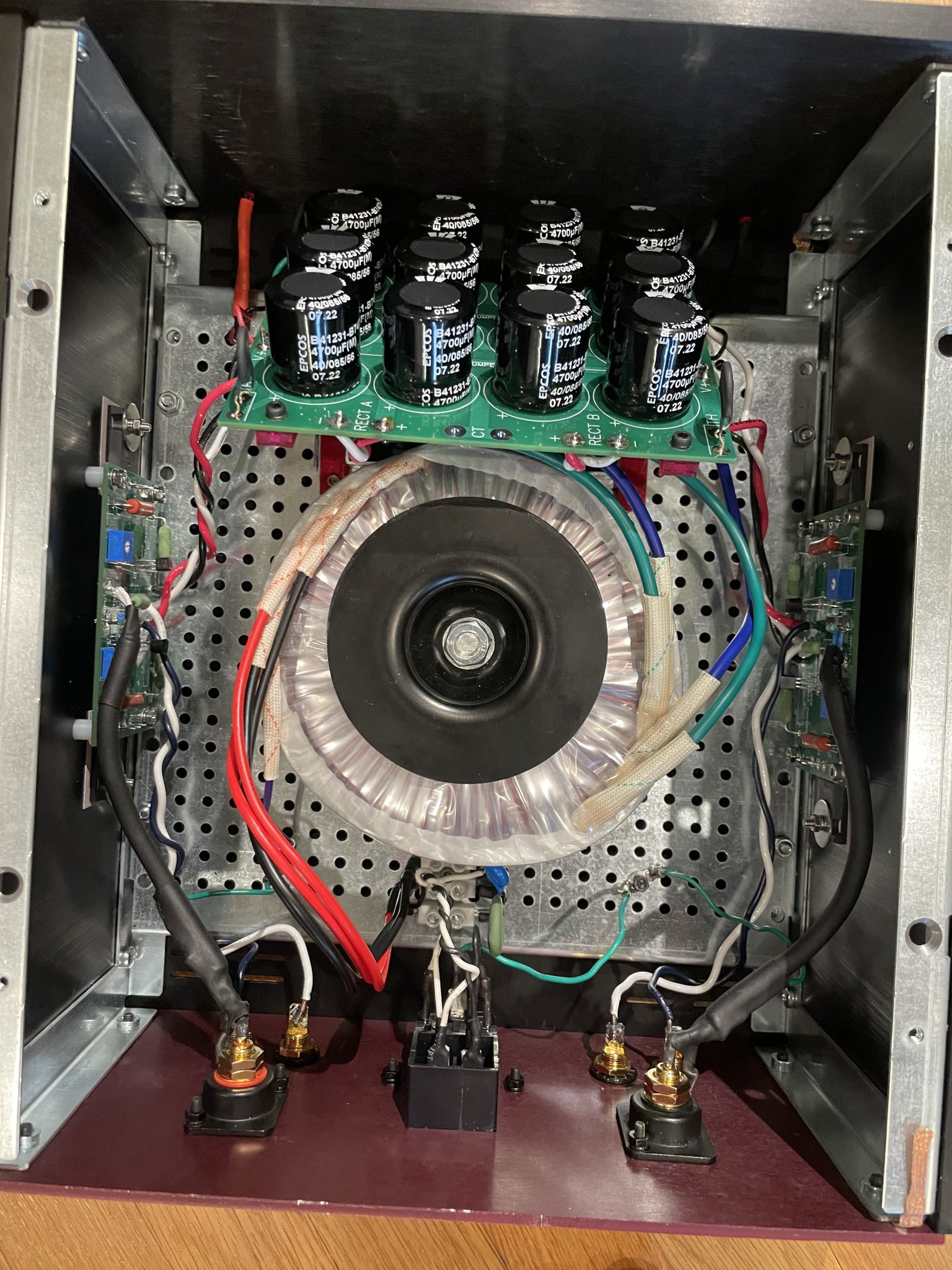

Final button-up completed.
- R6/R7 voltages trimmed to ~530mv. The unit was pretty hot at 780mv, and probably okay, but I dialled back down because 25-30W/ch is plenty for these speakers (88dB sensitivity) in a smallish room. And DC summer just kicked in with a vengeance, which made me feel a bit guilty about the extra heat
- Reconfigured LEDs to monitor V+ and V- to ground respectively, instead of both of them connected across V+ and V-.
- Attaching the front panel was a bit of a chore, as it was hard to position, align, and then tighten the screws. Took me and my son a good half an hour to fiddle everything into place

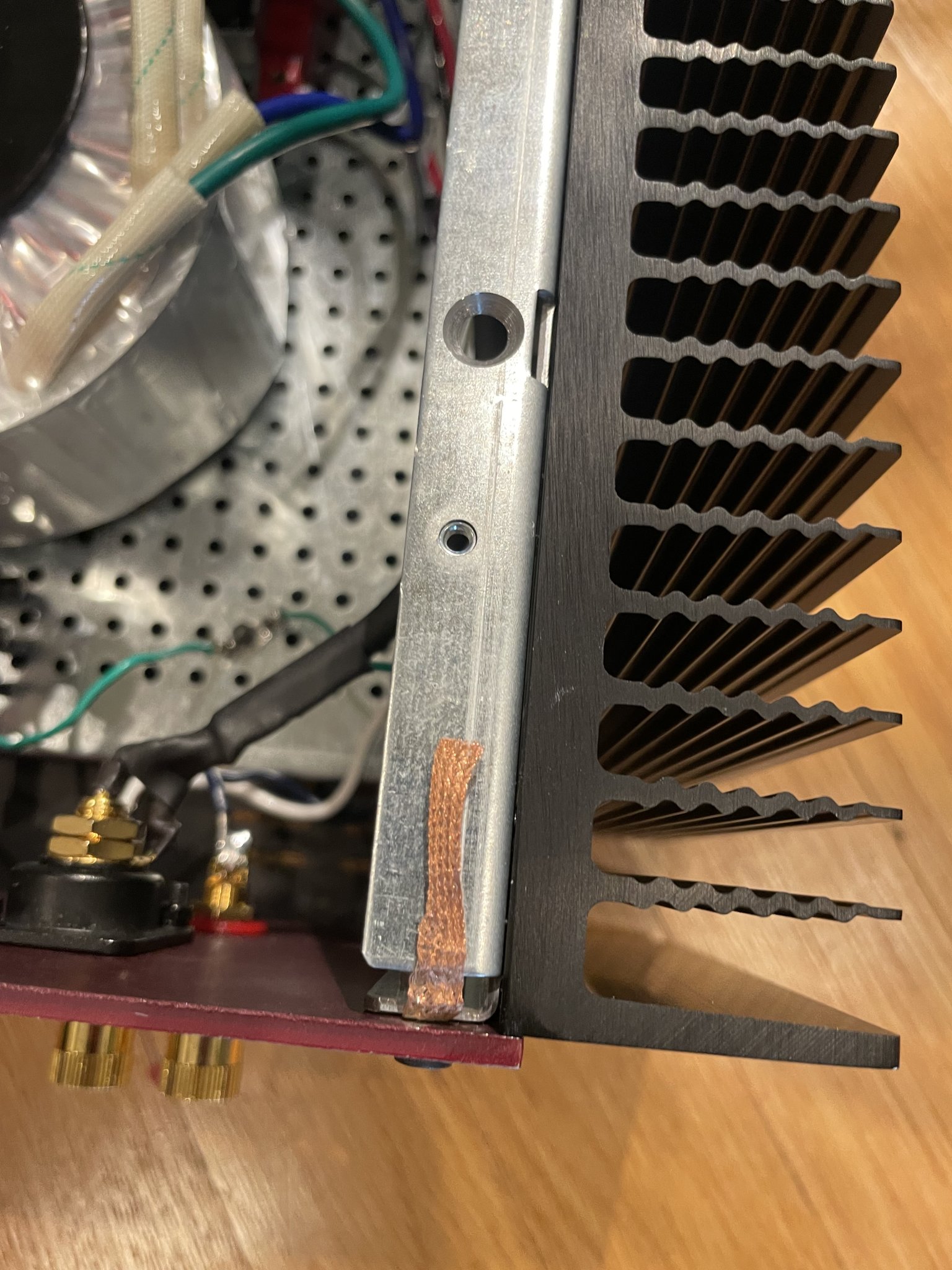

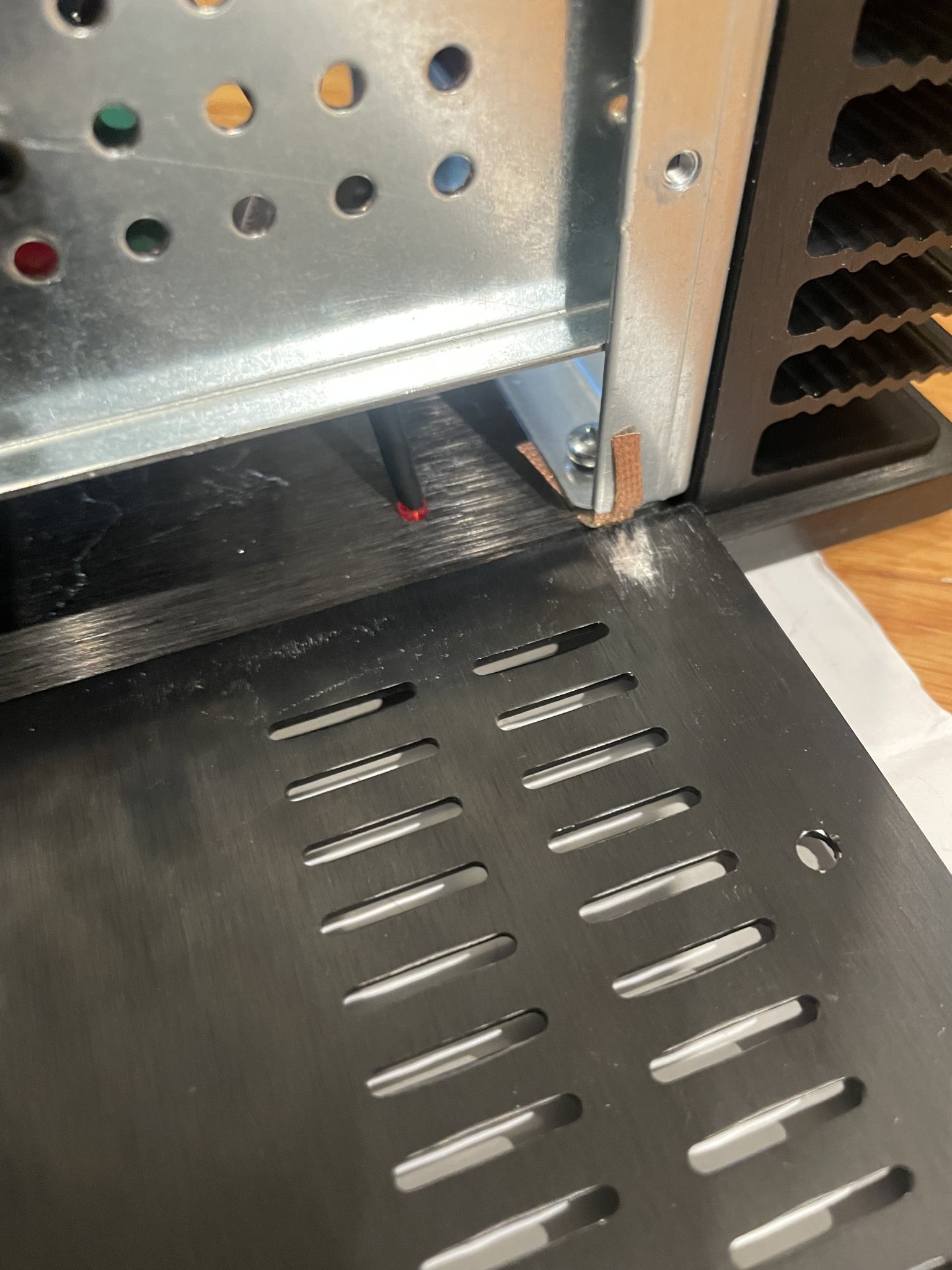

- Scraped anodized paint from corners of top, bottom, and rear panels, and placed some copper braid between them and the chassis frame to ensure good grounding connections all round

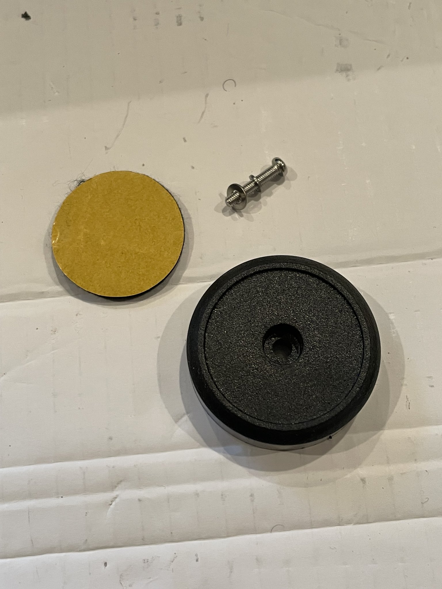

- Mounted feet with some M3/16mm bolts, taking advantage of mounting holes for bottom panel

Being in series, Q3 and Q4 must have equal DC currents, even if the output DC voltage is not zero.
Now this is the missing piece of the tuning strategy I've been looking for. Seriously, this should be part of the build instructions. Thank you.fiddle with R8 to chase desired Iq; go with half-steps
