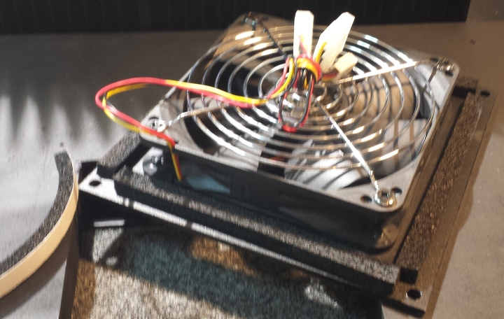

you really don't need that black mesh - it will just increase fan noise
leave just shiny one , on bottom side
The slightly soft room-temperature elasticity of hot-melt glue should actually help decrease any coupled mechanical noise of the fan to the plinth.
It should work great! -- however it looks like the black mesh can be removed by itself to leave the black metal(plastic) in place, where the screws attach to the wood. At least that's what it looks like from the photos. Can you pry it off and have everything else intact? Or will the mesh unscrew, and then you can screw the mount and fan back together?

6L6, you are correct on the screen. Still, the glue may decrease the noise. Or maybe some foam strips between the black mounting portion and the particle board.
no. they are much smaller🙂 and they dont need to push alot of air. and there is no cabinet to amplify the noise. a fan in free air don't have much noise at all🙂

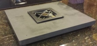

Painted it flat black so to not bring much attention to it.

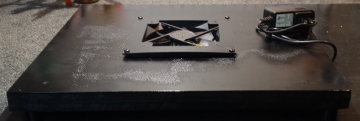

I removed the screen and then used foam weather stripping between the fan and stand. I tightened the mounting screws just enough to keep good tension on the foam. It ran so quiet I did not use any hot glue.

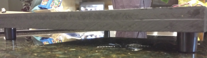

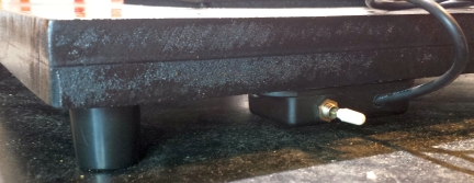

Mounted 7/8 inch feet to the base. I'll add a small enclosure for connections and a switch in a couple days.
Sorry for some of the out-of-focus shots. I think the camera had problems with the shiny granite counter. You can see the reflection of the bottom of the fan on the counter-top in the last photo.

I have attached a couple photos of the cooling stand, now with a nice power switch and another coat of paint. I placed the amplifier on the stand, and it fit perfectly.

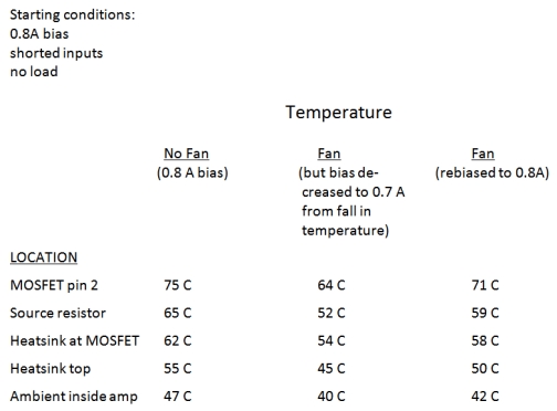

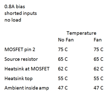

To examine the effectiveness of the fan, which cannot even be heard at five feet from the amp, I let the amplifier sit for two hours biased at 0.8 A, inputs shorted, and no load on speakers. I confirmed offsets of < 3 mV. That is, I let the amp warm up for about two hours and slightly readjusted bias, and then let it sit another two hours, during which time the bias and offsets did not change.
Then, I took temperature measurements on pin 2 of the MOSFET, on source resistors, top of the heat sink, on the heat sink in proximity to the MOSFET, and in ambient air within the sealed amplifier.
Then, I turned on the fan and let the amplifier sit another two hours and repeated measurements. I was quite surprised by the results, which are summarized in the third photo.
Hmmm. Not a single change. I once again made sure the fan was on. And, of course, confirmed it was blowing air up rather than down.

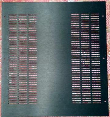

I then took a look at the top panel of the chassis and realized that the bottom panel directly over the fan was identical. See any problems?

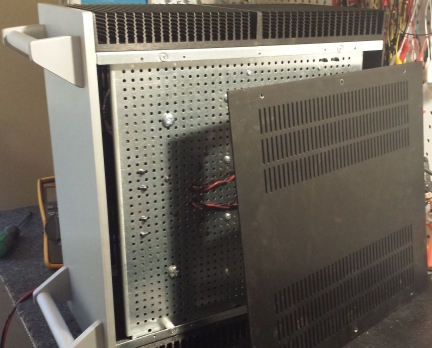

Blowing air up against the central non-perforated portion of the bottom is futile. I need to drill a bunch of ventilation holes in the bottom panel over the fan, it seems to me.
The top and bottom are identical. I am going to remove the bottom panel just for purposes of running the test again. If temperatures fall as they should, then I will need to drill ventilation holes in the bottom directly over the fan.

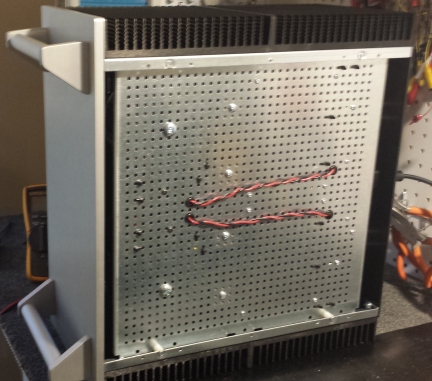

I set the amp on its side and removed the feet and bottom panel and grabbed a photo to show how the bottom panel's central, solid portion prevented air movement into the amplifier, since it was directly over the fan.
I left the bottom panel off (second photo) and then remounted the feet and set the amp back on the stand, turned things back on and let it cook with the fan running.
After about 2 hours, I took measurements again (3rd photo). Temperatures were dramatically lower, and I could feel air moving out of the ventilation holes on top of the amp. BUT, the lower temperatures were accompanied by lower bias - it had dropped from 0.8 A to 0.7 A. Of course, a MOSFET's output increase with temperature (which is why there are thermistors in the F5 to decrease Vgs as temps rise), and my primary effort to lower temperature also lowered MOSFET output, which in turn, lowered temperature, until a new equilibrium was reached.
At least in my case, then, if I would have biased without a fan to 0.8A, noted what temperatures were, and then found that temps became lower with a fan running, this would have been, in part, because of decreased output from the MOSFETs that I would not have recognized.
In order to compared oranges to oranges, I re-biased the amp to 0.8A with the fan in operation and let the amp cook again for a couple hours and repeated temperature measurements after confirming bias had remained at 0.8 A. As seen in the 3rd photo, temp measurements were, indeed, lower than biased at 0.8 A without a fan, exactly in the range that Zen said they would be (about 5 C lower).
Now, I can drill holes in the center of the bottom panel, directly over the fan, to allow air into the amplifier (and won't get as much air flow as I do now), or I can build a new stand with two smaller fans on each side of the bottom panel where there are ventilation holes....or two smaller fans just over the heat sinks....or 4 fans..... For now, I'm going to drill some holes in the center and see what I can get.
