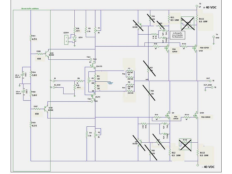

I am considering a couple safety options I wondered if anyone would comment on.
Current limiting
I built this without the current limiting circuit. The reason was not that I was attempting to make the amp sound better, though I have read of those who firmly believe so, and they may be correct. Rather, I was anticipating that current limiting, as originally designed, would begin limiting before I desired it to do so. In pre-build discussions with a couple of friends, it seemed that it would not be worth it, but I would love to get the thoughts of several persons.
1. Should a current limiting circuit be used (the boards were designed for this option)?
2. If it should be used, at what current would you want to begin limiting in this amplifier given results I've posted on distortion, capping, etc., when considering transient peaks that occur during music (classical or otherwise)?
3. If it should be used, what values/devices should be chosen for R17-R22 and the two transistors, all of which are crossed out in the attached schematic?

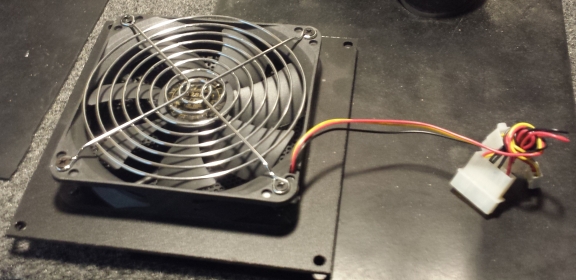

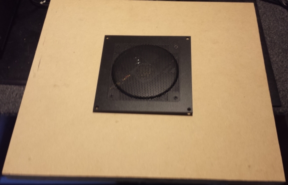

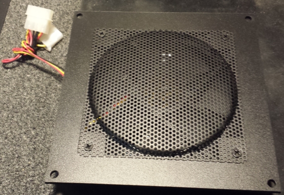

Fan
I am thinking of mounting a large, slow and quiet fan on the underside of the perforated top that would pull air up and out from below. I have used fans mounted in the back before with good results. I also know of descriptions of external fans to run air by heat sinks. But I was thinking of adding a fan to the underside of the top as an easy addition that would provide a bit more of a safety factor. Any thoughts on this, and which fan might you suggest?
Current limiting
Fan

Current limiting: Was removed in the F5T. 'Nuff said.
Fan: Have you seen Zen Mod's "babysitters"? http://www.diyaudio.com/forums/pass-labs/186554-babysitter-papas-koan.html#post2530010 A great solotion to the heat issue, IMO

Thanks for that link to ZM's cooling system! I had heard through the gravevine of their existence, but had not found the link. I will read through it tonight.
Good point on the fact that the turbos had no limiter circuit.

I am going to build a base with a fan like Zen Mod demonstrated for this amplifier (see post #71). I then will rebias and take temp readings and post my findings. This should only take a couple days, if I can work it in. Thanks, everyone.

I have begun construction of one of Zen Mod's babysitters for providing ventilation. 6L6 linked to Zen's project in post #71.
I went through some boxes of spare parts and found a 12 V cabinet/CPU fan with an adapter and a nice cover (can't even remember when I bought it). It was 120 mm X 120 mm and about 1 inch thick.
I glued and screwed together a couple pieces of 1/2 inch high density fiber board to make a stand that was 14 X 16 X 1 inch.
I cut out an opening in the center for the fan.
Next, I'll paint the stand black, add some 7/8th inch feet, and mount a small enclosure on the side for connections and, perhaps, to place a simple power switch on the 12VDC side. These are just some photos of what I've done thus far.
If too noisy, I may cut the voltage to the fan to slow it a bit, but I don't think this will be an issue.
