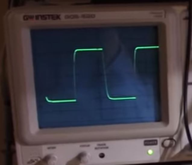

On checking out the Marantz providing the preamp output, one channel had no DC, and the other had 3 mV. I installed the high pass filters suggested by Andrew, regardless.
The new boards were installed and the amplifier sounded great. This time I biased at 0.65 amp and the top of the heat sinks ran no warmer than 122 F, significantly cooler than at 0.7 amp. The photo below is the final square wave at 1 KHz, 1 watt into 8 ohms. Thanks, everyone.

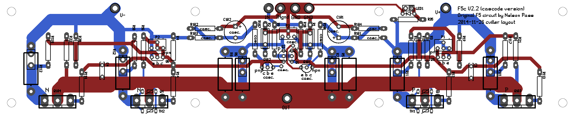

A while ago, I ordered a small batch of those boards that toxic ingestion have discussed in this thread. I was lucky enough to be able to add the capacitors before I sent the file for production, so I have named the version F5c V2.2. Otherwise, the board is identical to the one described in this thread.
To keep things organised, I have placed in on my simple order site:
F5c V2.2 (cascode-able)
It connects to paypal, but I have not used the site for a few years, so please email me if you run into issues. And also email me if you have questions - I have turned off PM because I forget to go in and reply to PM messages.
