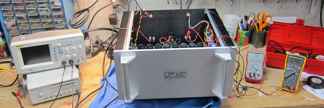

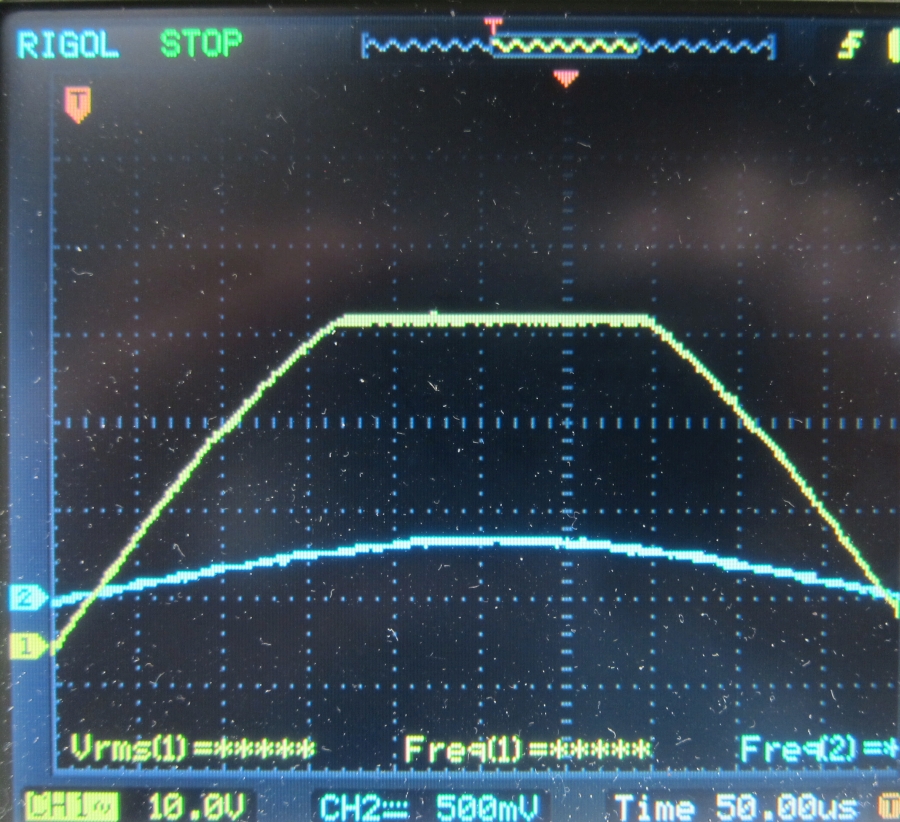

I disconnected power to the left board, installed the repaired right board an powered up the amp with a light bulb – no problems. Then powered up the amp with both boards active. The repaired board biased up fine to 0.8 A and offset < 2 mV. (photo 1)
So I set up for some measurements. Again, no changes have been made other than the repair.

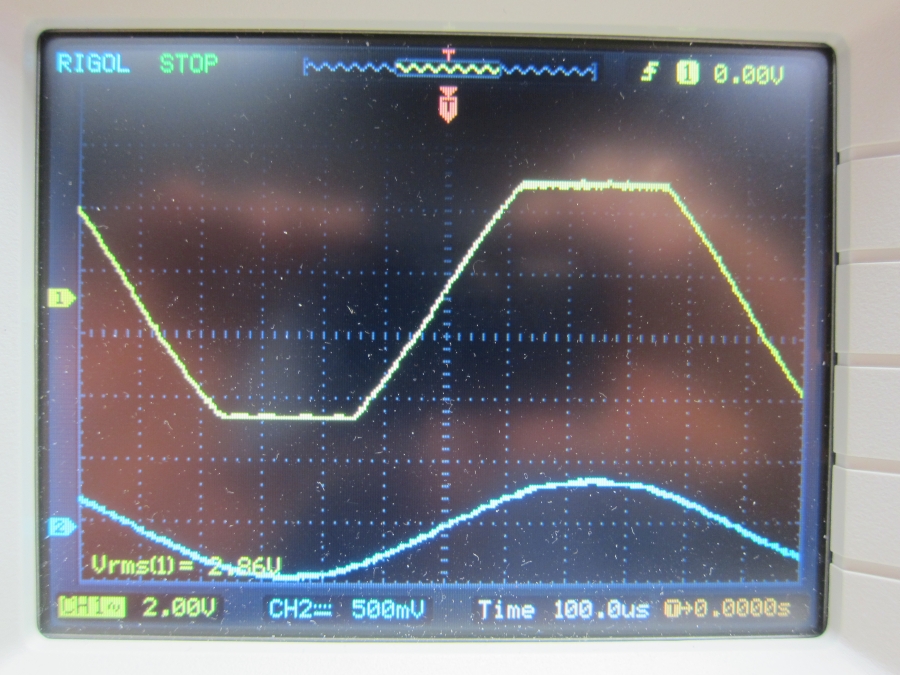

Conditions – R channel:
8 ohm 100 W power resistor load
Signal generator in to R channel through RCA jack
Scope bottom blue trace measuring output of signal generator (input to amp)
Scope top yellow trace measuring output of amplifier
1 KHz sine, triangle, and square waves. Then 3 KHz of the same.

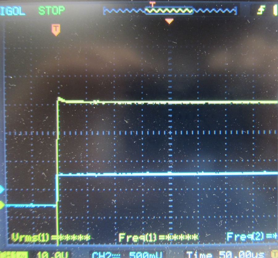

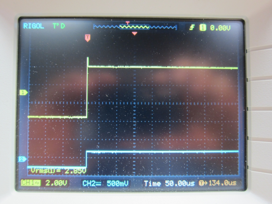

For sine and triangle waves, I increased signal generator output looking for ringing on the amp output, especially near peaks and saw nothing. So then I increased well into clipping and adjusted scope to display individual cycles. I didn’t think I saw anything on the sine or triangle waves and took a couple shots (photo 2 and 3). However, I will say that the horizontal portion of the clipped output wave did wiggle and quiver on the scope, but just barely. It was much more obvious in life than can be appreciated in a photograph. The digital scope, of course, gives us pixels rather than a smooth trace. But any pixel above the horizontal trace in the photo would disappear and then reappear, causing the quivering. This appeared extremely minor and I wasn’t sure if it was just noise. It was most apparent on the triangle wave in the photos.
Square wave showed overshoot, but not much else. (photo 4).
3 KHz was same as 1 KHz.

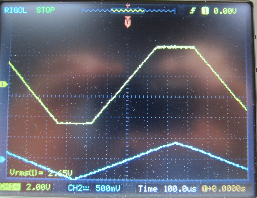

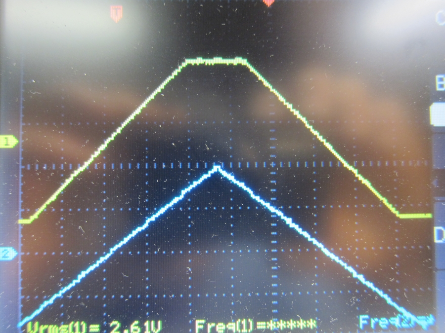

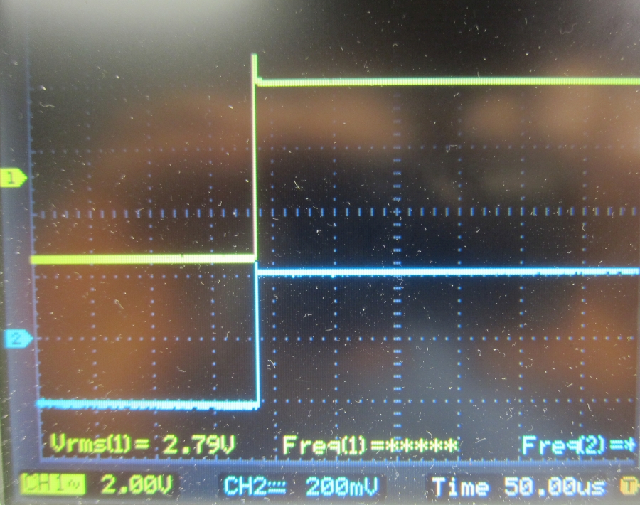

L Channel, same conditions:
Photo 1 is the sine wave. A bit more quivering than the other channel, but extremely minor. You can see what I mean by minor ringing on the clipping on the initial negative swing, if this is ringing.
The triangle wave was a bit noisier than the other channel, as well (photo 2).
And the square wave demonstrated overshoot again, and minor quivering during all of the duty cycle.
I repeated this on both channels using 4 ohm loads, and the signal was the same. Again, the same at 3 KHz as well.
Before I go on, I wondered what people think of these tracings. My initial impression was that there was little to no evidence of ringing, but I did notice the quivering and, of course, the overshoots on the square waves.

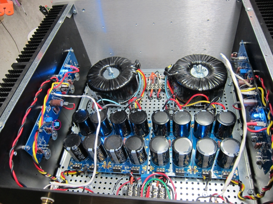

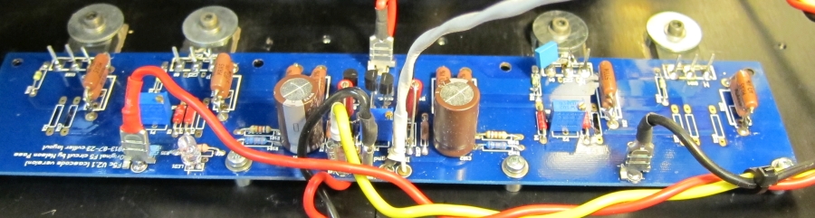

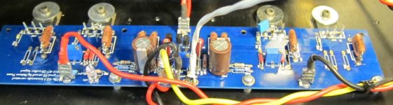

I continue my story.
Regardless of being unsure whether the slight quivering I was seeing reflected ringing or noise, I decided to increase stability of the amp, given loss of MOSFETs on two occasions and the overshoot on the square wave. In communications with 6L6 and Bear prior to taking these measurements, they also agreed that they would probably make some changes to increase stability if nothing definite was found on testing. I could add a 1 nF cap between the drain and just before a MOSFET gatestopper as shown on the F5 turbo V3 schematic (and as Zen suggested, Nelson also said that an alternate location was across the feedback resistors). I could increase the gate stoppers on the MOSFETs, and I had brought 220, 340 and 680 ohm resistors 1% tolerance to do that. Or I could do both. Given the overshoot on the square wave and the simplicity, I decided to add a cap on each board. I would run the waves through again and see what this first modification would do before taking further actions.
I had with me and used 1 nF film caps. The first photo shows installation between the drain and just proximal to the 47 ohm gatestopper on the same MOSFET. Photo 2 shows an entire board, with the cap on the second MOSFET from the right.

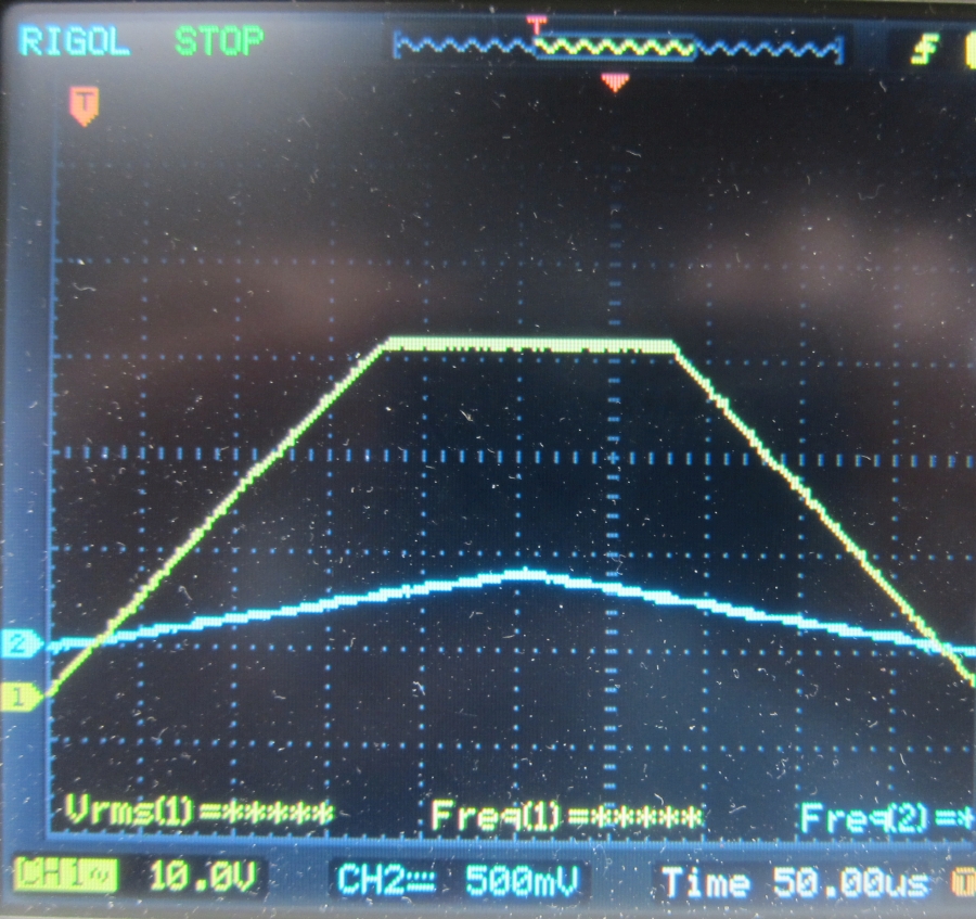

The results of this action were identical on both boards, the same at 4 and 8 ohms, and the same at 1 KHz and at 3 KHz. Photos 3 and 4 show sine and triangle waves during clipping, while photo 5 shows square waves.
All quivering had disappeared. These traces were completely steady. Rock solid. And the overshoot on the square waves was markedly attenuated. In fact, I had not realized how much of the quivering was present prior to the caps until seeing the trace with the caps in place.

That overshoot looks *very fast*... would be good if that scope had split timebase and you could expand the overshoot - measure the period so know the frequency.
I'd tame it... but it would be nice to know which side it is coming from. I'm guessing it is going to be the side that blew up. So, if you compensated that side, betcha it goes away? Of course for safety, you might want to make both sides the same.
But the same may not be the same numerical values for the compensation components. Might be worth looking at the spec sheets to see the gate capacitance. Usually one complimentary part is different than the other. Depends on by how much...
But, even after that, I'd do some tests as I described in PM, iirc, protect the devices, lower the B+ and try to do the plug in/out and watch for transients... at low enough B+ you will be well within the SOA of the devices so it will be less likely that a full bore parasitic oscillation will smoke the mosfets.
Otherwise, how will you be confident that you can use the amp without being hyper vigilant? And what about an inadvertent interconnect yank out?
_-_-
Edit: you posted as I was pushing the button!
I would compensate it slightly more - get that peak to be as close to flat as possible or just so slightly rounded...

Looking at the build, my instinct says to run the power to the board low along the chassis, then UP to the connect points from below. I'd likely run the input as short as possible and rather than out over the filter caps I'd run closer to the board, probably along the top and then to the input point. The speaker run I'd route as far away from the input JFets as I could make it go, and away from the input wires too.
Now the PS and speaker and input wires are no longer parallel and the speaker lines are not near the input circuitry at all.
This might alter the way the square wave looks - but it might not.
It may help the stability.
Another consideration is how the boards "find" PS ground... how that is routed, and how the input ground finds the PS ground too...

Oops. I see my error. I should have added two caps per board, not one cap. Can't imagine I missed that, but you can see I am striking matches while walking through the dark on this. I needed one cap for N-channel devices and one cap for P-channel devices, though the single cap on N-channel devices appeared to pretty much take care of the issue, and I lost an N-channel device this time and two of them last time. Still this is a mistake on my part that I will need to address. Now I understand your comment, Bear.
Wow Steve, you are not sitting on your hands I must say...
But it is interesting that it works so well just with one capacitor - it seems to suggest that one would need to investigate the CLR loops and find the best possible way to tame it. Any way we can get the frequency - it could easily be close to mhz range...
