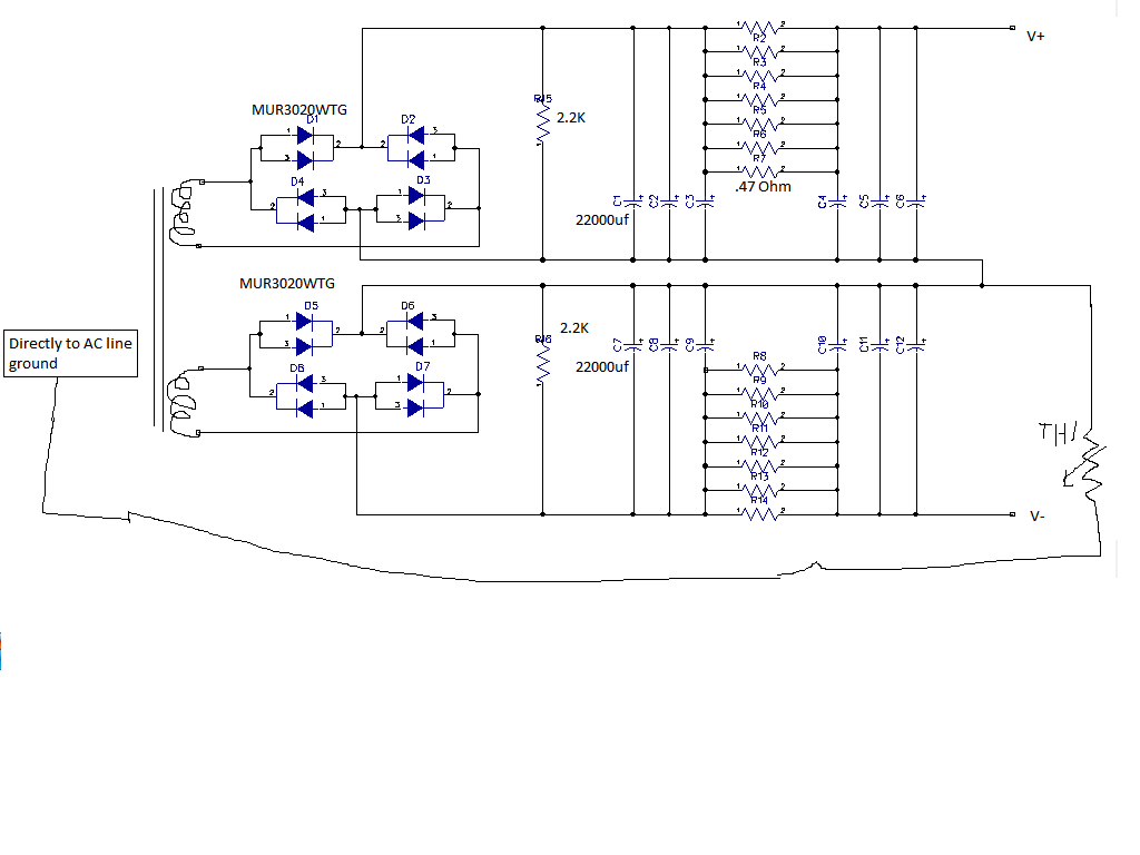

1. can you please let me know if there is anything wrong with attached circuit. This is for f5 Turbo. Anything additional required before connecting to ground?
cap - each 22000uf, resistor values mentioned in attachment.
2. Assuming both left and right channel can be connected to same PSU unit shown in attachment without any issue?.
3. Have another question on transformer
I have one toroidal 800VA
Two primary 0-120, 0-120
secondaries 0-24(400VA), 0-24(400VA)
There is one green wire that says "shield", does anyone know what is shield for?
Thankyou for looking.

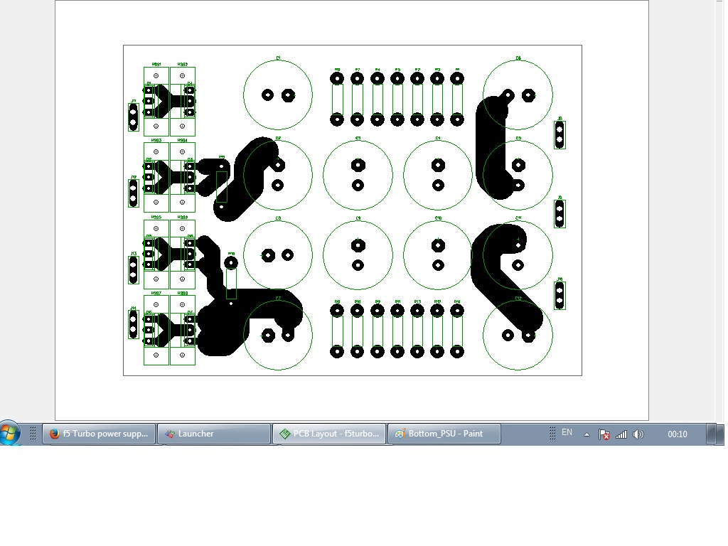

f5 Turbo power supply?

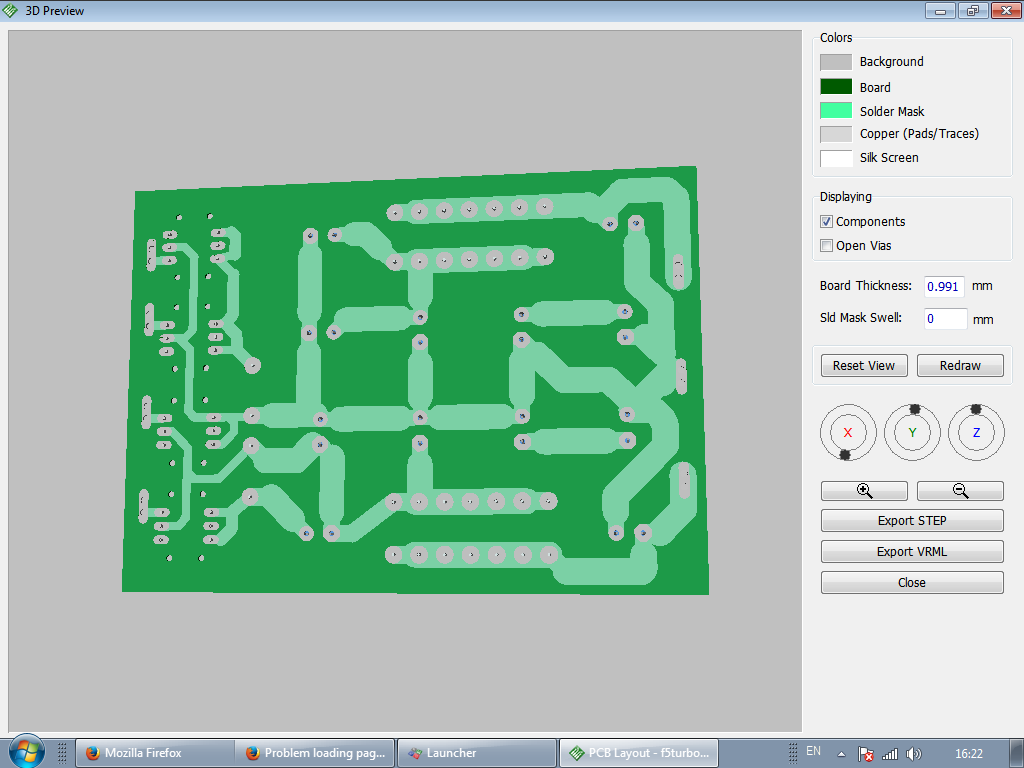

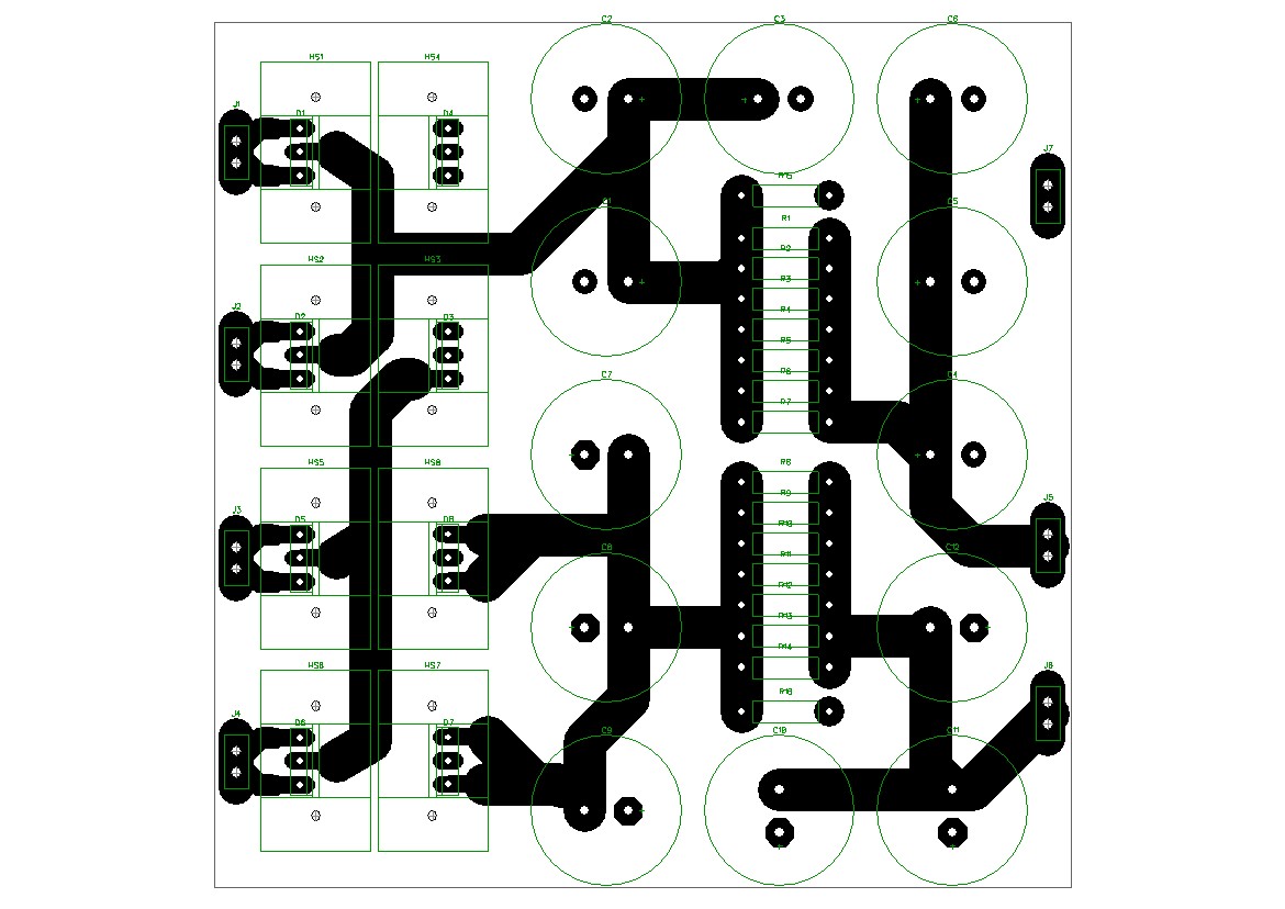

Attached is just f5 power supply with MUR3020WTG diodes. I have made board since i wanted to use 12 caps 22000uf.
Anyone who has experience with PCB designing can please provide you inputs if you see anything wrong. Please check images.
Thank you in advance.
Those traces look extremely thin.
Charging currents tend to be very high and you don't want too much loss on the board (some is inevitable).
We normally try to keep track width at least 200 mil or more in this kind of all-in-one board. Think of using more planar areas and doubling tracks where possible on both sides of the board.
Similarly for the diode boards, run the inputs and outputs on different layers, or the negative and positive supplies. You will have more board area to work with.
Also recommend using a stop mask on the copper so you can solder a bus bar, in case the tracks cannot be widened further. For this the tracks need to run straight instead of this convoluted manner.

I have widened tracks.
small ones are 8mm thick
Big ones are 15mm thick
is that fine?
If you look at images, is it an issue how close tracks are?
If yes i'll reduce thickness or redraw them.
Thankyou for your inputs.

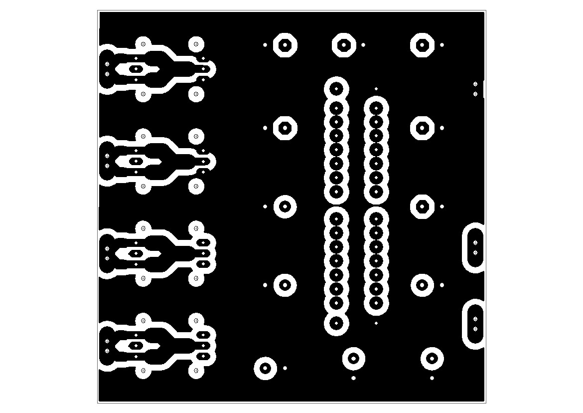

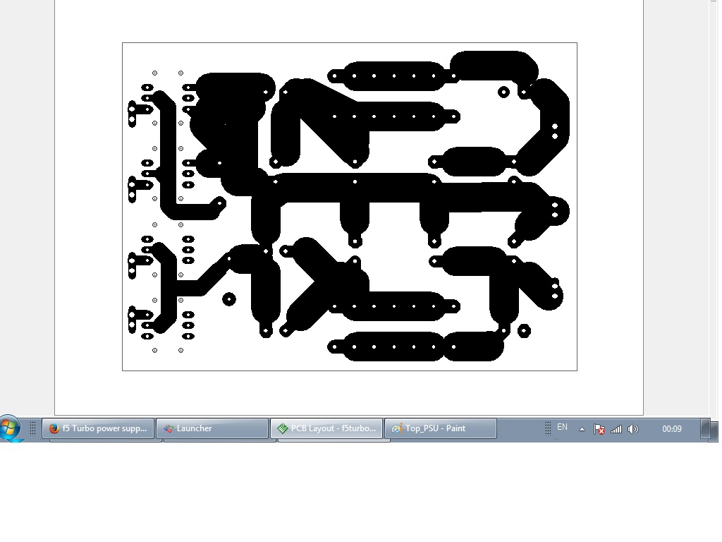

change in layout
Due to space constraint there was need to reduce size so i have to go for another layout. After going through few posts its recommended to use one side as ground so doing that as well. Attaching new layout please let me know if you see any major flaw.
All tracks are 10mm wide and the ones that are 5mm wide are laid on both sides of pcb.
Is using copper pour(to have wide copper paths, non uniform shapes) instead of traces good idea(referring to top side)?
transformer has 4 wires 0-24,0-24
when using a capacitor as smoothing one brings the input to the cap lead as near the capacitor body as possible. One then takes the output from the cap lead as near as possible to the cap body.
The effect of this is that the internal lead inductance is shortened and the smoothing performance is better, particularly at the higher frequencies.
If one uses multiple capacitors to form a capacitor bank, one must do the same.
Putting a capacitor out on a long trace along which the current must flow in and then out increases the inductance and could potentially ruin the higher frequency performance.
Redesign to minimise the trace impedances.

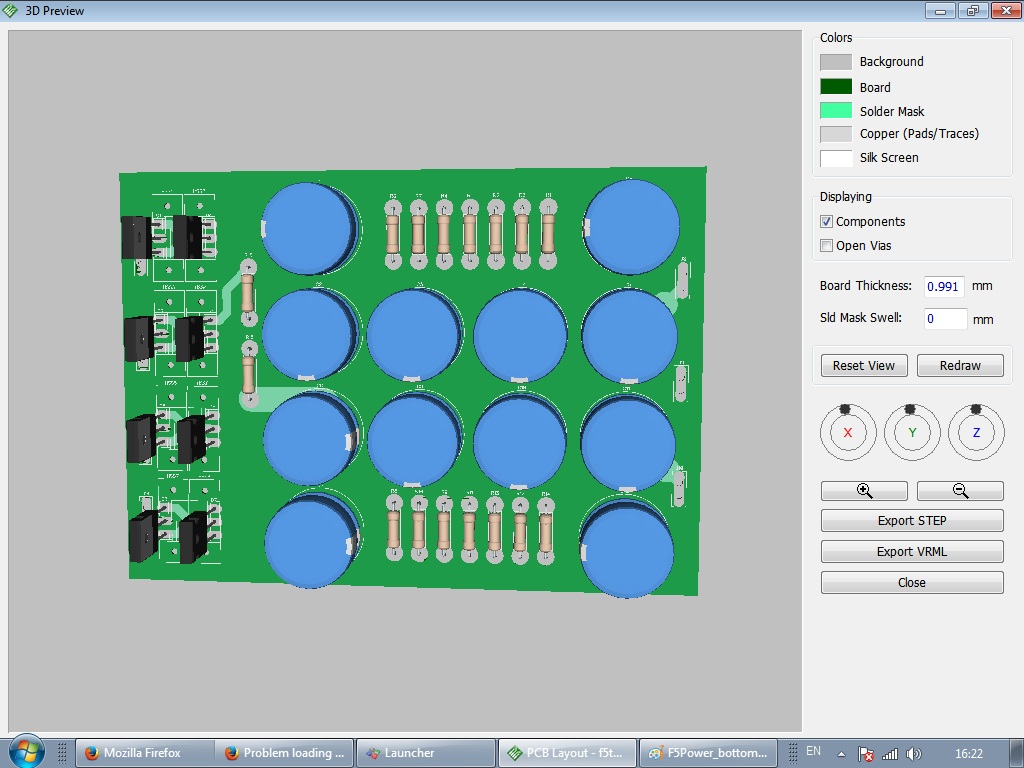

If you're trying to squeeze 12 caps onto a small PCB like that, I would suggest not using the resistor pads at all. They are going to consume a lot of space and are forcing you to orient caps in the L shape and the squiggly tracks.
When we face similar situations we basically solder the resistors under the board, directly to the caps' pads. This will help to line up your ducks, so to speak. For even tighter spaces you should forgo the board entirely and use point to point wiring. A PCB is not strictly needed for simple circuits like this.
As to your other question, I usually bolt the diodes directly to the case floor. You can achieve the same mounting method if you use a 90 degree aluminum angle and bolt the diodes to it. Obviously the diodes will be mounted to the bottom of the board if you choose this method.

Have one more question
How much capacitance is good, PSU page says 80,000uf or more(so i added 12 22,000uf) ?
what is the benefit of adding more capacitors, i can add more but is it worth the price that goes into caps?
The shield is likely between the primary and secondary windings. It is normally connected to earth. Functionally the shield reduces the capacitive coupling between the primary and secondary and thus reduces the mains power high frequency "hash" that would otherwise be coupled to the secondary winding.
regards,
Rick
regards,
Rick
