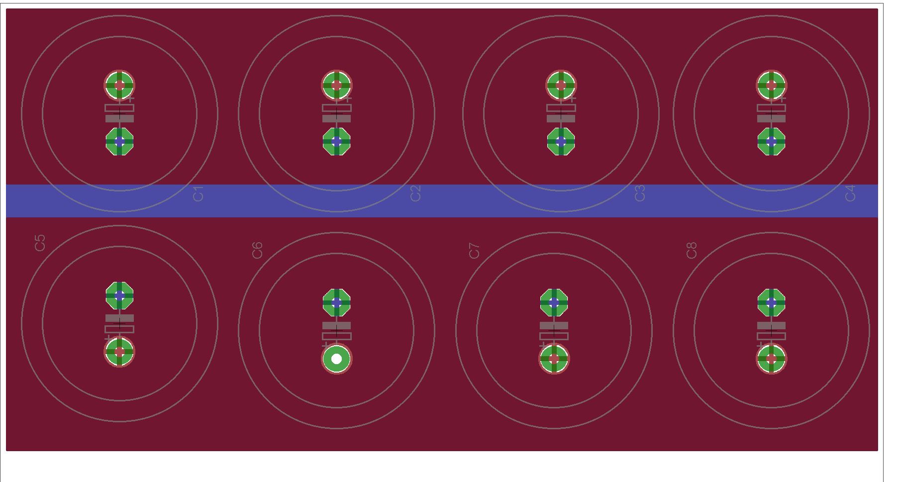

Here's an rough-and-ready example created in 5 minutes in Eagle for you to start from. All the alignments are slightly off, this is just conceptual.
Notice each cap is connected to alternate layers for rail and return. I drew the returns on bottom layer and the rail on the top, but in your case since you will need access to the rail layer, you should flip them over.
The drawing program should automatically know where to connect each component depending on how they are joined in the schematic, including your quick connect tabs.
Note bottom layer is a continuous unbroken layer from the top left corner to bottom right corner.
Please check cap polarity.
Top row of caps is input.
Lower row of caps is output.
You do not want them to be closer together as that will couple the input to output at higher frequencies.
There will be resistors between the two rows, under the board.
This is one power supply rail.
Will have to be duplicated for other rail.
Besides there are a few unconnected nodes etc, this is a pictorial example not the final layout (hopefully).

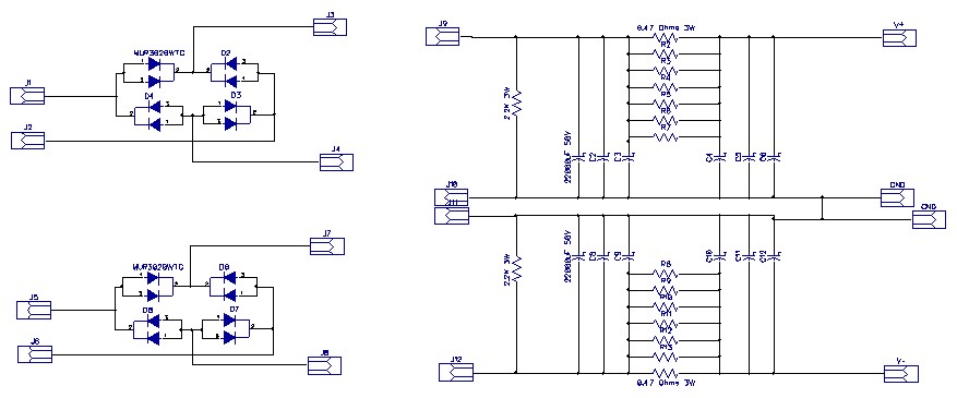

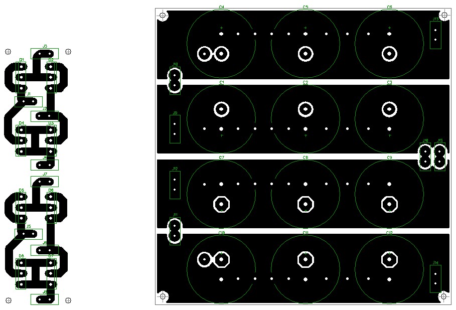

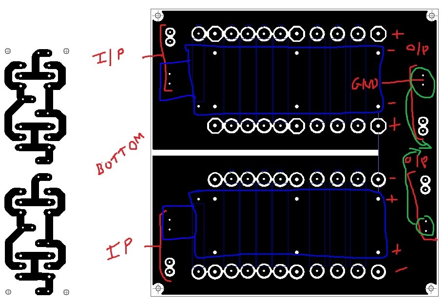

guys blame it on me for not posting detail information. Please check images.
Tried what i wanted to achieve
1. Have thick tracks.
2. 0V tracks below supply tracks(Top are supply and bottom is all 0V plane)
Please have a look and let me know if i have made any mistake like before(post#27) or a new one 🙂
- Planes have 3mm seperation
- 1mm gap between pads and planes, let me know if it is too less.
- cap/resistor pads are 6mm dia.
Thankyou Marce, Sangram and Andrew for helping me with this.

Hi CJS
You can simply take the ground output from the joint between the two return planes topside. No need for external joining.
I would also suggest flipping the two planes, with the rails on the underside and ground topside. This will make the process of soldering the resistors easier and prevent the chance of accidental shorting the pads to the ground plane.

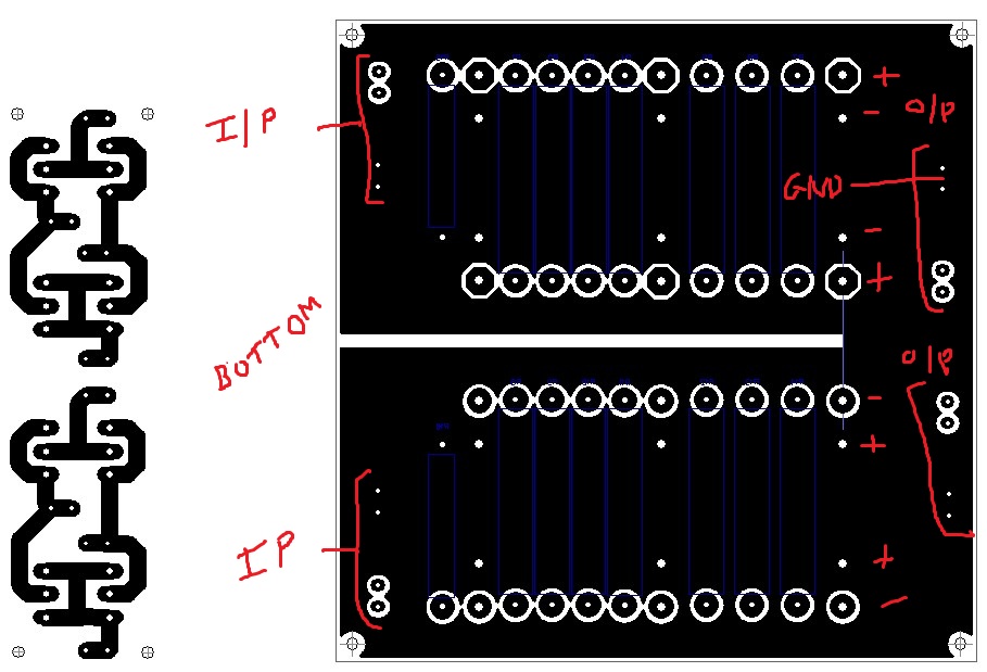

Hi
You can beef up thermals like the attached. NOTE: Track is not routed anywhere, it is drawn for reference only!!
I do that by routing the tracks first, then making the plane and connecting it to the respective net. It is possible with a thick enough track to totally eliminate the thermal, I do this for lugs and tabs which are basically lumps of metal and do not mind a few extra seconds of soldering heat.
For anything that needs higher current, I try to reach a decent balance between current capability and thermal relief. Often a hybrid model works, where one side (solder side) is relieved from the plane and the other side (component side) is used for the track.
Since Ground planes are already joined not doing any external joining.

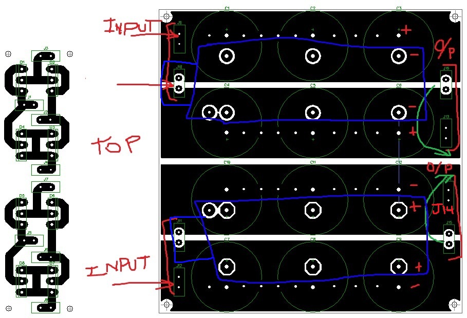

I see 4 tabs on the output side, 2 connected to the ground plane and one on each output rail. Were you planning to take the supply common of one channel from one tab and the other for the other channel? If so, you will have severe crosstalk issues because the return currents for each return will be totally mixed.
Move both ground tabs to the middle, so the current flow equally in both directions. A few mm of separation is not a problem but the 3" or so you have now is quite bad.
Right
Not sure if i got you.
J13 (+V, top only)
J16 (Connected to ground/0V plane , bottom)
J14 (-V, top only)
J15 (Connected to ground/0V plane , bottom)
Now my ground/0v plane is at bottom and connected towards right side(output side at bottom).
(J13,J16) goes to one client circuit
(J14,J15) goes to other client circuit
current return paths are separate for each client circuit and merge at bottom right side of 0v plane.
If i move the ground connectors to the middle(marked by green arrow) i will be moving away from blue rectangle, isn't that bad ?

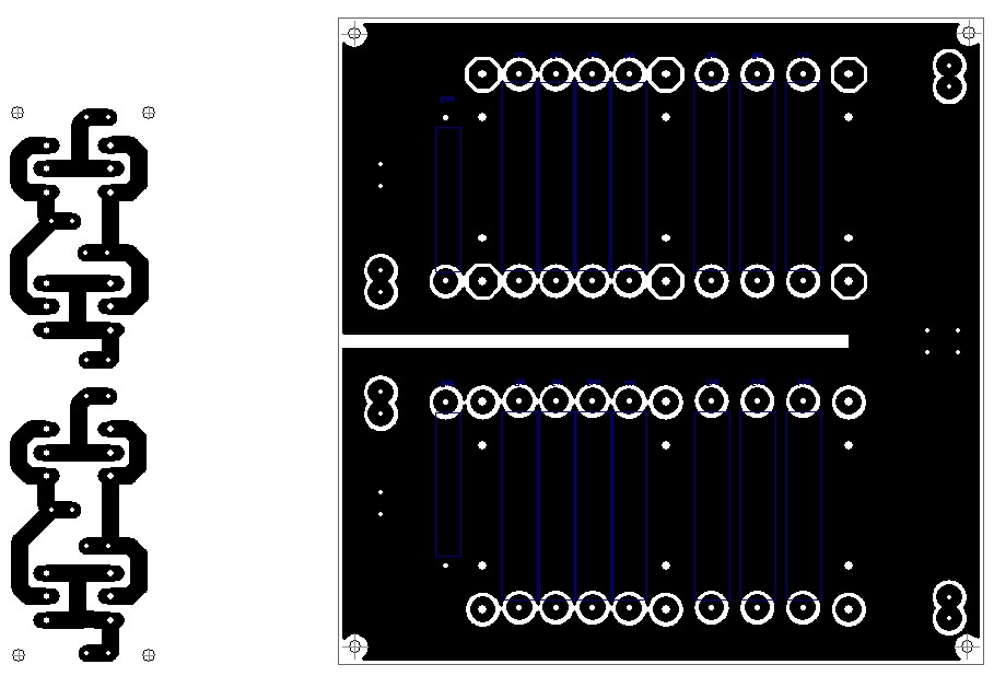

Hi CJS
Are you taking a four-wire power connection to the amplifier or three-wire?
If you are taking four wire connection you need not connect the two halves of the return plane together (as they will be properly merged on the amplifier PCB) and your connection method is fine.
If it is a three-wire connection, then the 15/16 should move to the middle/between tab 13/14. I would also (personally) simply merge the two return planes together in such a case, creating one large continuous copper area.
Hi CJS

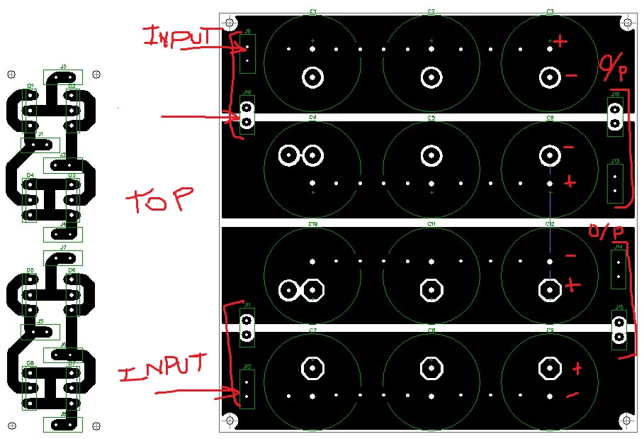

Sorry for messing up.
Making it 3 wire.
Moved J13 (+V, top only) and J14 (-V, top only) to corners and J15,J16 (GND/0v) close towards middle.
-Two wires from J13 will go out , one to left channel and one to right channel
-Two wires from J14 will go out , one to left channel and one to right channel
- Two wires will go out from J15, one to left channel GND, one to right channel GND and J16 to thermistor > mains supply earth ground.
Also signal input GND will be connected to J16

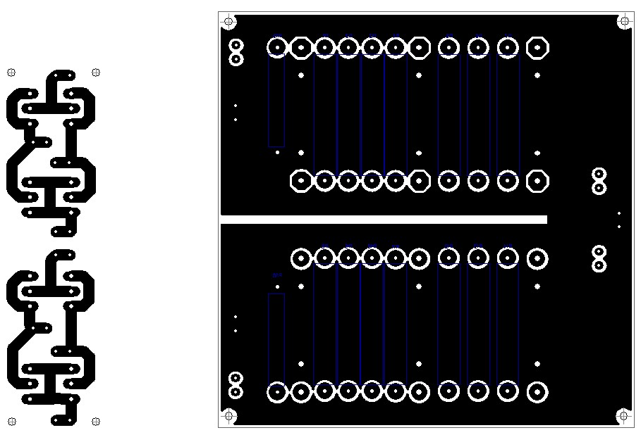

Hi
I wouldn't flip input and output like that.
As has been said by Andrew before, you need to keep loop area small. Loop area is the physical distance between currents, and this is a function of PCB routing - not the schematic which is more theoretical. For example, in the schematic you can connect 'ground' anywhere, but in a PCB the distance between - and size of - traces makes a material difference in circuit operation.
Which means you should just put the rail output tabs close to the ground tabs. The input side was also okay earlier, the only change required was to put the ground tabs where you have them now.
Hi

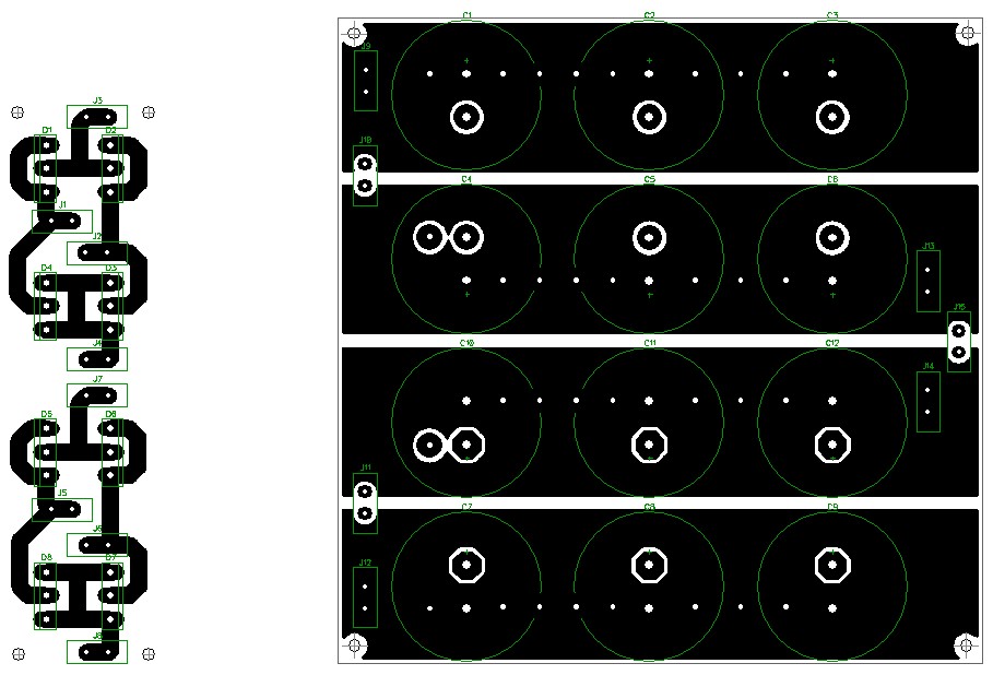

Reverted to where i was earlier, just moved (GND/0V) tabs to middle.
it was getting congested, so removed J16, all GND will go out from J15.
Looks okay to me, you can crimp two cables on each connector with no issues, I do that all the time.
Don't forget that you should be moving the rail side to the bottom (ground planes are topside) to make soldering of the resistors a bit easier. It is manageable both ways though, you can execute as per your wish.
