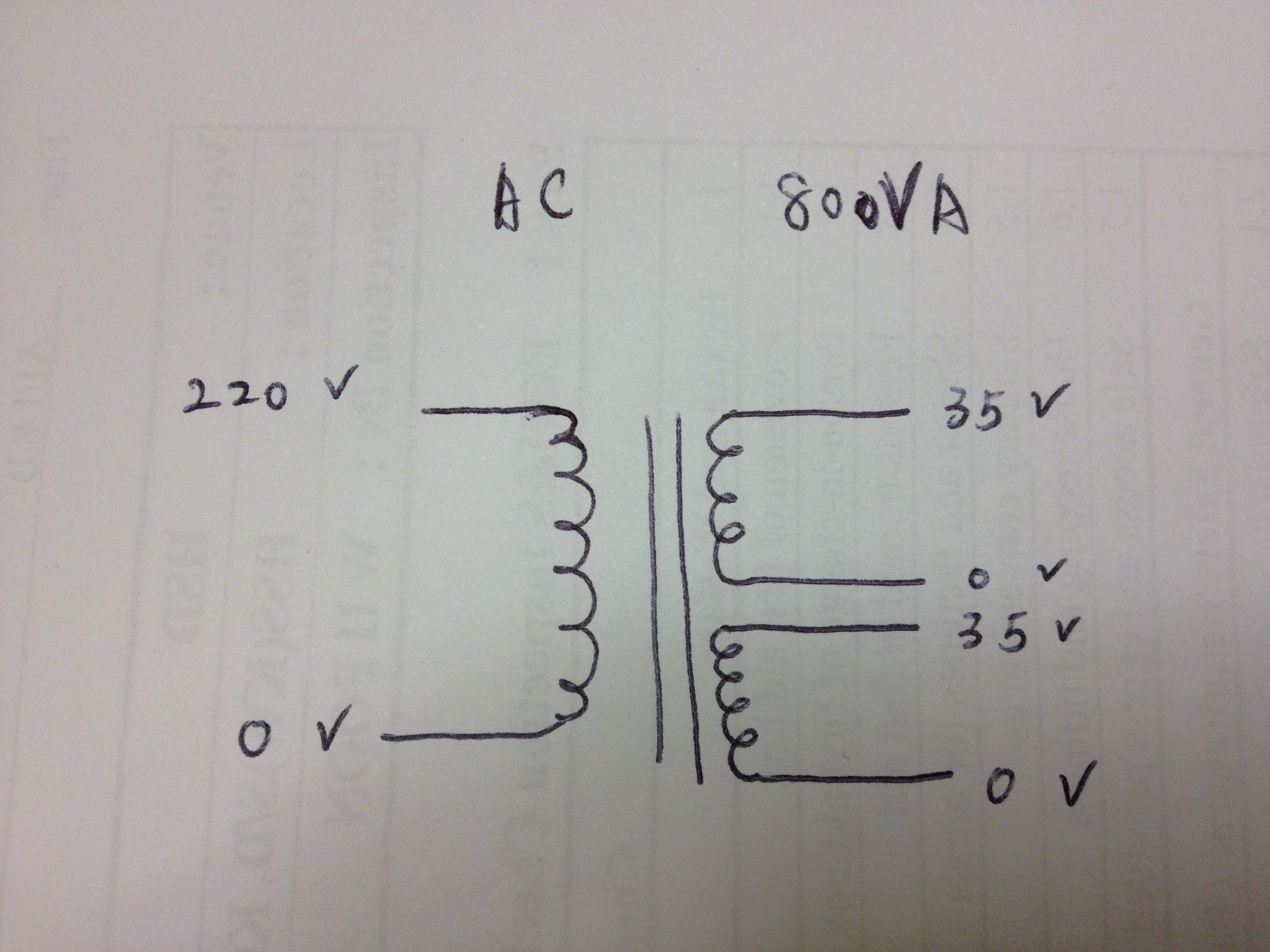

Because my power transfomer output have daul AC 35-0-35, So hwen i apply to F5 circuit, after regulator, DC have +- 48V , so how can i do?you can't have +- AC voltages.
what do you actually have?
A DC, or dual polarity DC, or AC, or dual AC?
That's better, Now you make sense.
I shall re-state and you can tell us if that is correct.
Transformer is 800VA 35 +35Vac
Rectified output on your mains supply is +-48Vdc when on zero load (open circuit).
Or, you have a two channel regulator to bring the voltage down to 48Vdc?
The F5 runs on +-25Vdc

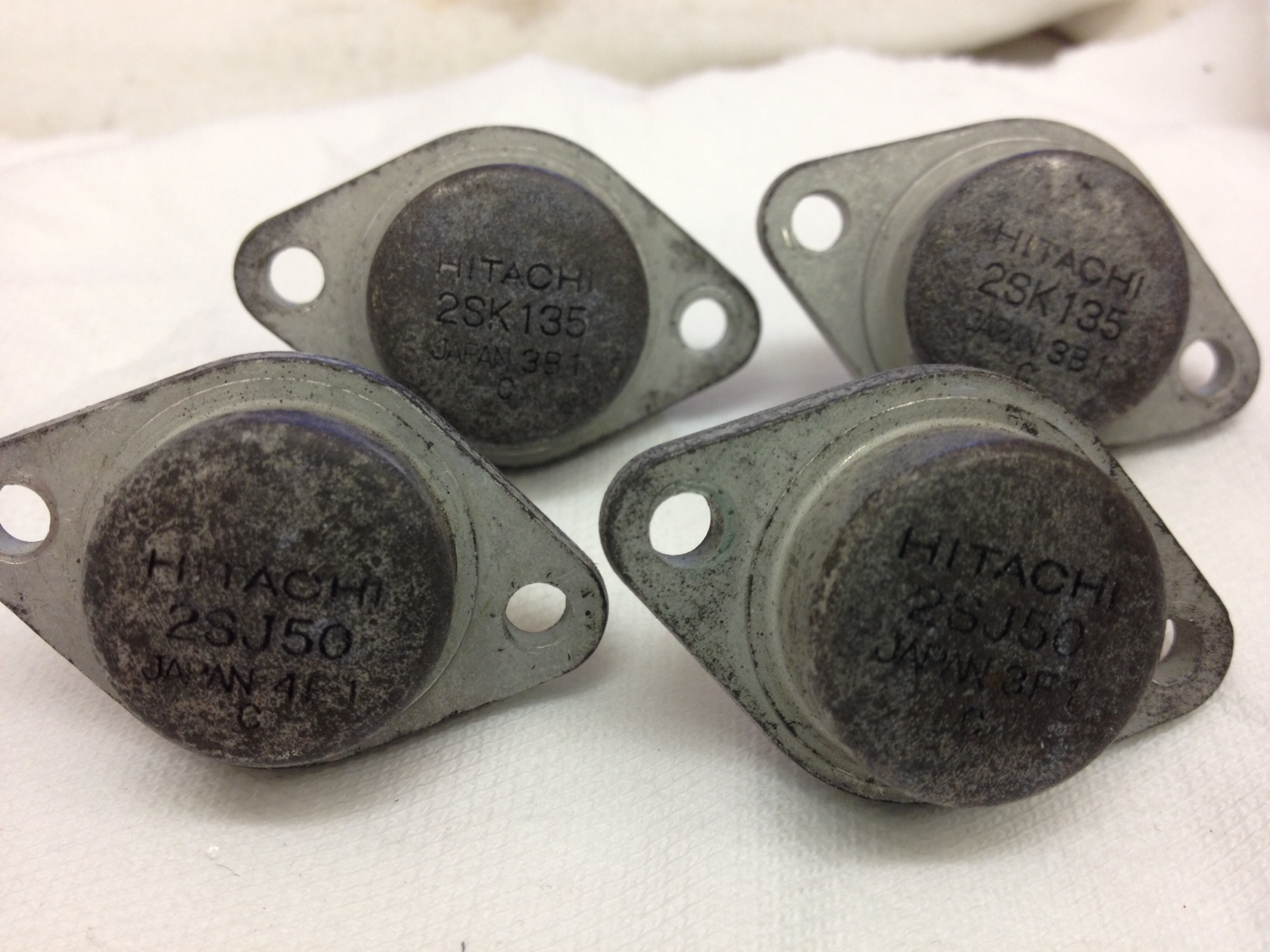

Other things, Could i use Hitachi 2SK135/2SJ50 to replace FQA12P20/FQA19P20 ?
On my hand have 12 pcs per each Hitachi FET
The Hitachi are Lateral devices.
Read up on the comments from Members on altering the F5 to lateral outputs.

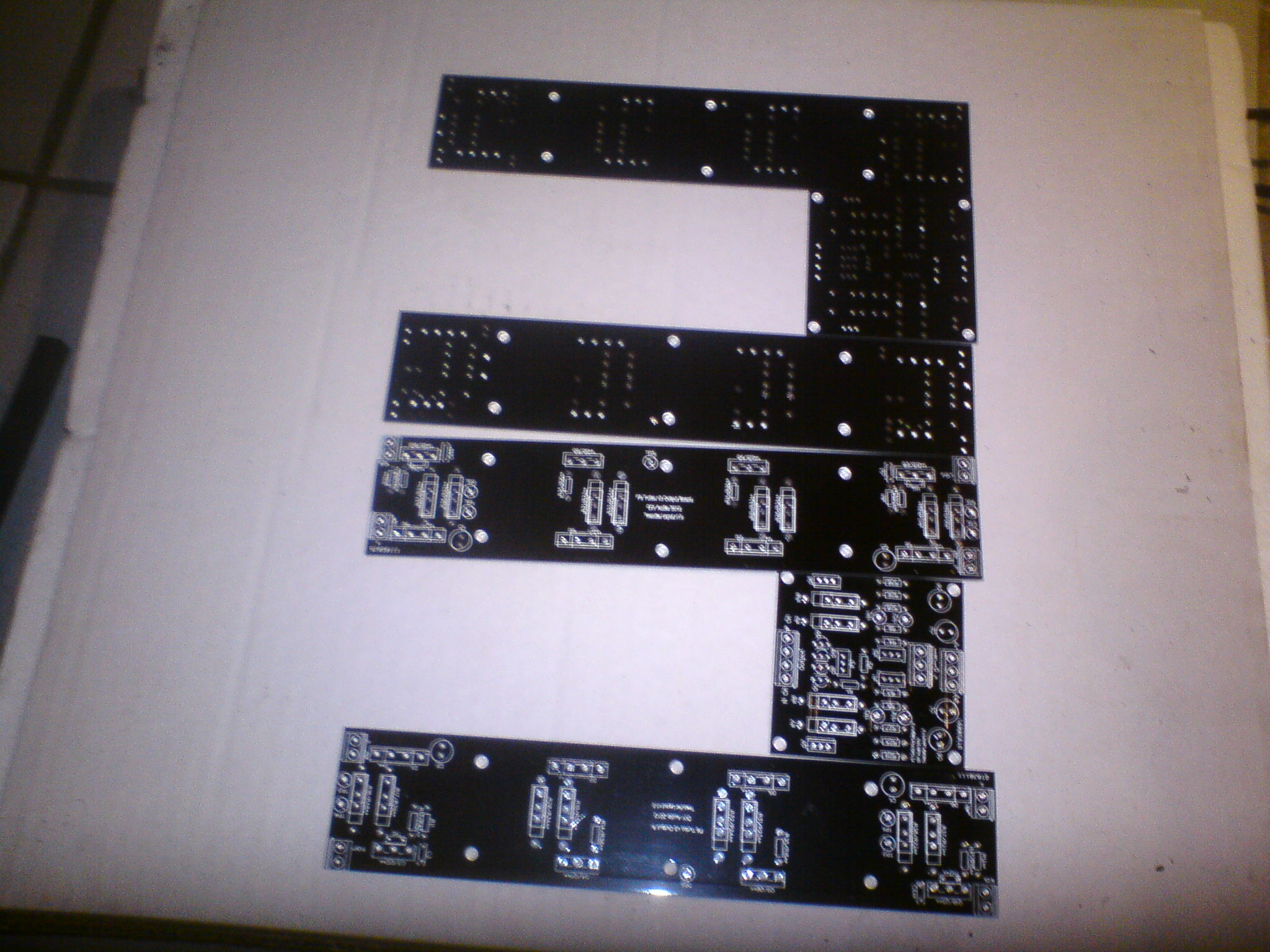

Hi Everyone,
Hope I'm not bringing up a sore subject, but how are the F5T boards coming along?
Any plans for mono block boards?
Also, if you were to make a F5T board for mono blocks, how would boards be configured?
For instance, if you are using a standard case with heat sinks on each side, how would the boards be configured? Would you use an input/driver board attached to the base plate and feed power and signal to output boards via wire or a single board spanning the space betweem heat sinks? One board would lock you into a particular sized case, right?

All the F5 PCBs I have seen on the Forum are for single channel.
There are none that are for stereo.
those are (allmost) the boards that will come in the store.
as far as i know, the output boards will be split in 2.
this is the UKToecutter's prototype turbo V3 boards.
