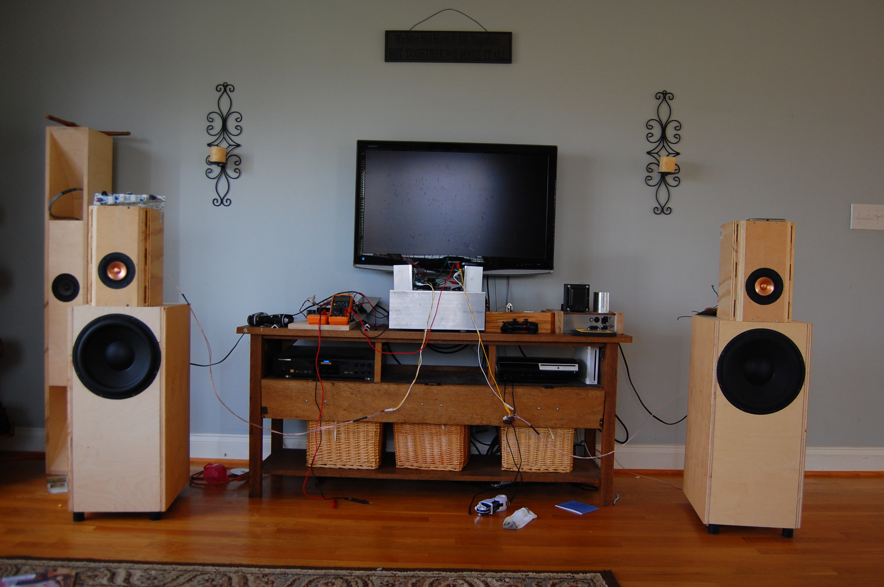

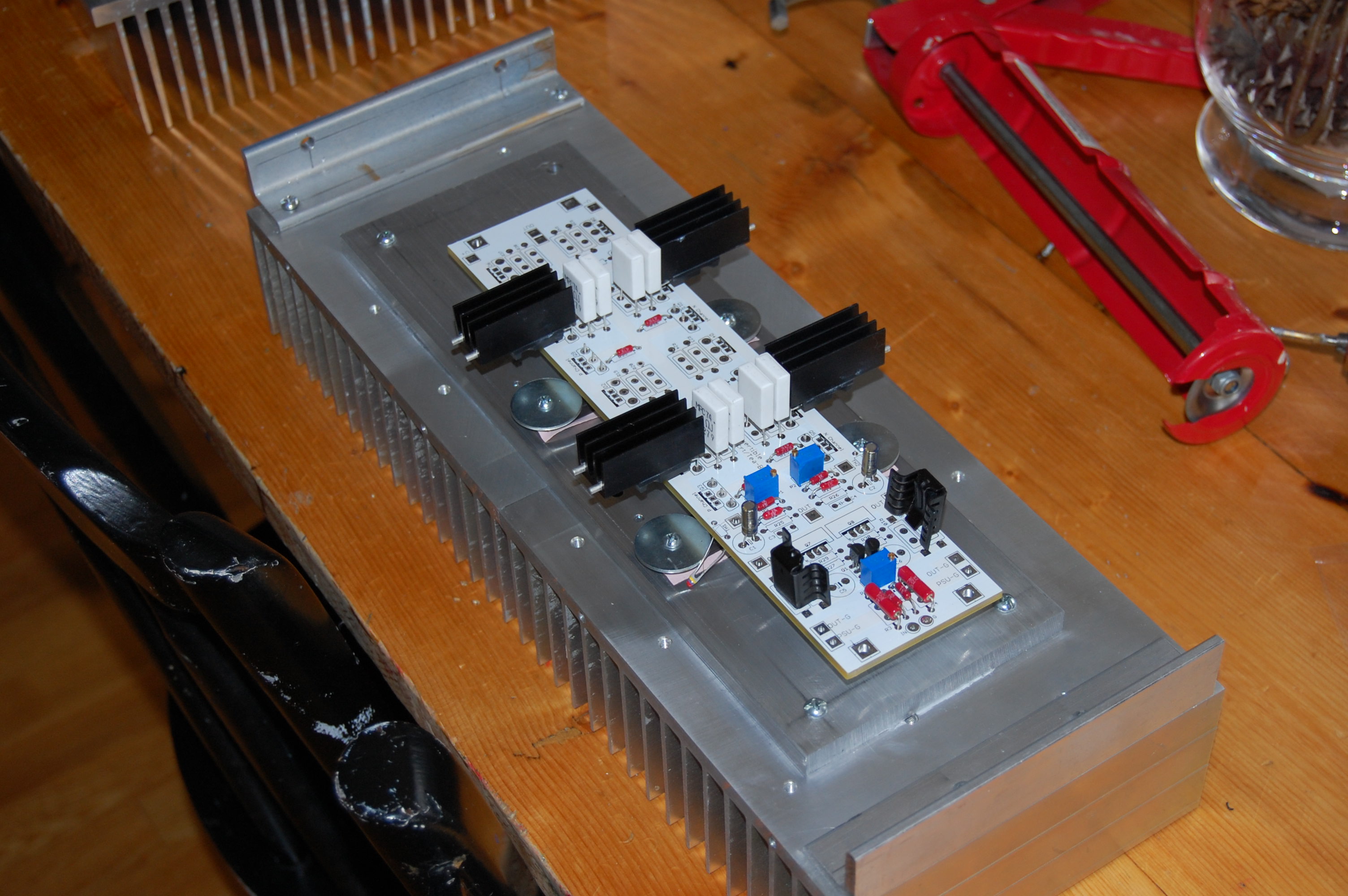

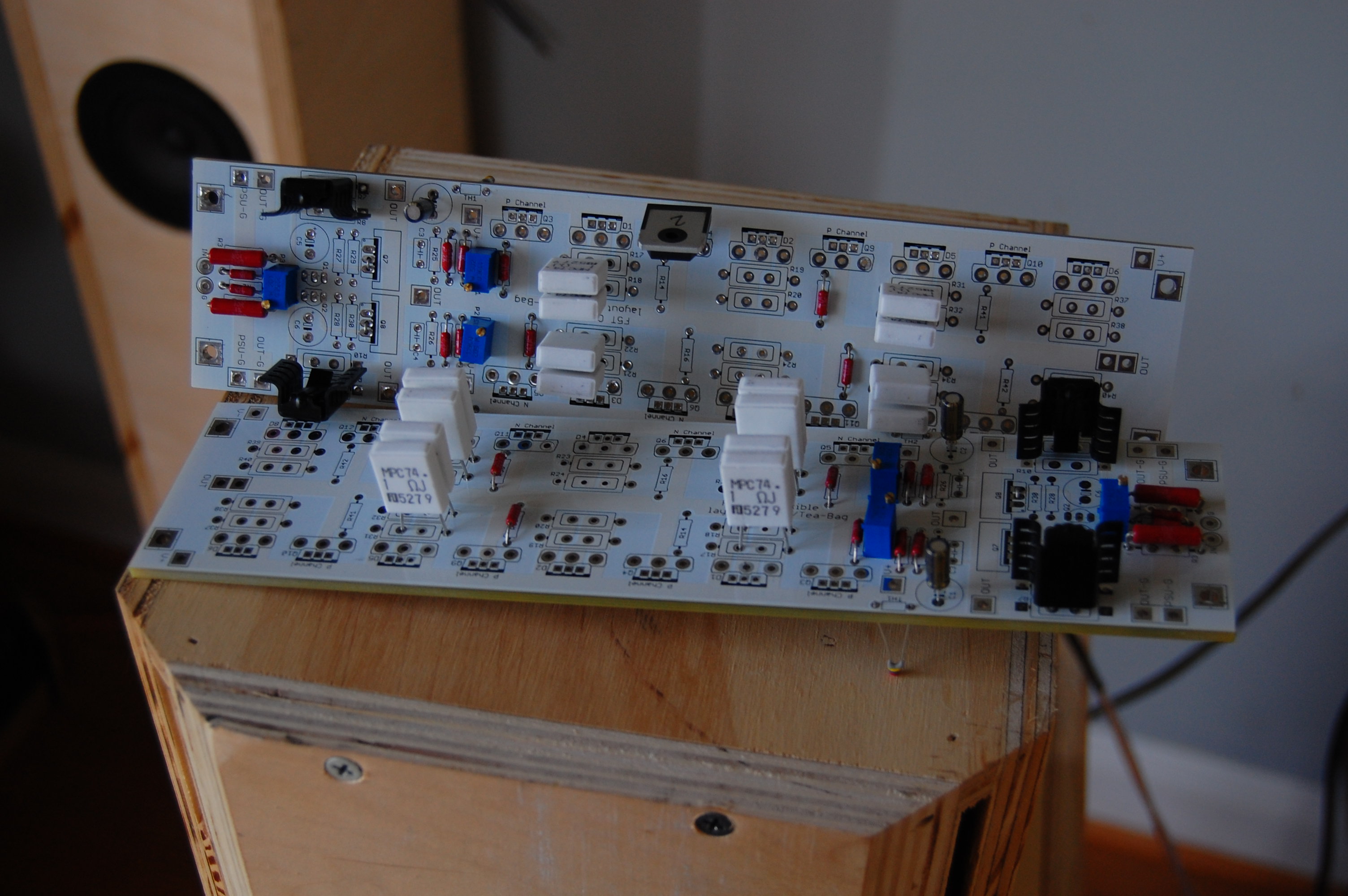

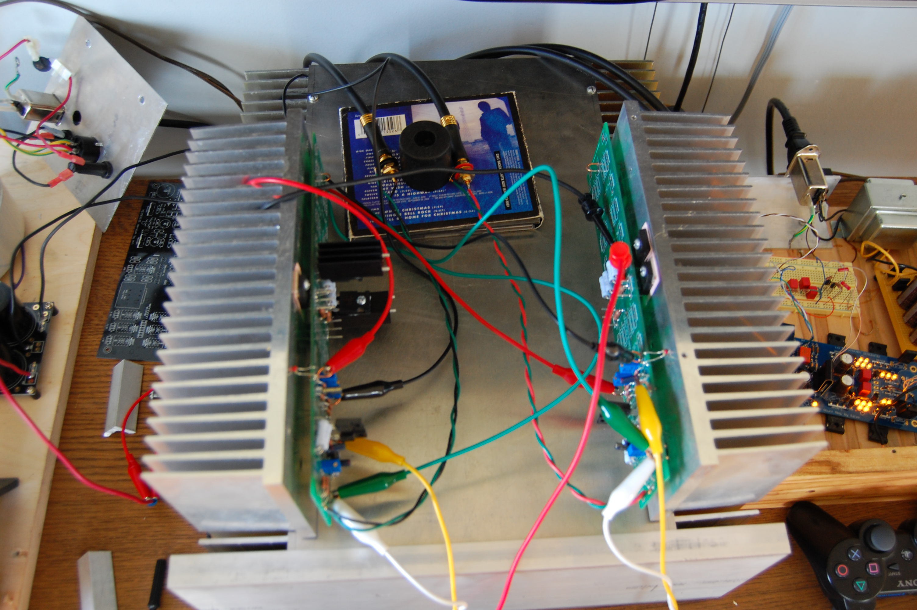

Here are some pics. My system driven by DCB1 into B4ish Xover and on into the dual F5t's. Also some pics of F5t noards with kit components as well as his proto boards. proto boards show diodes mounted both ways, on and off the sink. THis single pair unit was able to drive the 12" woofers you see to high excursion without the fee standing diodes getting warm. Heat is not an issue, but consistency of temps may be. dunno. Hope to listen to nicer boards tomorrow. Getting fet kits out has me busy with little time for listening or playing.

You can see TeaBags baords in the picture. They have the mosfets spaced at the Store's universal mounting distance of 40cm. They have the diodes mounted in between the fets at same spacing. If all are devices are mounted on a sink, then you have a device every 20cm. I have chosen to mount the diodes off board, as heat has not been an issue. My final plan is to have a copper bar connecting them all before being attached to their individual heatsinks to act as a spreader and also for thermal tracking. I am not sure if you can mount all 8 fets on a single sink, run at 1a bias, and get away with it without a fan. Best chance would be to mount them on a heat spreader attaching two sinks together like mine. Ill try to post idea for dual mono later on.

Just now completing the thought process on the Hotrodded DCB1 buffer. A heat-spreader like yours (or copper) will be a must on that project, since the transistors don't reach the heatsinks.

regarding the diodes. i think its a little stupid way to go with fet, diode, fet, diode. you will not get any symetry on dual sinks.
a better way will be fet, diode, diode, fet🙂
