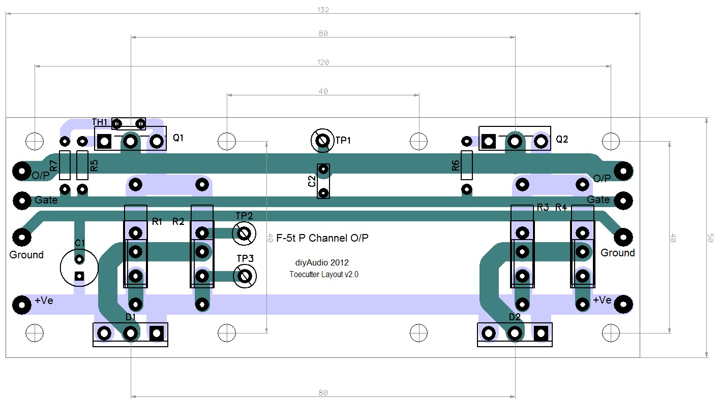

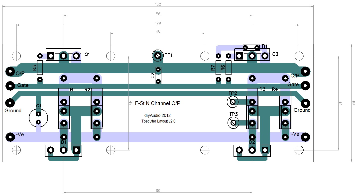

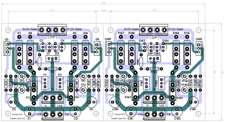

The boards will not be all one board. There will be a gain board with 2 channels, and N output boards and P output boards. Each board has 2 MOSFETS and 2 diodes. For the big diyAudio 5U x 400 deep chassis you can put two of the boards on each side, ie 2 P's on one side and 2 N's on the other side, or one P and one N on each side.
This is quite versatile as you can make mono-blocks or 2 ch amps,
With 2 output devices per side or 4 per side.
And they all bolt onto the drilled tapped holes on the diyAudio chassis heatsinks. the chassis' will be in stock in the next week or 2 .

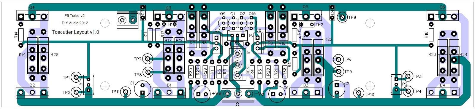

here is the boards🙂 gain stage board is breakable so it can be used in monoblock.
for 2 ch you need:
V2: one dual gain stage. 2x P ch outputs. 2x N ch outputs.
V3: one dual gain stage. 4x P ch outputs. 4x N ch outputs.
EDIT: don't mind the marking error🙂
for 2 ch you need:
