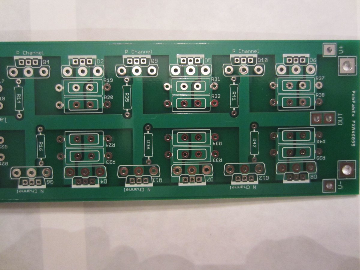

My solution to that - build a board that will do both...
TO-220 front, backTO-3P/247 packages.
Also using Vishay U30DCT diodes in smaller package as an option.
I think bias levels may have to suffer, but with adequate sinking and attachment to sink, its possible. The actual part inside the packages are very small, so it's about spreading drain heat afiak. Otherwise the FQP's make equal spec part (except dissipation) and are still available, not obsolete etc.

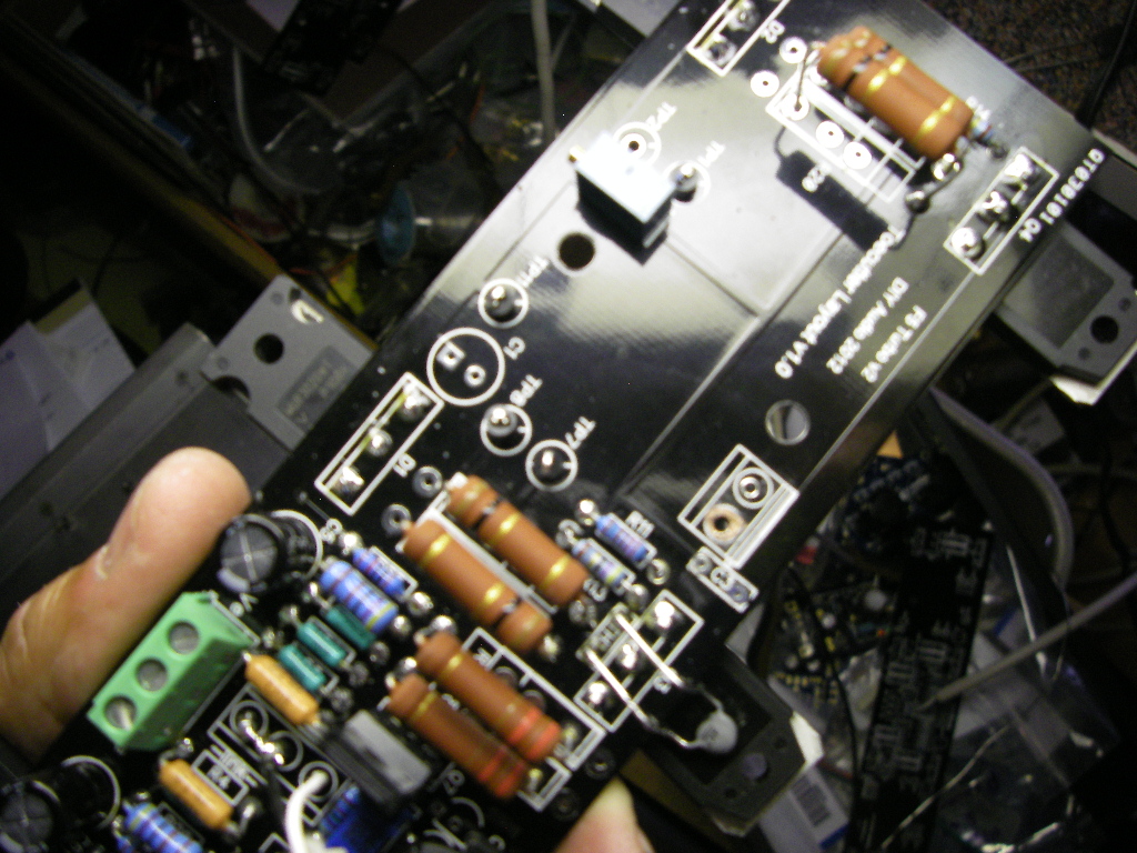

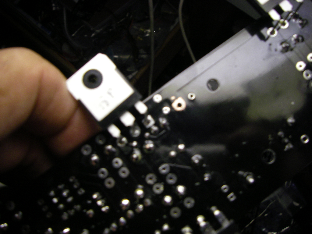

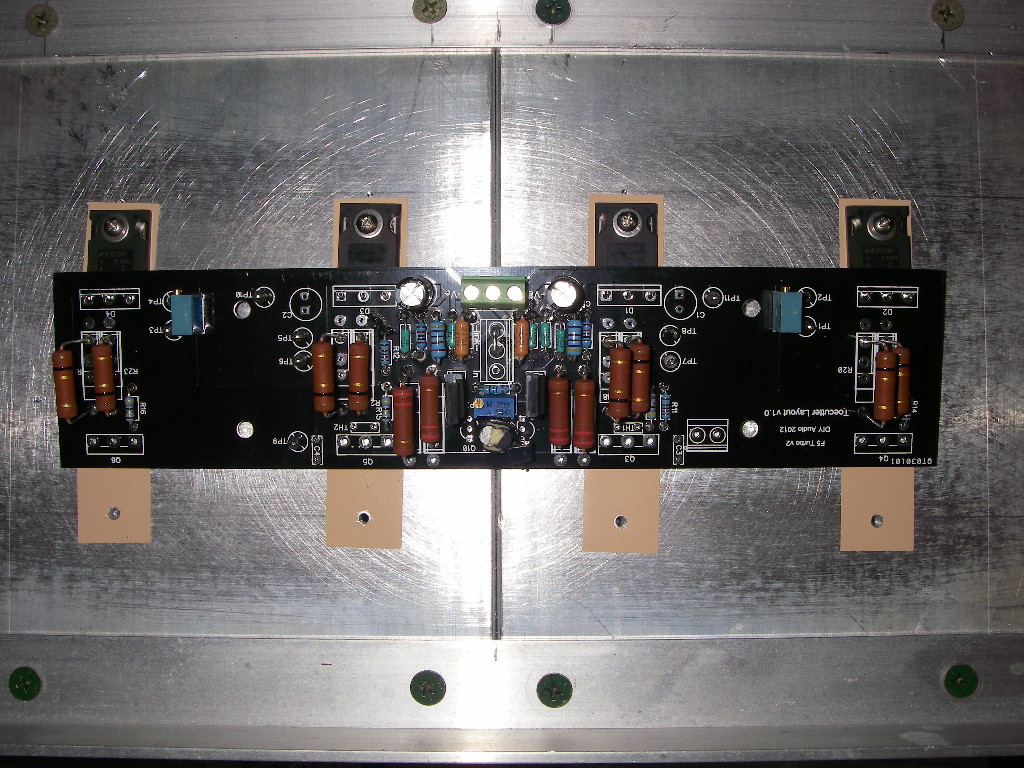

The build continues
Got more done today (hope the boss isn't reading this).
Put all the transistors and diodes on the board and heatsink.
Didn't want to use a terminal block for the speaker output so I had to drill the hole out to except 14 gage wire (5/64" drill), then had to scrape the black paint off so there was something to solder to, front and back, as the drill cut all the tinned copper away.
Second thing, the input ground, again not using a terminal block and I had previously soldered the jumper wire, no place to solder the input ground. I did solder it to the jumper on top, not great, but will do. If I was smart, (and we know I am not) I would have used a longer stripped piece of ground wire and run the end up through the second hole and then soldered it.
Andy I would recommend a third hole for the ground; one hole for the input ground wire and two holes for the jumper, even if you use a terminal block, this is easier than stuffing 2 wires in one hole.
