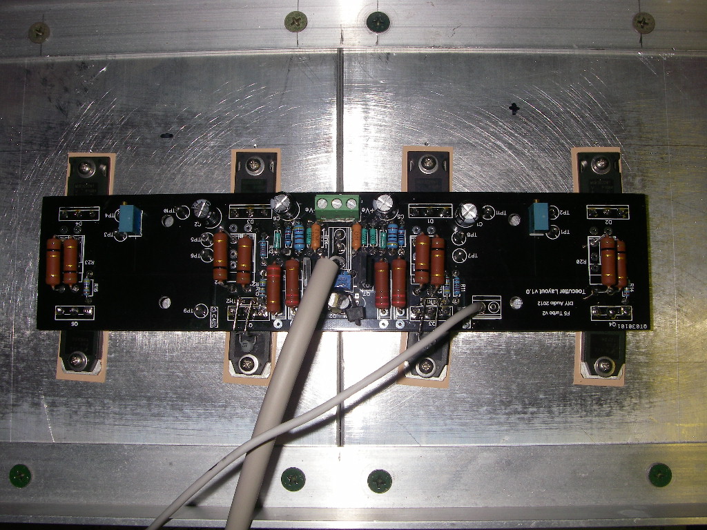

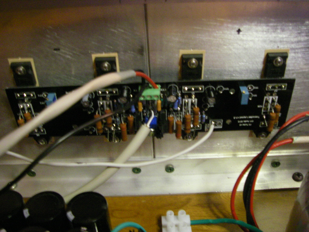

Had an issue with the cascode transistors.
When I first powered the amp with my variac, set on the 2.5 amp fuse, no bias could be set. I was pretty sure where to start looking. Checked the data sheet on the 2SC4793 and sure enough the emitter was not pointed at the JFET source, DOH! Either I don't know how to install them or they are marked wrong on the board. The back side should have the double line right? I believe they are marked wrong on the board, Andy. After trying to fry them (it didn't work) I had to unsolder them (awful job, pulled up 2 traces) and put them back in hoping they were OK, they are OK. The amp pass' a signal too!
It biased up just fine the second time. Set at .3 VDC.
Being a prototyper I should have checked everything first, but I only checked most things, not everything! DOH again.

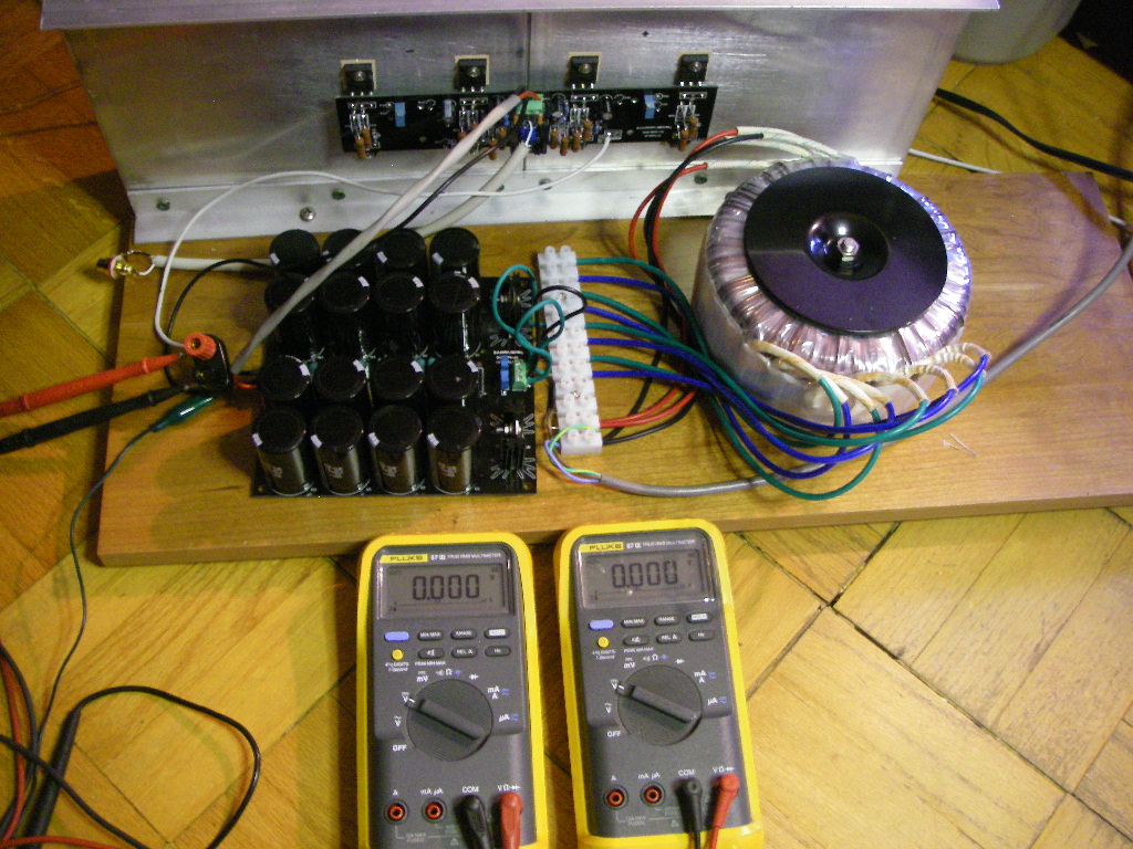

I am running 33.5 VDC on the rails and the heatsink isn't getting that warm, but it has only been on for about 20 minutes and biased at 2.4 amps total, which is all a standard F5 runs at.
Let know if you have any questions.
I fretted over drilling and tapping the heatsinks, but that was an easy job. I drilled the pilot holes all the way through (broke only 1 drill bit when it exited the side of a blade and no tap was broken because I only tapped 1/2 way down the hole). I used fairly short #4 - 40 screws.

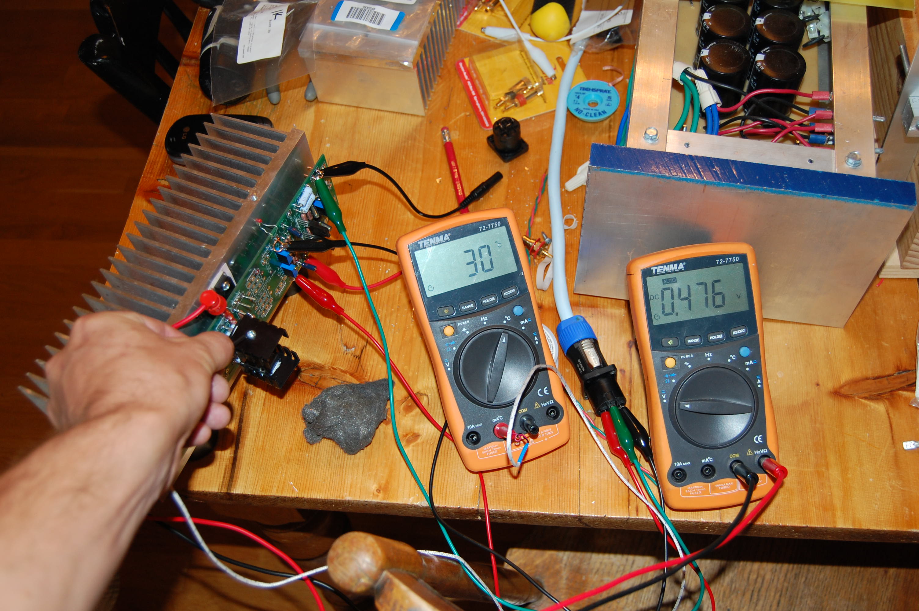

Put the diodes in and fire it up and just see hoe hot they get with just a small hearsink attached. Mine didnt eben get real warm in free air with no heatsink. If you consider their very poor ability to dissipate heat into free air with no heatsink, then you realize they are not putting out hardly any heat.
It could be argued, that if you want to hear the effects of having the diodes, you have a better chance of doing so with less pairs, where it is more likely they will push beyond their bias point. This assuming you are not driving big or inefficient floorstanders. In that case you will probably be using them regularly.
At idle, with diodes on cheapo 25C/W+ heatsinks, I can get the bias up to almost 1A (.485 across Rs and diodes)before they start to want to jog a little. This is with the little heatsink sitting at 31-32C. All the little heatsink is doing is keeping it from having to dissipate in free air, not much more. The large heatsink are at 42C roughly. I will mount the next version with diode on main sink, which will raise the temp on it and we will see how that affects bias point. Next I will run a signal through it into 2OHM load to push it and see what happens.

I am just seeing about general settings here. when i run it with a load, I will have it set much lower. I will try it at .450 in open air. I am trying to push then to see when and at what temperature they will react at. After open air test, they will go in a case. BTW, I had them over 1A bias and stable, in open air, but that is just playing with fire.
Andrew, they are not biased beyond their passing or they would take off, correct. I am still below threshold, although on very shaky legs.

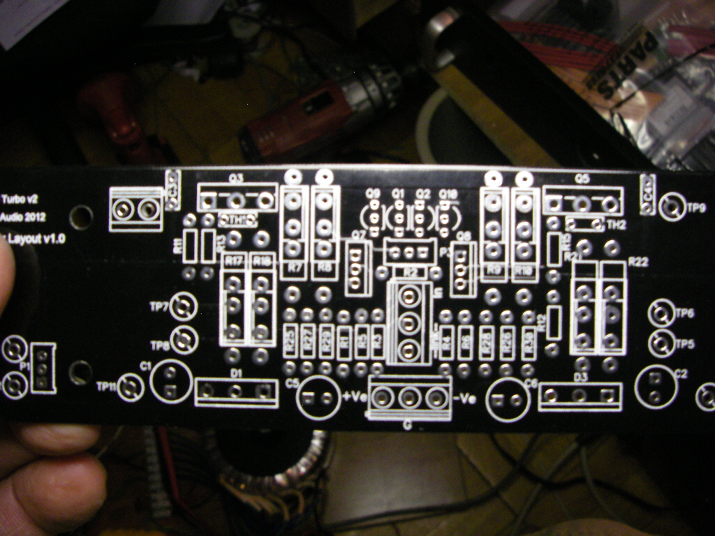

If we are looking down on the boards in the linked photo, as far as I can see Q5 and Q6 are still wrong. The double line is on the wrong side. The Emitter should point to the JFET's Drain and they don't. I had to draw them on a piece paper and turn it upside down to make sure.
I put them in according to the graphic on the board and had to unsolder them in the prototype V2 boards and turn them around.
Secondly there are not enough ground holes. The link hole has no open ground hole to link to. Input ground wire, power ground wire, Link to where? double wires in one hole?
One more thing, in this new version, where is the hole for the speaker output? All the O/P holes in the input board are full, you wouldn't want to take the speaker wire from the N or P boards. You should connect the speaker wire to where the N and P boards connect together, at the input board, right?.
