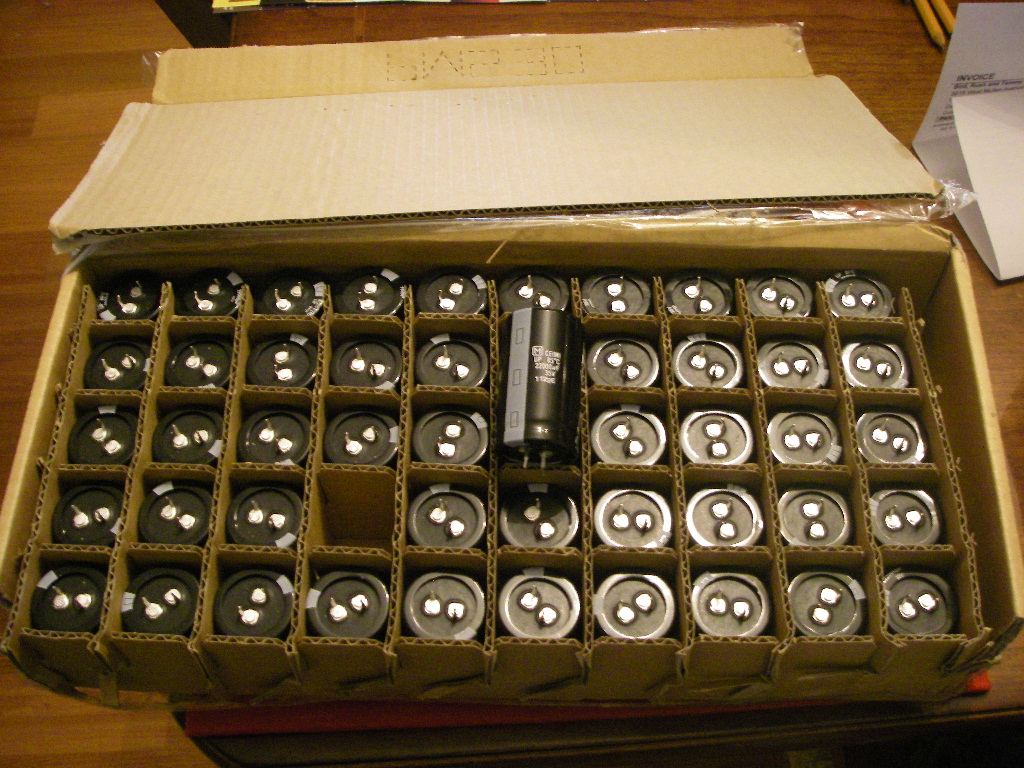

I had no takers on the mini group buy. I needed 48 caps to complete all 3 power supply boards and was willing to split 100 each pricing with someone, but I couldn't stand to pay $4.73 at the 25 each price.
What to do?
I waited till they were open and called them today, let them know who I was (small fish) and asked them to give me better pricing on 50 than the 25 pricing. She asked me what I had in mind, I went for broke, $3.29 each I said (the 100 each pricing) and she said OK. I got 50 at $3.29 each.
Thought I would share this with you guys, it never hurts to ask when you have a larger quantity.

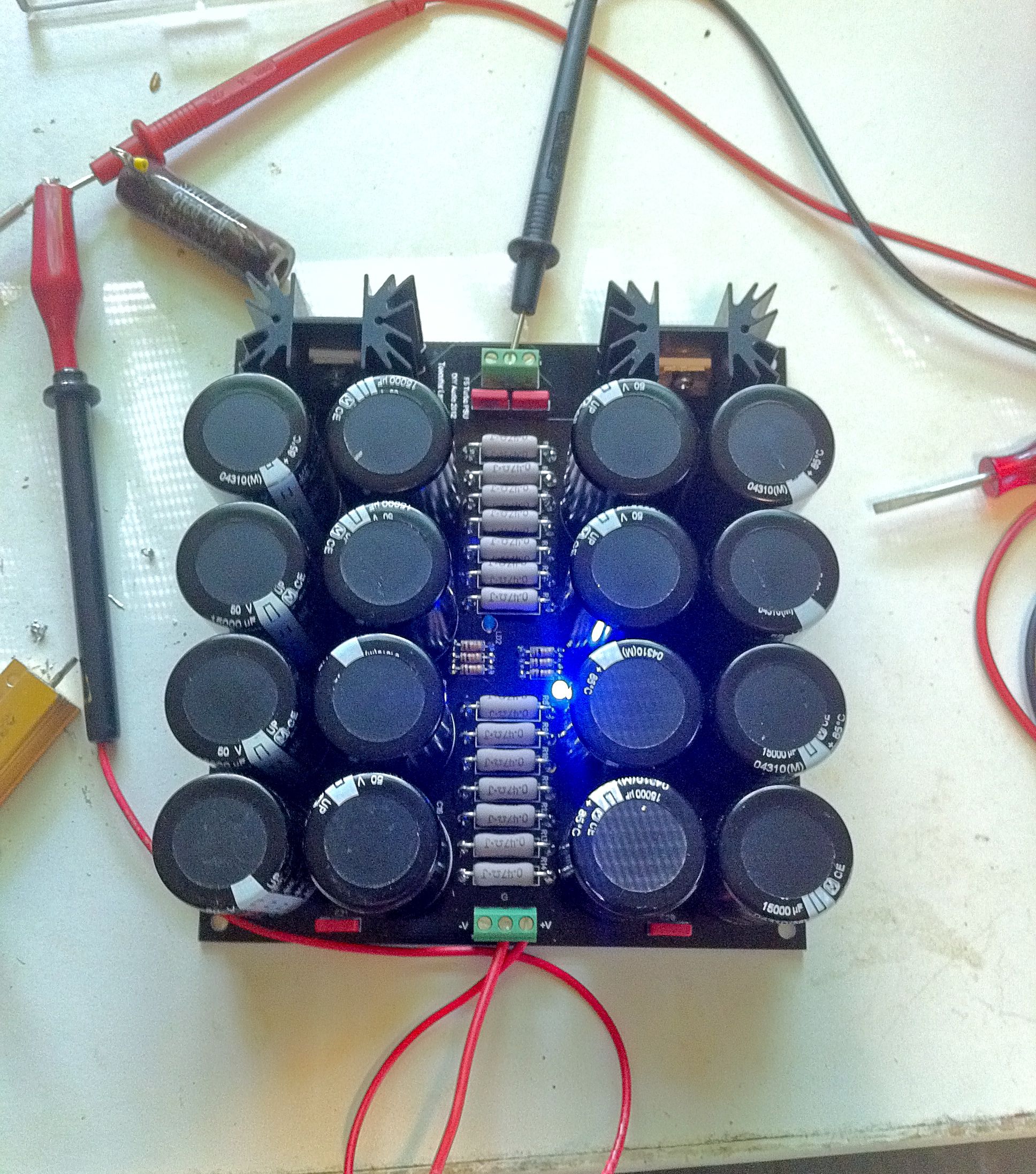

PSU Board is built. Currently reforming the caps as it is obvious they were on the shelf for a while at the distributer.
Assembly was uneventful. It's a very compact board so stuffing in order of smallest to largest was important.

I noticed there isn't a drain resistor on each rail like the F5. I was going to add a small one in place of C20/21.
What resistors are appropriate for the LED at 32 VDC? I was not sure, but I think they run at 20 ma, so 1500 ohms?

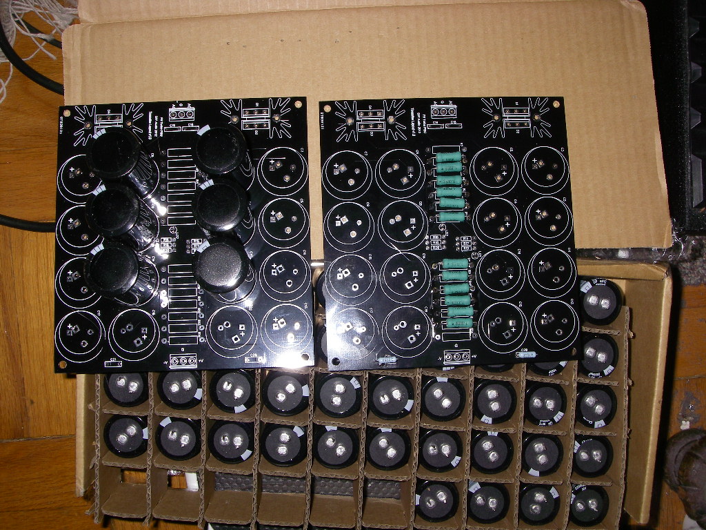

Partially stuffed PS bords.

That was the one thing I was going to comment on- the lack of bleeder resistor. I'm just gonna tack on a 3.3k 5w to each side. No big deal.
I am using three paralleled 10k for the led. Value chosen to give about 10mA at 33v rails.
The led is still pretty bright at 10mA.

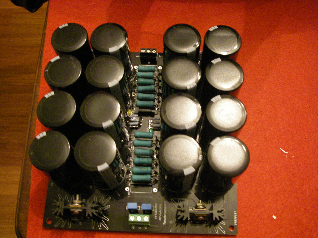

Couple of things before I forget.
In the BOM R25 and R26 should be equal values. For a 32 VDC +/- rails the values should be 10k ohms and R27 and R28 should be somewhere between 4.75k and 10k ohms. Depends on the idss of your 2SK/2SJ. I am using 10 idss because a have a bunch in that value and the cascode will allow me to use them here. I will have to pull R26 and replace it with a 10k.
Second thing the board needs 2 pairs of AC inputs. Not many transformers with high amp secondaries will be center tapped. I bought an 25 volt AC Antek 1000 VA with 4 secondary windings and will have to make up the pairs on a terminal block and jump to the PS board.
Third thing the 3P fixed terminal blocks are way too small for the transformer secondary windings. Wont come close to fitting, when I jumper to the PS board I will have to use 14 gage wire.

I have been doing some work on the PSU to accommodate 35mm and 40mm snap in caps and will be replacing the terminal blocks with high current pub mounting screw connectors that will accept ring or spade connectors.
Can you guys comment on the drill holes. Are they all ok?

The drill holes are on the small side for the 1/2 watt resistors. The larger resistors are fine on both PS and V2 boards. The snap caps snap right in and hold great while you solder them in.
