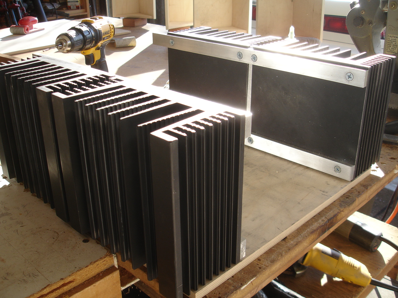

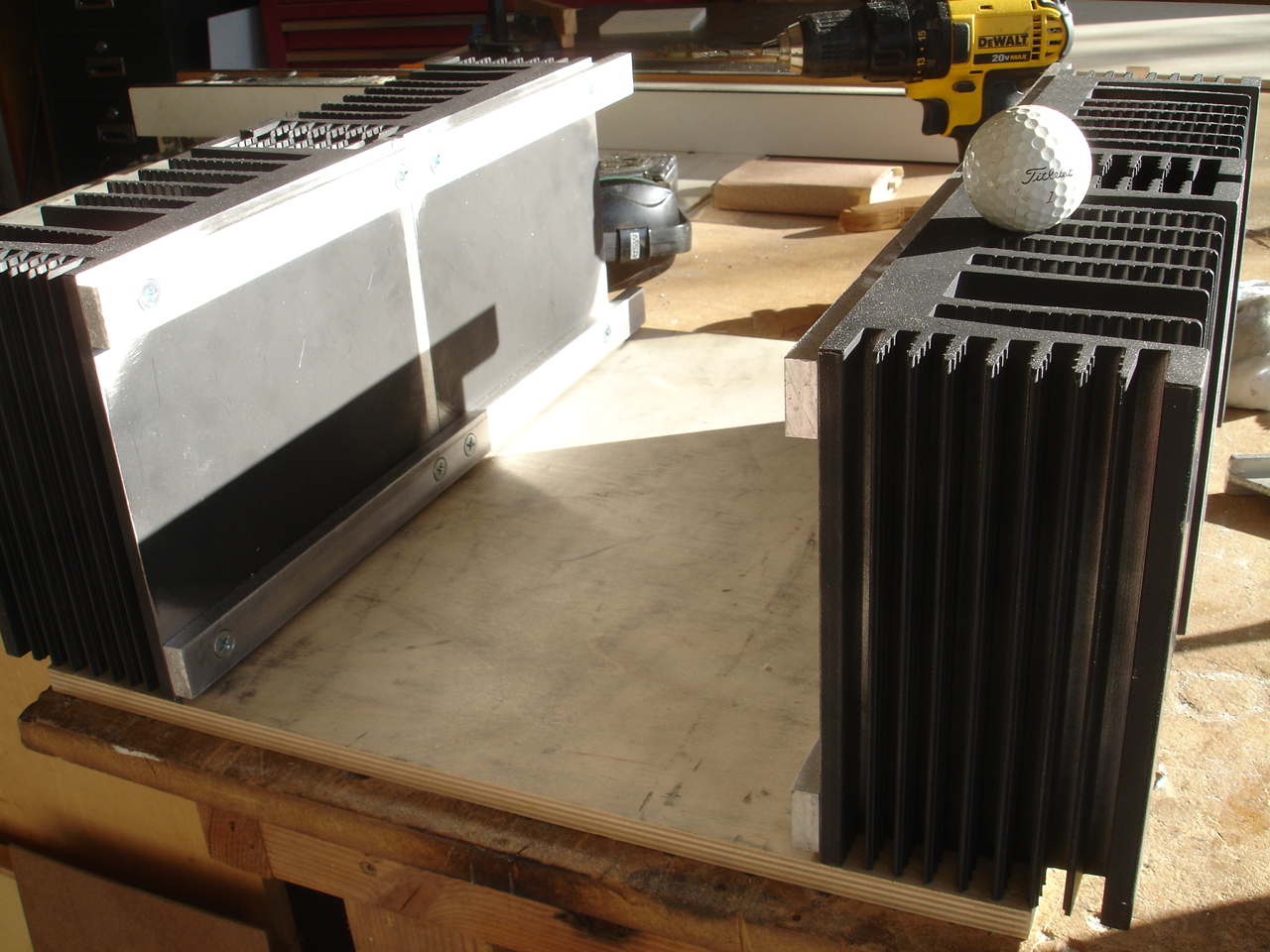

These are the heatsinks I plan to use on my F5T V2 build.
I bought these on ebay maybe there to big.
