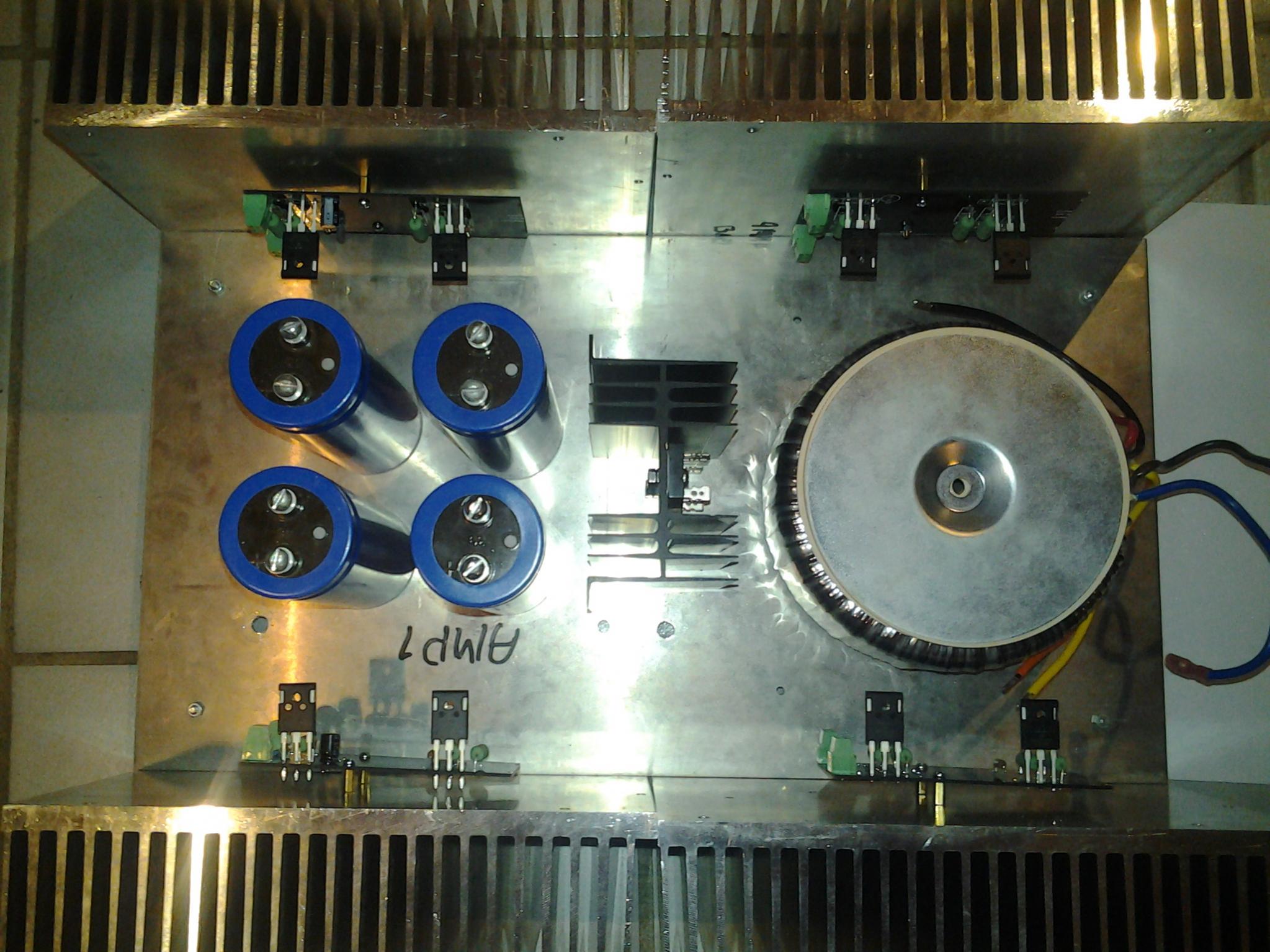

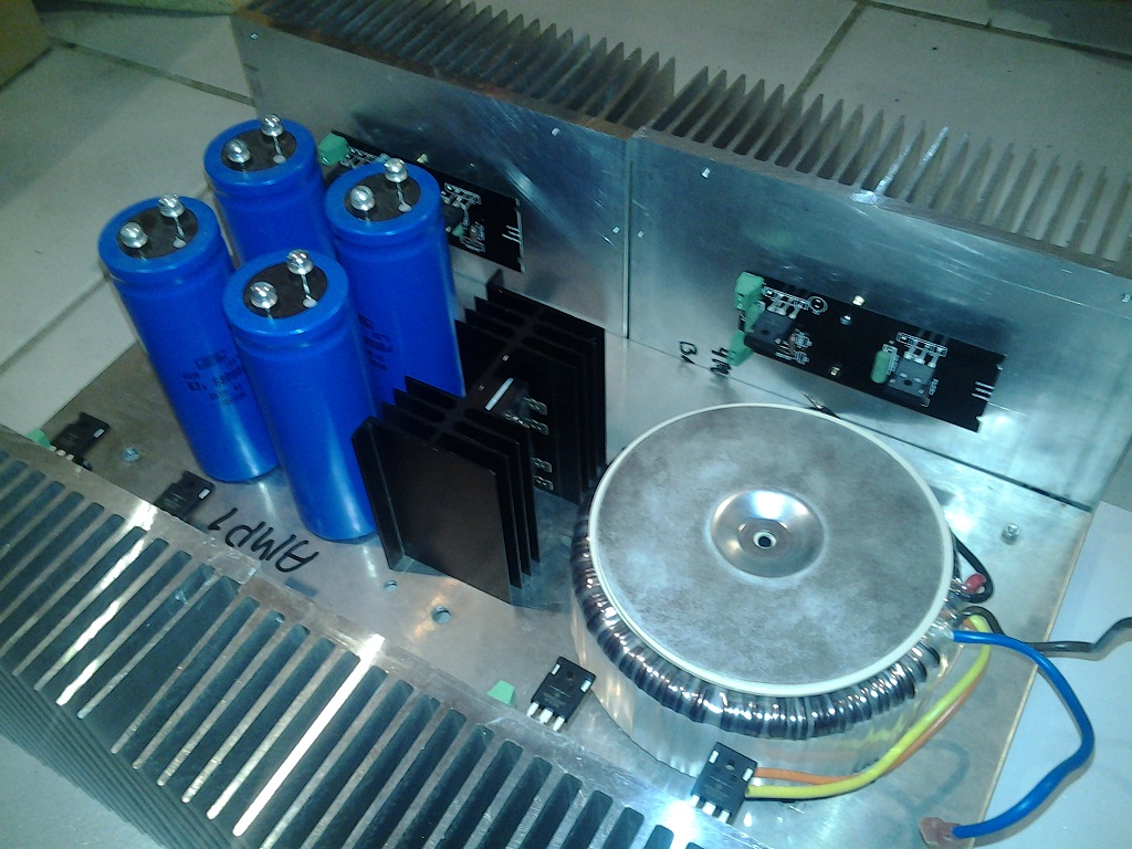

I think I would have been fine with a smaller transformer say down to 600va dual secondary.It was just a little more for the bigger one. I read that multiplying the rail v by .75 will approximate the secondary voltage needed.There is different ways to accomplish the same things.
here you can see 11" wide x 50" deep bottom with a 1000VA transformer.
