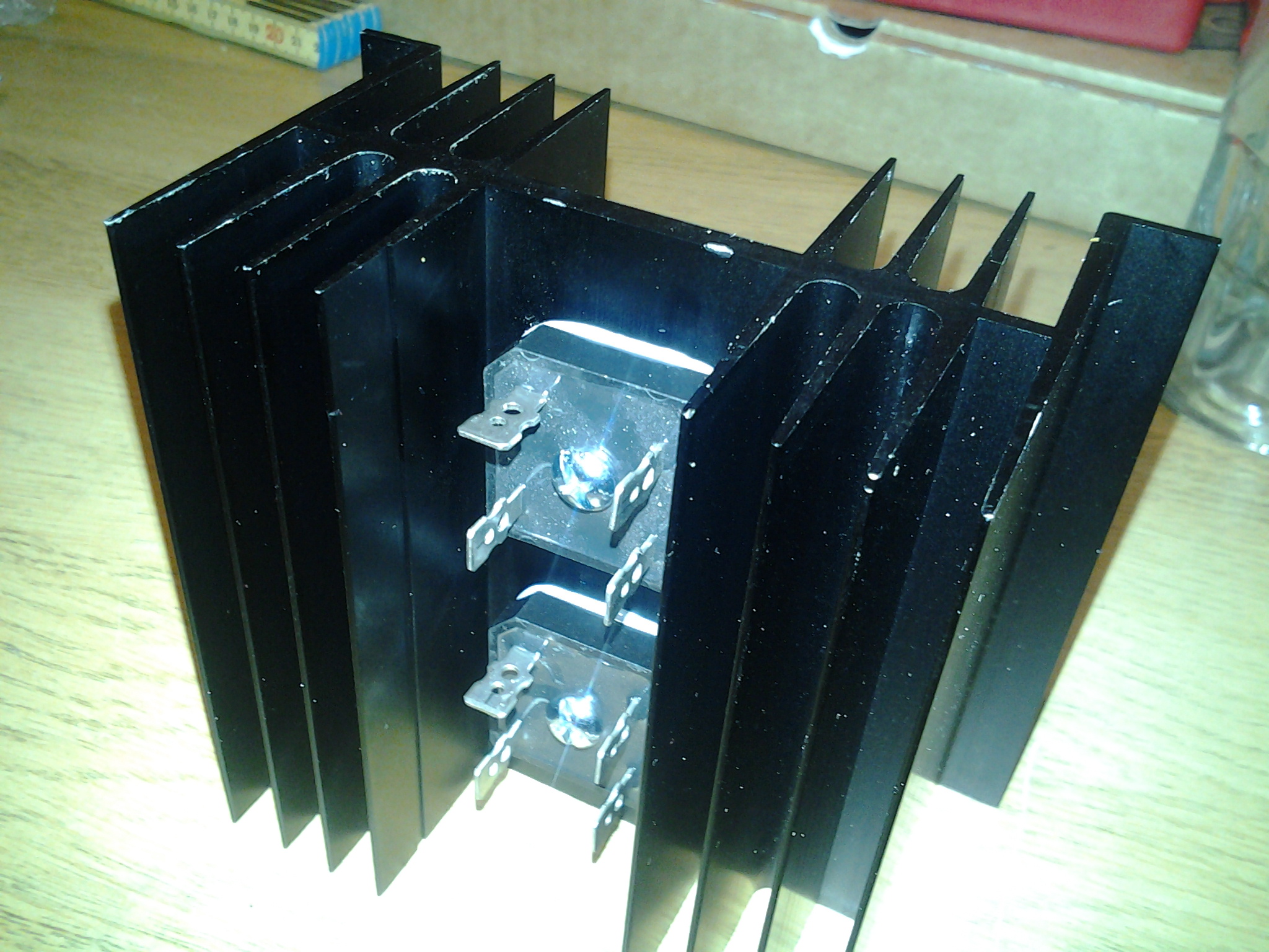

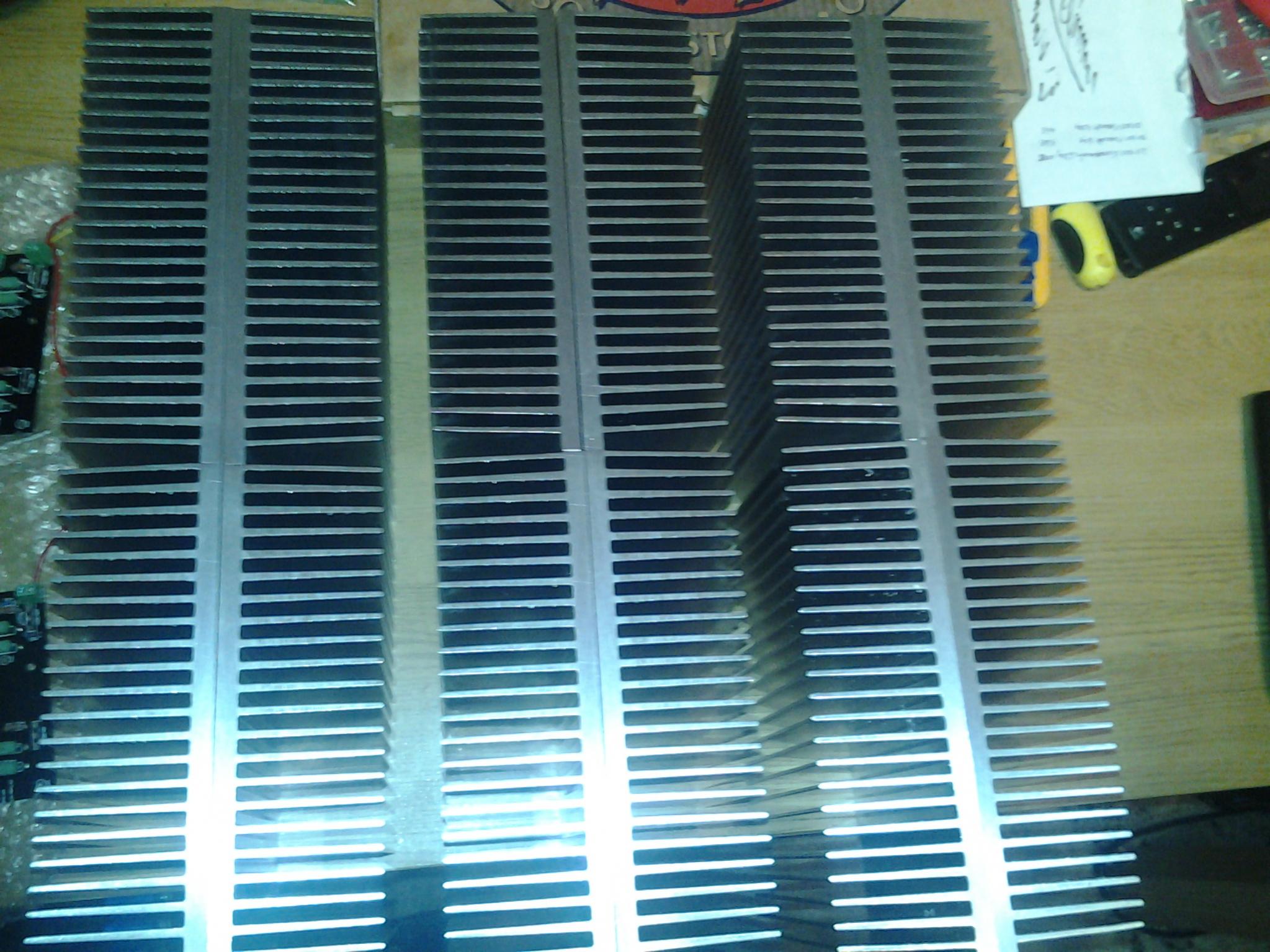

some F5 turbo heatsinks:) 33Kg. and rectifier bridges mounted on sinks.
