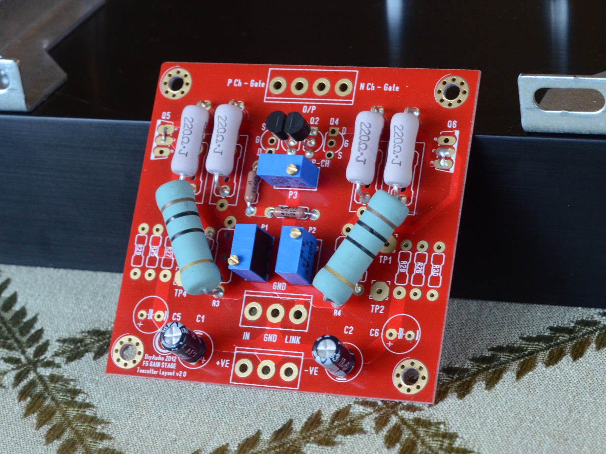

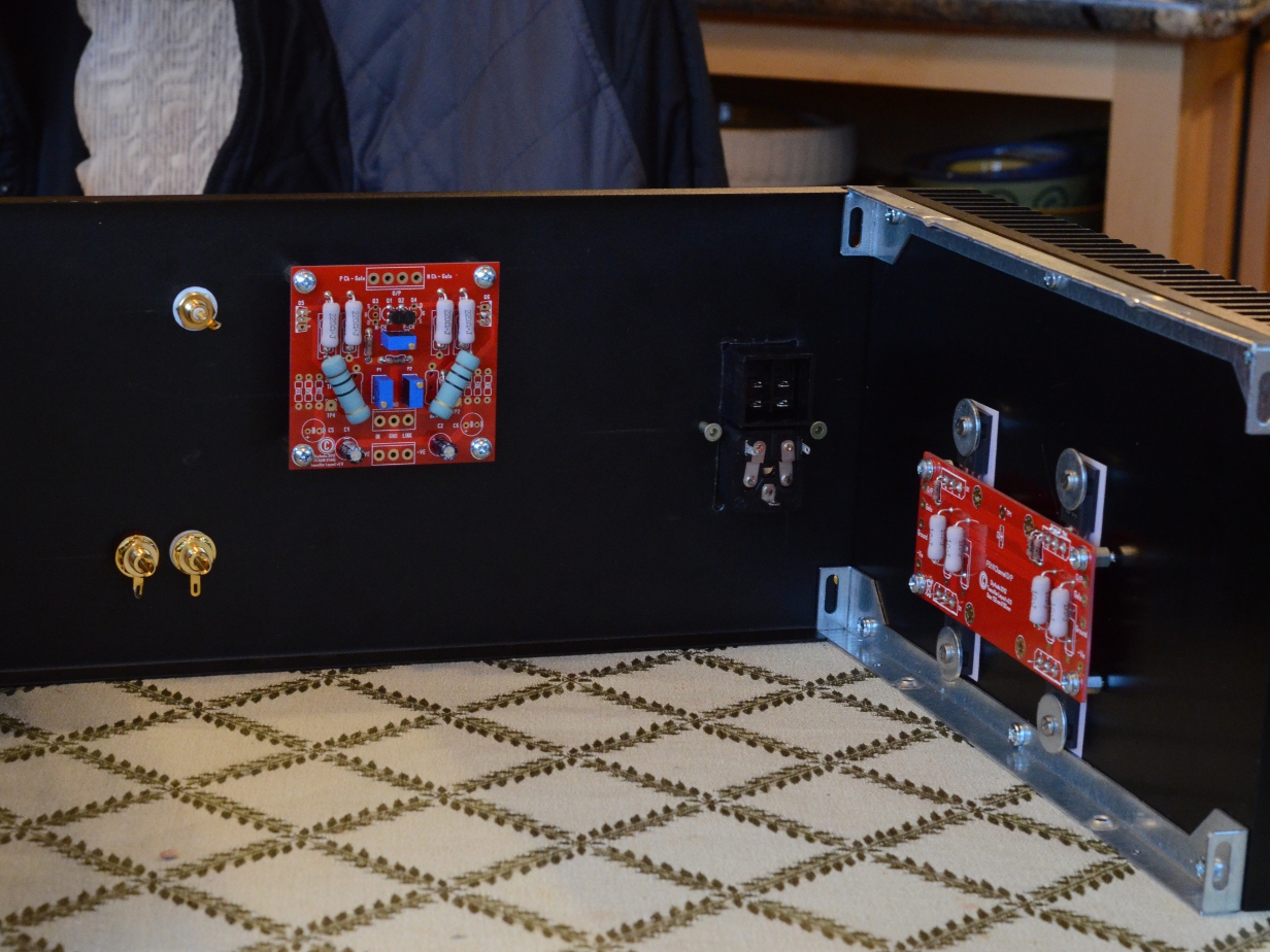

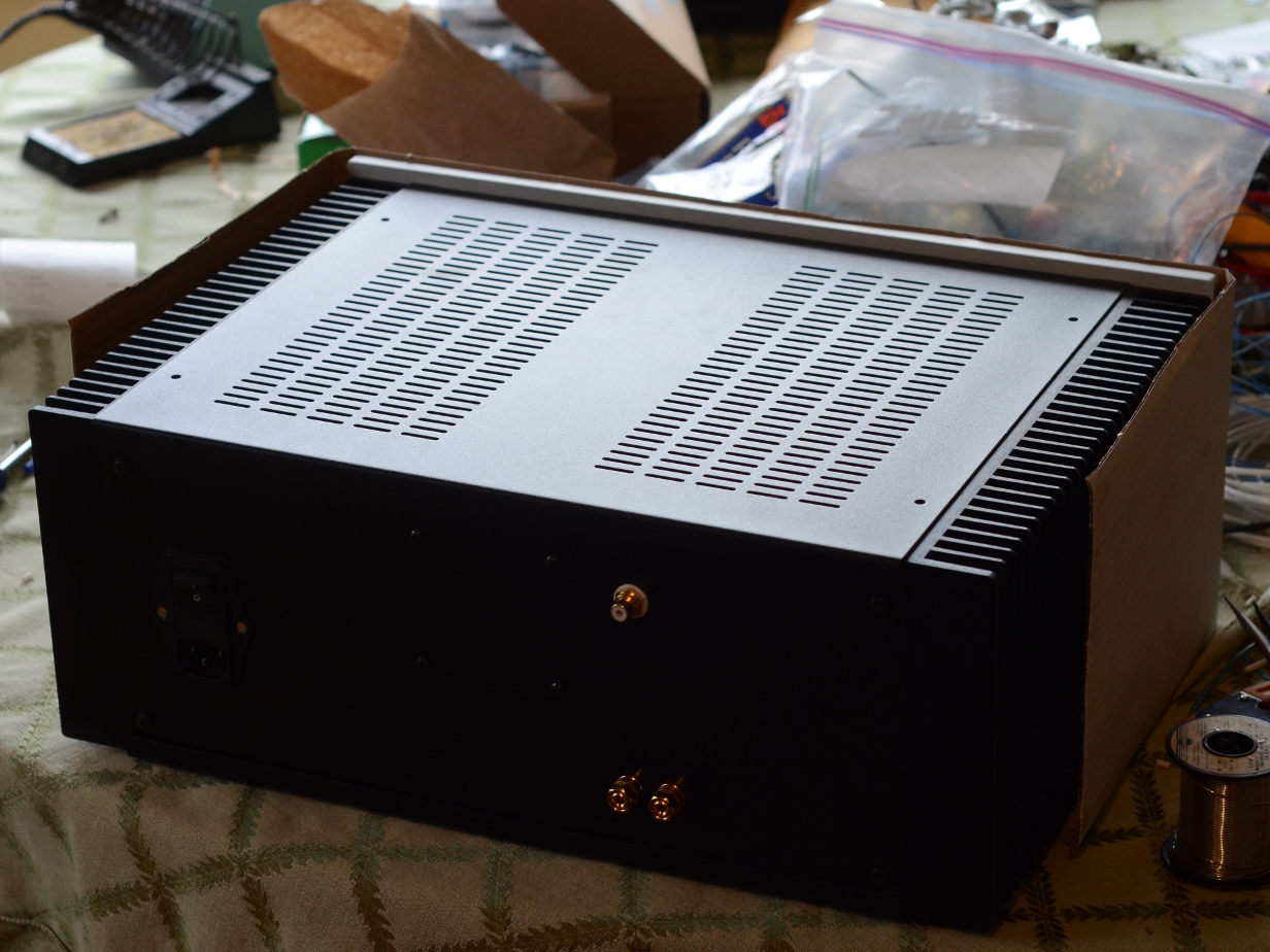

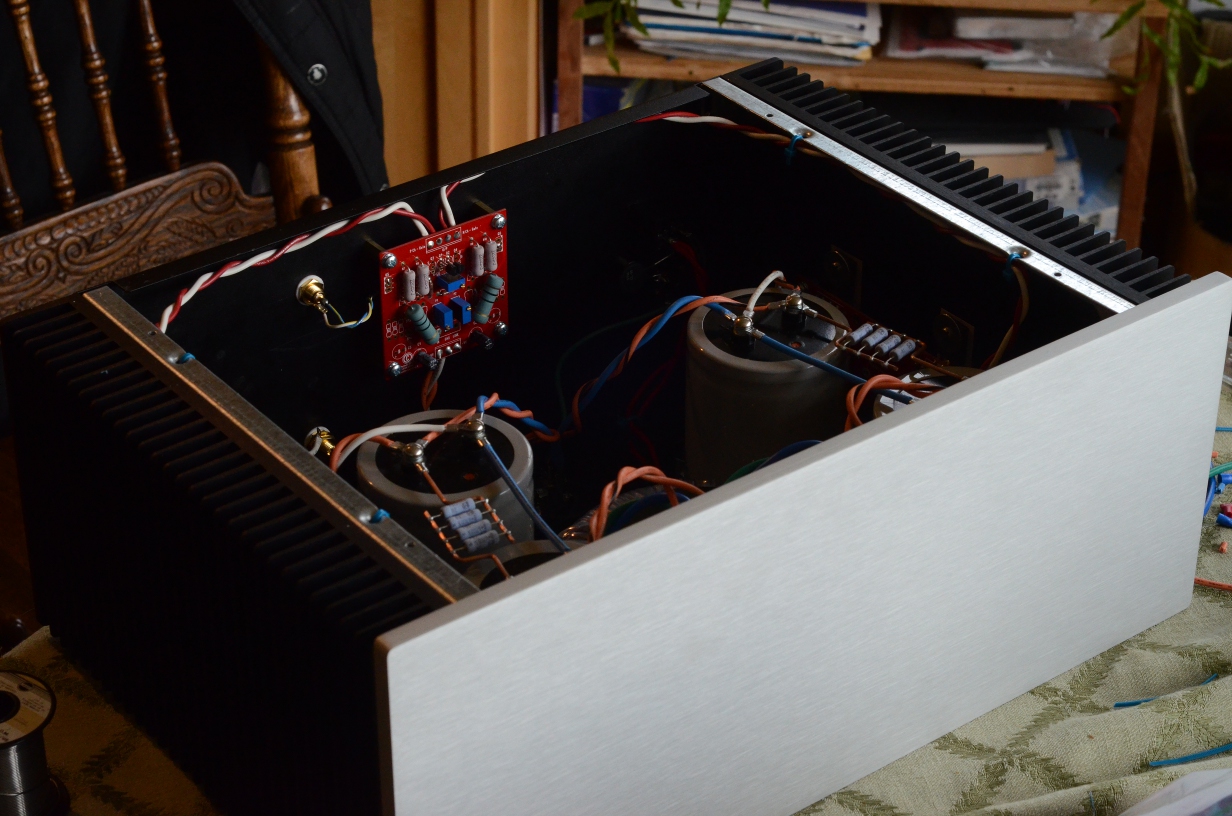

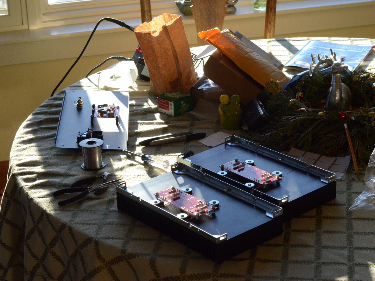

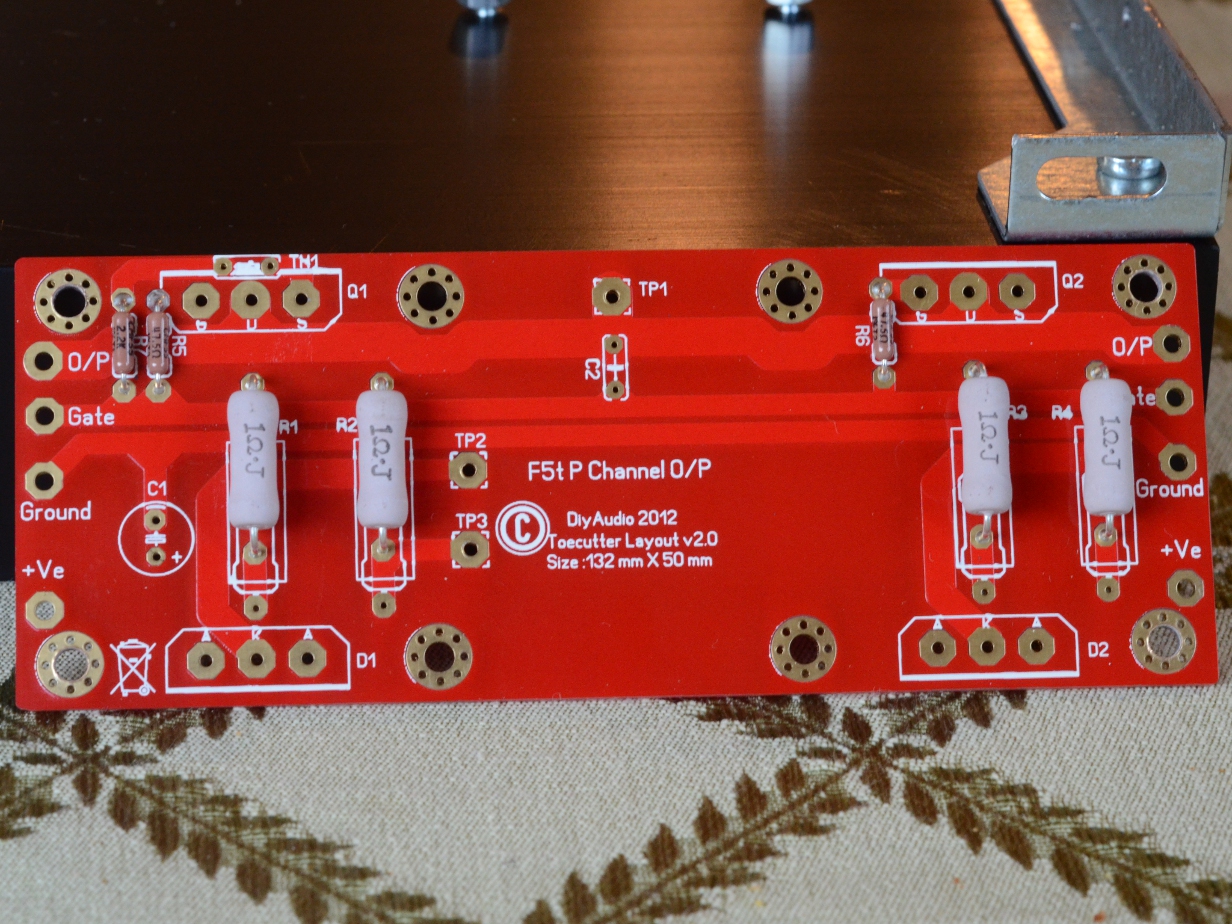

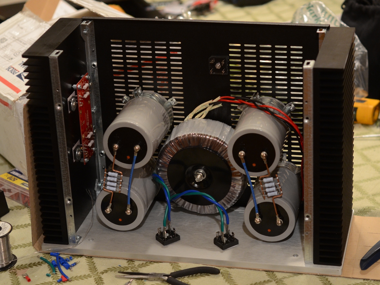

Finished wiring up a V2 monoblock last night. I am in the process of powering up the first time right now. I'm kinda guessing that P3 gets set near the middle of its range.
Anyhow, here are some photos. New UKToecutter boards, diyA chassis.
The plan is to get it up and running (biased) by tonight.
I'll post more details a bit later when I've got a spare moment and the amp's done.

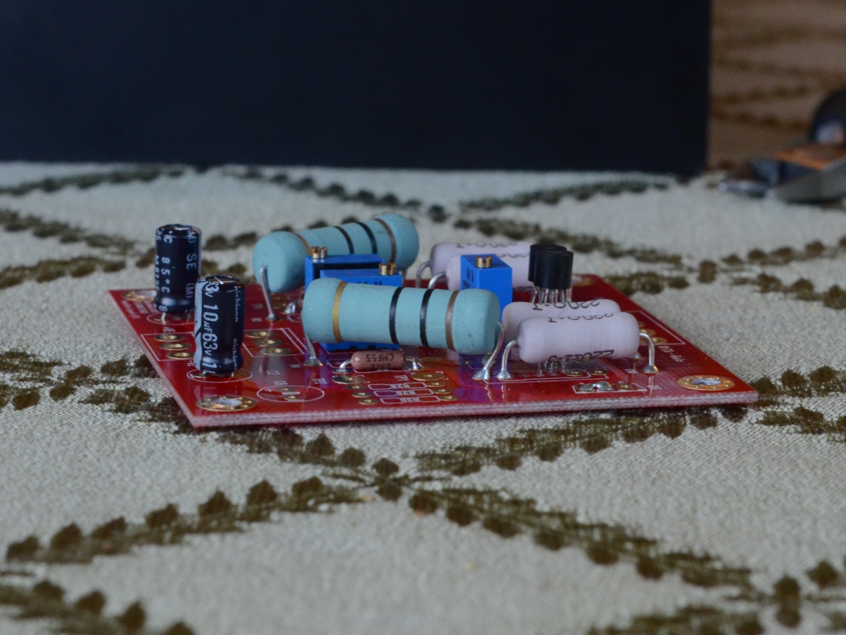

I'm in a spot of trouble. Here's what I spent the evening doing.
While trying to bias the above F5t channel I noticed a few problems.
I tested the power supply, it works fine, unloaded voltage hovers right around 35v.
I set P1 and P2 all the way counter-clockwise and P3 somewhere in the middle.
Power on and nothing smokes which is a good sign.
I measure voltage across R11 and R12. R11 is at 930 mV, R12 is close to zero.
Uh oh.
Turning P1 doesn't affect the voltage across R11. P2 adjusts R12 just fine.
Offset at the output was quite high, between 180 and 230 mV.
I say screw it, attach a test load and source and I get music. Why did that work?
Now I'm sitting here scratching my head. :scratch: Best thing I can come up with is a transistor is gone. Neither P-ch heatsink or N-ch got any warmer than ambient using an infrared gun.
Anyone have something for me to measure or try?
Best,
Nelson
Reversed pot on one half?
Getting music out is possible even with a bit of bias. That's never the issue. The high offset is likewise normal indication because the adjustment process is about getting the bias and offset to hit a 'sweet spot'.
