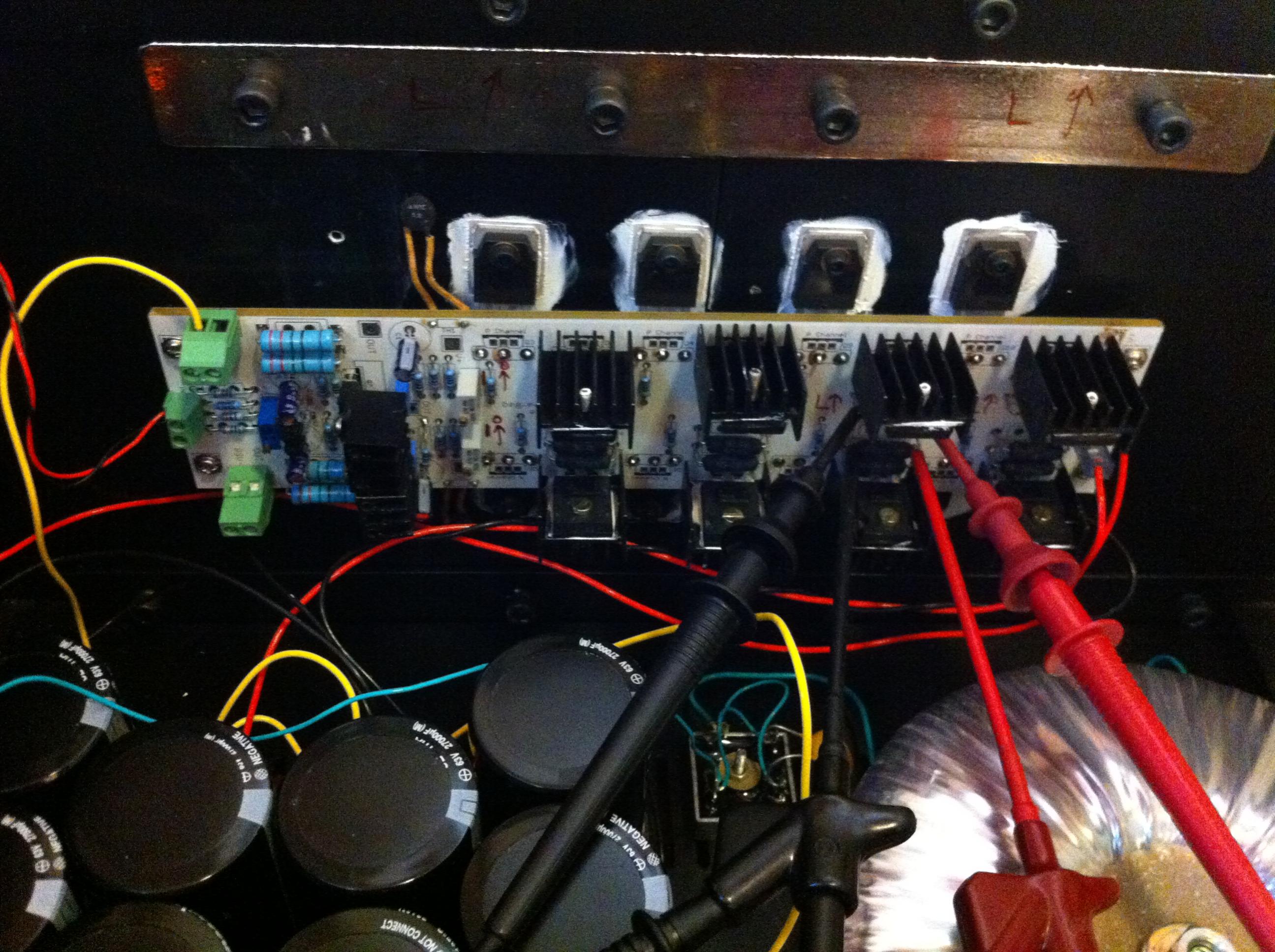

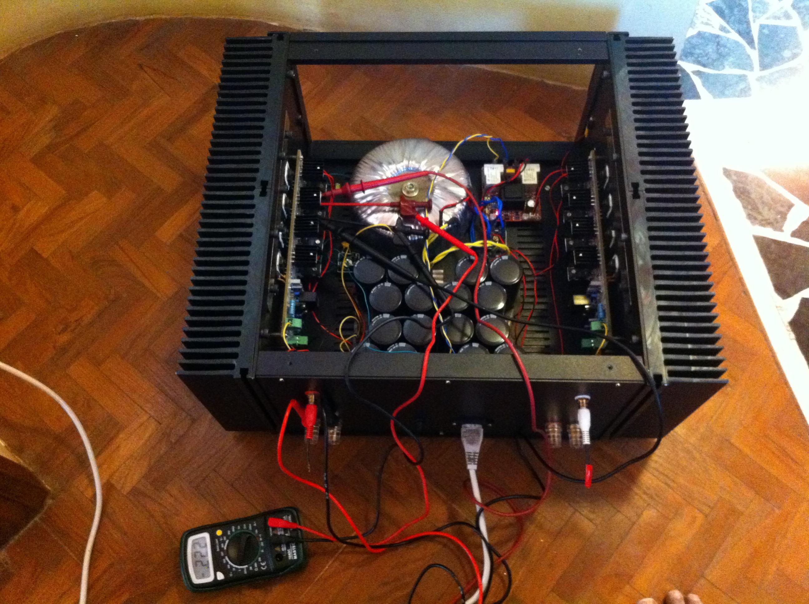

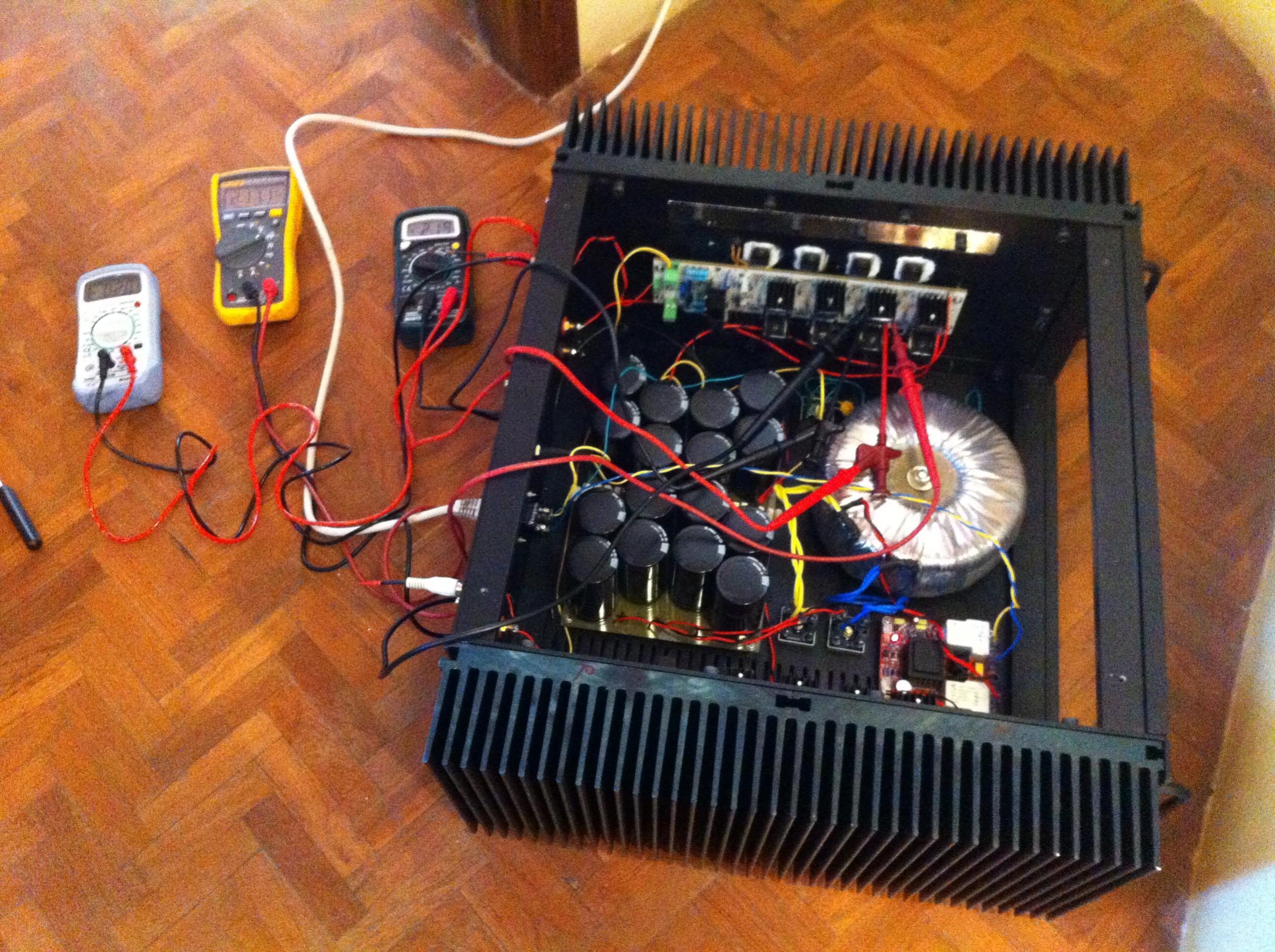

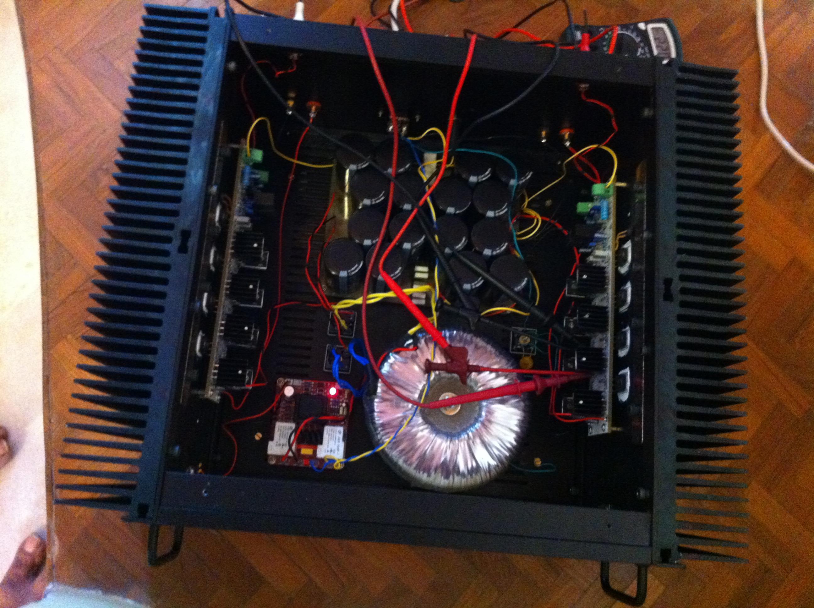

Completed F5 Turbo V3
Finally, after months of putting together various pieces, I completed the F5 Turbo V3 today gifting myself for the new year!
Basically the V3 is built around Teabag's boards using 4 pairs for each channel. The schematic is exactly the way it is on NP's article.
The AC rail voltage is 32V and gives 47VDC per rail after rectifier and caps on no load condition. The toroid is 1KVA, 2 X 32V. The capacitors used are Panasonic CE THA model 27000 uF, 63V X 8 per rail in a CRC config.
I have used a soft start switch from ebay, which seems to work well with a push button start switch.
The amp is turned on - no problems. Check with bulb first, no problems. Biases well and offset is stable after adjustment. No hum, no noise cannot even make out that the amp is on when a test speaker is connected, with inputs shorted as well as open.
The chassis is massive with huge heatsinks. A similar chassis handled V2 with ease. But I can tell you that the V3 is a different ball game. The heatsinks get quite hot. The 4 pairs push heat like hell.
Only concern right now is that I have biased each output transistor at 300mV when quite hot. At that bias setting, when started cold, it starts at 75mV and climbs all the way to 300mV in a matter of 1 hour. Is this normal. Is the thermistor control working? I have made sure that the thermistors are touching the heatsink and have also applied heatsink goop for better conduction.
I want to see the bias stop at 300mV and climb no further. I have right now kept it under observation.
Any comments and advice appreciated. Attached are some of the pictures.
Thanks.

The bias is related to heat. The hotter they get, the less bias it takes for a given current. You decided you bias at operating temperature, which is correct. When you turn the amp off and it gets cold, the same Vgs produces les current. As it warms up, the temperature increase once again cause the bias to rise. I do wonder how hot they are running. Can you put you r hand on the sinks for 5 seconds? Maybe should back down to 3 pairs or consider monoblocks. Hope you enjoy.
Thanks. I backed down my bias to 250mV as of now and it has climbed to 270mV ever since (30 minutes). The heatsinks are passing the 5 seconds touch test so far, but just about.
hello. have you messured 47VDC rails with amp running at 2.4A bias? or is it only calculated? i would expect about 41-42VDC rails from 2x32V sec.

You have enough current that thermal stability has to be main issue unless you can do something about the heat. Consider that it may warm some playing into a load. IN truth, at those bias levels, the diodes are a non contender unless you are playing into brutally heavy load. In that case yo have a heat problem.

At load the DC rails are at 43V each.

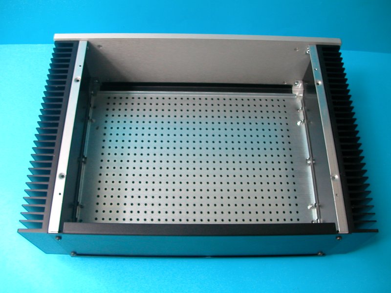

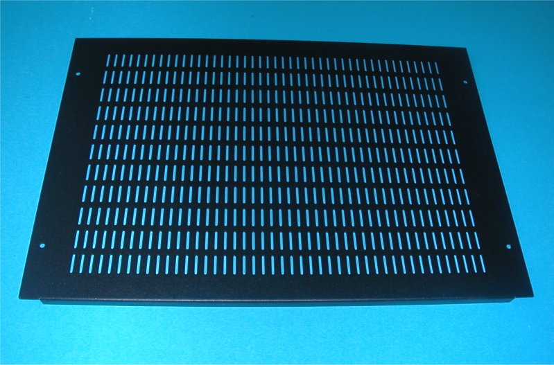

I advised the holed bottom and this cover (HIFI2000). A fan in the center of the lid on the inside will give much freshness. Congratulations for the work

Interesting. In NP's paper, the F5T V2 schematic specified a 32V rail voltage. However, in the V3, no numbers were given. I assumed (probably wrongly) that the required rail voltage is still 32 V. However, in the text of the paper, NP use an example of : 36 V secondary to give 48 V rail. However, in the PSU schematic, he still shows caps rated at 50V. So the question is, what should be the rail voltage be for V3? I suppose that higher the rail voltage, higher the output (provided the PSU can pump in more juice when needed).

I mentioned that it is 47V DC at no load earlier. Looks like I have to use a quite cooling fan mounted to the top cover to evacuate hot air from inside and also provide enough ventilation to the bottom cover to enable air flow.
