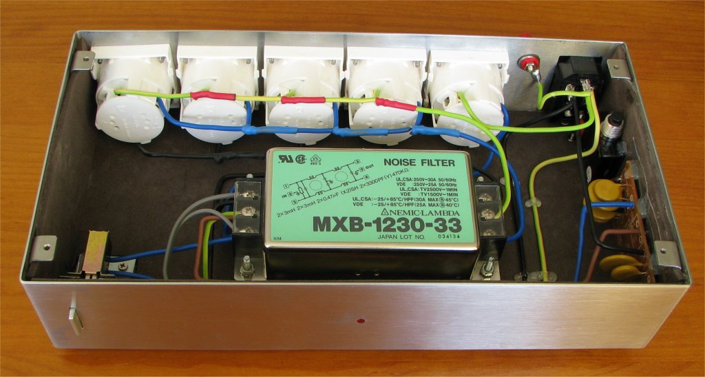

In some cases, the mere fact that the F5 away from other devices may result in loss of humm.
The power grid has several harmonics from various devices used by itself and neighbors, it also influences the humm, and is difficult to alleviate.
I advise the use of a filter Electrical network 30A of Lambda (TDK is now), this filter does wonders throughout the audio system.

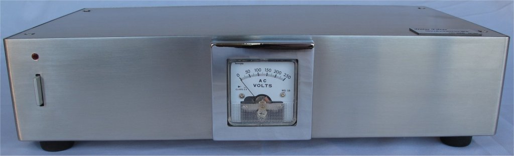

I use Lambda MXB-1230-30A 30 where I made a box with outlets
Thanks, I will check out the Lambda stuff. I can hear my Toroid making different noises when my water pressure pump keeps going on and off....
