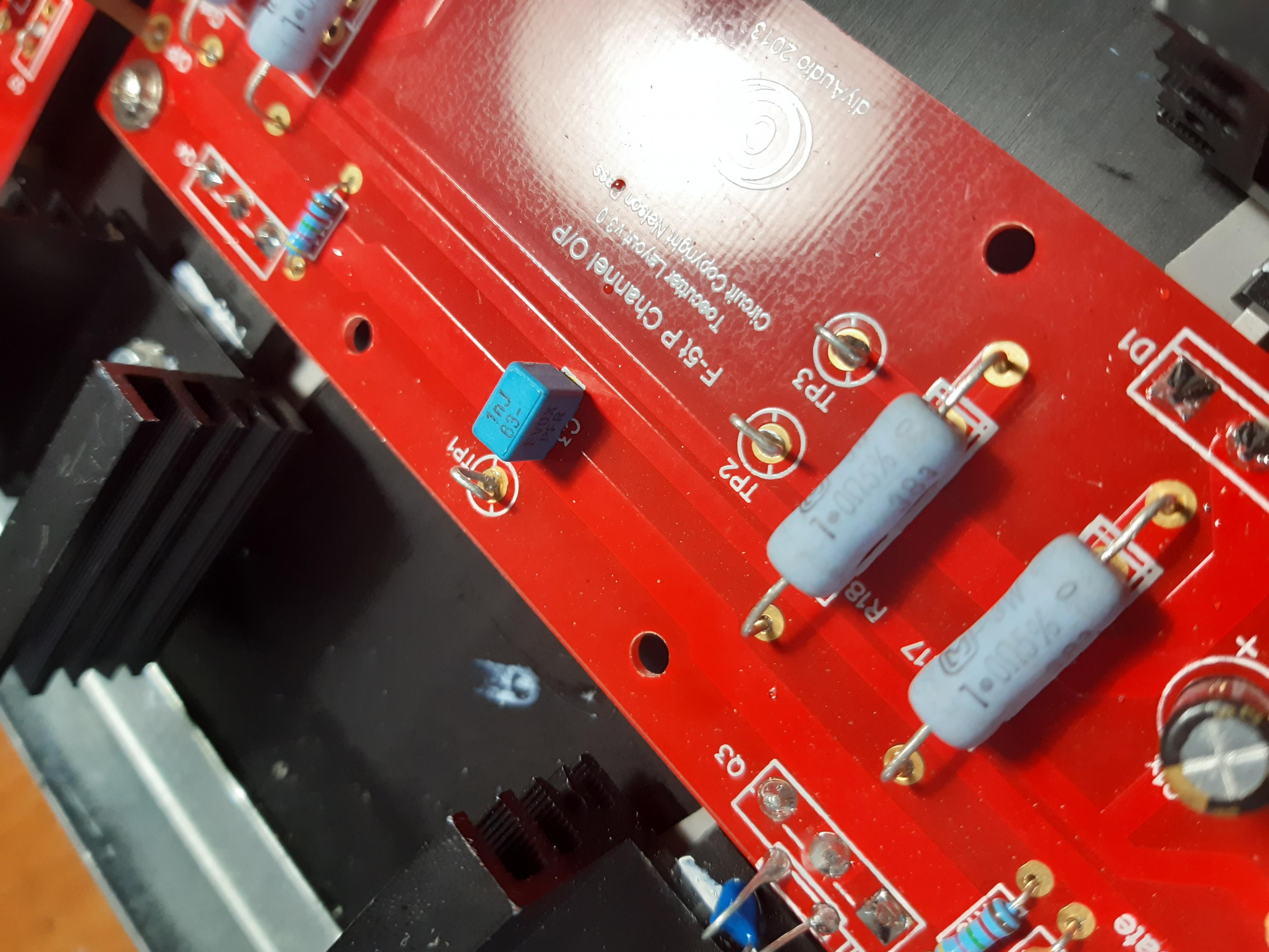

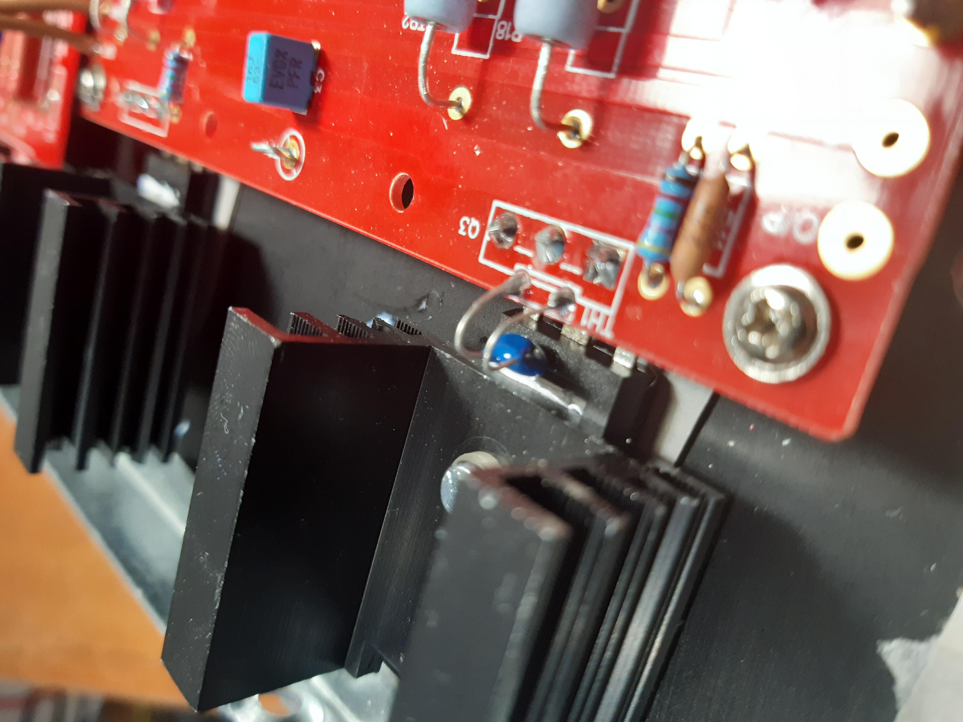

I moved termistor and change position onto the plastic.
Add little cap.
I set to "0" TP1 and TP2 (FE pcb) and I read the bias procedure but I haven't got all the instrumental and experience.
Now procede to assembly the case and after to fine set bias I'll ask to help from trusted techician.

umut: The MUR30xx rectifiers specified in the original article have a conduction voltage that is only a hair above the idle bias setting.
Since the thermal compensation arrangement provides for the bias at startup to be higher than the final idle bias, there is a chance of the rectifiers conducting even without signal, which sends the output transistors into failure.
The few ways around this are
1) not to use any diodes at all
2) to use diodes with a higher knee voltage than the MUR3020 (which has the highest knee voltage of all that series)
3) to increase the source resistance to allow for a slightly higher safety margin (the bias 'voltage' needs to be recalculated in this instance)
The diodes you linked to have usefully higher knee voltage than the MUR3020, but only by a little bit. This makes me optimistic about most of them, but you will still need to feel your way around the circuit.
If possible, use a current-limited power supply (say 2A) to work out what bias points you can set with the diodes and a few combinations of the source R. With a knee voltage of just around 0.6V, you can probably target around 0.56 ohms source R (that's 4x 2.2ohm resistors) for a standing bias around 1.6A - a bias voltage of around 0.45V. This should give you some margin to safety and all the benefits of the full Turbo experience. The diodes will start conducting only when the output current reaches about 2.5A.
If that sounds like too much trouble, just drop the diodes.
Just to be clear, you only need one diode, a few resistors and a benchtop power supply (or a CCS with a big heatsink) to work the combinations out. The actual circuit is not even needed for the initial discovery.

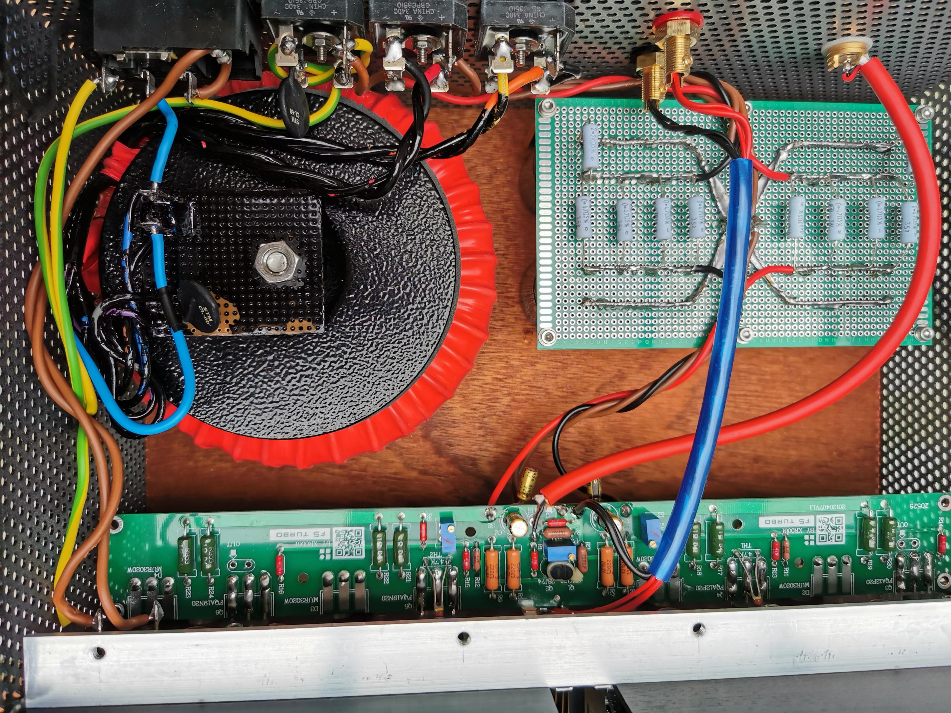

So got the transformers back in the amps with windings varnished and extra turns to reduce the output voltage. Mechanical hum is defiantly quieter, mainly the harmonics have been removed. Not sure the extra windings make much difference to the mechanical noise, will try with them bypassed next time I have time.
Can't hear the mechanical hum from the listening seat, but still quite noticabe when stood next to them. No noise through the speakers, just great sounding sweet music. Only 40degC on hottest part of heat sink, so room for more bias.
Maybe time to try a DC blocker to get rid of mechanical hum.
