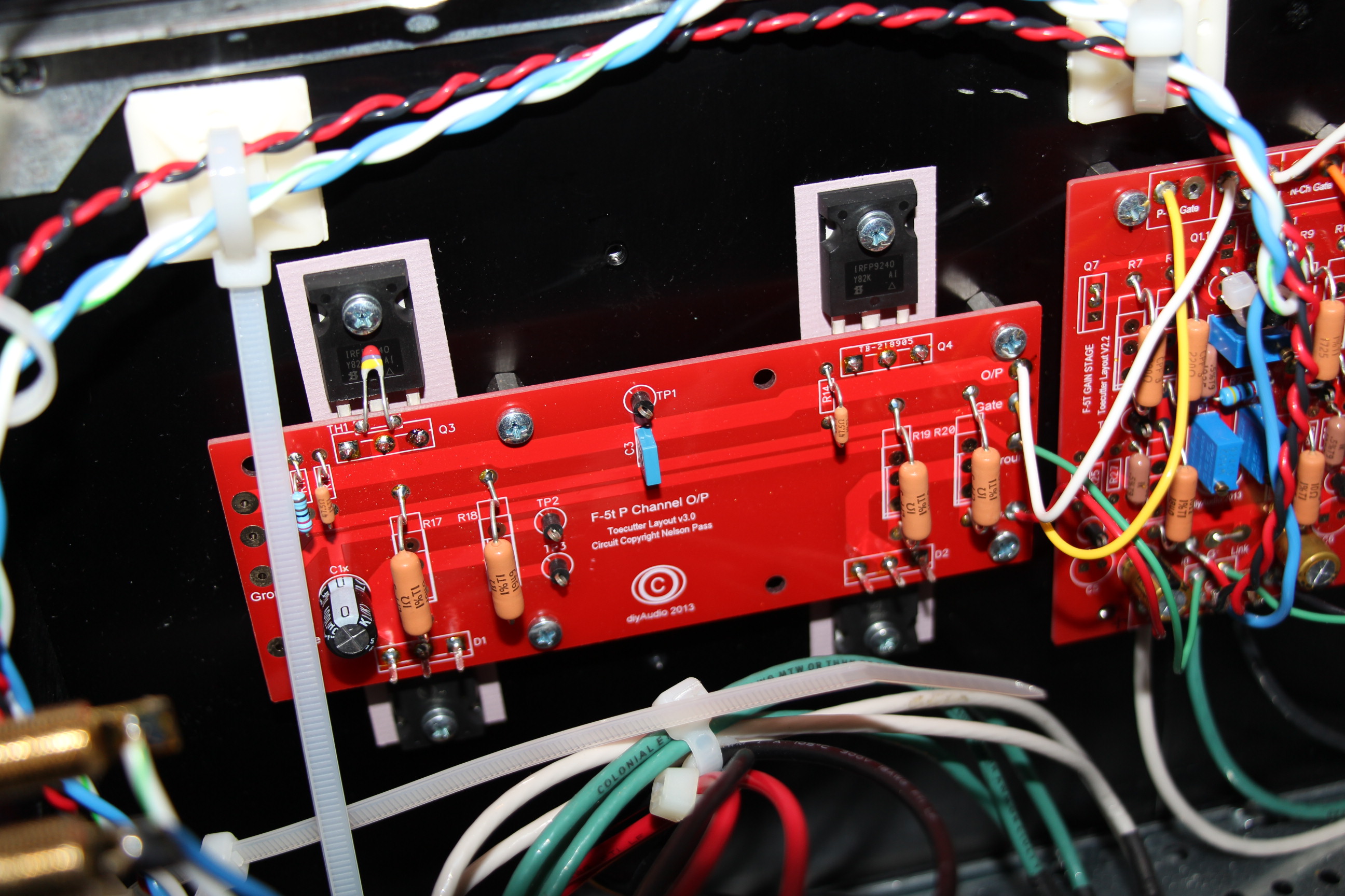

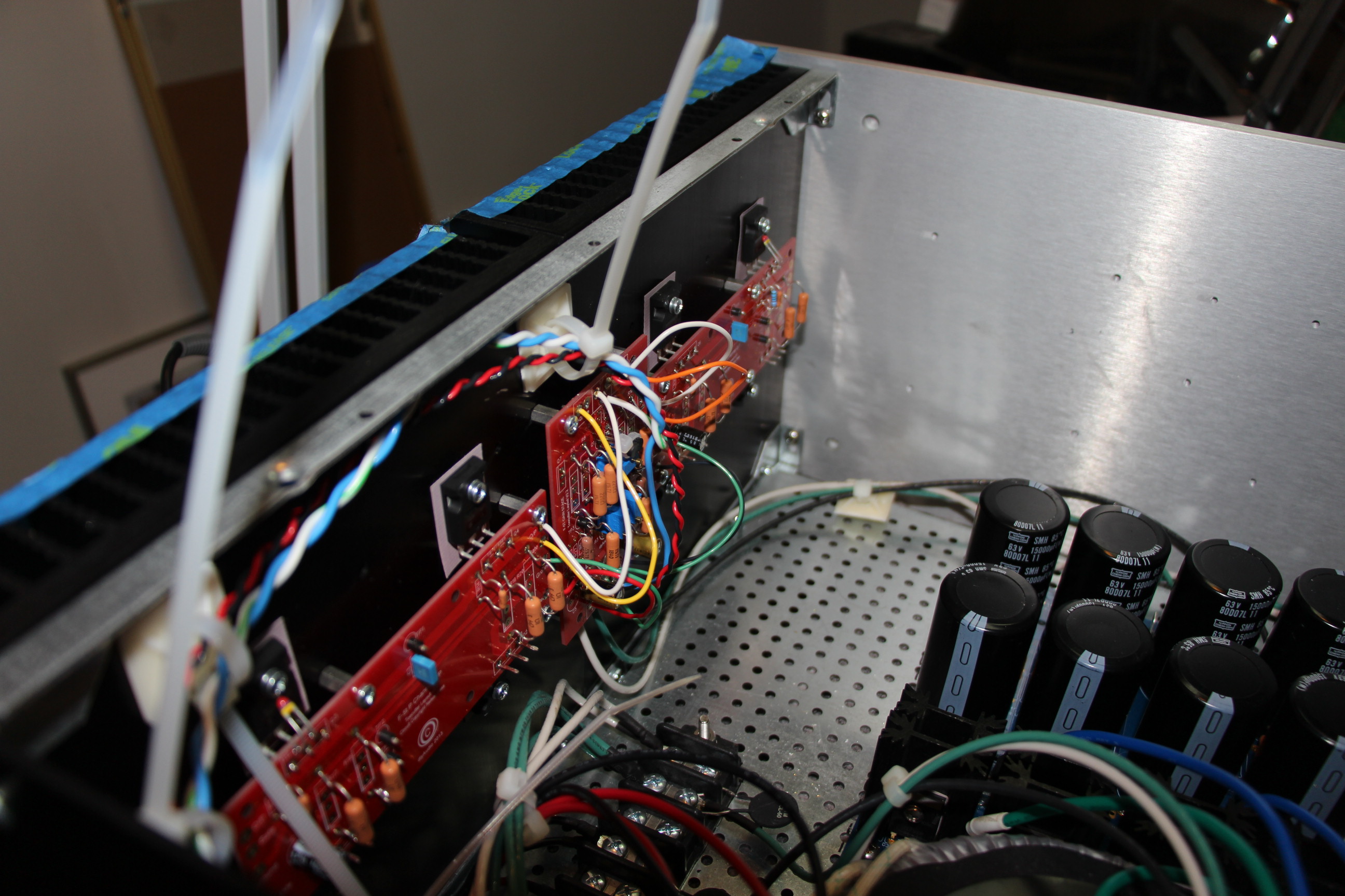

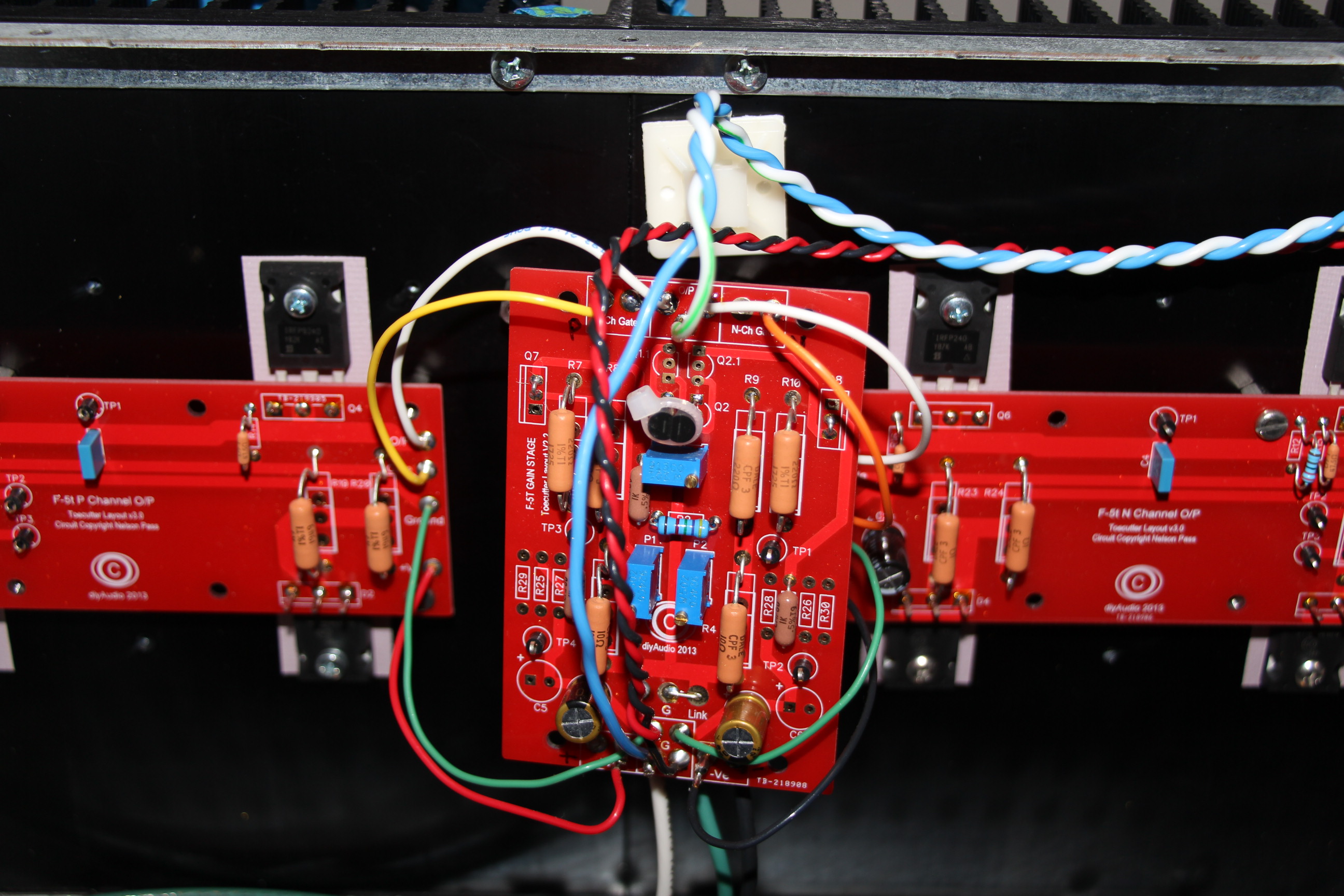

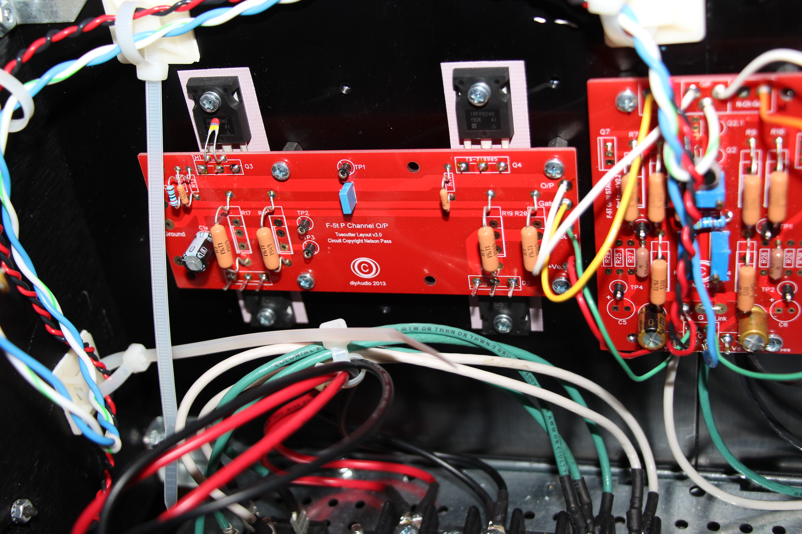

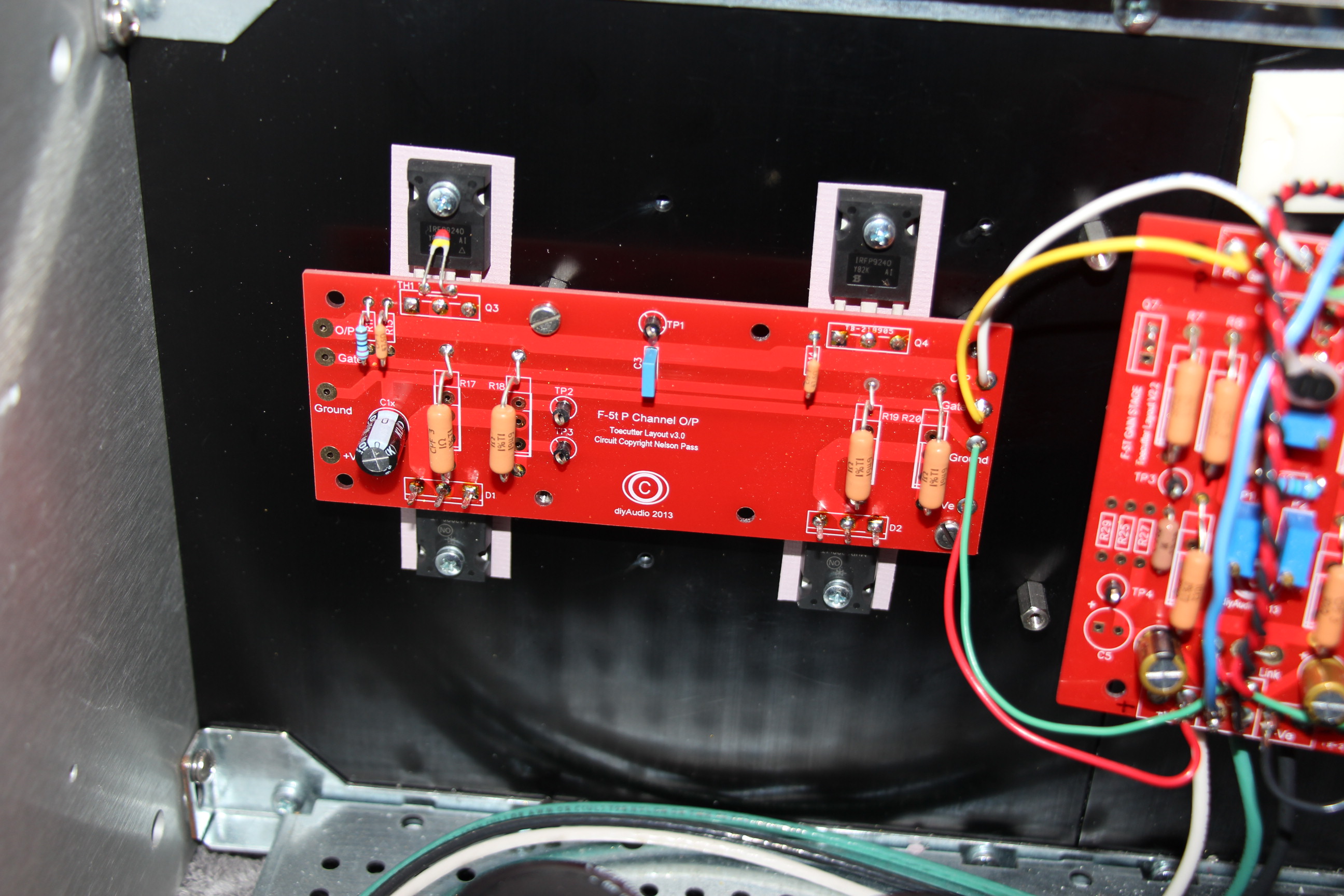

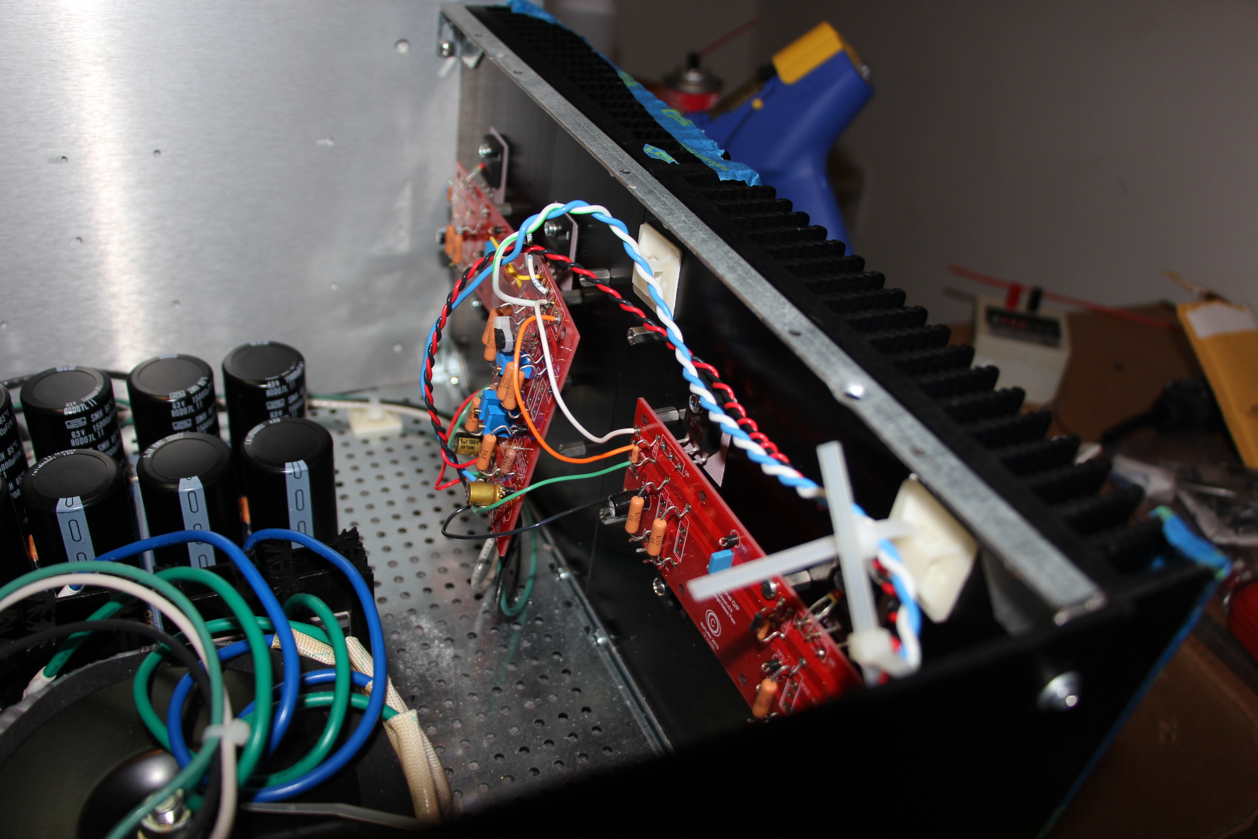

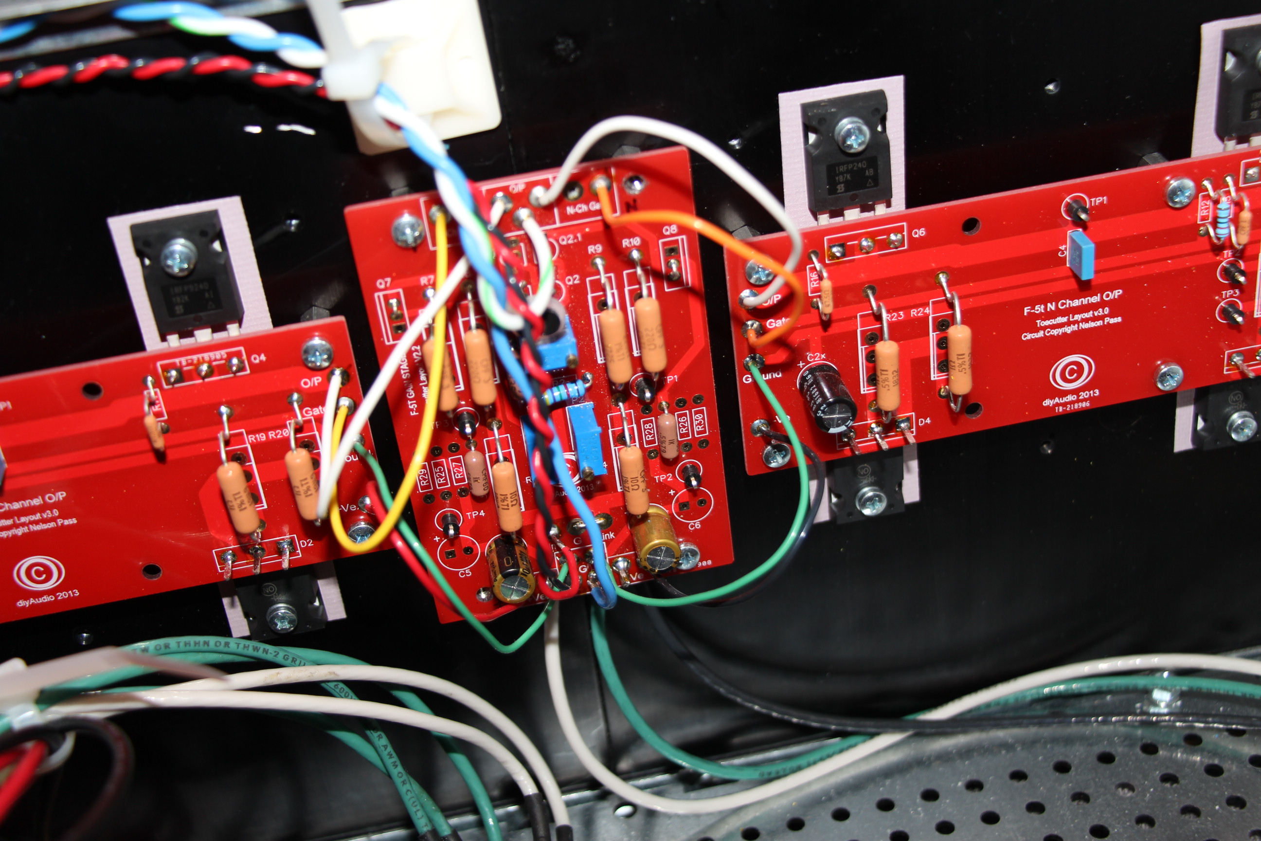

Apparently my picture post has to be vetted before posting. Please feel free to ask for other images that might prove helpful.
some more

Pretty sure not my issue but PS had 2 CL60s instead of a CL 30 for power lead and 60 for ground. I see TP 1 and 2 I know which pts control those points the other end of the test point is ground?
