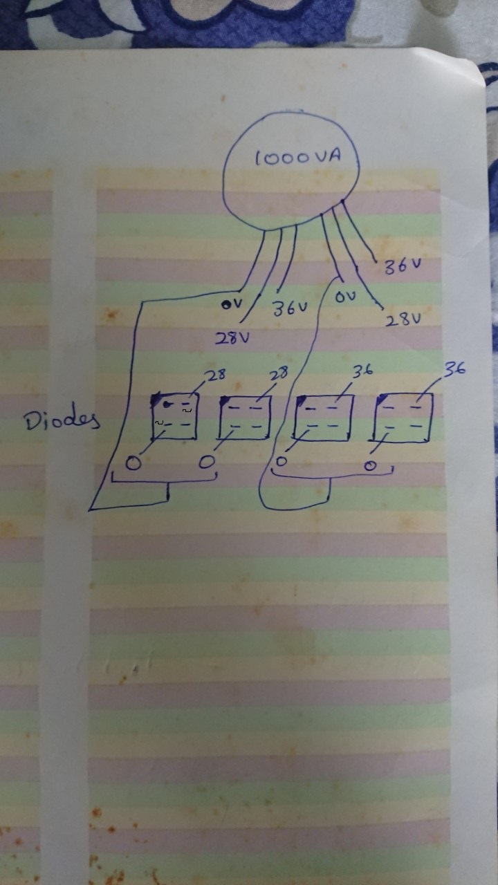

Two PSU from one Transformer
Please help confirm if connection in image is good.
Transformer is 1000VA ( Transformer secondary wires are 2.5 sq mm)
0-28-36
0-28-36
Diode - GBPC3506 - four
Need to run two different PSU from same transformer(different voltages)
Is it fine to to connect 0V wire to two diodes as show in Image. This is for F5T v2 and Aleph2 (Mono) fed from same transformer.

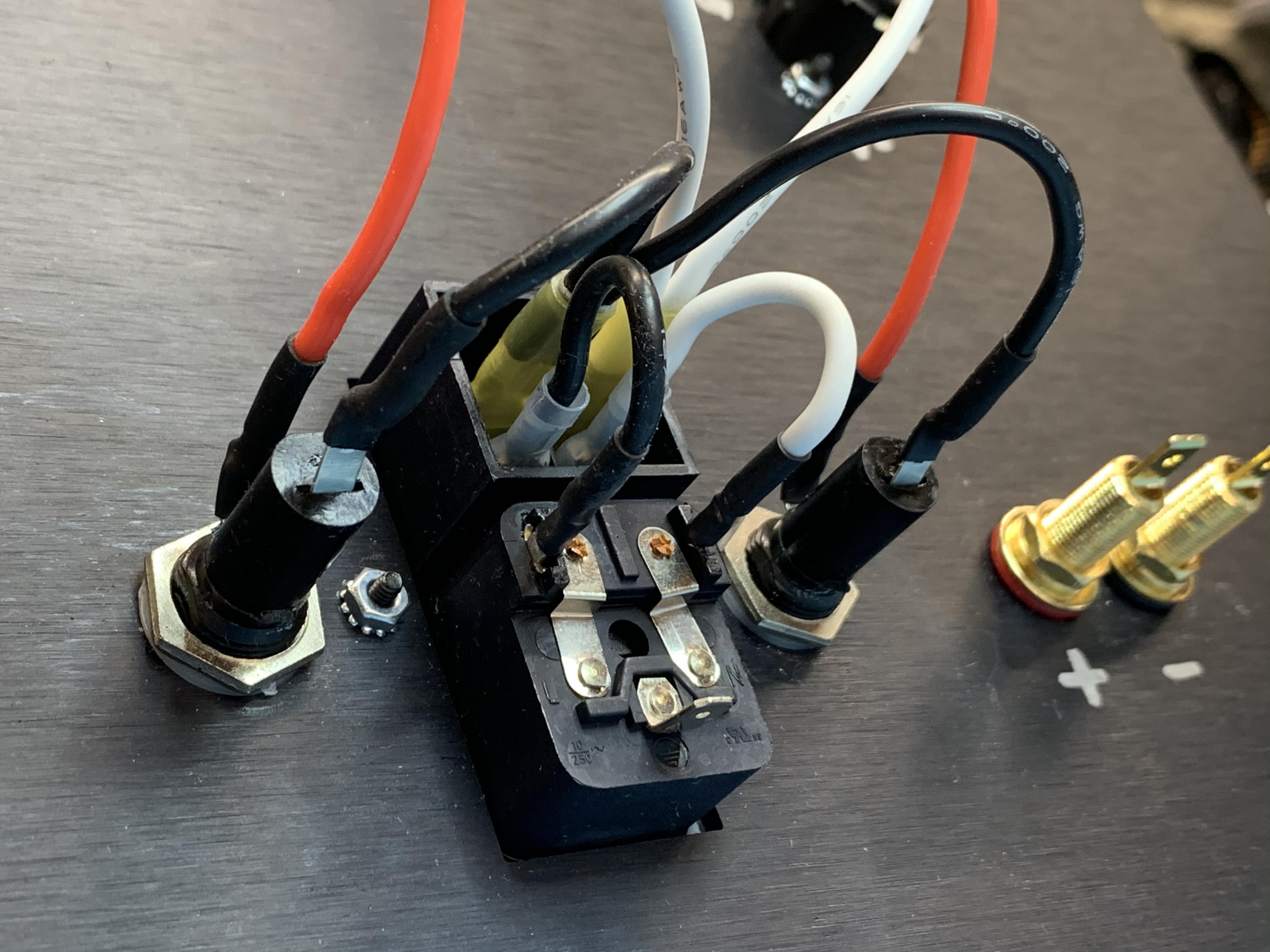

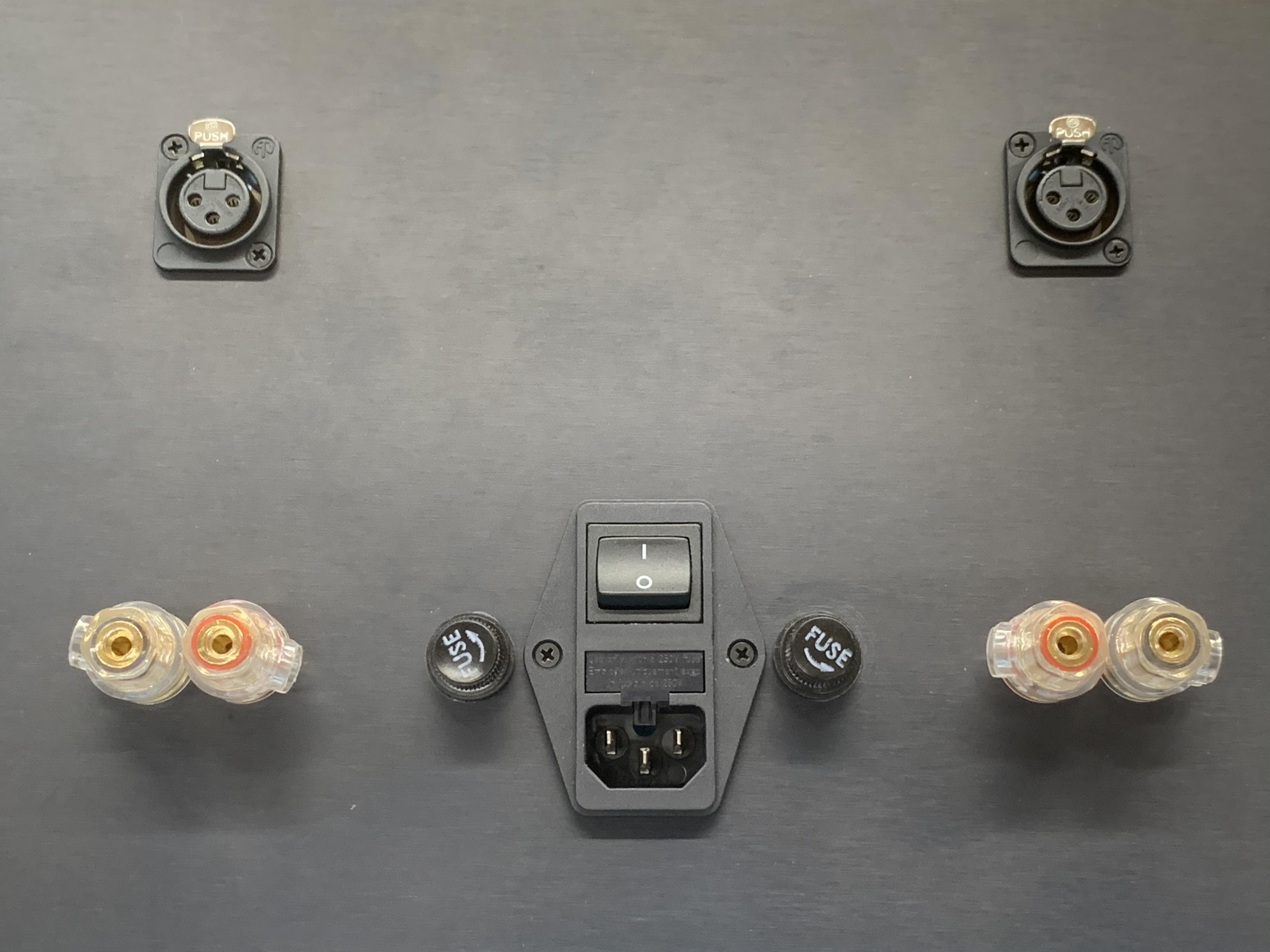

This morning I plugged in my test speakers and some RCA inputs, but the moment I flipped the switch it looks like I blew a fuse. I used the fuses sold in the back panel kit. The one that blew was an F2AL250V, which I had on the hot side of the IEC block. The fuse on the other side says 10A250V, so significantly higher amp rating than the one that blew. Did I have them placed backwards, maybe the 10 should have been on the hot side? Should the two fuses be the same model, or is using two different fuses by design? Or since the 2amp fuse blew maybe I have an issue somewhere?
I'm running dual mono with two Universal PSUs, each fed by their own Antek AN-6224 transformer, with a Soft Start in front of them. Maybe I just need beefier fuses to handle this much juice?

You need more than a 2 amp fuse I reckon. I use dual 6A slow blow fuses. Seems to work fine.
The 10A MUST stay on the neutral.
Your other fuse is too small for that much PSU. Try A 3A slo blow. If that doesn’t hold, increase by .5A until it does.
This is exactly the advice I was looking for, and what I was hoping to hear. Huge thanks! Back to the hardware store I go!
I had the same problem. Mine because I didn't let the amp cool off enough before turning it back on again (similar to your scenario). I also used the 10A FB glass fuses that came with the IEC plug. I chose to use separate fuse holders after that since I built with dual PSUs. I chose 4A SB for those since that's what was in the Aleph J service manual. I haven't looked too intently at the F5 manual to see what was recommended. But the above advice is good.

3A slow blow seems to be doing the trick. I am currently hearing music out of my speakers. Sweet holy heck, I think I did it!!!
Massive thanks to everybody here, especially 6L6 and all the other frequent commenters. Too many people have helped me to name you all, but you know who you are, pat yourself on the back. It takes a village to make an F5Turbo, as the saying goes.

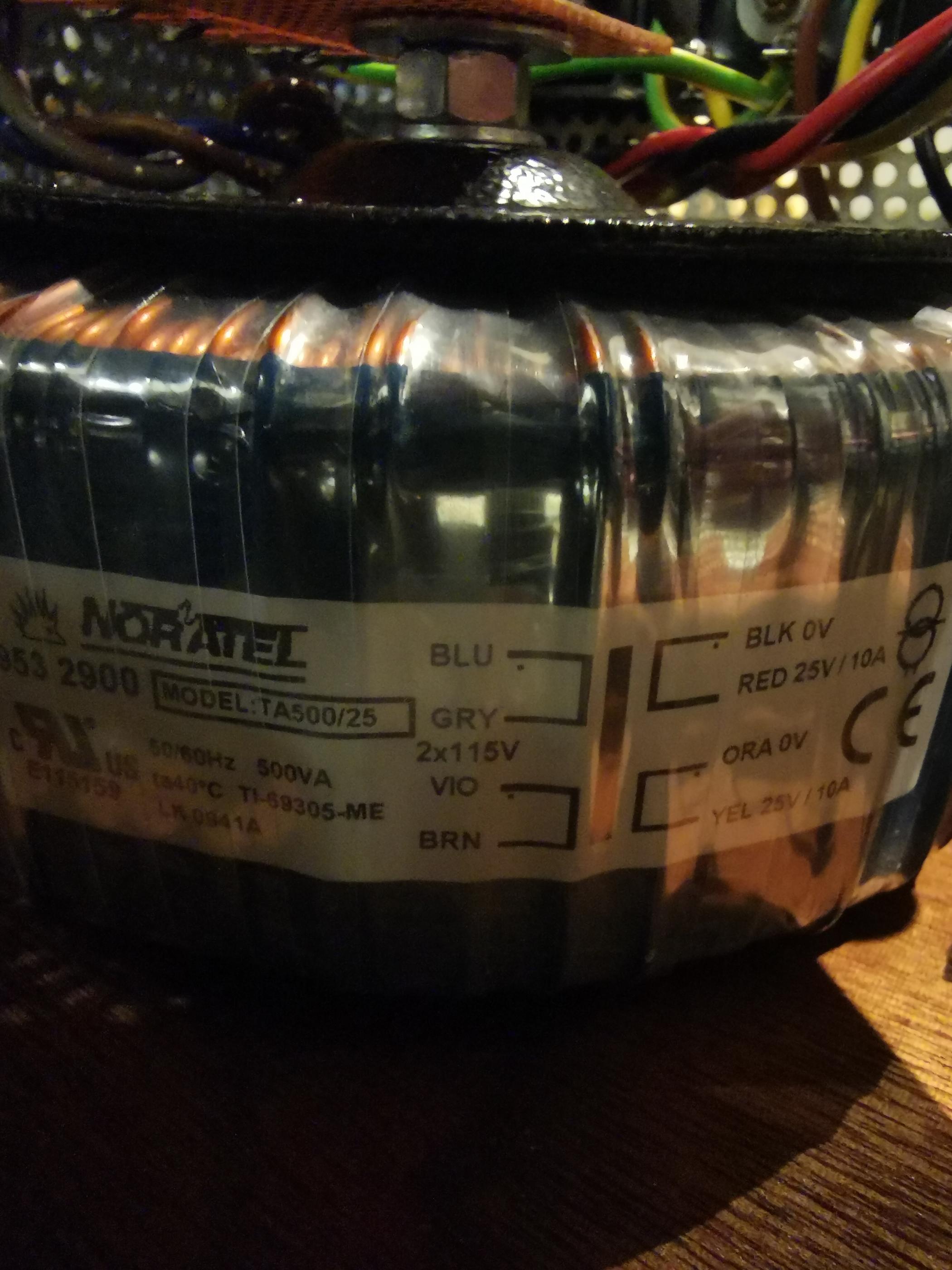

So got the transformers back in the amps with windings varnished and extra turns to reduce the output voltage. Mechanical hum is defiantly quieter, mainly the harmonics have been removed. Not sure the extra windings make much difference to the mechanical noise, will try with them bypassed next time I have time.
Can't hear the mechanical hum from the listening seat, but still quite noticabe when stood next to them. No noise through the speakers, just great sounding sweet music. Only 40degC on hottest part of heat sink, so room for more bias.
Maybe time to try a DC blocker to get rid of mechanical hum.
Hummmm.
Can anyone recommend a transformer that doesn't make mechanical hum noise when the mains voltage is 240V please? Tried lots of approaches to remove hum with some success, but guess 500VA transformer is going to make some noise.
Heat sinks are not the biggest. 40C at 0.25V bias across the source resistor, so presuming I should go smaller on the transformer?
Still sounding lovely, so happy to spend a bit more than the £40 I did on the original transformers.
Hummmm.
Have you check your mains for DC? DC on mains has been known to cause mechanical hum in transformers. If thats not the case maybe you just have a defective unit. I have had good luck with Antek and Triad Magnetics.
Thanks for the advice. I've tried a DC bolcker with no audible effect on the mechanical transformer hum. It was a design from Rod Elliott site. It seemed easier to make his recommended design than try measure the mains DC (I had the parts). I've built mono blocks and have a 500VA transformer for each channel. I'd be supprise if they were both defective, but not supprised if they weren't designed to be quiet at 240V.
