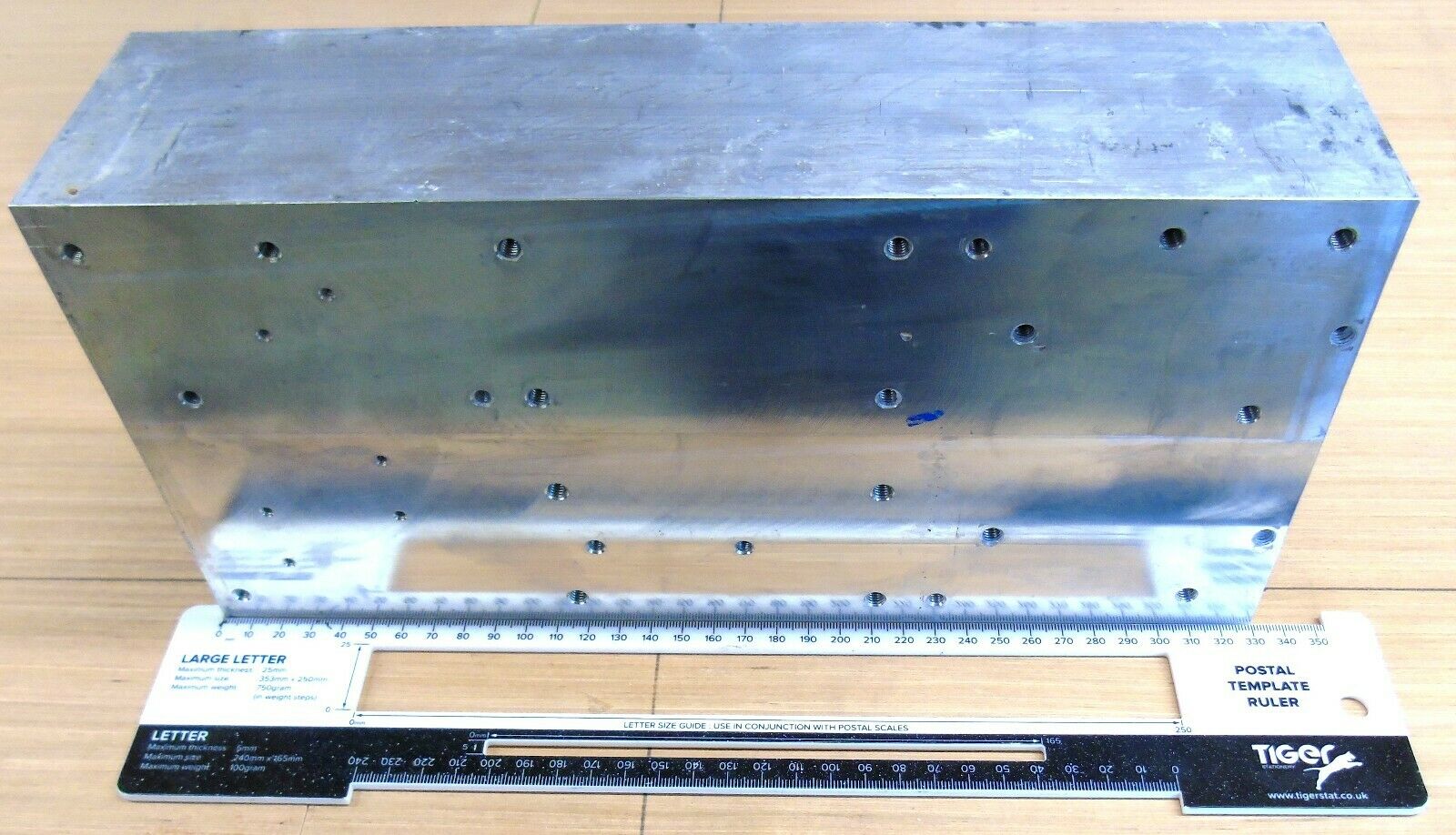

Uhm, if you're building F5 Turbos as monoblocks then I think you may be building (or should consider building) a pair of V3 amps, not a V2. And as a former owner of Pass Labs Aleph 1.2 amps, I'd suggest you consider how you will move the amps you're building. The 1.2s weighed just over 100 pounds apiece and, like all of the Aleph series amps, had a chassis made almost entirely of (sharp-finned) heatsink. Your V3s will very likely weigh far less but moving them may be painful if the heatsinks are sharp.
The rear sink on the 1.2s differed from the other three sides in that a narrow vertical portion lacked fins; that was where Pass Labs located the IEC inlet, fuse holder, single-ended and balanced inputs and binding posts. You might consider a blank (non-finned) panel on the rear of your amps to which you could attach a couple of handles as well. Just a thought.
In any event, good luck with your project!

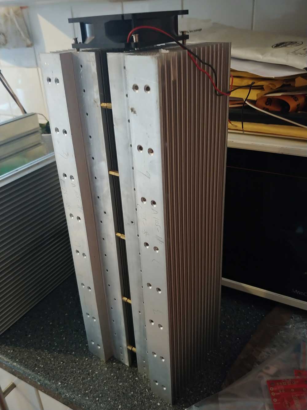

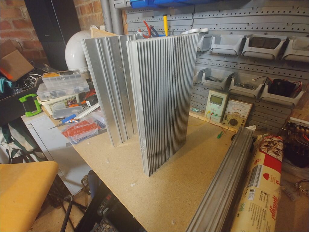

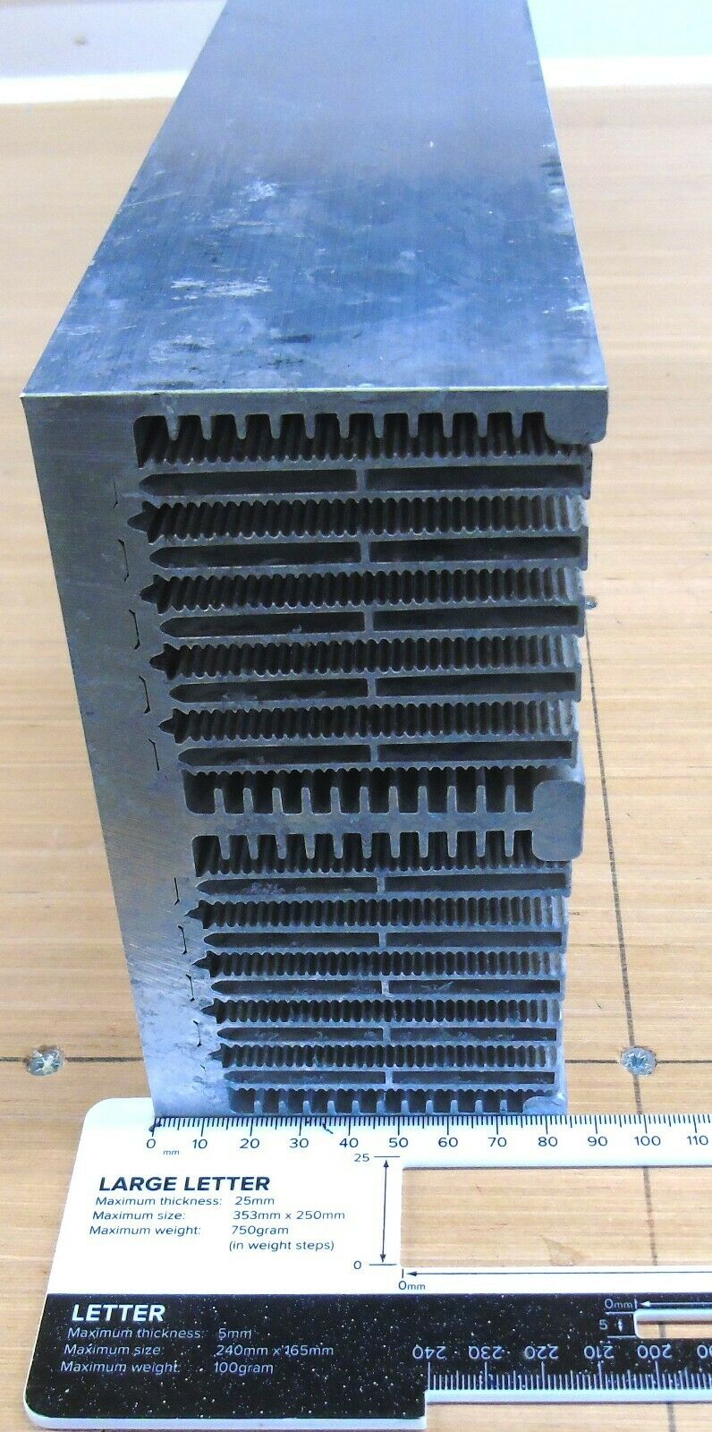

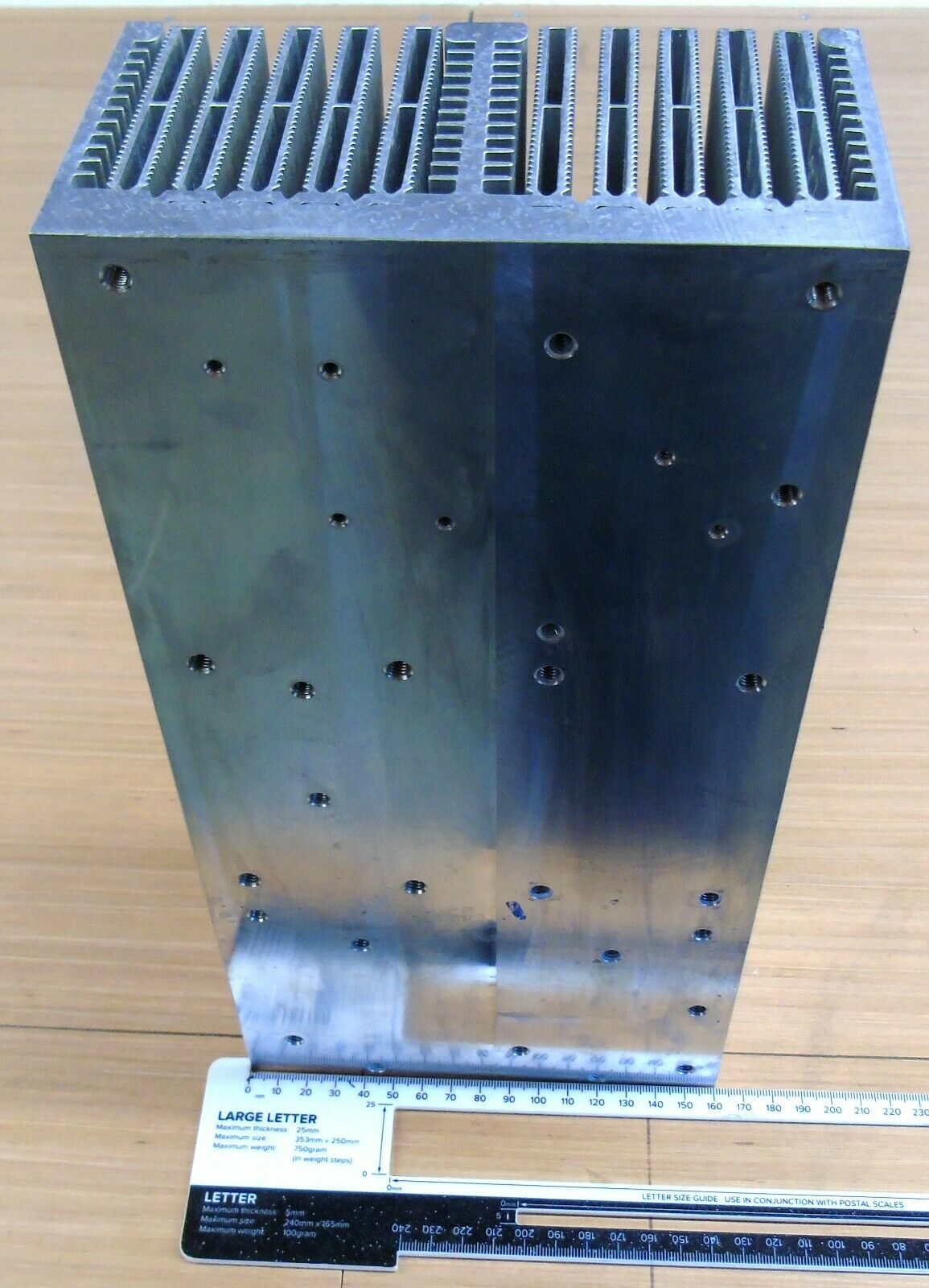

I have another set of heatsinks in mind at the bottom of this post and had a question for people here the heatsinks there have much deeper fins and are a more manageable size for an amplifier compared to stacking my other sinks up.
This is what I was looking at originally, the 4 heatsinks together to make a whole F5 Turbo V2, If that is not enough heatsink then hmmm as I feel that using 8 of those sinks to make two monoblocks would be an insane use of space in my small room! lol
4 Sinks, Stereo F5 turbo
415mm Length
230mm high together
30mm fin depth (not so big)
892764d1605275623-f5-turbo-builders-thread-www-rikibuckingham-com_20201113_120739-jpg
Possible layout
4 Sinks Upright, Stereo F5
415mm high
230mm wide
30mm fin depth
892767d1605275623-f5-turbo-builders-thread-www-rikibuckingham-com_20201113_132526-jpg
Possible Layout (Transistors further down sinks as the heat rises)
or a Heat tunnel Turbo, I think personally I would not like this as I hate fan noise! but they are lovely sinks

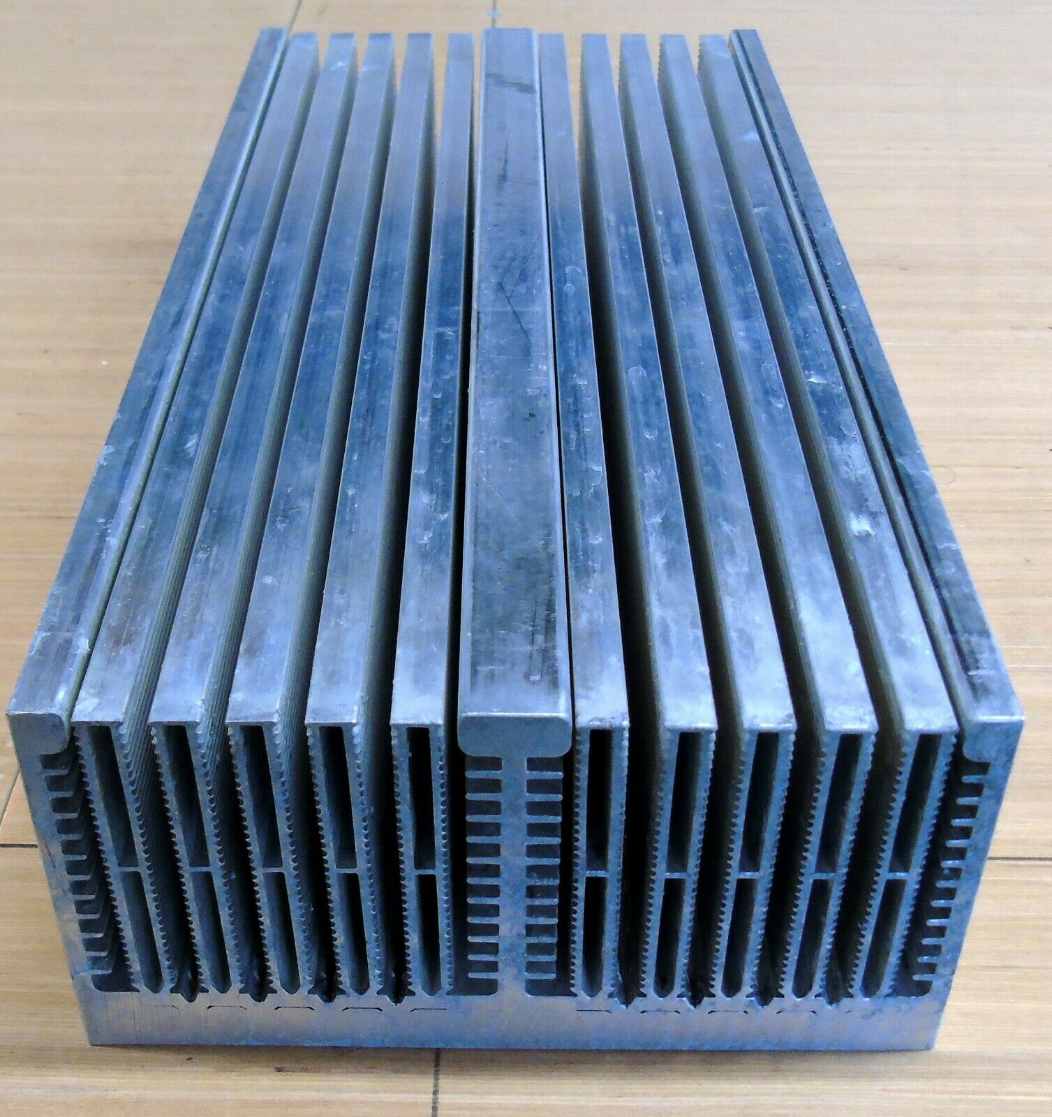

Here are the heatsinks I have found that I would prefer to use as it would just make the whole process easier, the fins are also deeper so my question is would 2 of those plus one along the back of the amp be better than the ones above ?
fins 80mm
Length 330mm
Width 160mm
My intuition tells me here are the better sinks to use, overall smaller yes but Fins are bigger, the 330mm Length is also much more suitable for an amplifier length on a work surface/living room cabinet compared the very long 415 in the sinks above.
Any thoughts ?
with shorter fins - you need to cut them and orient vertically
short but wiiiiide heatsink is much more efficient than long and narrow (tall tower)
so, all in all, it seems you have fan assistance as only choice
fans at 7-8V are very silent, nowadays
even wiithout resorting to expensive ones
Thanks Zen, I hear you this short but wide heatsink ... I should have realised, so I can keep fins upright. I could put those long sinks upright and make a tall amp?
I could get the sinks here cut maybe ... hmmmm
If you look up the specs for those tunnels, you‘ll find that they have incredible good heat-transfer IF the forced airflow is high enough...
Do you think those two sinks are enough for Turbo 2 ? as that's all I have of those heat tunnel ones.
Sorry, I can’t tell wether they‘re good or not. It depends on the airflow you‘ll get with the fan(s) you would use.
I was tempted for ma f4, but stepped back and stayed with the conventional passive massive chassis...
Compare the heatsink‘s heat absorption capacity.

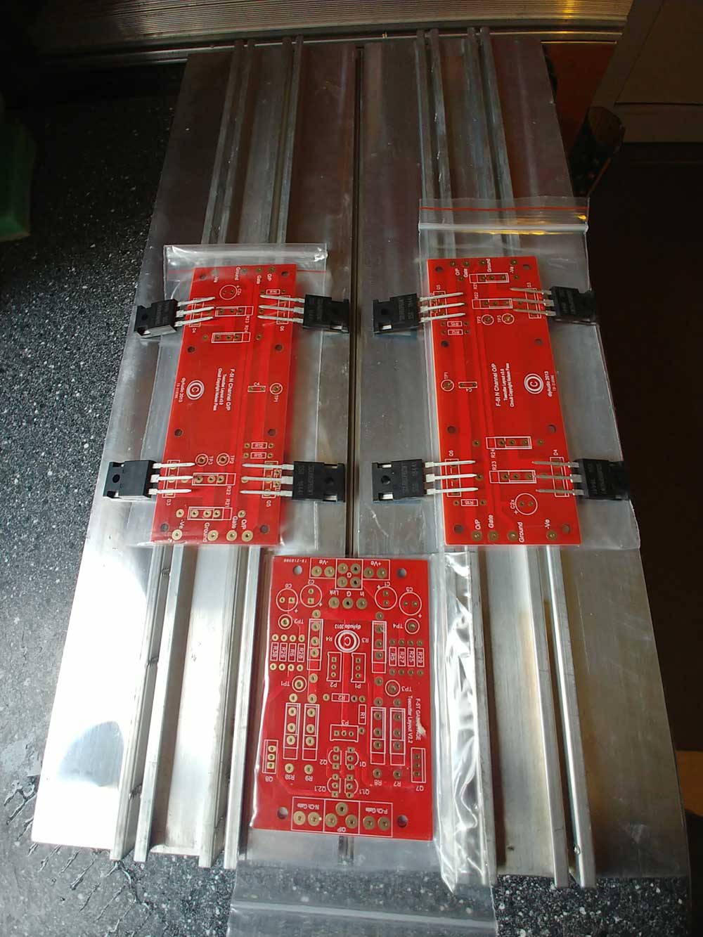

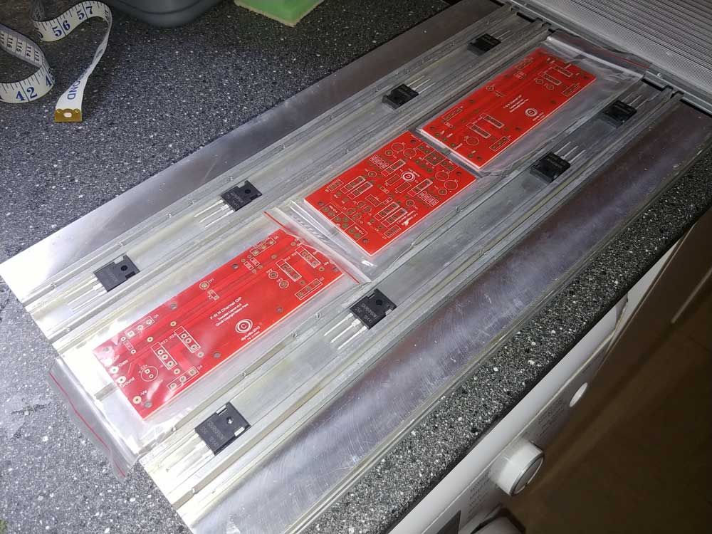

The stuffed Front End Board, couple questions and differences?
I have a few differences between my stuffed board, and 6L6 illustrated build guide. Some of those changes might be personality, and some of those differences might make a fire - and I don't know what's what! So, here's my semi-long post.
=== QUESTIONS =====================
1. I bought the "transistor kit" from diyaudiostore, it came with 2 - TIP32 (replaces obsolete 2SA1837), and 2 - TIP31 (replaces obsolete 2SC4793). Should these have a heatsink on them? 6L6 puts a small clip on version. Also in his post, he mentioned the other transistors in the PSU will make the heatsinks "live." Seems like putting an insulator between the transistor and heatsink is a good idea. How about this amazon special? I also noticed that diyaudio store sells "keratherm" pads $19. Should I insulate the PSU transistors as well as Q8 and Q7 on my Front End Boards?
2. Bourns Multiturn Pot (potentiometer). The ones I found are smaller than the ones in 6L6 post. There are three pins on the bottom, and they can go in either way: are the pin direction <up> vs <down>, <left> vs <right> important? I couldn't tell from the specs guide on mouser. Here are the two parts that I bought:
5k ohm https://www.mouser.com/ProductDetail/652-3266Y-1-502LF/
200 ohm https://www.mouser.com/ProductDetail/652-3266Y-1-201LF/
There are a couple flavors of each of those, I made sure to get the ones with the pins in a straight row. They fit perfectly, but are a little small.
3. A couple of my resistors are different looking: like smaller wattage, fireproof or not, whatever, than 6L6's selections. I didn't stray from the BOM for my selections - but a 1/4watt resistor is really small! Is that going to be a problem?
R5, R6, R25, R26, R27, R28, R29, and R30.
R5, R6: "1Kohm 0.6W"
R25, R26: "4.75Kohm-10Kohm (may be different value, see formula) only use when cascoding"
R27, R28: "4.75Kohm (may be different value, see formula) only use when cascoding"
=== COMMENTS ========================
Took me a while to find where these parts actually went. On the BOM (pdf) linked from the F5T diyaudiostore PCB page, refers to a couple depreciated parts:
Q7 = 2SC4793 only use when cascoding. Otherwise short C-E
Q8 = 2SA1837 only use when cascoding. Otherwise short C-E
Then, on the "transistor kit" it mentions the above parts 2SC4793 and 2SA1837 are both old, replaced by new parts:
And, they aren't identical.
Q1 and Q2 are these little guys, that I also received in the Transistor Kit. Ovals with one flat side. They are also different from one to the other. I didn't get a close up of the code on them - but I think they are correct to the BOM for DIYaudio F5 Turbo. You can see the four little guys (transistors?) in the bottom right here:
R7, R8, R9, and R10: 6L6 mentioned that he was using "high voltage caddock resistors" and that most people would use regular resistors. That was my route.
Joined 2017
I would isolate the heatsinks. Keratherm is probably overkill, temperature-transferwise (that is, they‘re relatively expensive)
Don‘t underrate resistor‘s wattage. They may overheat or even fry (not probable but still)
Take great care to use the correct fets and little guys. They look almost similar but are different. Correct position matters.
Get accustomed to the led‘s orientation, they only work when correct.
Trimpots are fine either way, as long as they fit in size and value.
Hth, have fun and success!
thank you very much @myleftear! It has been exciting to pull these pieces together.
On the P1 and P2 trimpots, 6L6 has arrows on them that he drew on with a pen. What's that for? Something I should measure before stuffing and soldering them down?
Stuffing the N and P channel boards. On the "BOM for DIYaudio F5 Turbo"
mentions TH1 = 4.7Kohm NTC for BOTH N channel and P channel boards. The "F-5t N Channel O/P" board only has a TH2. That's a typo right? There's a thermistor (?) on both P channel and both N channel boards: four in total.?
Also, only R11, and TH1, on P channel boards say
"use only on 1 P ch board pr channel"
R12 and TH1 (TH2?), on N channel boards say
"use only on 1 N ch board pr channel"
Each channel, Left and Right, have one P and one N channel boards. So, that's only one P channel board and one N channel board per Left and Right channel. So all boards get all of them?
Let me know if you see any other glaring mistakes on these boards - thank you very much!
