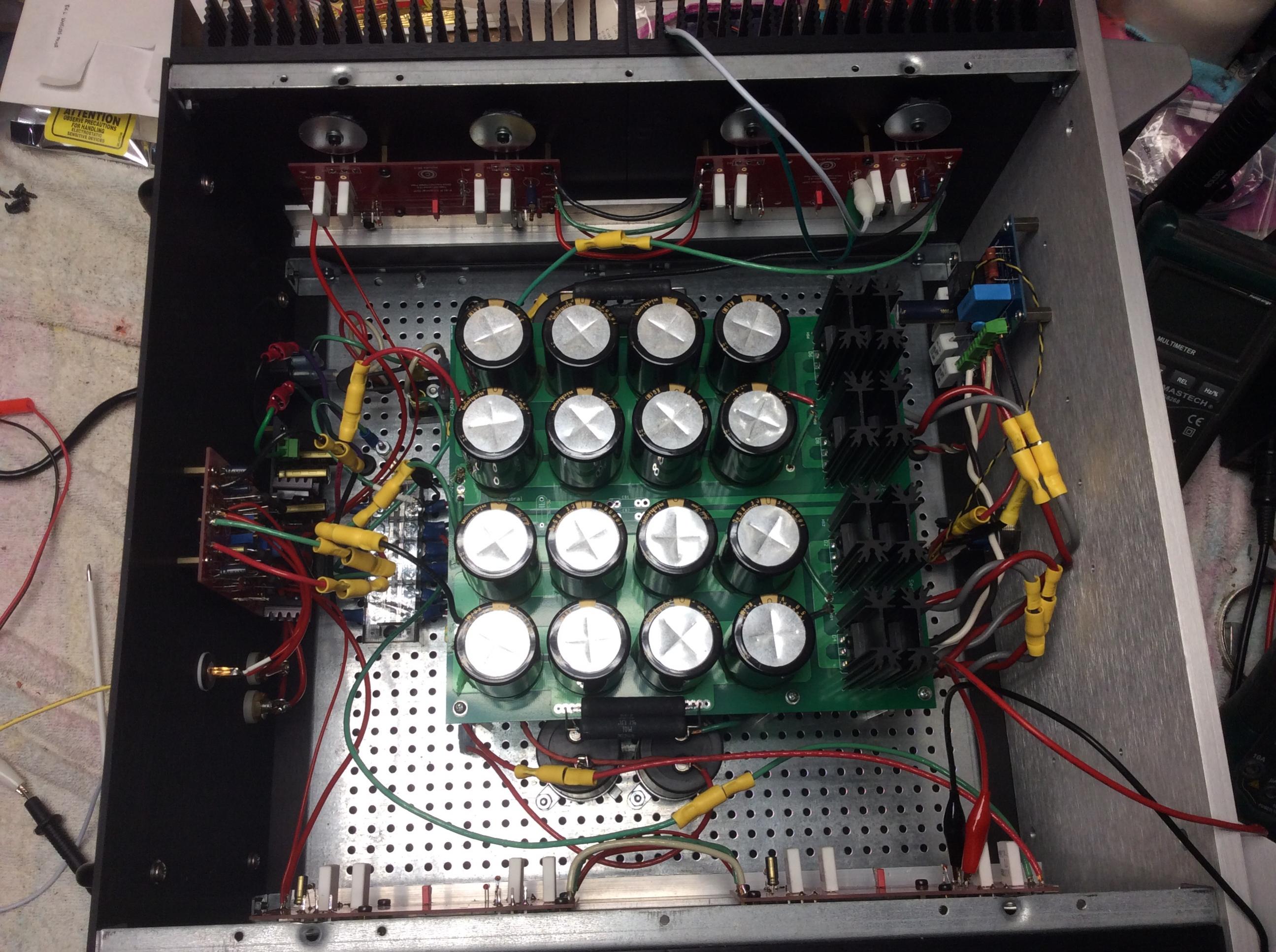

Folks:
Okay, I'm officially freaking out. Something scary is happening with one of my F5T V3 amps. A brief history: one of the two monoblocks released magic smoke months ago, apparently when a 7-year old Keratherm Red insulator failed. I replaced all of the insulators on that monoblock with AI203 ceramic pads and Kryonaut thermal paste. All of the active parts on that amp were also replaced, as were a few passive parts. That monoblock now works just fine.
As a prophylactic measure, I made similar improvements to the other monoblock (replaced insulators and upgraded some resistors). I'm now trying to rebias that amp. With P1 and P2 (the 5k pots) each dialed to below 5R, I'm reading about 12mV Iq across the test points on the P channel side of the amp and 0mV Iq across the test points on the N channel side. You'd think I was ready to set the bias, except I'm reading about 45 VDC offset at the output. Rail voltages are +-46.1 VDC.
What could have caused this?

Strange, but so interesting! Did you unsolder any of the dc wires from the boards in the process? Any other changes from before apart from replacing pads/paste? Could inverted wires be the cause? Excited about the solution here. Pics?
If you unsoldered diodes or fets, have you checked if they got mixed up? Unlikely but...
PS: are both rail wires from PSU well connected to PSU? Long shot but, if rails are 45v whqt you are experiencing could be one dead rail wire/pad lift/poor connection. Longshot that too prolly..

Andy (& Co.):
My last post was incomplete; I neglected to mention that one of the N channel MOSFETS in the amp failed when I tried to bias it a few days ago. I replaced all of the N channel MOSFETs (and the MUR3020 diodes for good measure) yesterday. I looked at but did not test the P channel MOSFETs; there was no evidence of a problem on that side.
I doubt the attached photo will help much, but the DC power lines are correctly attached. I'll verify that the N-channel MOSFETs and diodes are where they're supposed to be, but that isn't likely to be the issue.

...I'm reading about 12mV Iq across the test points on the P channel side of the amp and 0mV Iq across the test points on the N channel side. You'd think I was ready to set the bias, except I'm reading about 45 VDC offset at the output...
That would be expected, the P side has started to conduct, the N side has not. First, plug in your dim bulb tester, then twiddle the N side pot until it starts conducting, the voltage on the output will begin to drop; remove the dim bulb tester and carry on with the bias procedure.
Scott, what voltages do you see across R5 and R6? I'm surprised that the P
side is on at all when P1 and P2 have been set to near zero.
Also, what voltages do you see across R3 and R4?

Folks:
Okay, let me try to answer everyone in one fell swoop:
Before the second monoblock blew, its bias was set at +0.331 / -0.332 VDC and offset was under 2.4 mV. That amp had been working fine for years.
The power supply is properly delivering DC to both the P- and N-channel O/P boards. Rail voltages are +45.7 VDC and -46.7 VDC (P- and N-sides, naturally).
I don't have a 100W incandescent bulb on hand. With a 60W bulb, my dim bulb tester lights bright and then dims considerably but does not go completely off.
Resistance across P1 is currently set at 0R5 and across P2 it is 2R1.
Voltage across R5 is steady at 4.9 mV, across R6 it is 79.7 (but very slowly drops).
Voltage across R3 is 3.389 V, across R4 it is 3.080 V.
Offset is 45.1 VDC.
As noted above, after the first monoblock was repaired, I decided to make similar improvements to the second amp (which was working fine). So the Keratherms were replaced by the ceramic insulators, some resistors were upgraded (from 0.25 and 0.5W to 1W) and small value anti-oscillation caps were placed in parallel with R3 and R4. The N-channel MOSFETs blew on the second amp post-repairs during the bias procedure. They (and the MUR3020 diodes) were replaced with a matched quartet of IRFP240.
My working assumption is that AudioSan is correct and the P-channel MOSFETs are defective; without removing those MOSFETs from the amp, I tested the drain and source pins on each of the four P MOSFETs with my DMM in diode mode and got a reading of 0 V.
I'm clearly no engineer and everyone's guidance is very much appreciated. What do you suggest?
