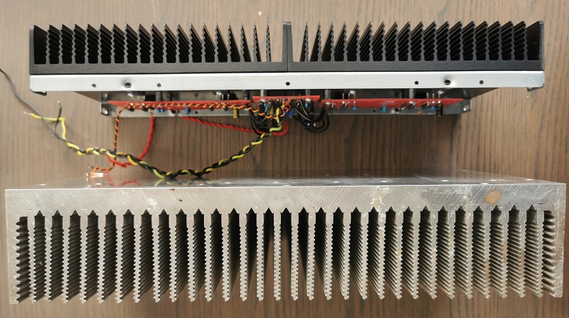

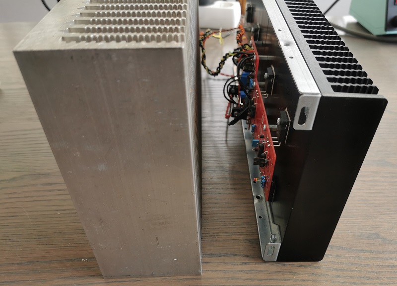

I'm thinking to build new chassis for the amplifier as i have some nice Fischer SK159 heat sinks, but on the other hand they are probably overkill. Better save them for further more powerful projects as F5-V3 or something similar?

I would use dual mono with 2pc 400VA-500VA 2x225Vac transformers and 2 PSU boards.
I would also build it as a F5 turbo V1 (a V2 without the diodes), and cascoding the input J-fets.

4U400mm and up can handle the dissipation from 2 ch V2. If you want V3 you need 2 of those chassis.
The cascoding of the J-fets are only to spare the J-fets from the high voltage rails. Running 25V parts on 32+V is not optimum.

Get the 5U/400mm instead. I mounted the power supply pcbs in my F5T V3s on standoffs above the toroids and the extra vertical space is helpful. That will leave you plenty of available floorspace if, at a later point, you decide to add capacitors to increase the size of your power supply (I did that as well, migrating from a CRC to a CRCRC).

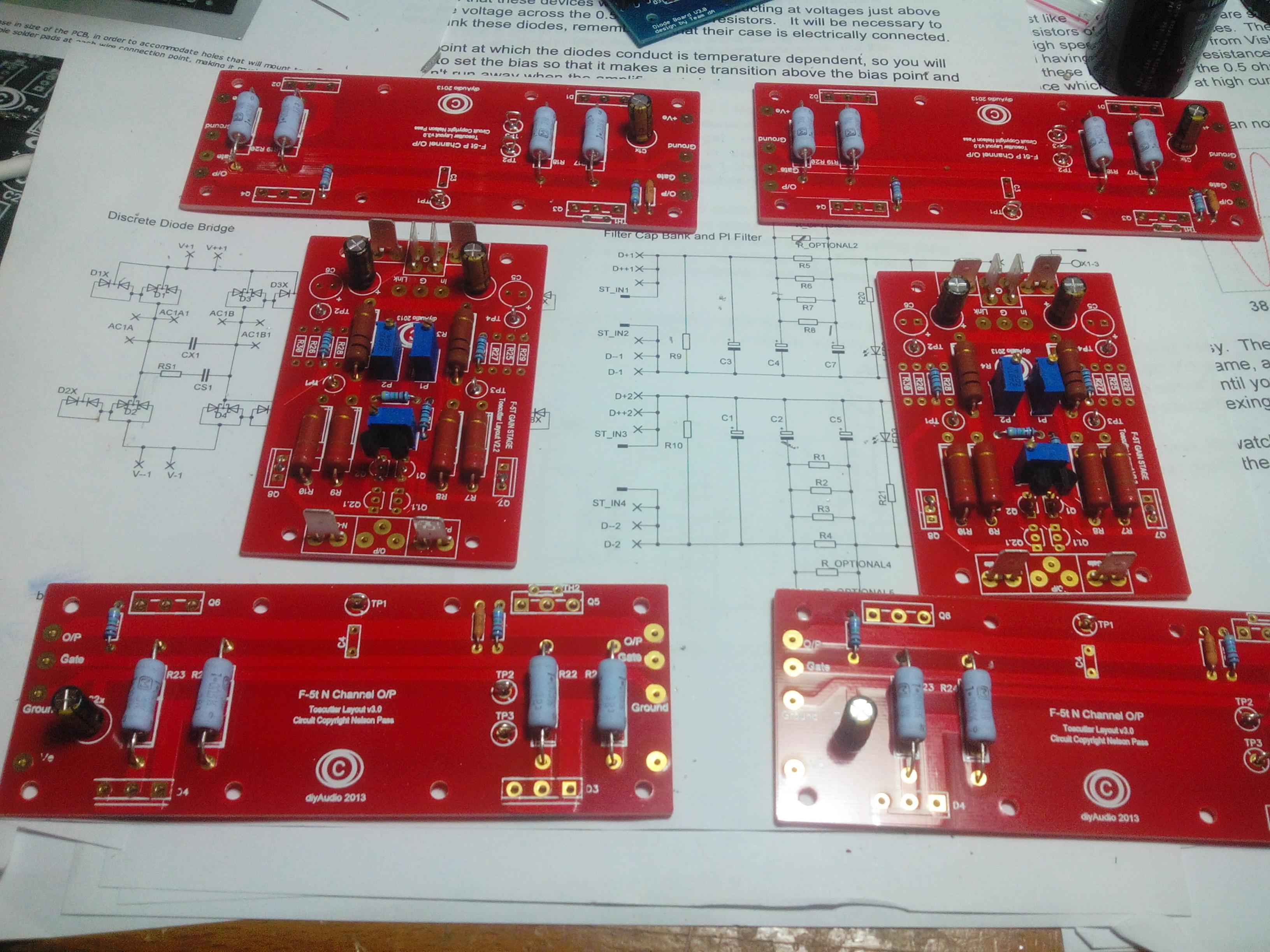

I'm starting with my F5 Turbo V1. (I've possibility to pass V2)
I've need your help.
I bought this material
On diy store:
UNIVERSAL POWER SUPPLY
BOARD F5-T
toroidal 600W with 2x25
Soft Start
Speaker protection
and
HiFi2000 4U400
My questions:
in italy there is 220V not 115v, Do I change somenthig in my power supply?
Which are the values in Test Point (TP)?
In power supply I use nichicon Cap 15000-35V, is it correct?
Thank You.
