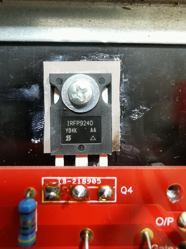

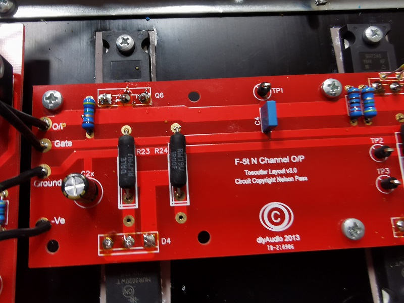

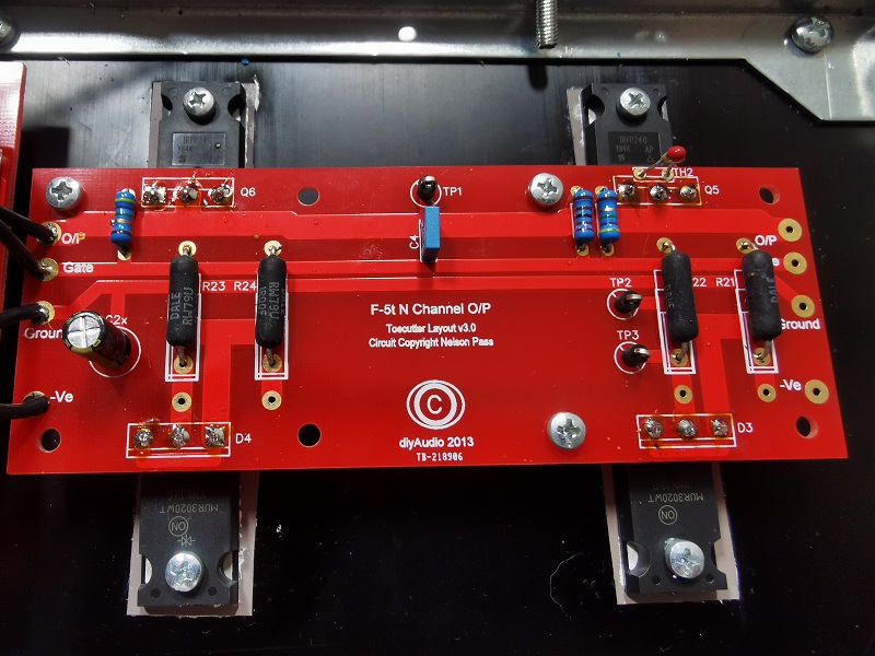

Now I have disassembled the amplifier to check the build quality and errors.
J-fets are cascoded. Source resistors have right values.
Output fets are poorly mounted, especially the problematic Q4. There is no tight contact with heatsink.
Some screws spin into the gap when I tighten them 🙁.
I don’t know how long the amplifier operated under such conditions. Would make sense to replace the output transistors or can i test them somehave?

Nice discovery! That is the most probable explanation. In my wrecked inherited build, the holes were equally screwed, no pun intended.
Not nescessary to replace fets, unless you have easy acess to matched ones. As long as they draw similar amounts of current / similar voltage drops, they should be OK. As Zen Mod says: a fet works, or it does not work. There is not much in between.
I would, as is, adjust bias waaay down, and see if they draw similar ampunts of current then. 8-10 percent pocket should be fine. If you compare now with high bias, q4 will heat more than the paired one and hence possibly draw more current.
I think you are good. The important part now is to unfu** the previous owners mistakes.
If it is not possible to use other holes, i would make a new bigger hole and use a little bit bigger bolts. Another option is new screws: sometimes that will do it. But ensure you clean the bolt hole properly first. Conpressed air and tightening a brand new bolt in and out a few times, will help cleaning it all the way down.
Sounds like they have soldered fets first, then tightened them. A road to certain disaster.
You probably know this, but I would recommend the following, once all holes actually work:
1: desolder fets once you know q4 works properly (90% certain)
2: clean holes, and / or make bigger onces
3: mount the fets to sink again, tighten not too much. Ps: ensure thermal pads are still good!
4: put in the PCB, ensuring all fet legs line up.
5: align fets and tighten goood. 1-1,2nm on all will ensure even dissipation, but requires a special tool.
6: resolder, with a BIG tip.
And of course remove all flux, and ensure all other joints are good.

If you need to use the same hole and the thread is gone you can use Helicoils. Bigger bolt may not go through the fet.
