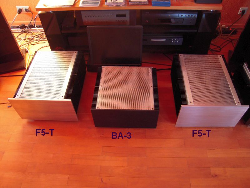

great photo! missing the f5t in the middle on a nice furniture
good and best luck to you !
The F5T are 'hiding' behind the TV. I don't like looking at equipment in my home. Maybe that's why I like the look of the ML speakers.
Anyway, enough of chat and on with the build. Hum, maybe that's why it's taken 5 years to get to here....

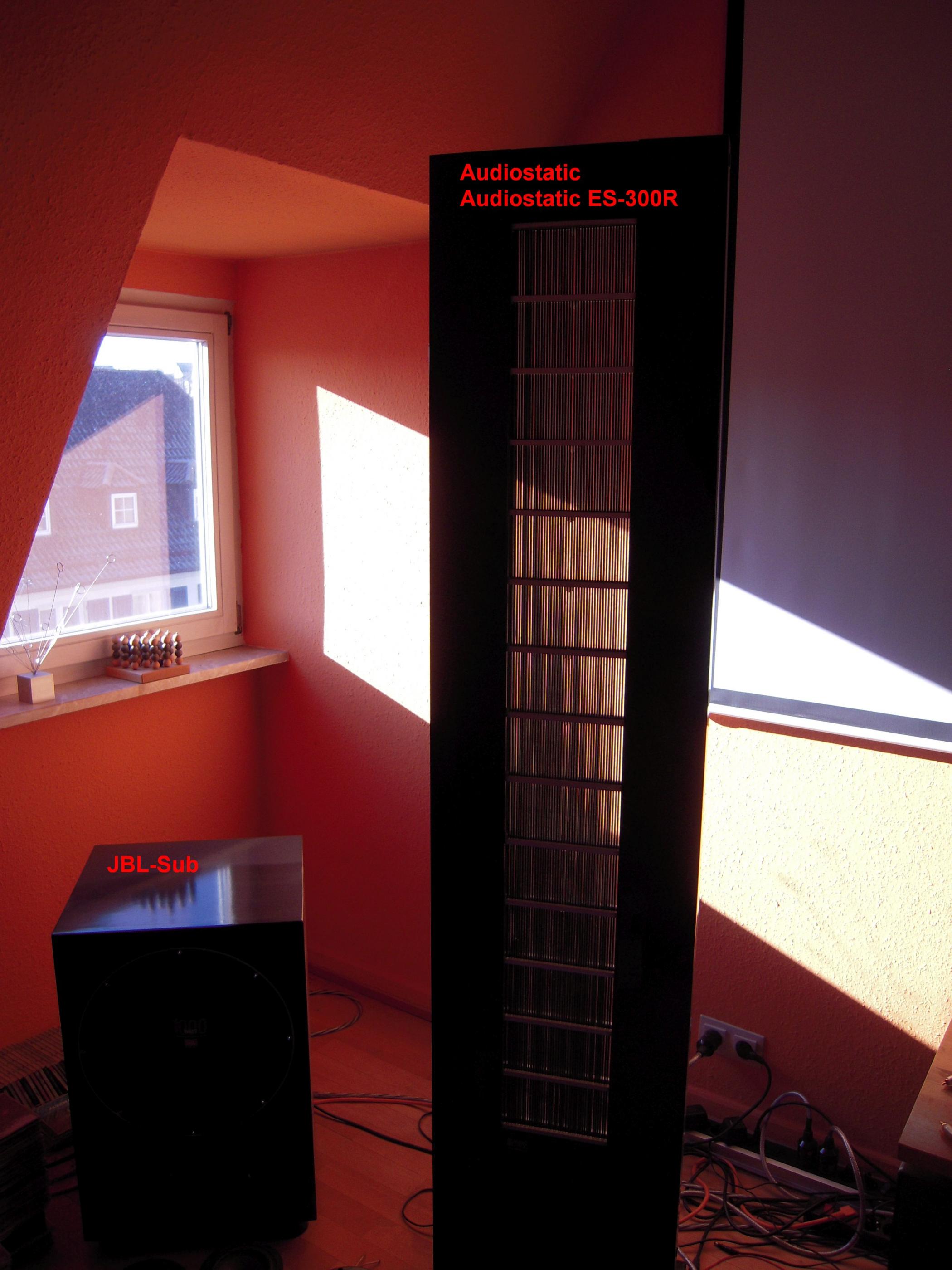

Hello Shteve,
I am using my F5-T-Monoblocks with ESLs Audiostatic ES-300R).
O.K., those are not Martin Logans but in a way similar.
I use an active crossover at 80Hz for the ESLs. They don't like to play loud at those low frequencies. The foil would have to move to far (danger of contact to the stators).
I use a JBL-Subwoofer (15-inch/38cm) below 80Hz (driven by the BA-3 amp).
It sounds absolutely awsome! The ESLs are fast and extremely detailed.
The F-5Ts do not too much in the upper frequency range with these ESLs (as reported from some members who are using horn-speakers).
I also listened to many Martin Logans. They have the same good qualities
as most ESLs (fast, coherence,....)
But I know that the Martin Logans expect an stable amp. Should be no problem with an F-5T.
You will have fun!!!!

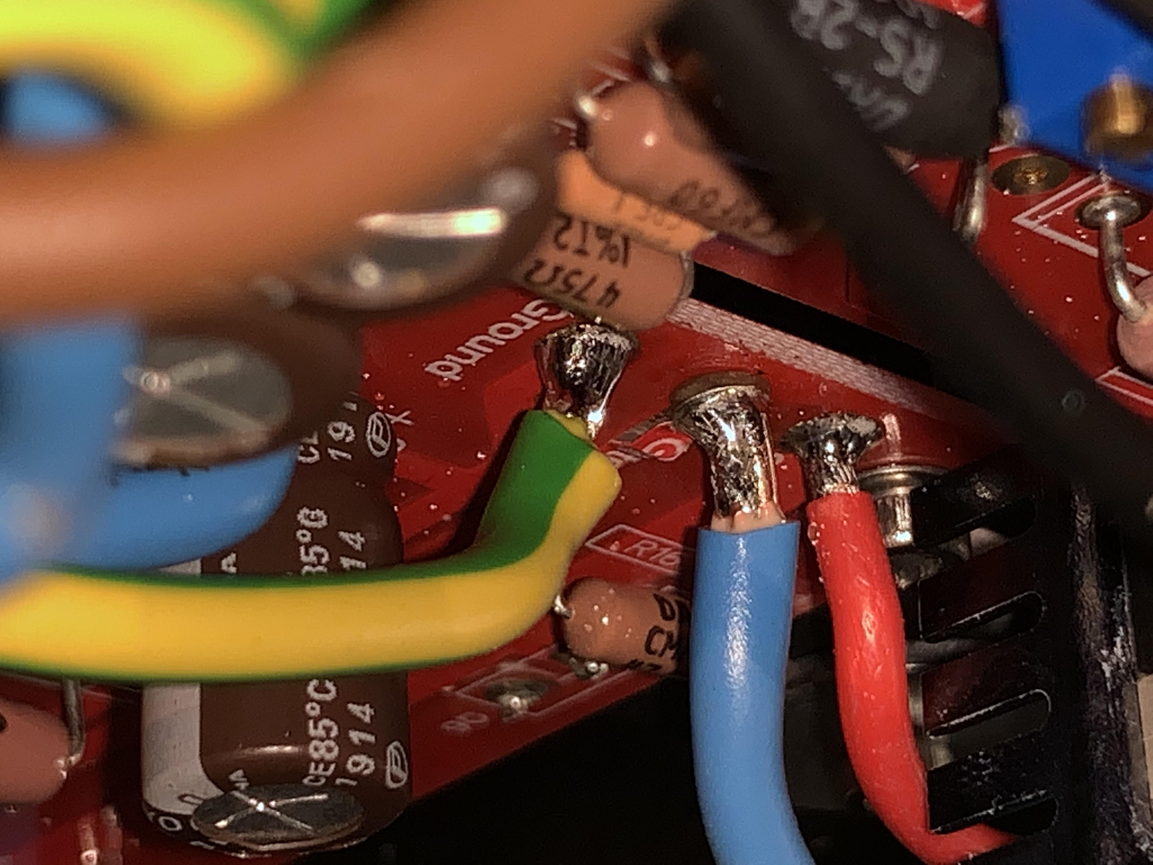

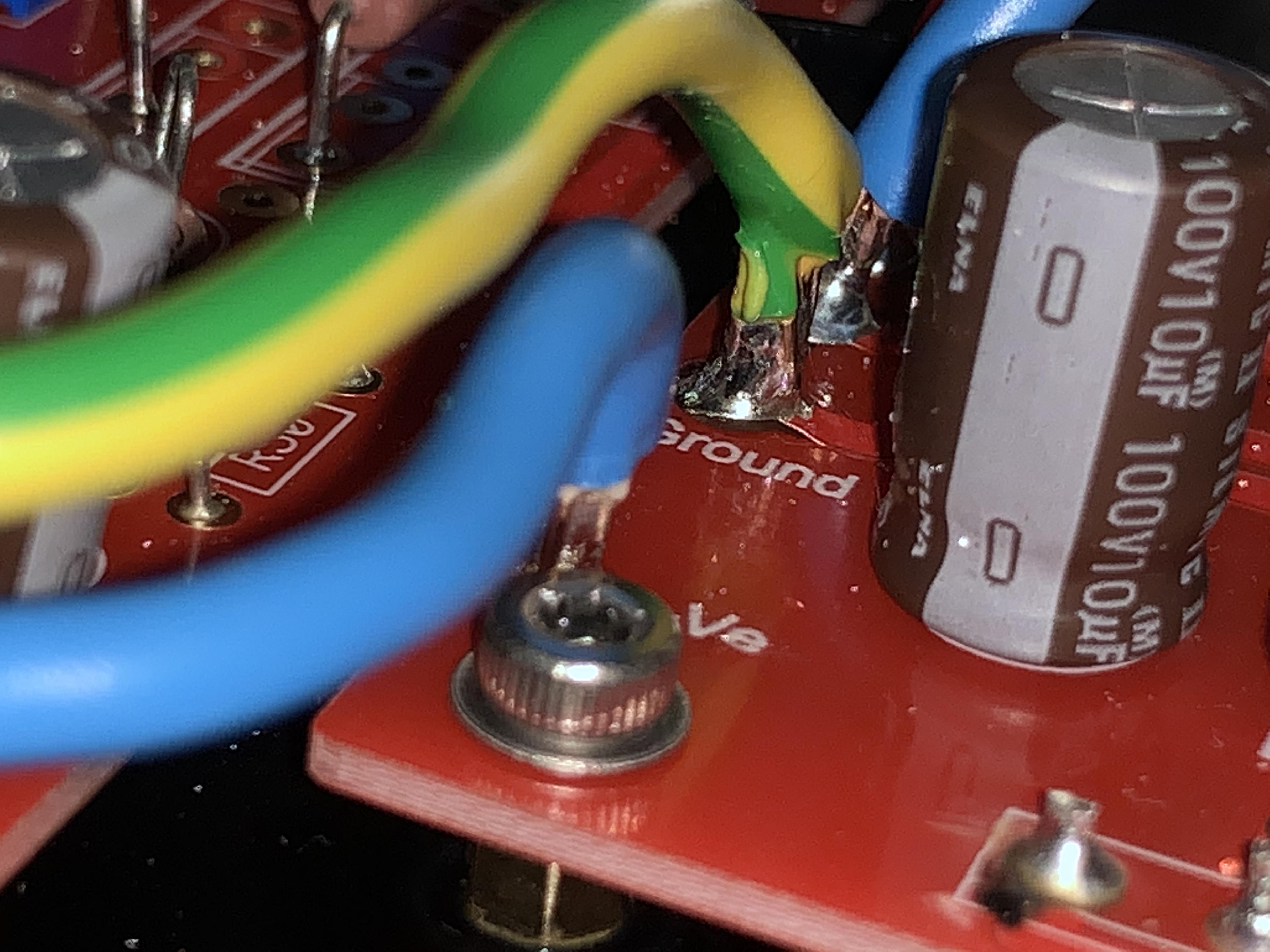

have problem with two of my f5t cards
Se pic.
Is this a problem? I have continuity to the other side of the cards.
Ya, it's a problem, you have traces that are lifted, and I bet there are other problems on the board. Even if there is continuity, anything with issues like that is/are untenable.
Epoxy Glued the lose tracks. the amp Work no problem. Used to big/stiff wire...
