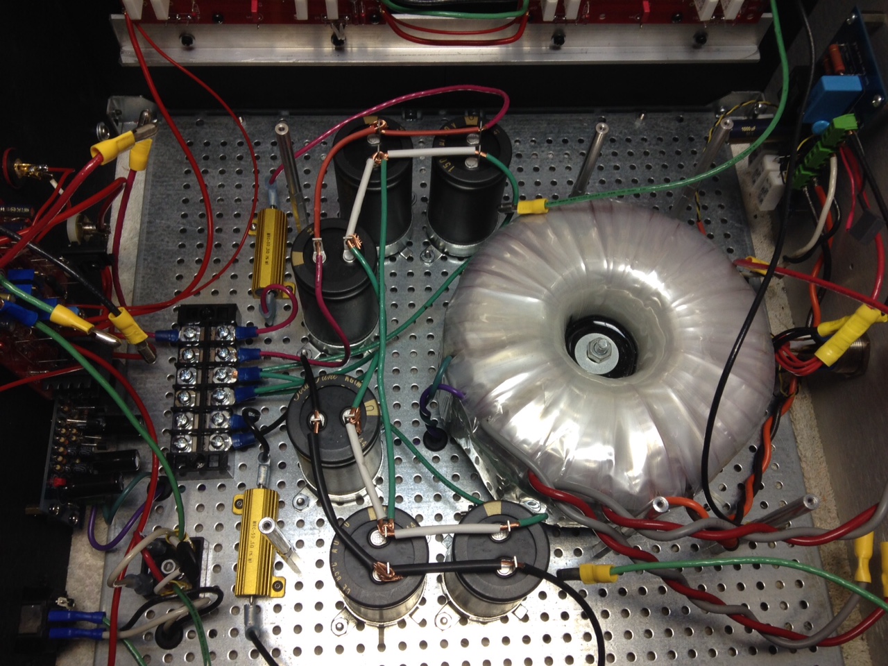

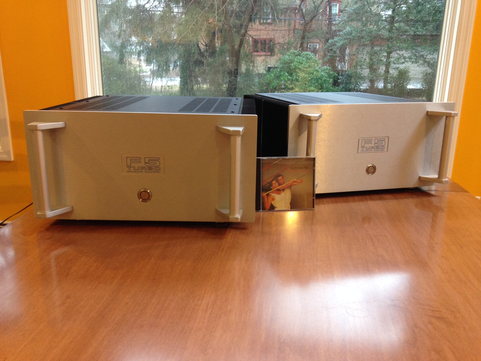

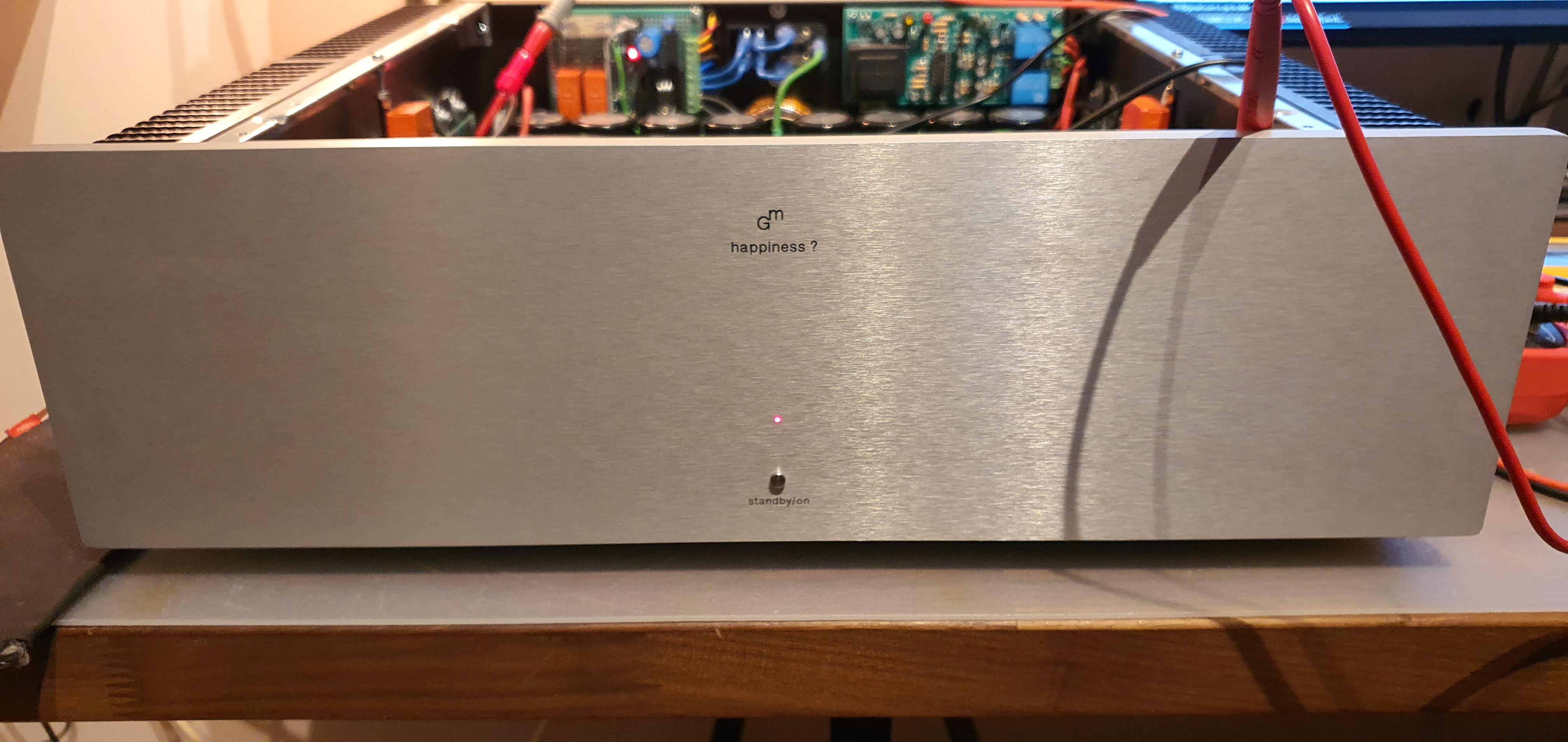

Folks:
My amp has been repaired and I suspect (to be honest, I pray) this time the repair will prove successful. As I've mentioned before, I jumped into this hobby out of a love for music and not because I had any technical skills, and my learning curve has been (at best) a slow incline. My F5T monoblock could never have been repaired were it not for the support of people like AudioSan, Sangram, Bfpca and nashbap. Many, many thanks!
And in case any other novices are interested, it seems that the first blow-out occurred because of a failed insulator pad. It wasn't until I replaced all of the active components and the insulators that the amp stopped blowing up and, even then, I managed to blow a thermistor that most likely short-circuited against a heat spreader (the lesson there: heat shrink doesn't last forever).
It's a relief to have my V3s back.

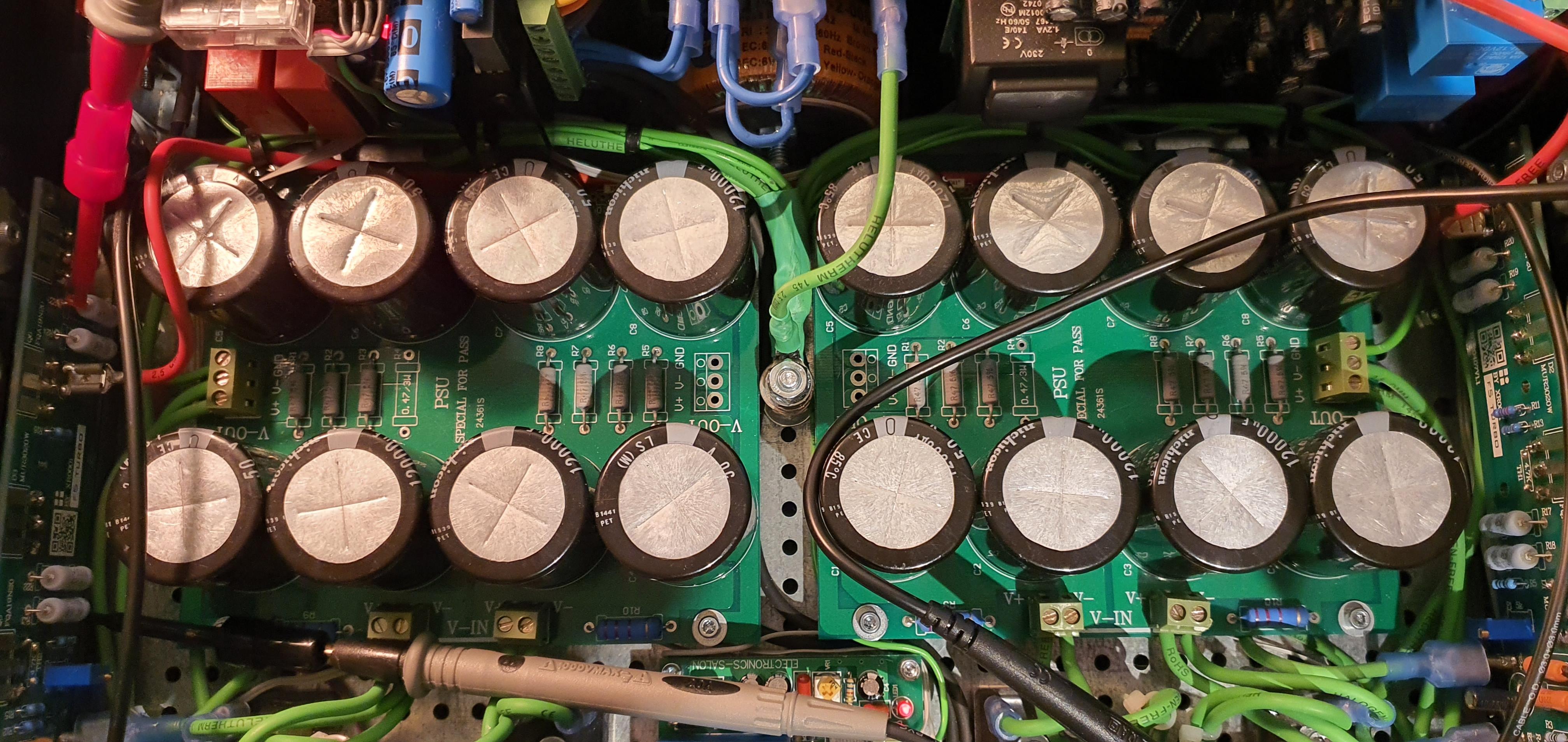

mnkosch:

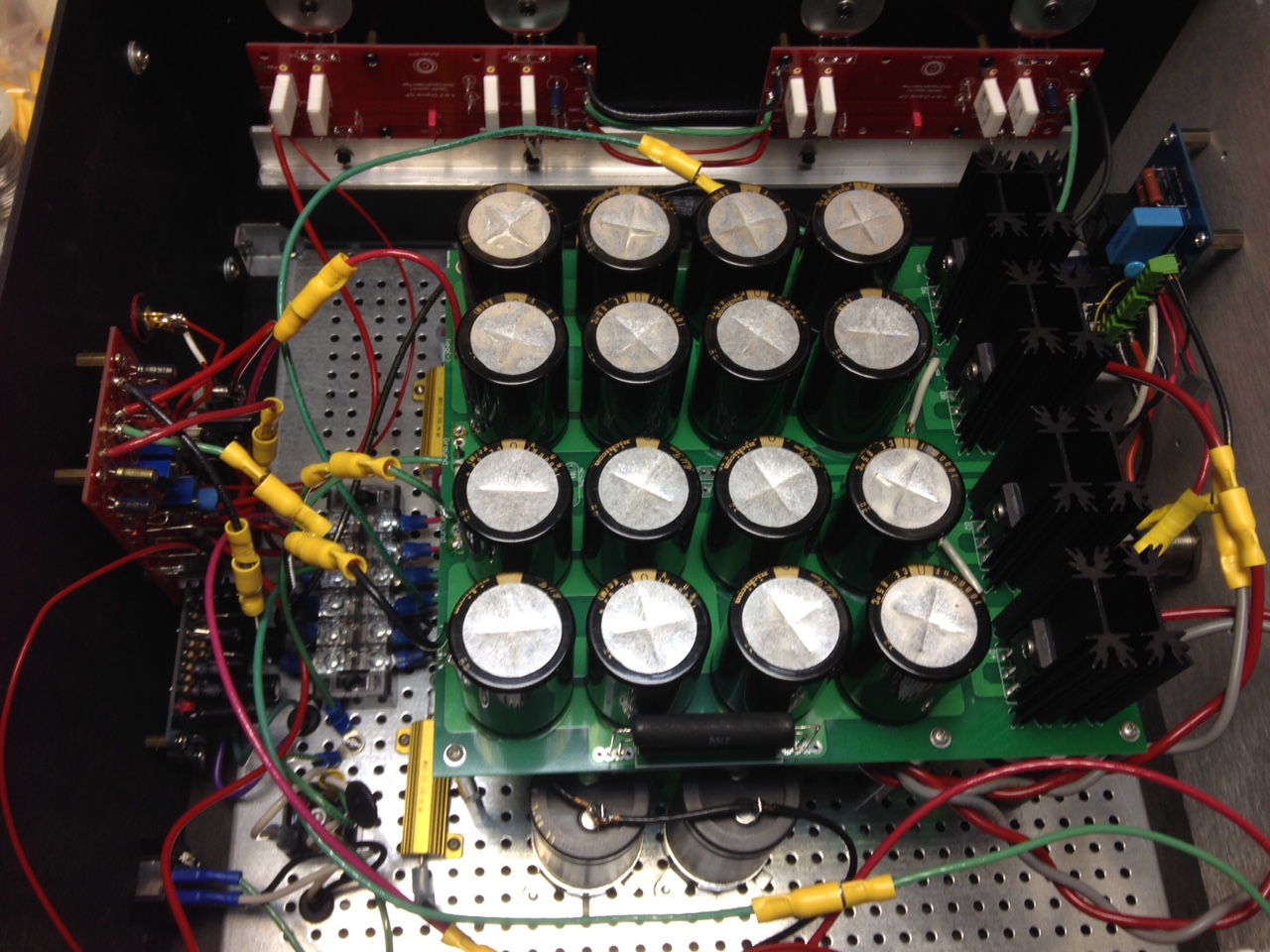

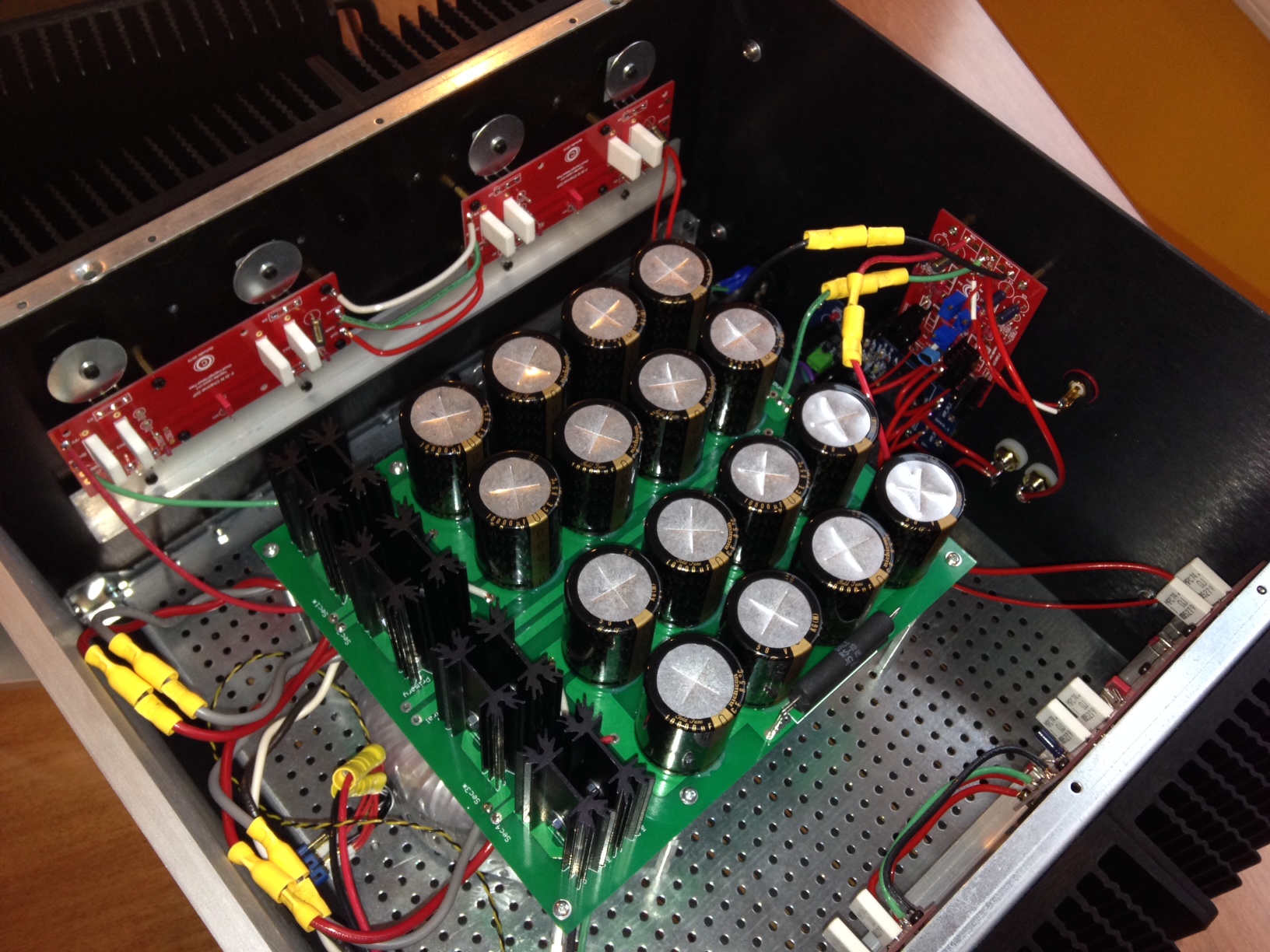

Take this with a big grain of salt, but I have some experience in this area. My V3s were built in 2013 with a power supply capacitance of 160,000 uF per monoblock (sixteen 10k caps each). The toroids are 1kw with 32V secondaries. The V3s sounded terrific but I missed the deeper bottom end that my prior amps (Pass Labs Aleph 1.2 monoblocks) had in spades. The V3s were faster and a little more delicate but lacked the oomph of the Aleph 1.2. After a couple of years, I added another 90,000 uF to each amp's power supply (six 15k caps each) and the result is far more to my liking. No bloat, great detail and a tight, deep bottom end. Your mileage may vary, of course.
Scott

Hi Scott,
Great information, thanks for sharing. I have inefficient mirage m3si towers so will target somewhere in the neighborhood of 250,000uf... probably will use 16x of the caps posted above for a total of 240,000uf per block.
Might I ask how you went about adding the additional caps? Sounds like a difficult task 😉

It wasn't very hard, actually. I should have mentioned this in my last post, but the power supply pcbs I used in my F5T build were designed and supplied by Buzzforb, another diyAudio member who years ago hosted an F5T group buy. His power supply boards were large enough to hold sixteen 35mm caps (and he supplied Nichicon KG Super Throughs to boot). I mounted the power supply board on standoffs above the toroid. There was sufficient space under the board and to the rear of the toroid to mount the six additional caps (and I used the Nichicon KG Super Throughs there as well) and a couple of 50W 0.1R power resistors.
You might try reaching out to Buzzforb. He is probably out of those power supply boards, but who knows...

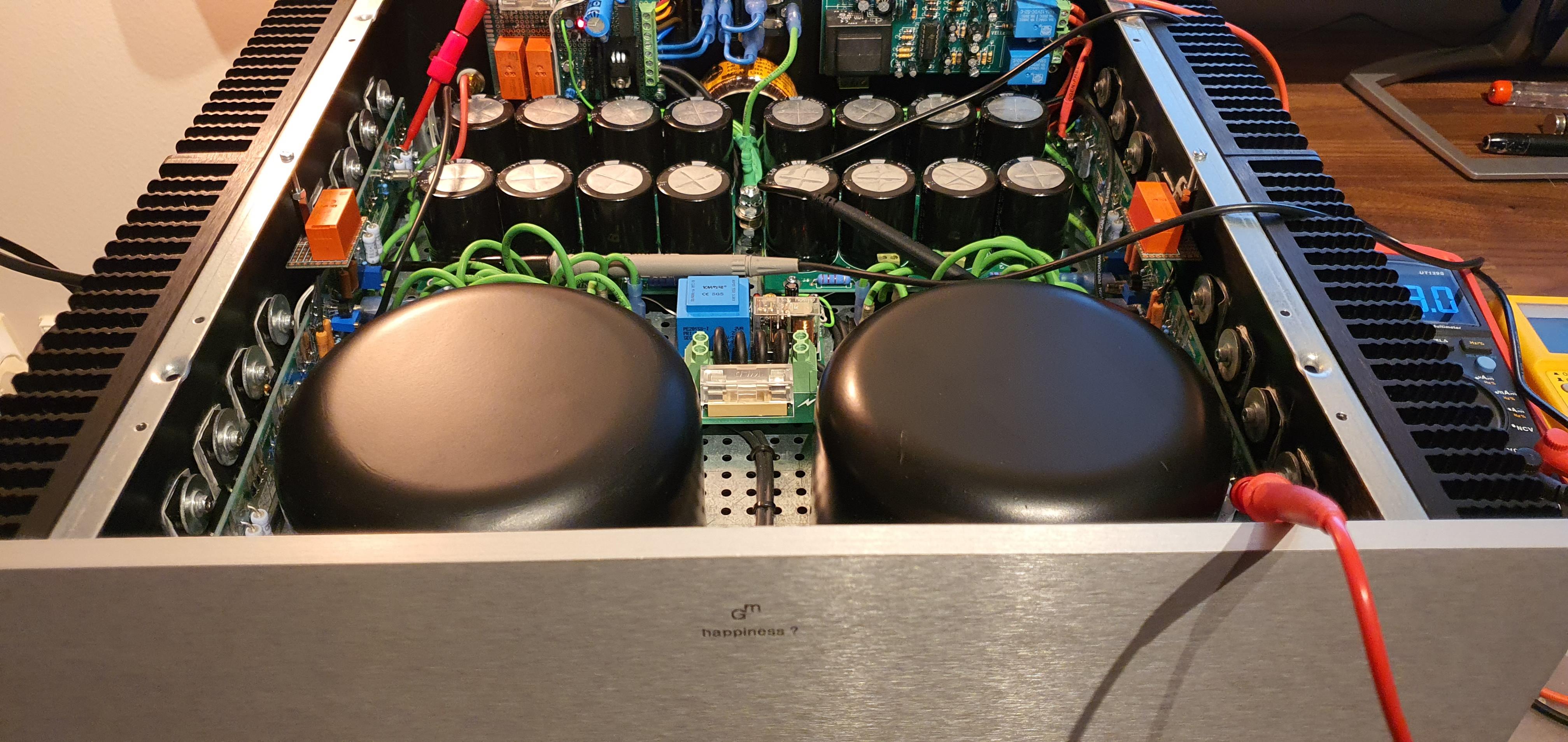

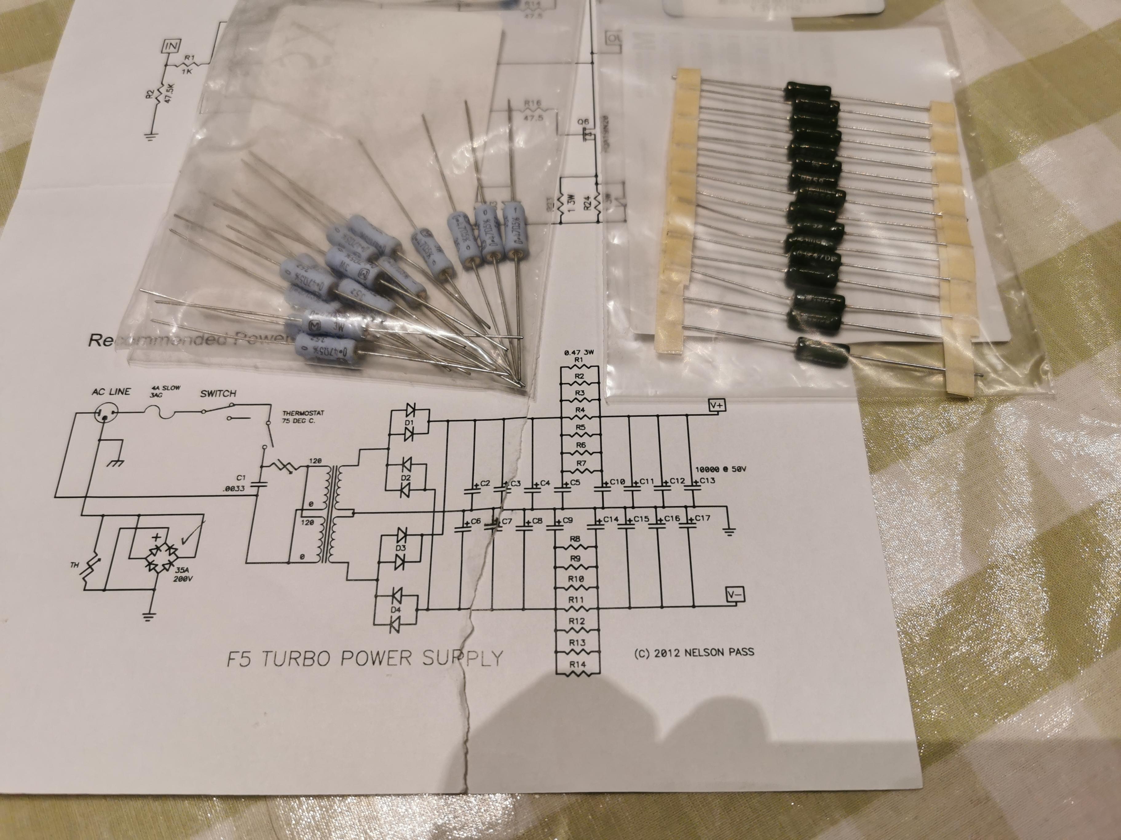

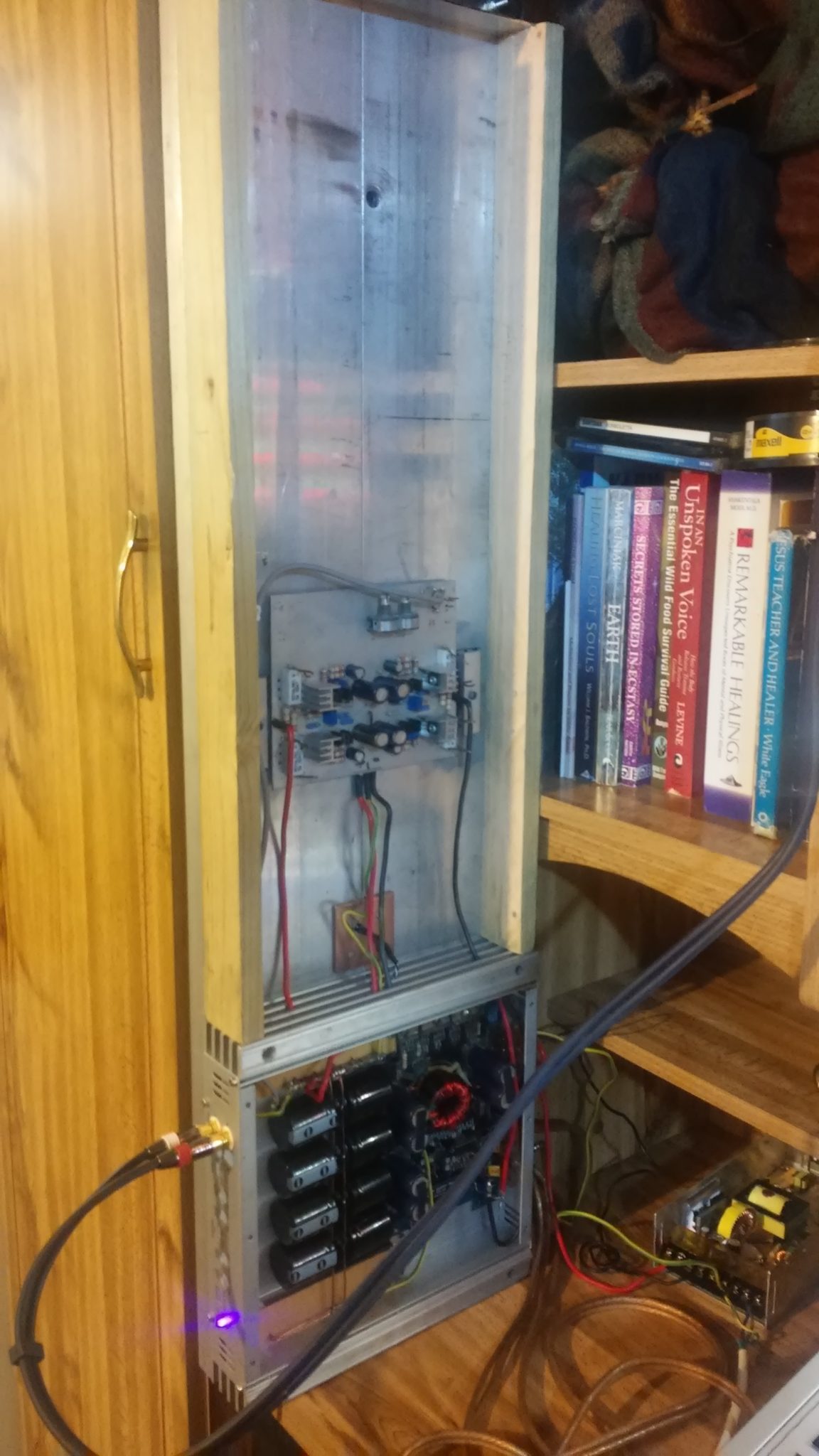

Slow progress is still progress! I bolted the bridge rectifiers to the chassis today. Steady Steve...think I'd better have a sit down and listen to some tunes to recover.
Also, it looks like past me bought 2 sets of the PSU 0.47 ohm 3W resistors. Panasonic like Mr P and Vishay wire wound. I realise either will be fine but which to chose? Its almost like buying the same record twice and asking which sounds best because my TT is out of action.

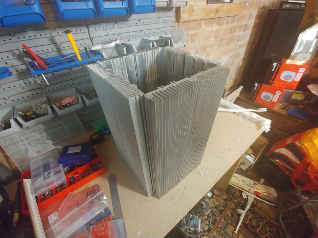

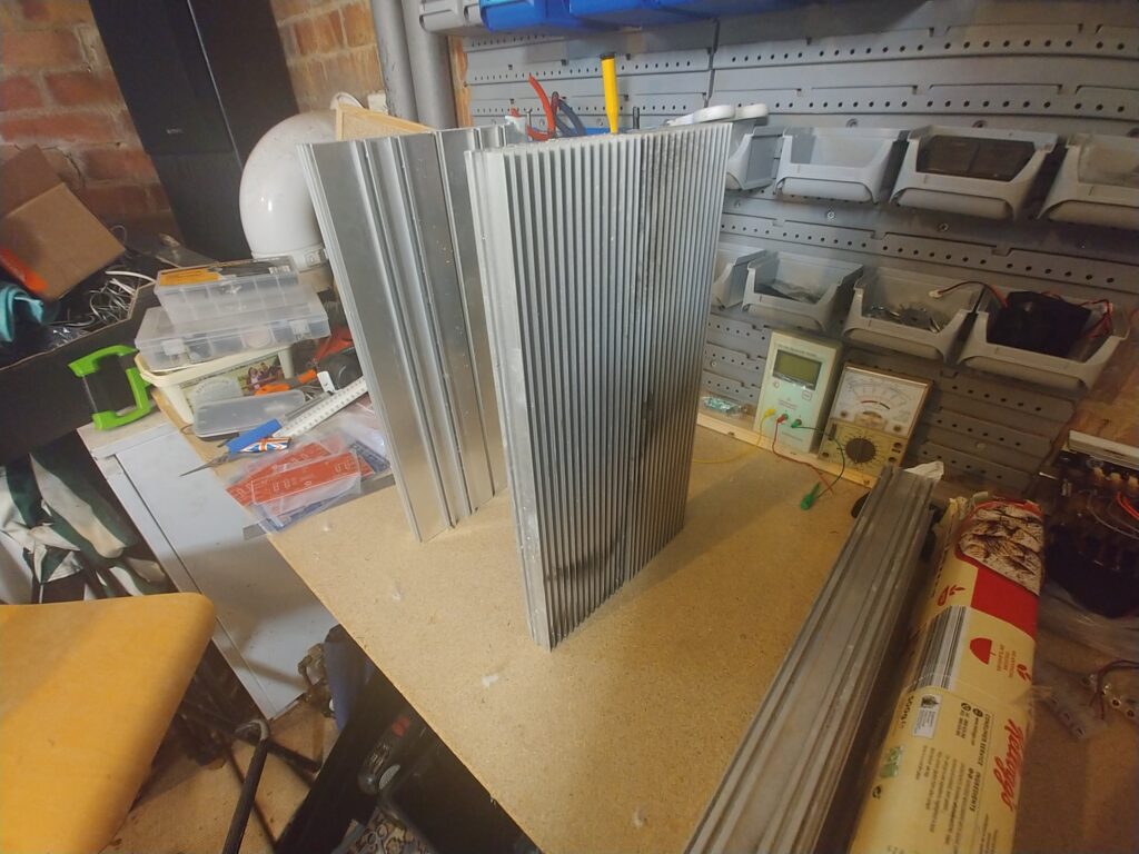

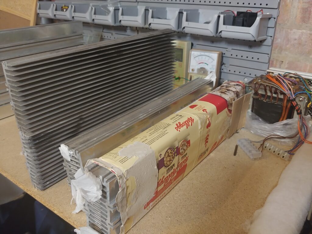

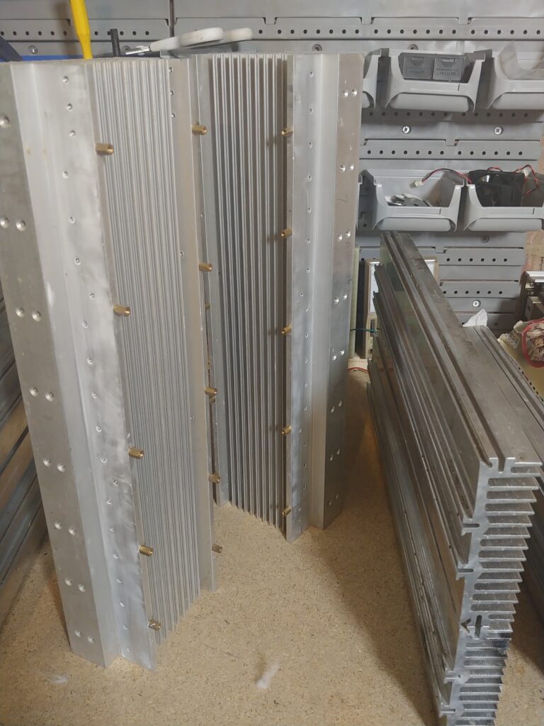

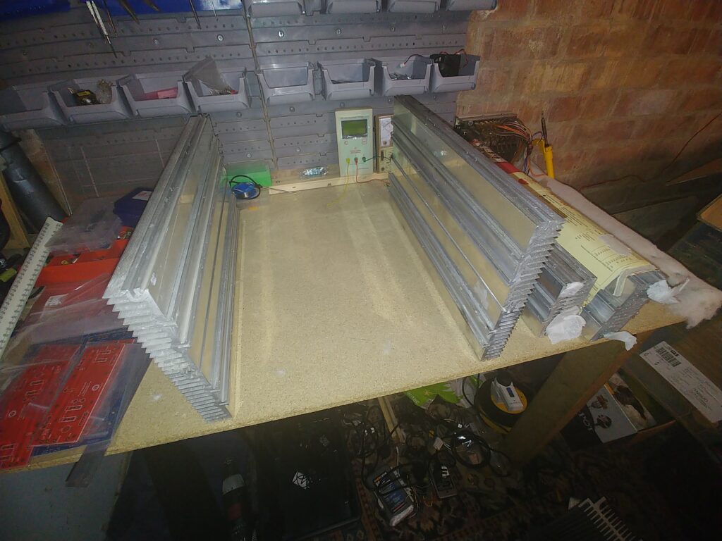

Hey Diy people
So I've decided Im going to share my whole build here to help others and take on any ideas from other people here. It's a slow build and im in no rush so want to take care making this V2 Turbo.

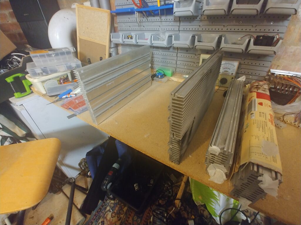

I have the following 8 heatsinks and was thinking of either using them in to build mono blocks either in horizontal or vertical configuration. I know heat wise Vertical is a good idea which I did for My Jean Hiraga build and somehow I kind of like this tall amplifier.
Im using the Diy Audio F5T boards and the Universe Power supply, the Turbo boards I have seen already will not be easy to fit to the shape of the heatsinks but ill find the way 🙂
If anyone has any other ideas let me know! and also anyone know whats best to clean the sinks ?

The new heatsinks for the Turbo V2
Config 1 Horizontal (one of two mono blocks)
https://www.rikibuckingham.com/wp-content/uploads/2020/11/www.rikibuckingham.com_20201113_120739.jpg
https://www.rikibuckingham.com/wp-content/uploads/2020/11/www.rikibuckingham.com_20201113_120752.jpg
https://www.rikibuckingham.com/wp-content/uploads/2020/11/www.rikibuckingham.com_20201113_120832.jpg

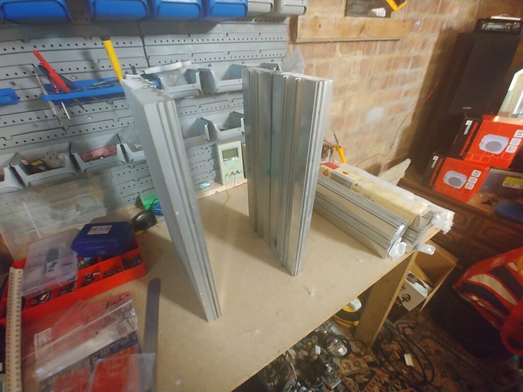

Config 2 Vertical (one of two mono blocks)
https://www.rikibuckingham.com/wp-content/uploads/2020/11/www.rikibuckingham.com_20201113_132526.jpg
https://www.rikibuckingham.com/wp-content/uploads/2020/11/www.rikibuckingham.com_20201113_132529.jpg

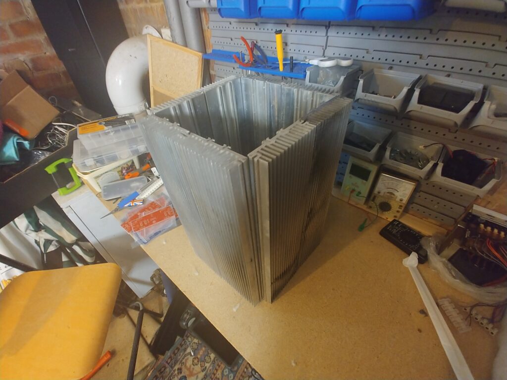

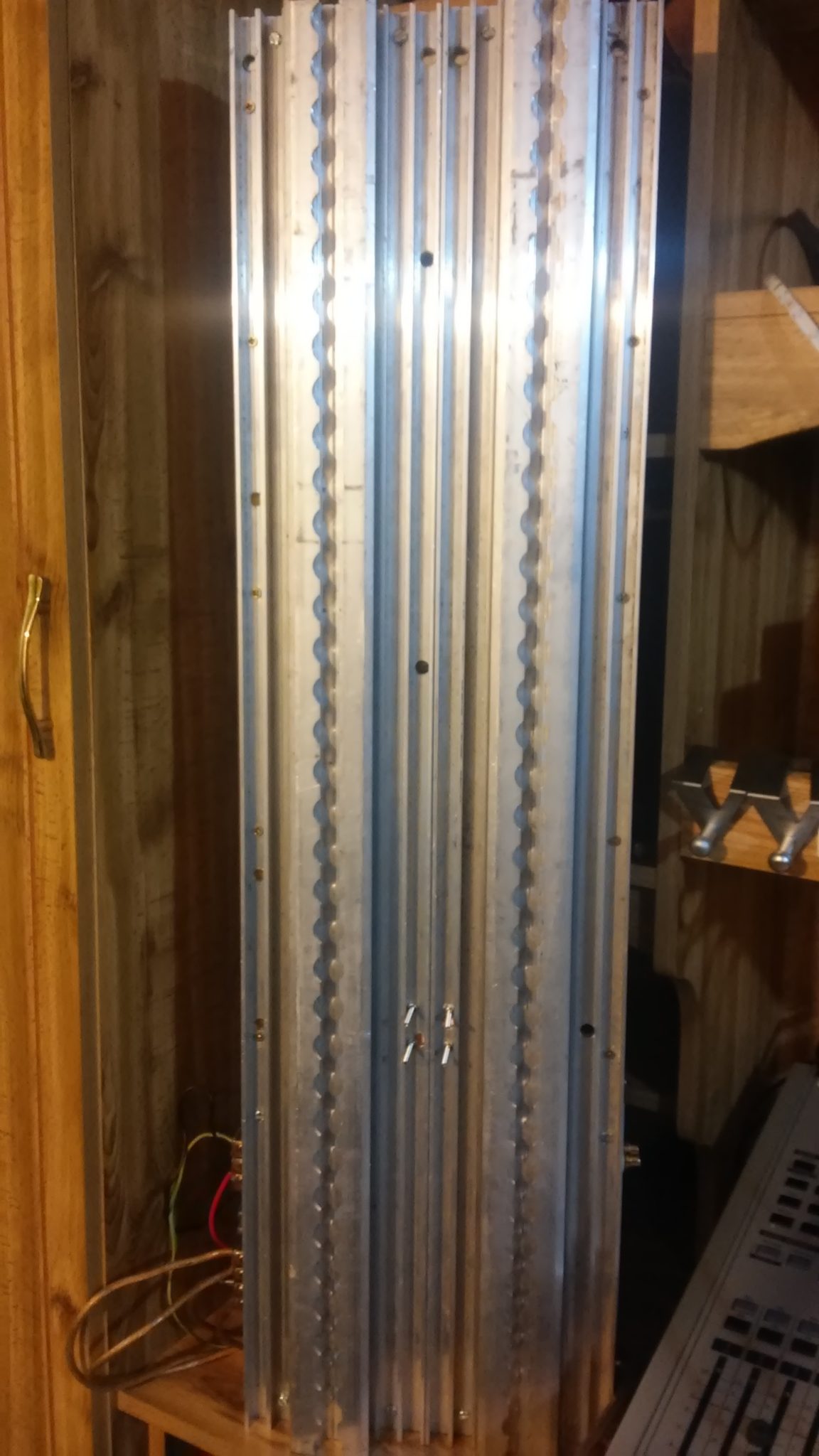

Config 3 a crazy Aleph style Vertical stereo amplifier (I think this would just be too heavy and insane ?)
https://www.rikibuckingham.com/wp-content/uploads/2020/11/www.rikibuckingham.com_20201113_132702.jpg
https://www.rikibuckingham.com/wp-content/uploads/2020/11/www.rikibuckingham.com_20201113_132706.jpg
