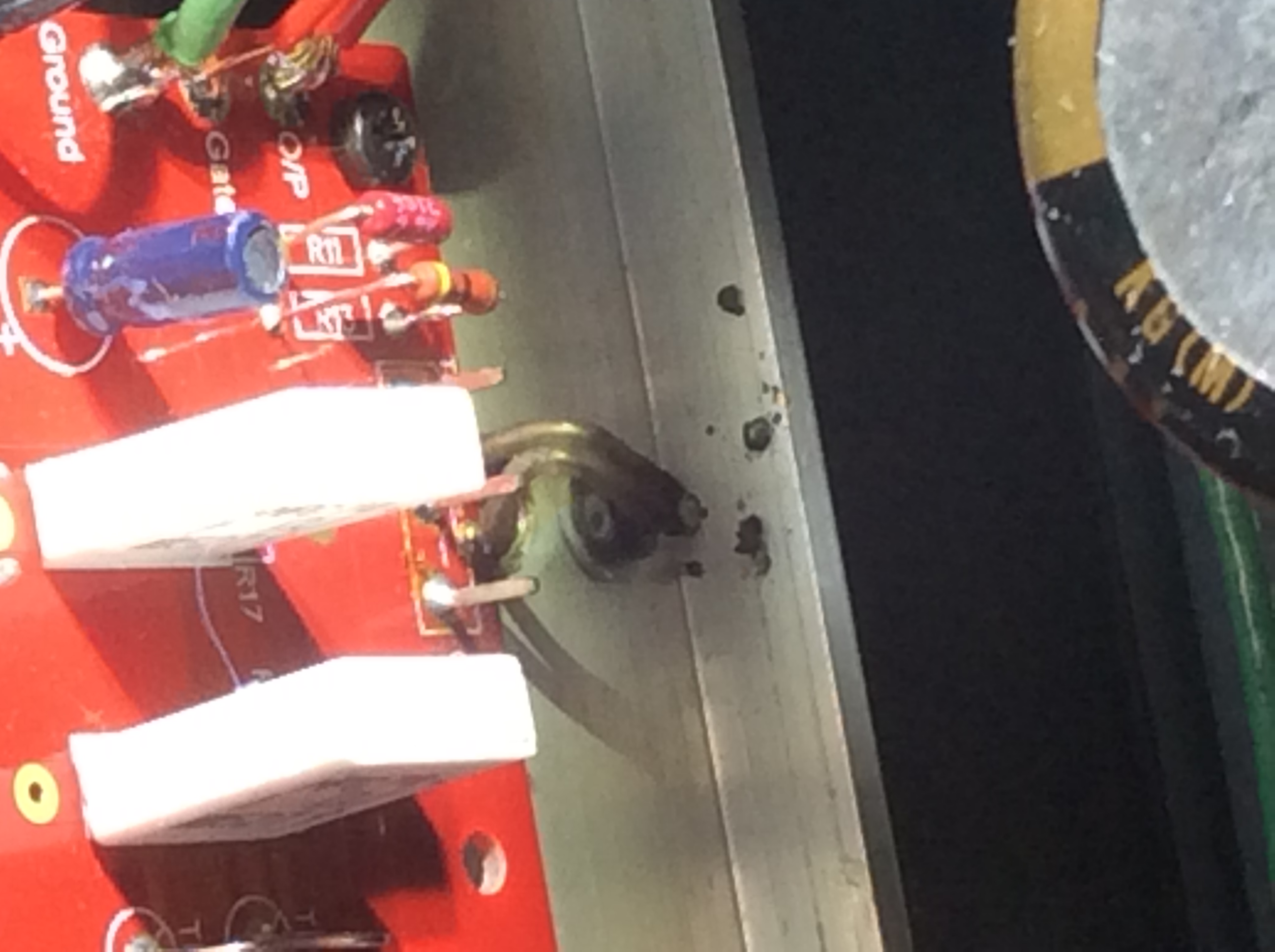

Folks:
I'm back and still flummoxed. One of my F5T monoblocks blew in late August and I've been chasing the problem ever since. I replaced all of the active components (the MOSFETs and MUR3020 diodes on the output boards and the jfets and cascode transistors on the front end board), upgraded the wattage on many of the resistors, added 470 pF caps across R7 and R10 on the front end boards, and replaced the Keratherm Red insulators with AI203 insulators and thermal paste. This afternoon I dialed down P1 and P2 to 0R, reassembled the amp, plugged the amp into a dim bulb tester, checked the guidance everyone has provided so far and triple-checked everything before turning it on. The bulb lit and slowly dimmed. I breathed a sigh of relief. Then the thermistor on the P side flared and burnt out (rather impressively).
The photo shows the thermistor after I pulled it away from its point of contact with Q3.
I'm lost.
I don't want an anchor. I want this amp to work. Any suggestions?
Thank you,
Scott

AudioSan:
That's possible. The legs of the thermistor are covered in heat shrink but its plausible that there was a gap between the heat shrink and the head of the thermistor. A large hole was drilled into the heat spreader that pins all four MOSFETs on that side to the heatsink; the thermistor pokes through the hole and touches the plastic body of the MOSFET. I thought the thermistor was centered in the hole, but who knows?
Do I need to remove and test all of the active parts (again!) or, if your suspicion is correct, can I get away with just replacing the thermistor?
Scott
