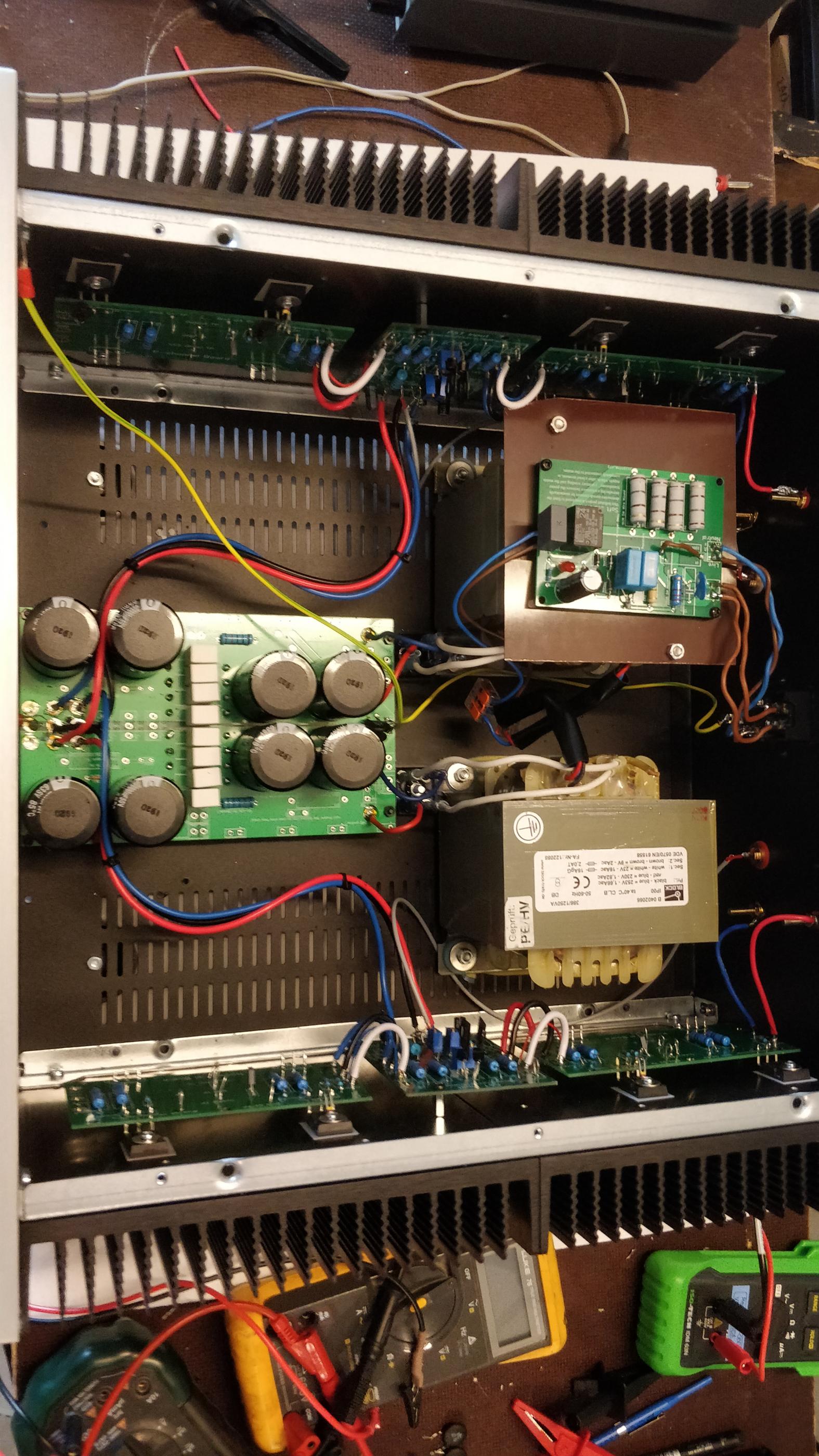

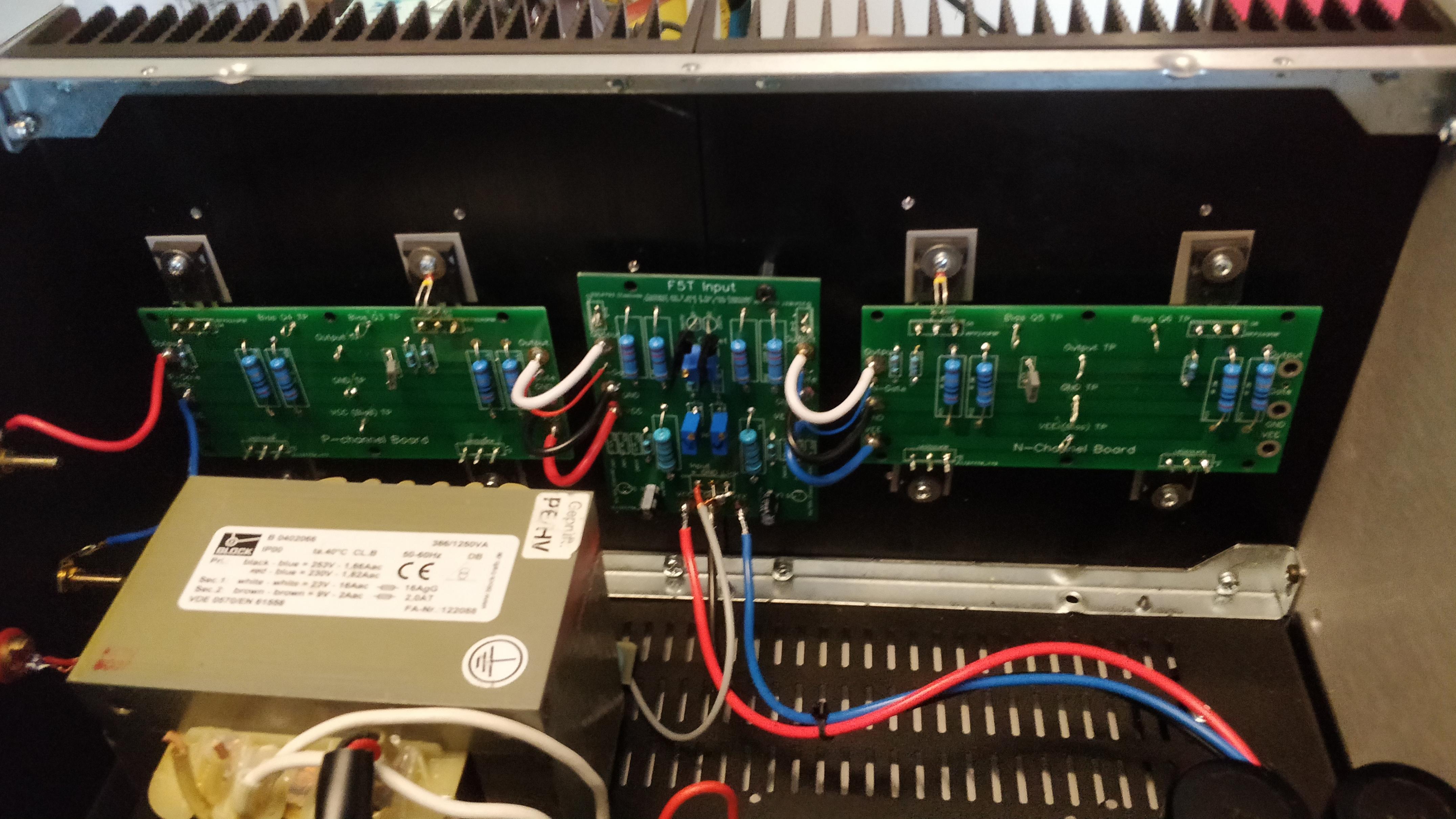

Once again, I will ask this great forum for advice.
Yesterday I finished my first F5T amp. After a successful F4 build I thought I would try the F5T. For both builds I have designed my own PCBs, which of course are 100% true to Pass’ schematics.
I managed to successfully adjust the bias of both channels of the F5T. I had the amp turned on for about 3 hours, to really let it cook (I’m using the U5 chassis). The bias was set at about 430mV and the DC offset was with in +-10mV. It did fluctuate some but I expect this to be normal.
Now it was time to test the amp with some music and it worked, but not without issues.
Here are the issues:
1. Hum from the speakers. I expect it to be a ground loop issue. If nothing is hooked up to the amp it is dead silent. If I hook up only 1 channel (left or right) it is still silent, but when I hook up both channels, I get hum from the speakers! The GND of the input is connected to the left and right boards respectively. The GND speaker outputs are connected to the boards (left and right respectively), and the GNDs of the boards are connected to the PSU. I have two D5-15 thermistors in series connected from GND to chassis/earth (only earth was not connected to the wall outlet). I didn’t have a CL60 available so I figured that two D5-15s (5ohm 6A) would make up a 10ohm 5A CL-60.
2. As I wanted to debug the above problem, I turned off the amp, and let it cool down for about an hour. I have a Soft Start board installed (from DiyAudio). I had no thermistor in the PSU but a 1uf filter cap (x1 or x2 I don’t remember) at the output of the Soft Start board. Besides the hum described in point 1 the 2 trafos (23Vac/16A giving me about 31Vdc rails. ) hum a little. So I decided to try to add two D5-15 thermistors in series before the Soft Start board. I also changed a cap (C2) on the Soft Start Board from 1uf to 0.33uf to increase the time before the relay sets in. Here comes the problem: As I now turned on the amp Q4 on the right channel went into flames. Literally! Hmm. I changed Q4, turned down the bias to 0 to rebias, only to have Q3 go into flames! I changed Q3 (now I’m starting to run out of matched IRFP9240s). I turned on the amp again, checked the positive rail (31Vdc) and nothing happened at first. I turned off the amp, decided to aim the bias setting at 400mV this time, thus turning down the bias on the healthy left channel so that I could also readjust the bias of this channel. With both channels having the bias set to 0 I turned on the amp and this time R13 and R14 on the left channel blew up!!!!
I’m wondering if the amp is oscillating? The value of R13 and R14 were 240ohm and I have the optional C3 and C4 1nf caps installed.
Extra info:
The boards are not cascoded.
The values of R5 and R6 (the 1k resistor parallel with the 5k pot P1/P2) were changed to 2k2 as I wasn’t able to adjust the bias to more than about 170mV with the 1k values.
If anyone can diel me in the right direction, I would be grateful.

either oscilations or initial Iq is too high
bias amp down, power on, rebias fully
measure voltages across JFet drain resistances, write down
power off , let it cool down
desolder mosfet gate leads from FE, solder them to rails (shorting G to S so mosfets closed)
power up and measure what voltage you have across JFet drain resistances, write down, post here - both hot and cold values

@foranobject, can you check what is happening at the drain of the JFET? You can probably tap that signal at the output PCBs, if you're using the store boards. It's the same signal that goes to the MOSFET gate resistors.
@sismik11, I think the recommended bias point was 350mv so the diodes wouldn't run away, which is what it sounds like happened.
Without a PCB it's almost impossible to track down your hum problem, you seem to have the external wiring correct but it looks like you have speaker return current flowing through the input wiring. You might try running a (very) thick wire between the L/R boards to force currents away from your inputs. Where to solder this wire depends on your boards.

What came to mind for me when reading this was what Sangram noted about the bias level.
If you read the F5 Turbo document I believe there are some guidelines on how high to go. I did not install the Turbo diodes on my V3 build. If you do the math for a V3 with 4 sets of output fets there is only a minimal gain in output power for a normal speaker load, which would typically be no lower than 3 ohms at some frequencies.
The other thing is your ps voltages are close to the recommended limit for using a cascode and perhaps with no load the voltage rises to a point where the input jfets exceeded their limits.
F5turbos are more demanding to build and adjust then other Pass DIY projects. When you get a catastrophic failure like this you need to find out exactly what happened to prevent a repeat performance by the magic smoke when you power on the next time.

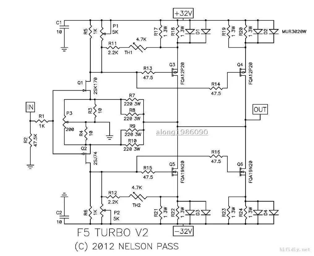

I completely missed the fact that boards weren't cascoded. As far as I'm aware there's no current F5T schematic that has the diodes, but not the cascode.
I've also never built any of these with the diodes, and I've never needed to. There's more than sufficient current without. I assume if you're running 3+ pairs with 40V rails or more you'd need more current to go with the higher voltage.
Zen makes a good point about initial Iq. With thermistors in the circuit, a cold amp will have about 10-20% higher bias than a hot amp depending on sinks, so if the amp was left to cool with 450mV hot bias (which is already at the conduction point for the diodes), the diodes would be fully switched on in a cold amp.
From the article - V2. Only the V3 has the cascode in the article.

Sorry, Scott, I must've gotten confused with the number of variations. Yes, the diodes never blow and because they strap across the resistors, those never blow either, being limited to extremely low dissipation. I prefer having blown resistors to having blown devices, FWIW. They're cheaper, easier to remove because of one less lead, and less of a hassle to procure and match.
One way to get more bias out of this circuit before allowing diode conduction is to lower the effective source resistors, from 2x1R to 3x 1R in parallel. This allows to get a little more headroom before diode conduction, potentially also allowing for a slightly higher temperature headroom (the diodes conduct better as they get hotter, we're trying to push this further out). Obviously your target bias voltage will reduce by 33% because of this change.
The gate stoppers should not need higher wattage if the front end is stable. I use 250mW Beyschlag surface mount types and they're more than adequate. In fact it is probably best to leave these resistors small, there's no upside to upsizing them. I also use a gate protector on the input JFETs just in case, it's two 9.1 zeners back to back across the input. If your stability is marginal I would also use a zener protector across the MOSFET gates. This is basically a 12V zener and a 1N4148 that clamps the MOSFET gate and protects the MOSFET gate a bit better.
The 10R resistors obviously need to be 2W types, as mentioned earlier. I use 30W Caddocks here. My feedback combination is 220pF across a 100ohm resistor, but I would recommend a minimum of 470pF as I have other stability measures in place. The article, or the original thread, has it at 1nF. Any metallised capacitor is fine, a film and foil probably the best for HF stability. C0G or NP0 ceramics will also work.
All of these measures will reduce the amplifier's bandwidth. The F5/Turbo is run with no compensation and very small stage count, to enable a wide bandwidth without resorting to tons of negative feedback. However all devices are intrinsically very high bandwidth, and you could run into potential stability issues at any time. You don't have to do everything I mentioned here - start with just the caps across the feedback resistors, and see how it goes. If you are feeding this from any kind of high voltage preamplifier, I would also move to protect the input JFETs. These two changes should have you covered for almost any kind of issue.
