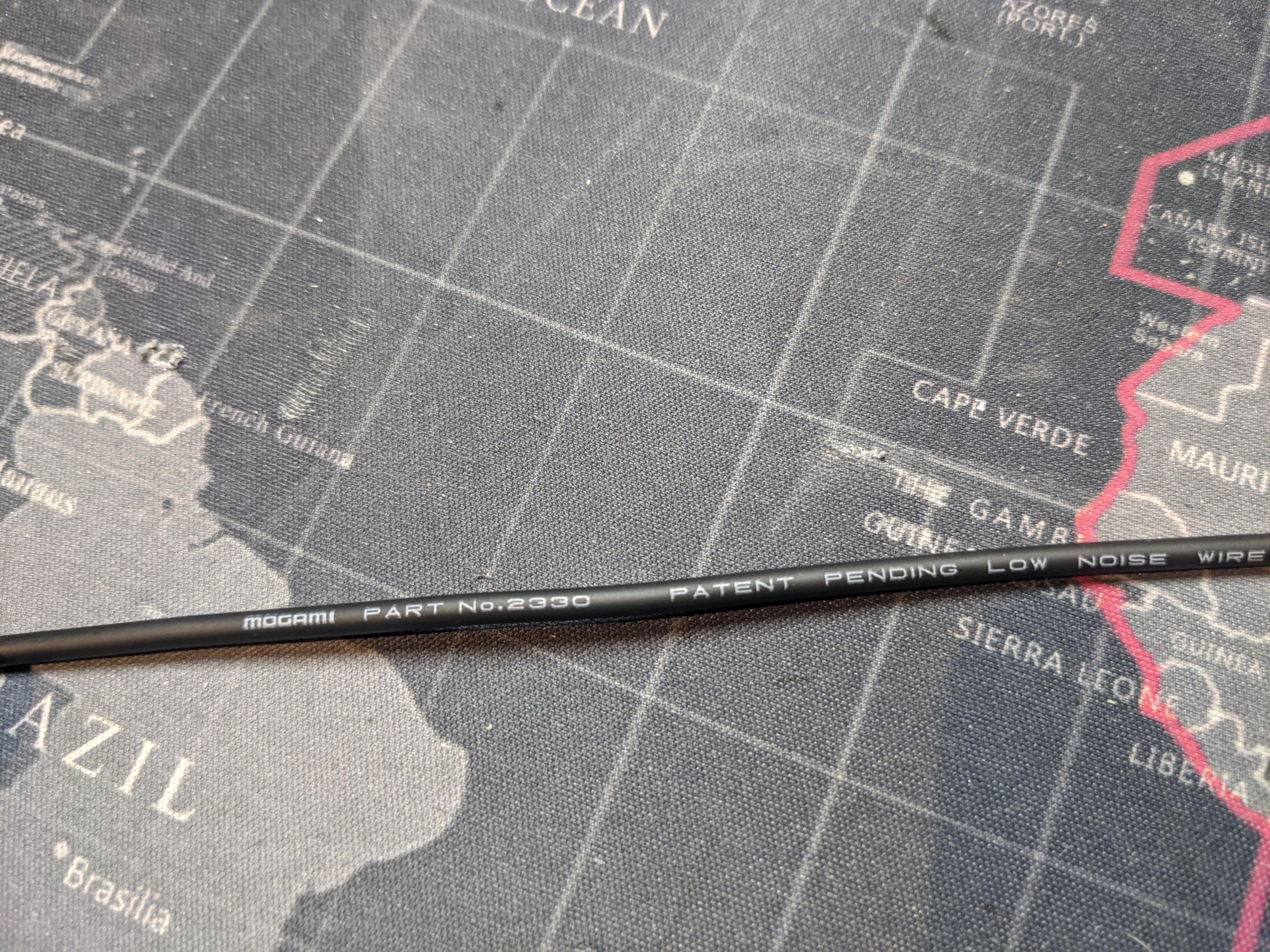

2. For the single ended RCA input, can I just use a coaxial cable I have lying around?

ha! I couldn't see the flux capacitor in your build guides so I'll go with the input wire. thanks again.

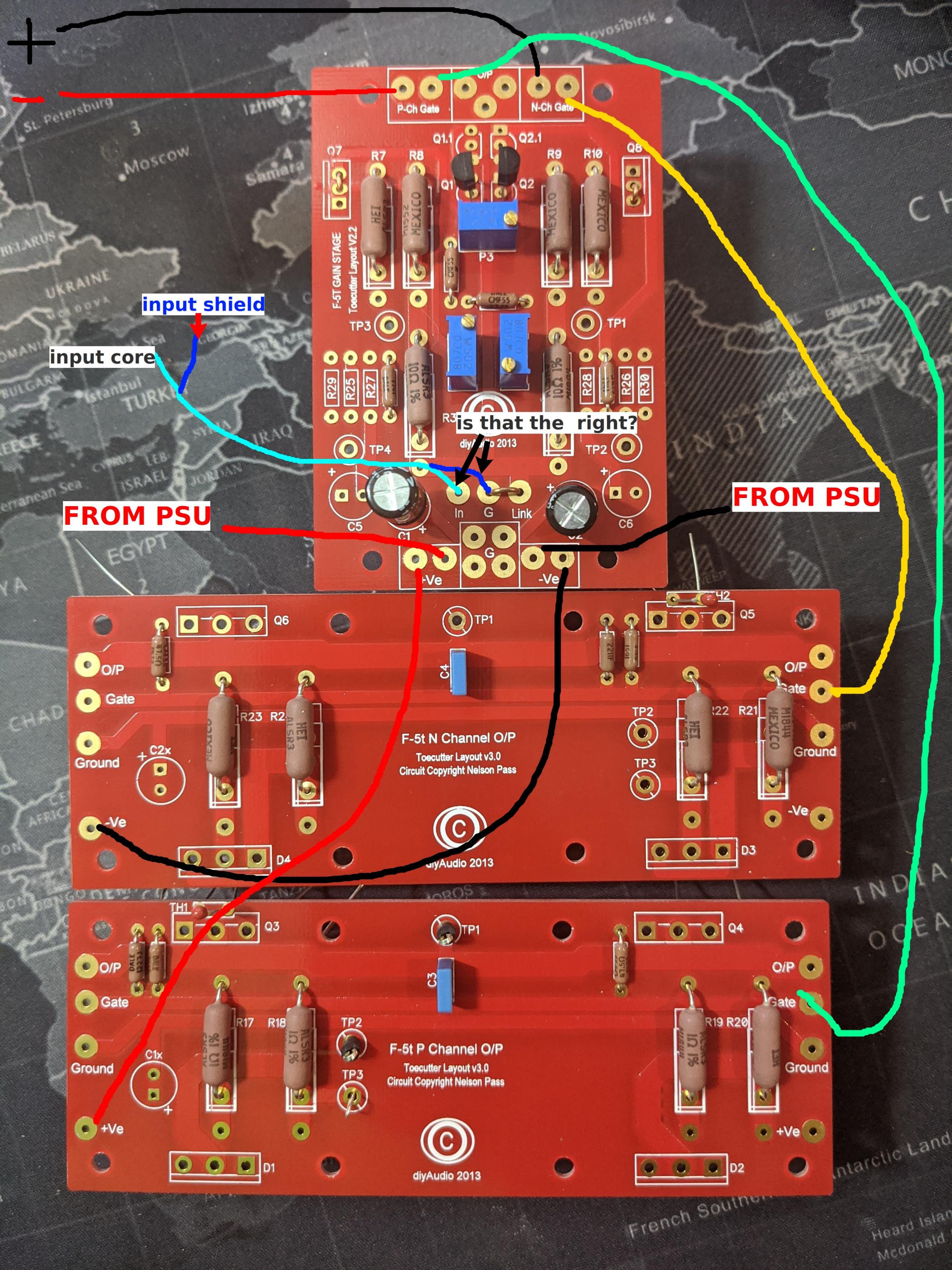

Could someone have a look at this illustration of the wiring and confirm if I have it right?
I'm not sure about the INPUT wire - does the core go to the IN and the shield to the GND? Or the other way around?
And I just want to double check the connection to the speakers - is it from the respective P-Ch and N-Ch connections at the top of the gain stage board?
I originally thought there were two points you could use for the "P-Ch Gate" and "N-Ch Gate" but I think I talked myself out of that and concluded there were two separate points - one for "P-Ch", one for the "Gate" on the P-Ch side, and the same for the N-Channel side. But confirmation would make me sleep better.
At least I have the O/P and GND worked out.

The input core goes to the input and the shield to ground as you've indicated.
The O/P from each of the output boards should connect to the O/P on the input board. This is to provide a central point to connect the N and P channel outputs and provide the feedback signal.
I connected Speaker + to the common O/P point on the input board and Speaker - to the common ground point on the input board and that worked well for me.
