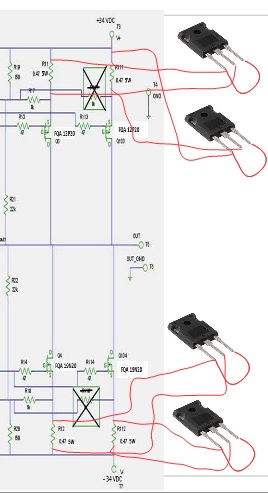

MUR3020W
Hi
I want to add MUR3020W.
I use the cviller f5c turbo version1 board.
Is it okej to hardwire the MUR3020W in this way?
What is your rail voltage? In the circuit the Jfets run at about 15% less than Idss. Multiply that by about 10% less than rail voltage and that will give the Jfet power dissipation roughly. Over 150mw, cascode it is the consensus among the experienced on this forum.
nash
Secondary around 26V(24V secondary, 115V primary, house hold 125V), DC could reach around 33V
using Nash guide and your numbers:
0.85*Idss * 0.9*Vdc < 150mW
If your Idss is 8mA and Vdc is 33Vdc, then you have 0.85*8 * 0.9*33 = 202mW.
That is well above 150mW.
I would aim for even lower than 150mW. I suggest <=100mW
10mA for Id @ 10Vds, or 8mA for Id @ 12Vds, or 6mA for Id @ 17Vds
Pmax for the To92 jFET is around 300mW to 400mW, running at 50% of Pmax raises the temperature a lot.
Aiming for ~40% of Pmax with a raised Ta inside the enclosure will still run the jFETs pretty warm.

Thanks Andrew. Which basically means F5 Turbo V2 need cascade unless use around Idss 6.4mA JFETs or lower...
hot jFETs combined with high Vds leads to high gate leakage current.
They might have a very safe Vds rating when cold, but that changes (a lot) when you run them hot.
The datasheet will show gate leakage vs Temp.
The datasheet will also show gate leakage vs Vds.
I can't recall the datasheet showing the combination.
