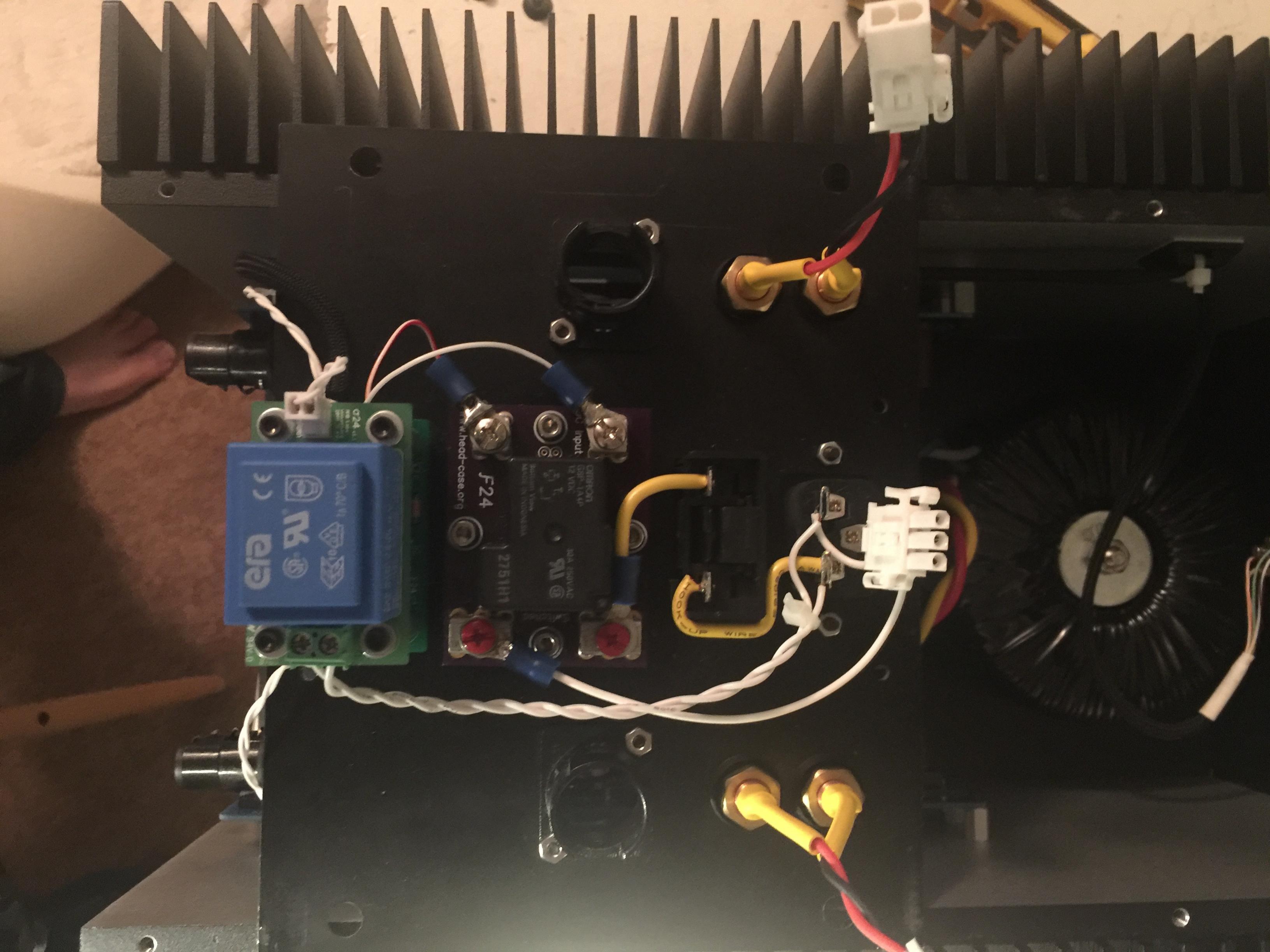

I can post some pictures, I already see a few changes that I should make - moving this small transformer after the main fuse, for example. I post things as-is though, so perhaps we can diagnose why the TH went smoky the bear.

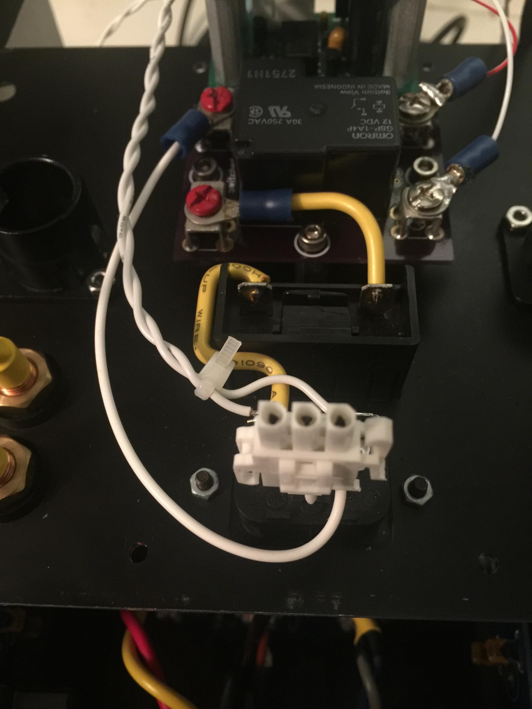

Ok, here's a basic shot. The white wires on the right go to a NC thermal breaker (which is attached to each heatsink uninsulated). The covered wires with the black nylon go back to the momentary switch used to trigger the relay. As noted above, the auxiliary transformer should be after the mains fuse. I think the basic circuit here is obvious enough:
In the second shot, you see the connector that supplies triggered AC to the power supply. The far right wire comes form switched "Live" and the "Neutral" and "Earth" come directly off the IEC plug.

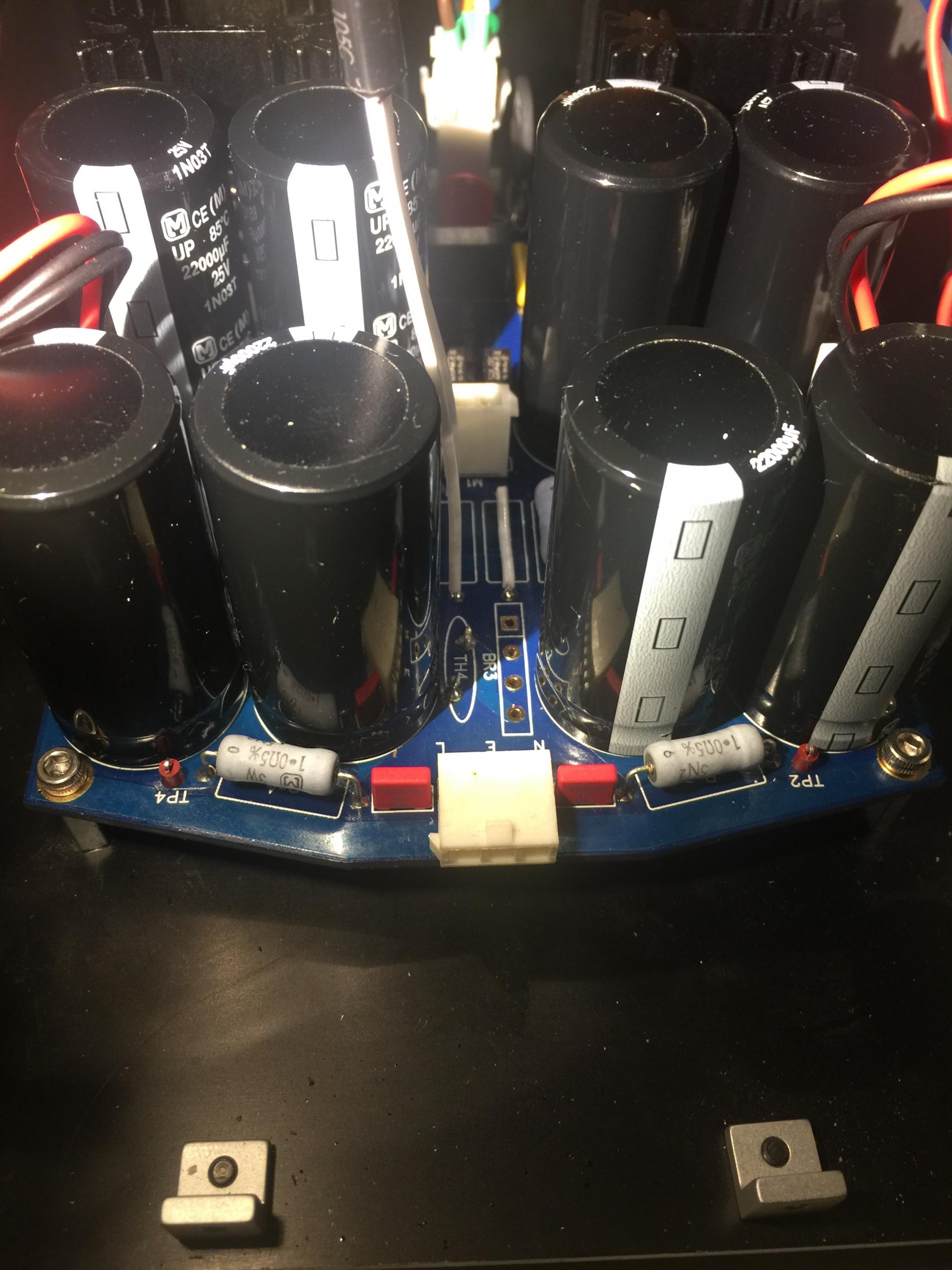

Here's the plug on the circuit board, it's pretty clear what goes where. The "Live" wire goes to a thermal switch, "Neutral" goes through a jumper wire over to the other side of the board where the transformer sits and the "Earth" goes via a trace to the screw that mounts the board. I think this is similar to what the First Watt amplifiers implement. You can also see where the smoking TH was removed and the non-populated bridge. Before you ask, the other side of this standoff has a screw is connected to bare metal via a counterbore. All of the various panels are earthed together via similar arrangements, including the heatsinks themselves.
edit: my images are getting squashed, but click on the thumbnails below for non-squashed versions.

With at least 5 white wires most of which are not in pairs your pics are pretty unclear where any current is going !
Color coding would be nice. Just look at where they go? I wouldn't say "most" aren't in pairs...
You may want to check if the body of the thermal switch is isolated from the live wire. I had a bad experience with a thermal switch where the metal body is actually connected to one of the wires.
I like that theory. Here's the datasheet, I can verify tonite:

The Thermal - in your photos, it's the doohickey on the long white leads. What's the TO-220 thing you linked to? If thats in-circuit and connected to heatsink, with no insulator, that might be the issue.
Looking at the layout an schematic of your PCB, http://www.diyaudio.com/forums/swap-meet/297805-fs-yafwpsu-yet-another-firstwatt-psu.html
Are the mounting leg holes connected to anything? Hopefully they float.
That scares the living bejeezus out of me. Is your chassis floating but hot? According to the schematic there's no reason why having it connected or disconnected should make one iota of difference in regards to power-up.
Lastly, and do this immediately - Connect safety earth from the IEC directly to the chassis with a stud and star washer and then connect your PSU PCB earth to that, NOT the IEC plug.
