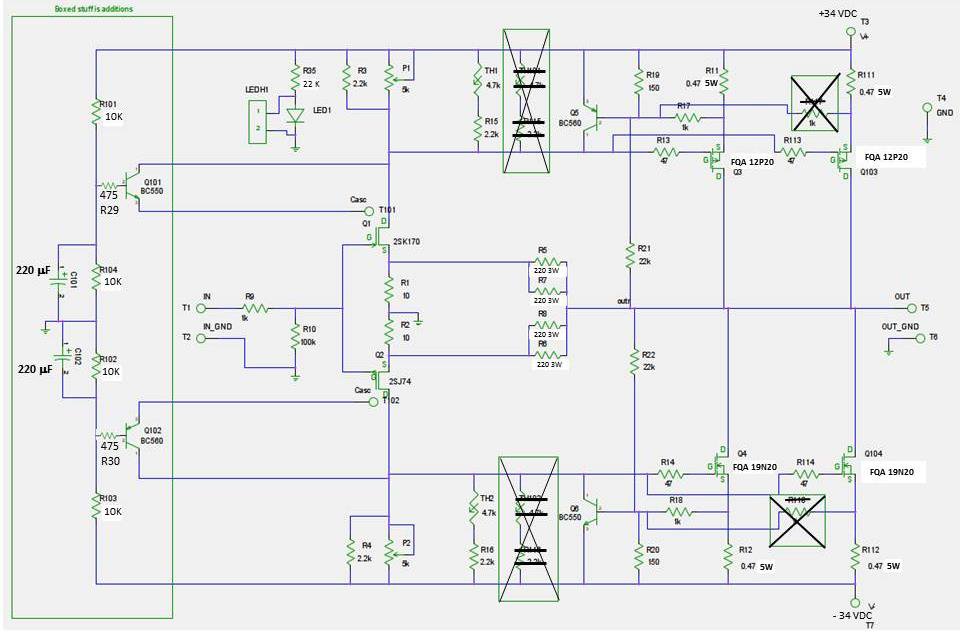

I got a problem with my f5 turbo v1 build.
I use cascoding transistors bc550 bc560.
I messaure 0,38v around the 0.5 ohm Source resistors, 32v rails, 15 v from the bc550 and current limiting (ztx550 ztx 560).
Double mosfet output messaure 0v on the gate.
I can play music but not very loud.
The problem is that the mosfet not working, no heat from them.
The jfet seems to work.
how should i solve the problem?
any idea?

0.38V across 0r5 resistors indicates that 760mA is passing.
That is your bias.
It should be the same for both source resistors, if your output does not have a load.
±25Vdc and 760mA of bias results in a dissipation of 38W.
±32Vdc for an F5t gives a dissipation of 48W per pair.
Something has to be getting hot !

Voltages measured across the resistors or referenced to ground? 3V across R12 is 6A. That makes no sense that there's not a lot of heat somewhere if that is the case.
Have you measured R11 as well? How about DC offset of the output? I suspect that you have a bunch of offset dialed in (causing the R12 reading relative to ground) but have not yet biased the output stage into conduction. Remember it's an iterative process, fixing offset will knock the bias back so go back and redo your biasing procedure again.

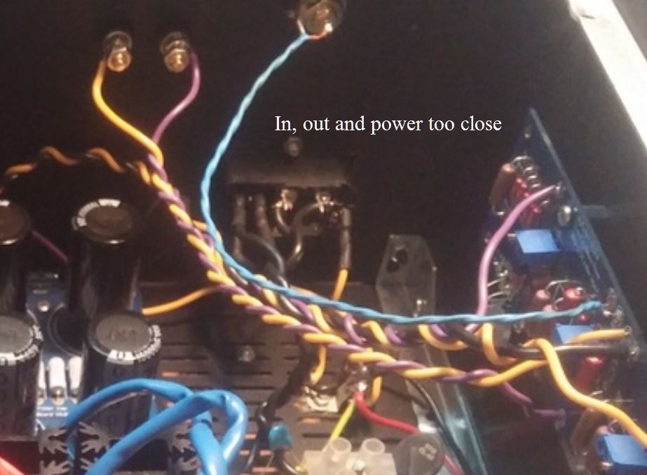

my problem with my amp...hum...the rectifier stage is buzzing. at least it seems the buzz comes from it.
need some advice to solve it.
i think this is what you are talking about. the power cable that goes into the amp is going down to the chassis
yes, agree. in this last pic i tried to put them wider.

now...a little better...but far away from a good result
i reduce the noise by tightning the bolts on the diode heatsinks.

I don't know what to do more. The ixis diodes keeps buzzing. I've tightened them and separate them apart the PCB and now i have them both sides of the toroid. I don't want to give up on them and go for monolythic ones because they were expensive. But if i have to...

I will do that, but i think that's not the problem. when i have my amp conected to my 89db tannoy sensys, i can hear the buzz or hum.
