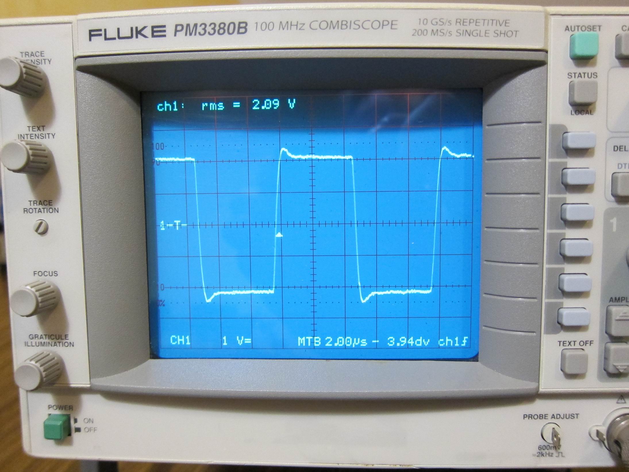

Finally testing my F5T-Channels :D, everything looks good so far :).
Setup: 33V rails, 3x IRFP9140 + 3x IRFP240, CLC with 141mF/1mH; 0,5 Ohms Resistors, 9,8mA Jfets, Bias 2 Amps.
When fed with a square wave, the output voltage does overshoot a bit, at least more than depicted in the F5T article. Could this be related to the use of IRF-devices instead of Fairchild ? I couldn´t get FQAs anywhere.
The overshoot could be trimmed a bit by changing P3, but this also changed the straightness of the rest of the positive/negative output signal.
If anyone has an idea on this, i would be grateful to hear.

Putting a 1000pF to 2000pF cap across the feedback resistors will fix the overshoot.
You can also change the value of the input resistor.

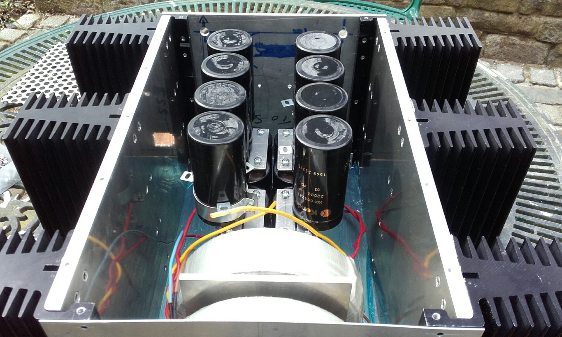

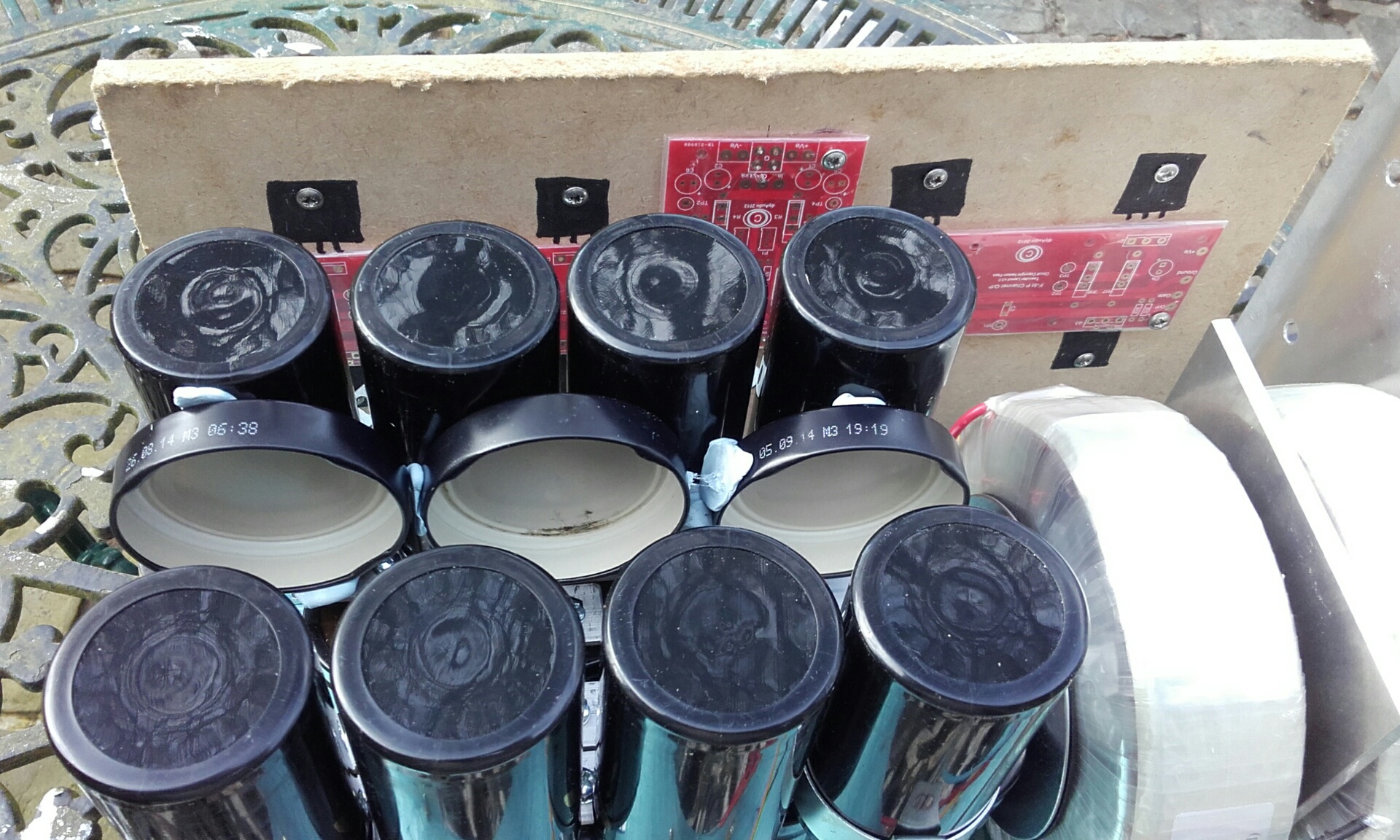

advice required
hello

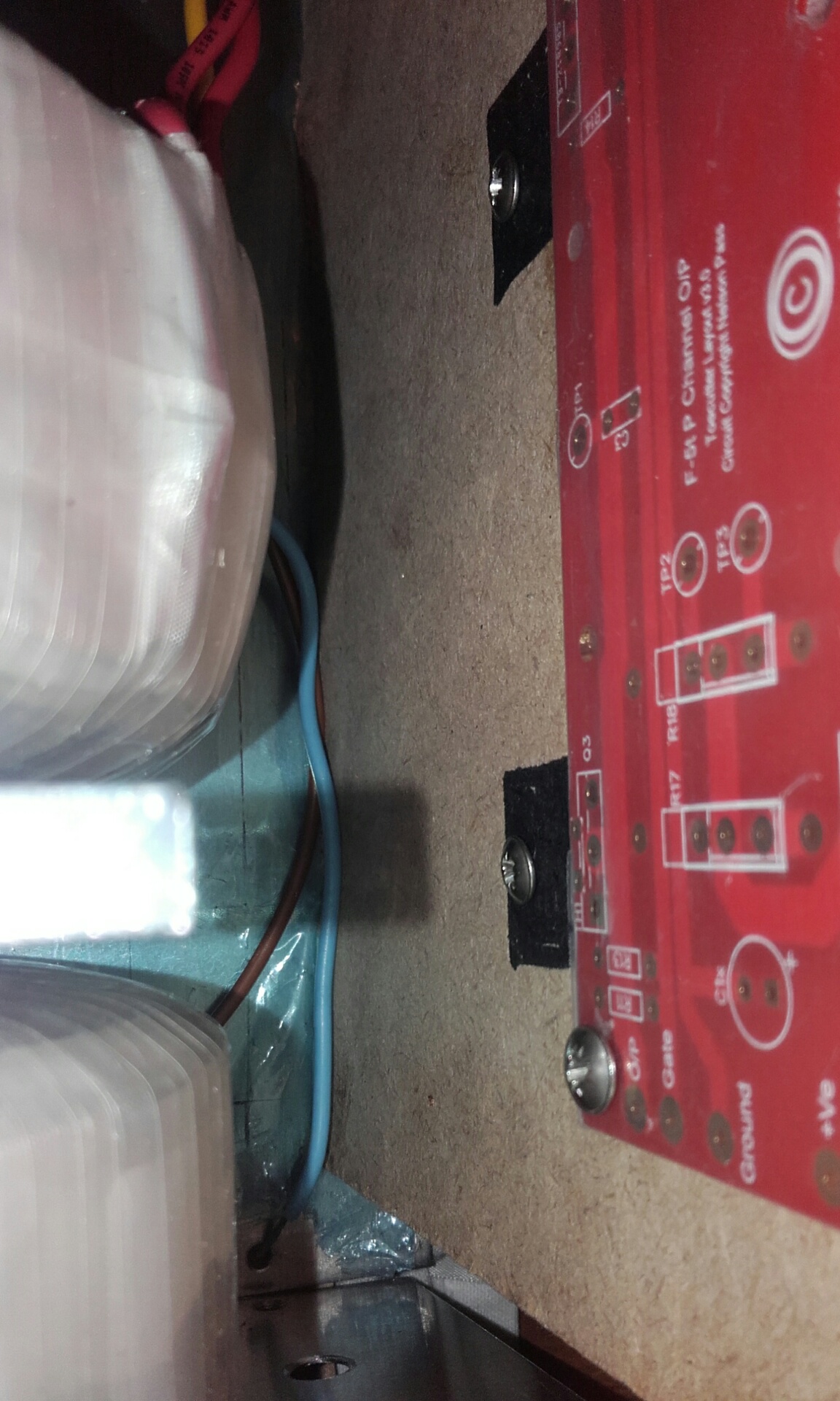

I am at an early a f5t build, trying to see how the components will arrange internally. the heat sinks in use are quite deep, so width is a little limited (they were a donation so felt compelled to use them) however gained a bit on usual case height.
The photos depict the space available, also I have blue tacked some jar lids! to indicate were inductors may be placed .
I have a couple of concerns.
1, the co-location of the output devices to the transformers, currently a 30mm gap.
2, is this an acceptable location for the inductors.
Would really appreciate some opinions
regards

What are the actual dimensions of the heatsinks? They look small for a F5T.
The heat sinks are not depicted in the photos, but here now. The alloy plate= 222mmx400mmx10.9mm, the fins are 222mmx95mmx70mm, each assy =9kgs, I milled a couple of thou off the mating face of the fin's, to get a better contact.

From what I can see, it looks like you will have a difficult time reaching the pots to adjust bias and offset. The amp will need to be at operating temp and running: a slip of the screwdriver could prove very exciting!
Hal
Thanks for your concerns.
Bourns manufacture a pot with side entry, this will allow vertical access to P1 & P2. P3 legs can extended and turned through 90deg for same access, not pretty but a fix. The bourns pot adjusting tool is plastic and the tool for the job, but will still take heed of your advice when dealing with live power supplies.
