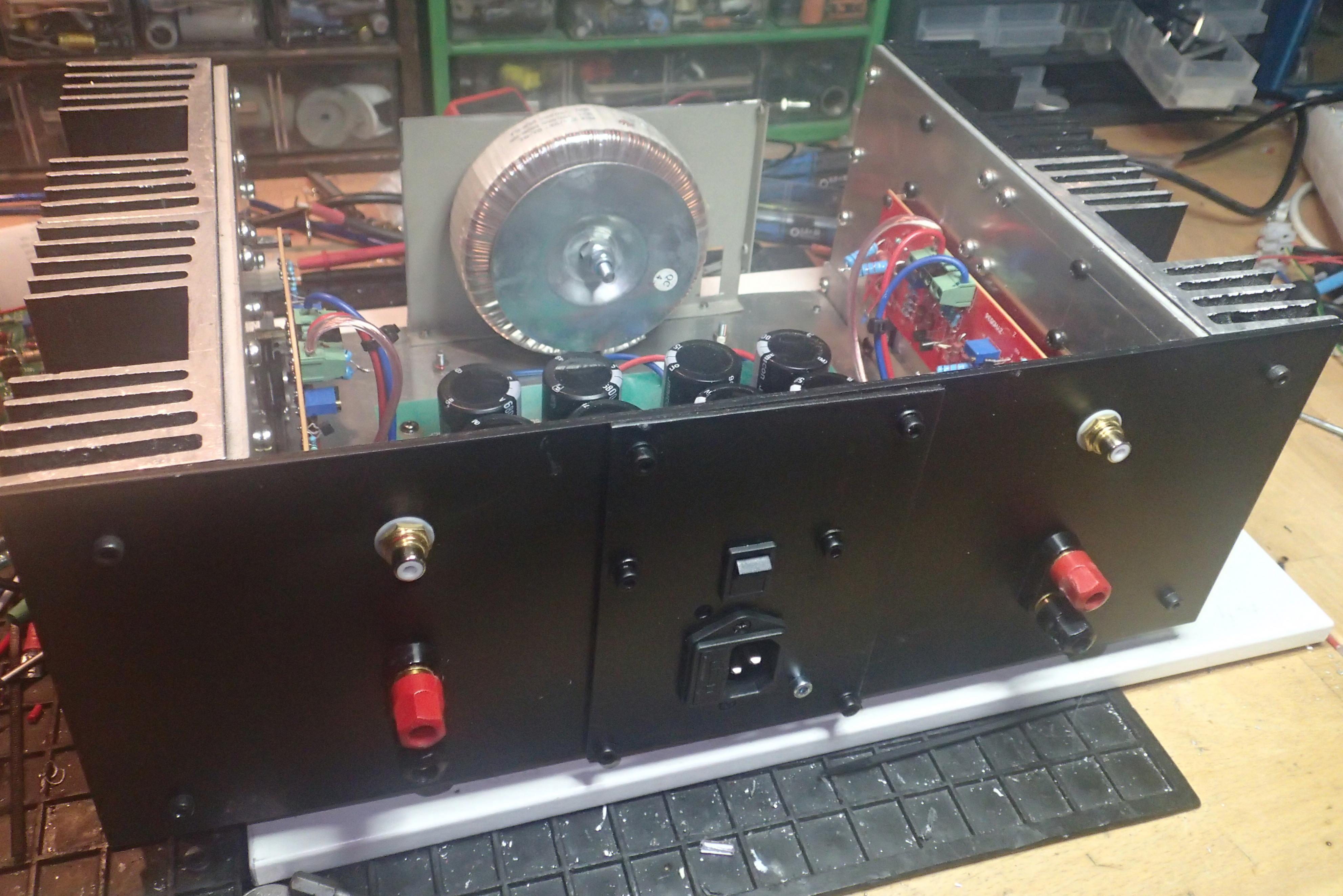

Due to a small heatsink I have built a vertion of F5. I use a smaller transformer with 2x15 V AC. To keep the teprature on "the right side" the bias is 0.8 A (0.4 V). My question is; will this changes influence on the measurement and difference from and ordinare F5 ( likeTHD....). Gain resitors are 220 ohm. Intention is to use it together with a sensitiv horn driver.

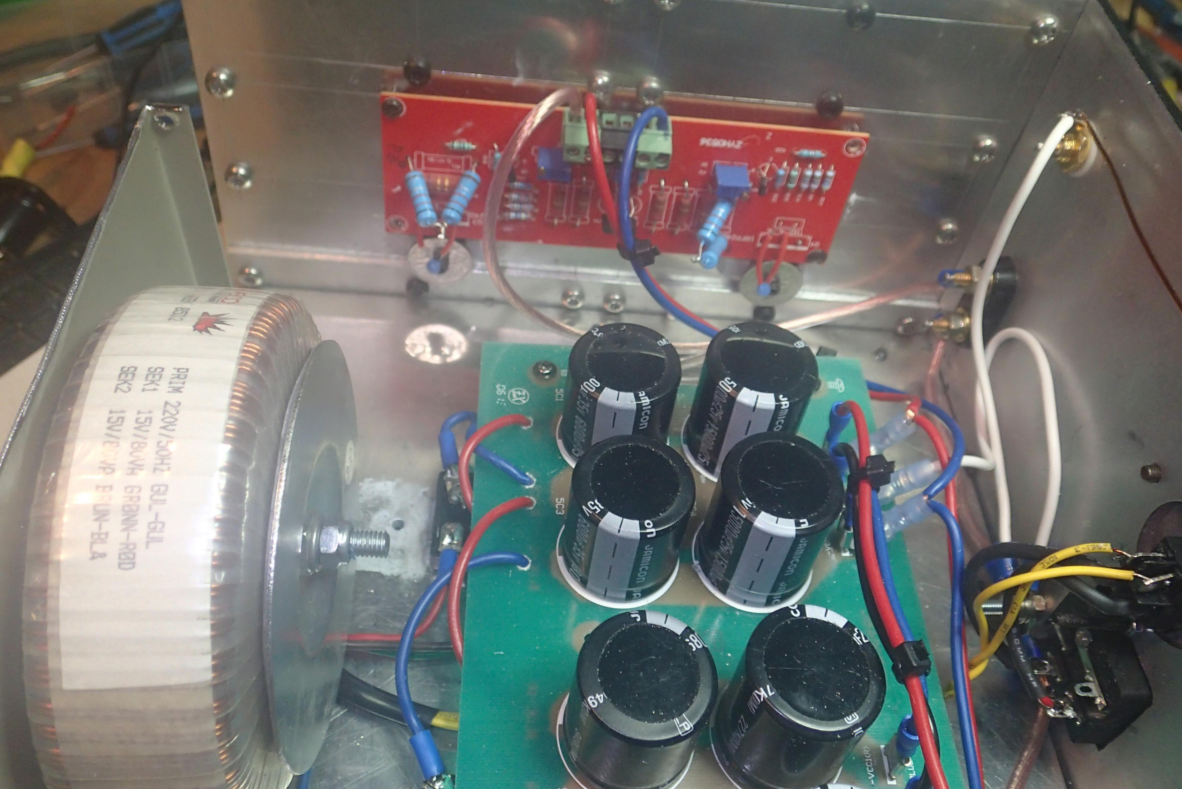

today I want to post the result of my F5T V.2.
Here some details:
Dual Mono Setup: 2 x 800VA toroidals from Toroidy + 2 x 176kuF Elko Capacity from Mundorf
I biased the amp at 2.35A per channel using a pair of 680mOhm source resistors at a voltage drop of ~400mV
Temperature is in the range of 53-55 degree
Offset DC: ~5mV
The housing I'm using is the very large one from Hifi2000.it it is similar to the one you can buy at the diyAudio shop but has a depth of 500mm instead of only 400mm
As you can see I also spent a decent front plate made of plexiglass. I needed to do so because I always want to have a look at the nice toroidals 😀
And here are the pictures:
