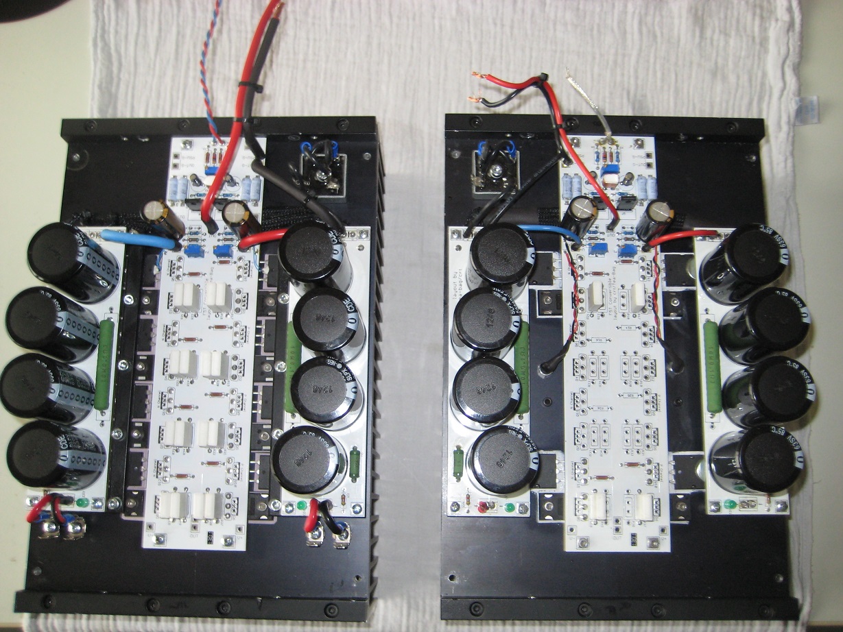

Hi Russellc, like Buzz said: don't give up!
If you have the 5U store chassis it will work with option 1.
Placing your MOSFET's at 1/3 at the two sides of the sinks is no problem. Look at my picture, the amp board/heatsink on the right is F5Tv2. I had no problems with heat distribution. Sinks are 300 x200 mm.

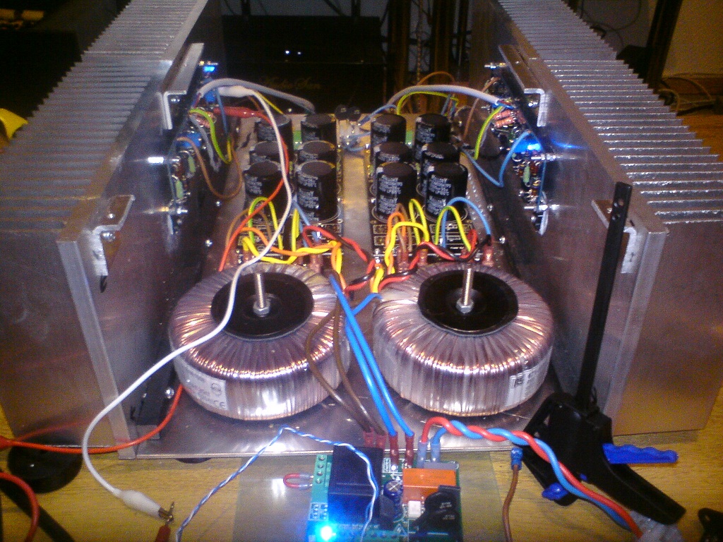

this one is 11*20*6"
Funny you should ask... I am still pondering that. The heatsinks are 5 3/4 in. wide alone. 18 in. overall only leaves 12 1/4 in. and the transformer is a bit over 6 in. But like Russell says big is good. I am leaning towards a square overall, that would leave me with the cavity size of 16 in. x 20.6 in. That is my current thinking.
Is bad we are talking about building amps that are almost 2 feet by 2 feet.

Say, I just noticed that the one on the Left is V3? If this worked, (I assume it did) then surely my V2 will survive....hmmmmmmmm

Upgraded a v2 to a v3.
Heat distribution is even better with more MOSFETs at a lower bias per MOSFET. Heat dissipation is the same of course.
In the center of the heatsink around 55 degrees C, at the edges around 48-49 degrees Celsius.
@ nashbap: bias is now 2 Ampere per rail @32 Volt, so around 4 Ampere class A bias.
2,5 Ampere which I aimed for is too much, maybe in the winter when my T ambient is around 18 a 19 C.
I think you could use the 400 x 200 mm heatsinks with Teabags board but it depends on how thick is the base of your heatsink. Mines are 12 mm, but I've seen heatsinks with even a 15 mm base.
