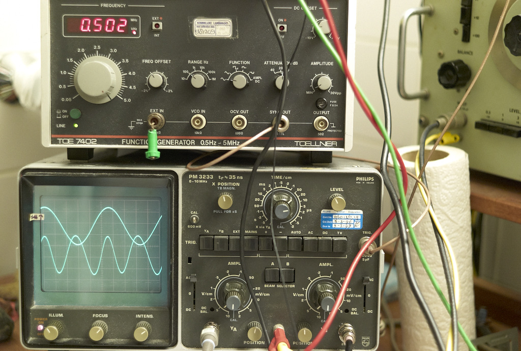

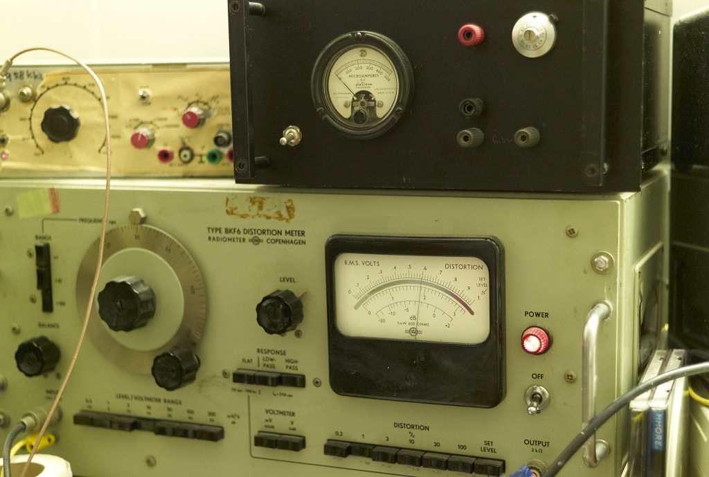

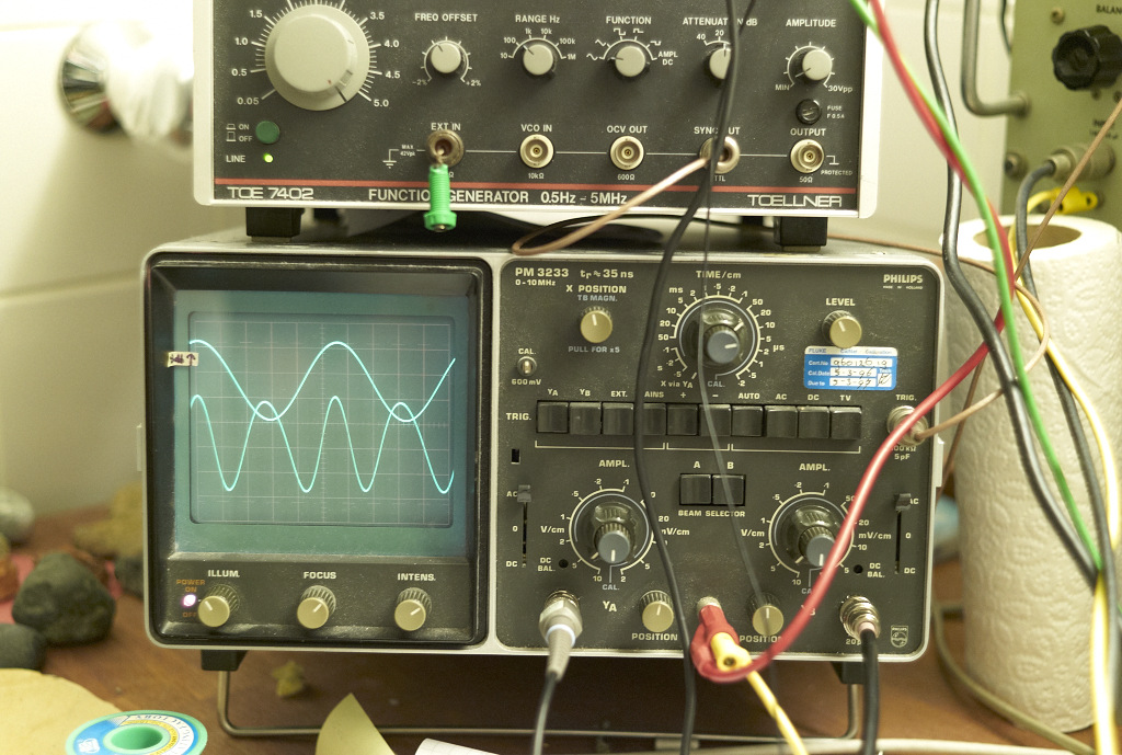

Nelson Pass presented a subcircuit to select an operating point, and select the distortion you like most.
Initially I had matched my 10/100 ohm resistors with great care. Well that was no good idea. It gave low distortion, for sure. But it was a bit hard sounding.
I set up P3 with 47 ohms to both sources and a 100 ohm pot for P3. The resulting source resistance was 8,3 ohms.
With just a small shift from center I could change the distortion dramatically; turning one way I got 2nd harmonic out of phase and the other way I got the second harmonics in phase - so the crest coincides with the top of the sine going.
I selected it quite a bit higher than Nelson does himself (his example 0,03%); I can't measure that low with that clarity. I choose a lot higher.
left
right
I settled for 0,6% 2nd harmonics, that is -44 dB, at that point the third harmonics is far away and slightly visible for me (I have no sound card). Many well sounding 300B and 2A3 SE amplifiers have this level of -43 dB for 2nd harmonics too. I forgot to check how stable this 'distortion' is.
It is quite well sounding now. So thanks a lot for this implementation idea.
(Compare my 300B PP that has 0,1% 2nd harmonics at 1 watt but that shifts to 0,6% 3rd harmonics at 4 watts and 6% 3rd at 12 watts)
