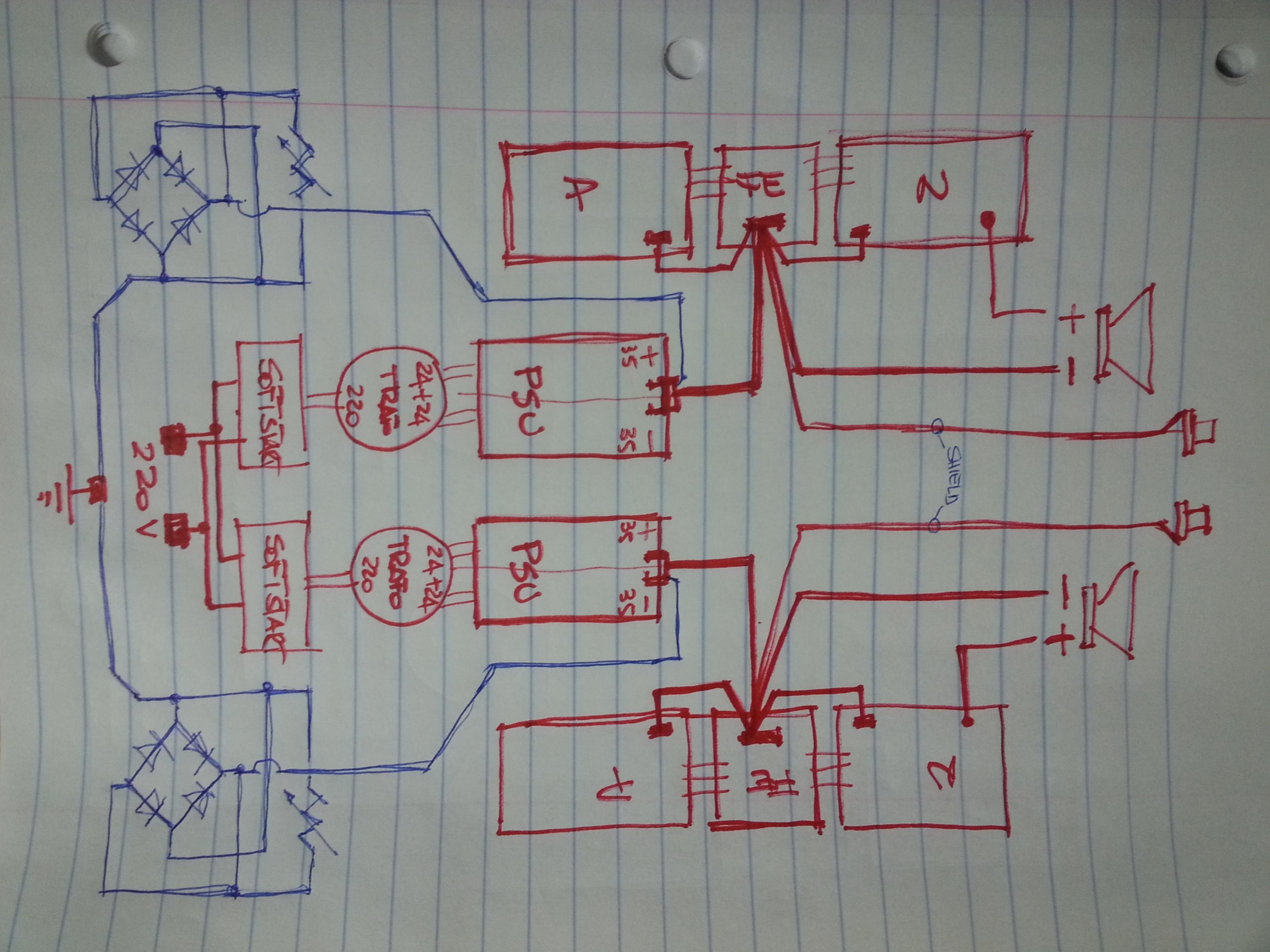

F5T V2 Ground Loop isolation
I am near to complete the F5T and I have a question about the ground loop isolation. I attach a sketch (really a "sketch" and I hope is readable) where I show the ground connection only. As you can see is a dual mono that in common have only the 220V power supply.
In the sketch I show in blue the 2 bridge with the 2 thermistor. Is acceptable to connect the loop to the PSU or should be on the star point? Actually I have no more room on the FE. The connection of the negative of the speakers was really complicated.

Eme,
that looks right.
You have two separated channels each with their own Main Audio Ground (MAG).
The only connection between these two MAGs is via the two sets of diode bridges to Chassis.
I don't know the FE PCB trace layout, but it's worth checking where the Input Screens should connect to. As far as I am concerned, the input pair of Signal Hot and Signal Screen/Ground must make up a close coupled pair for the whole input circuit.
that looks right.
Thanks Andrew,
I am using the Stor PCB and the Signal HOT is just near the Signal Ground. In the sketch I show only the shield of the signal.
I read on some thread that with my configuration the diode bridge to the chassis should be only one but in this way I have to connect the 1 ground of the 2 PSU. Now I am more confident that I choose the correct way

If your amplifier has only one MAG then that one MAG requires one connection to Chassis to pass Fault current via Chassis to PE.
If your amplifier has two separate MAGs then each of those MAGs require a connection to Chassis to pass Fault current via Chassis to PE. In in this situation you use one connection to chassis then that results in the two MAGs not being separate.
