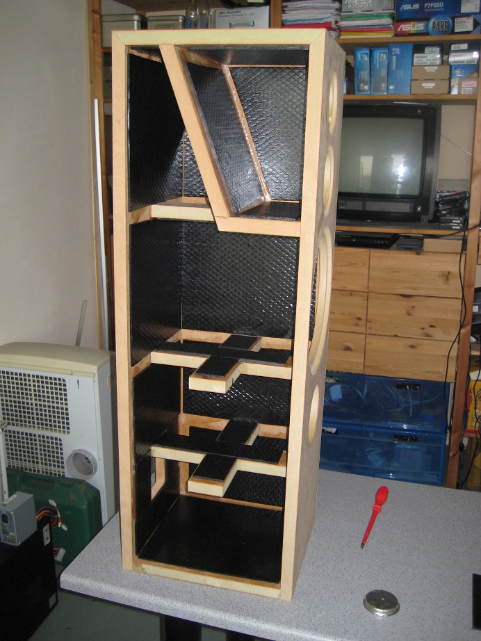

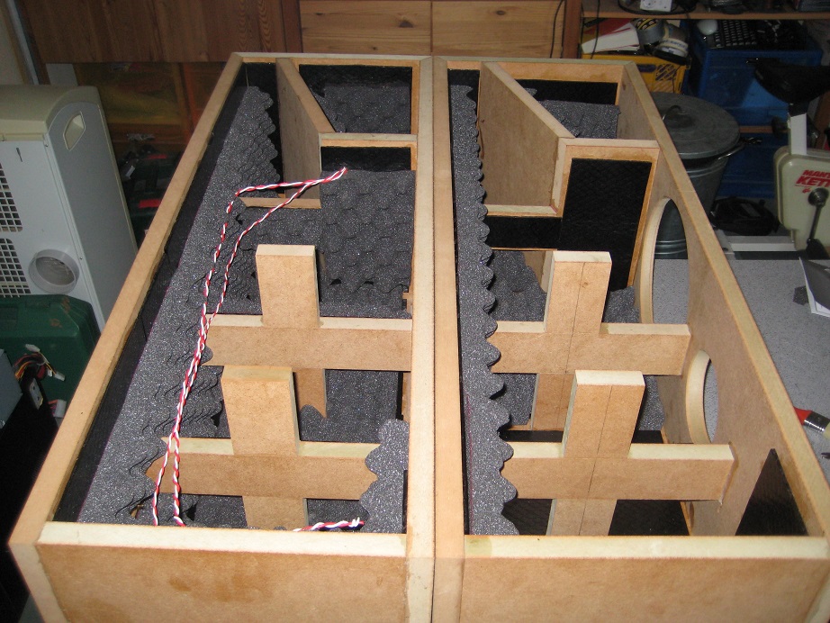

Haha, bit OT but making progress with this:
drivers: Vifa NE123, Vifa NE265 and Scanspeak Illuminator D3004/66200:D
