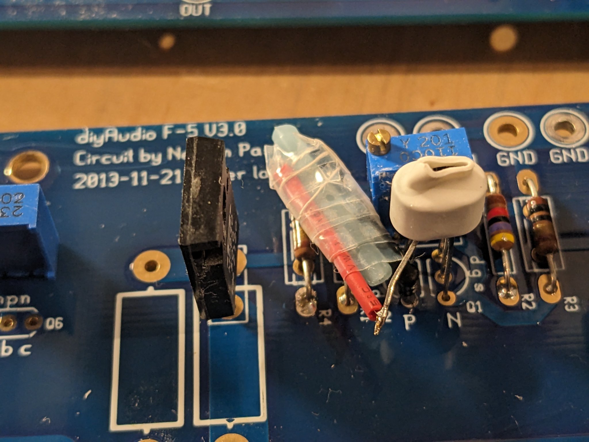

I lift up Pch drain pin then put 5.1Ω manganin wire.
I might not need P3.
It's getting morning so next day off to listen F5.
Later I buy 4.7k charcroft for R1.
