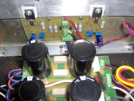

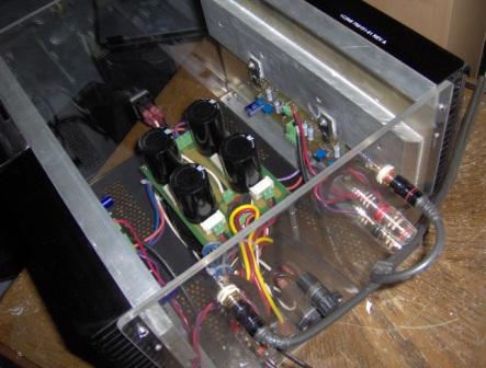

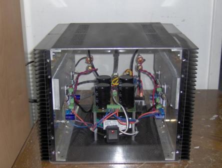

Here's a picture of my DIY F5 on Plexiglass. I don't have the budget to buy an aluminum for front and back panel yet, so I decided to use a plexiglass for the meantime. The transformer is Piltron 300VA 18 - 0V dual. To get the maximum performance, I'm planning to replace it with 400VA 20 - 0V dual as what Jack used on his amp. The capacitors used were 33,000 uF each, which is 66,000 uF in total per rail. I bought the heatsink from Steve at Apex Jr.

fredlock said:Another view...
very cool. Black cube. Looks like my F2. I mounted the power supply from the top.

So what about the bass? Middle of the road, lacking, non-existent? Or do you think its the smaller supply?
The bass is pretty good! I can't complain about it but I think you can make it better with the higher transformer rating IMHO.
Hi Fredlock, some questions about your "transparent" 😀 amp:
- could you give me the rough dimensions of the heatsinks?
- are you biasing it as per the F5 article, i.e. 1.3A/MOSFET?
- how hot are your heat sinks getting?
I have similar sinks and thought they are insufficient, but maybe....
Thanks anyway
Tino
Tino,
There are 2 heatsinks per channel joined togehter. The dimension is approximately 9 1/2 " x 12 1/2" plus the add on 1/4" thickness aluminum bar mounted on the heatsink with the MOSFETS.
Yes.
I did not measure the actual temperature but my assumption would be 35 to 40 degrees.
fredlock said:my assumption would be 35 to 40 degrees.
Checks out with the geometry and sizes you mention.
Your heatsinks look similar to the popular 30-rib 1.6" thick SK56 overhere.
A 5'' length of SK56 does 0.40C/W, makes 0.20 C/W for 10 inches, 25% added for rotating them 90 degrees gives 0.25C/W.
Corresponds to 35C-40C at an ambient temp of 20 to 25C.
