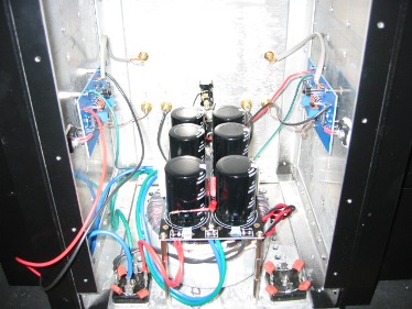

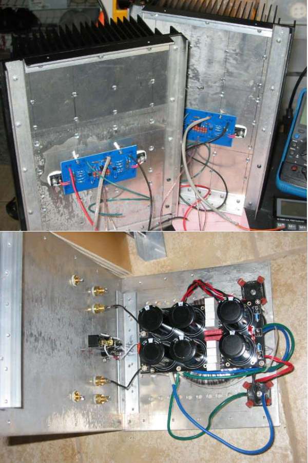

My F5
First of all I have to thank Nelson for his design, and also thanks Juma for his PCB layout.
I've been reading the thread couple times and Nelson's F5 article on first watt before I start making this amp.
I've it set-up today and have it run for about 3 hours and both channel fire up at the first time. The bias is quite easy to adjust, but I still have the following questions.
1). After 3 hours, I have 0.595v across the o,47R resistor and it's bias is +2mv to -2mv range. Is it normal?
2). The temperature on heatsink is 38C, and my heatsink is 7" x 14" x 3". Will it run really hot if I turn on for more than 6 hours?
If not I'd love to change that 0.47R resistor to 0.33 and run them at 1.8A. Please advise.
Albert

Re: My F5
Albert
Hi Albert,
1) It's not normal - it's great ! You got very stable bias
2) 38C is a great result, Mr. Pass usually aims for 50-55C. You have wide enough margin to try higher bias. Do it in steps, set bias to 1.5A for couple of hours and if everything is OK, go for 1.8A - the idea is to have temperature on heatsinks less or equal to 55C (the cooler, the better). You don't have to change 0.47R resistors in order to change the bias, do it with trimmer pots on PCB (0.705 V on 0.47R resistors will give you 1.5A bias, 0.846 V for 1.8A ).
Keep up the good work :up:
Albert, be careful with increasing the bias.
You'll approach 45W dissipation per device, this is a lot.
There is a Junction to case and case to sink thermal resistance.
The junction temperature of the MOSFET's will be considerably higher with 45 Watts and 55°C sink temperature than with 30W and say the same 55°C sink.
Tino

Thanks guys,
I didn't have chance to put any music on yet.
I certainly will let it sing for a week or two, then I'll follow Juma's idea to adjust the bias bit by bit carefully.
Thanks again. Will post result
Albert
BTW both 0.47R sit around 40C, does it matter? how high it can go and without burning it?
595mV across 0r47 is just 0.75W.
What size (dissipation) of emitter resistor are you using?
Andrew, I'm using 3w resistor which is same as schematic.
My F5 is very stable on both channels. I turned it on before I gone to work this morning and I have almost 2 hours listening section after I came home - totally 11 hours. I took the measurement again after the listening section and everything remains the same. The temperature is still 38C.
Many guys talked about how good the sound is. I thought I'm not qualified to say anything about the sound, but I'm really happy with this amp. Only after the first 2 hours listening, I like this amp even more than my tube amps. It sounds really mellow and tubie and the sound stage is wide. Bass is deep and tight.
I'll let it run for another week and will try tune the bias to 1.5A. ( 0.705v across 0R47 )
Albert

Juma,
I did try to up a bigger picture, but the site didn't allow me to do that. Is there any other way I could try, or I email you.

I sent you an e-mail about pictures.
With 56C on IRFs you are in the safe zone. Generally, class A amps tend to sound better with higher bias.

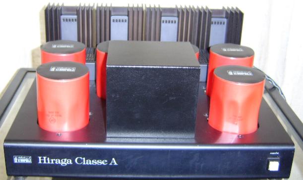

Vertical MOSFETs are used for a load of other stuff besides audio, operational lifetime cycle of these devices is pretty steep, think 50 years.
At less elevated die temperatures you'd be dead and burried before they (all) pop, 100C is acceptable if it's not the last DIY power amp you'll ever build.
A number of wellknown serial production amps were designed for really steep die and heatsink temperatures.
Best example is the 30 Watter Hiraga with BJT output devices, more than a few needed repair but a lot of them managed +20 years.
The 60W power devices of the Hiraga each ran at a 30W dissipation level, with small heatsinks good for 125C die temperature.
High die temperatures of BJT power devices usually destroy them because of the combination of reduced safe operating area and second breakdown effect.
BJT power amps such as the Hiraga and ExtremeA manage to survive due to the very moderate rail voltage levels.
Vertical MOSFETs do not suffer from second breakdown, just thermal runaway due to a positive tempco.
Do a search, some of the paesanos here have run vertical MOSFETs at very high die temperatures for long periods without any hassle.
(d., i'm a walking talking phone book)
Ask Papalala about bias level of V's and SQ.
