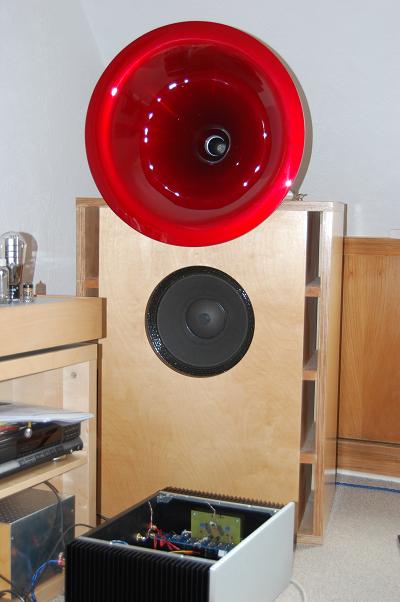

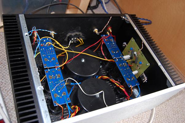

after one week of listening sessions, the overall sound impression is very nice. The F5 has no hum, no turn on thumb and is dead quite.
I think i like it even more than my tube amps. DC stays at around 5mv and is pretty stable. I can encourage everybody to build this great amp. Thanks to Nelson for bringing again a fantastic design to everybody. This amp will for sure stay a long time.
I have run with a tube pre, with the B1 and with an Aleph P as preamp. I'm a little bis dissapointed with the B1 / F5 combination.
gain is not issue, but the B1 sounds a little bit lean and the voices are not what i like. The Aleph P is clearly better in my setup with the F5 the overall sound is smooth as silk with a better tonal balance.
I still need to try the UGS F5 combination.
some picutures (The Alpeh P case still to build)
