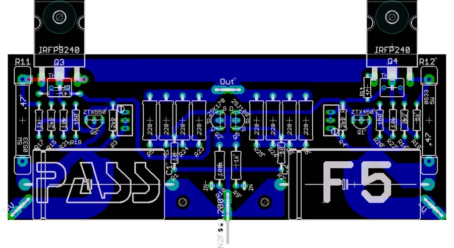

R14 on the IRFP924 has holes, but is not marked.
Nordic said:Attached is what I deem to be corrections regarding the fets that where pointed out. Maybe someone could just double check...
Joined 2002
I see R14 by the IRFP240, but I do not see R13 by the IRFP9240. Perhaps I have just missed it.
Jim
Jim
