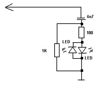

if not , try with led thingy for oscillations (attached)
you can increase gate resistors slightly (say 82R to 100R) and you can put caps across feedback resistors
I believe you'll find examples searching for F5 and oscillations ....... but from top of my head .....10n to 15n across R5 and R6

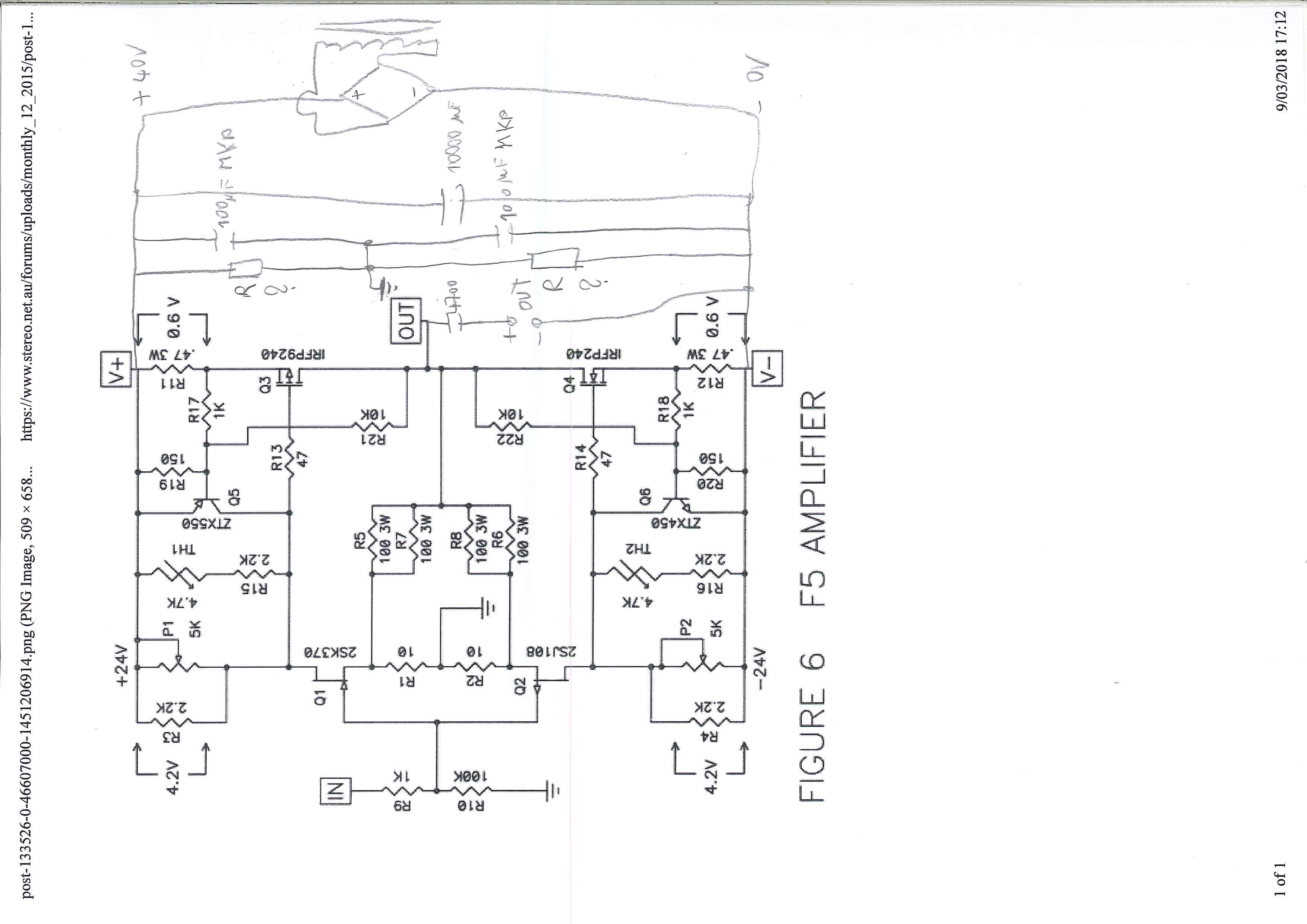

all that referencing schematic shown in Figure 6 , F5-om_sm-080527.pdf
all that , presuming that you didn't use some wimpy resistors in place of 0R47

I would like to use the artificial ground only to reference the input and feedback loop using 40uf caps and 220r resistors. The output referenced to - V using 4700uf coupling cap. Will this work?
The main psu cap will be single rail not split like quad 606
It might be better to use an active half-supply with decent current capability, I would look at 500mA as a bare minimum, 1A is better.
The F5 has an unusually large amount of current in the feedback loop and you want the lowest possible impedance you can get. I suspect 220 ohm resistors will drop too much voltage and limit your maximum voltage swing either side of the half-supply mark.
