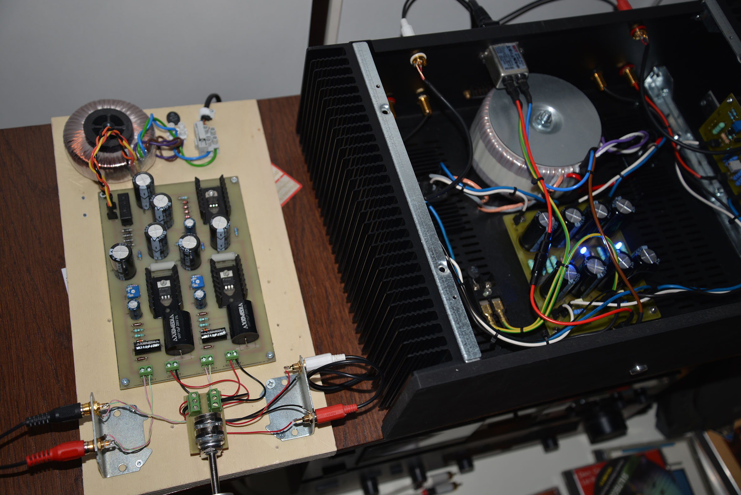

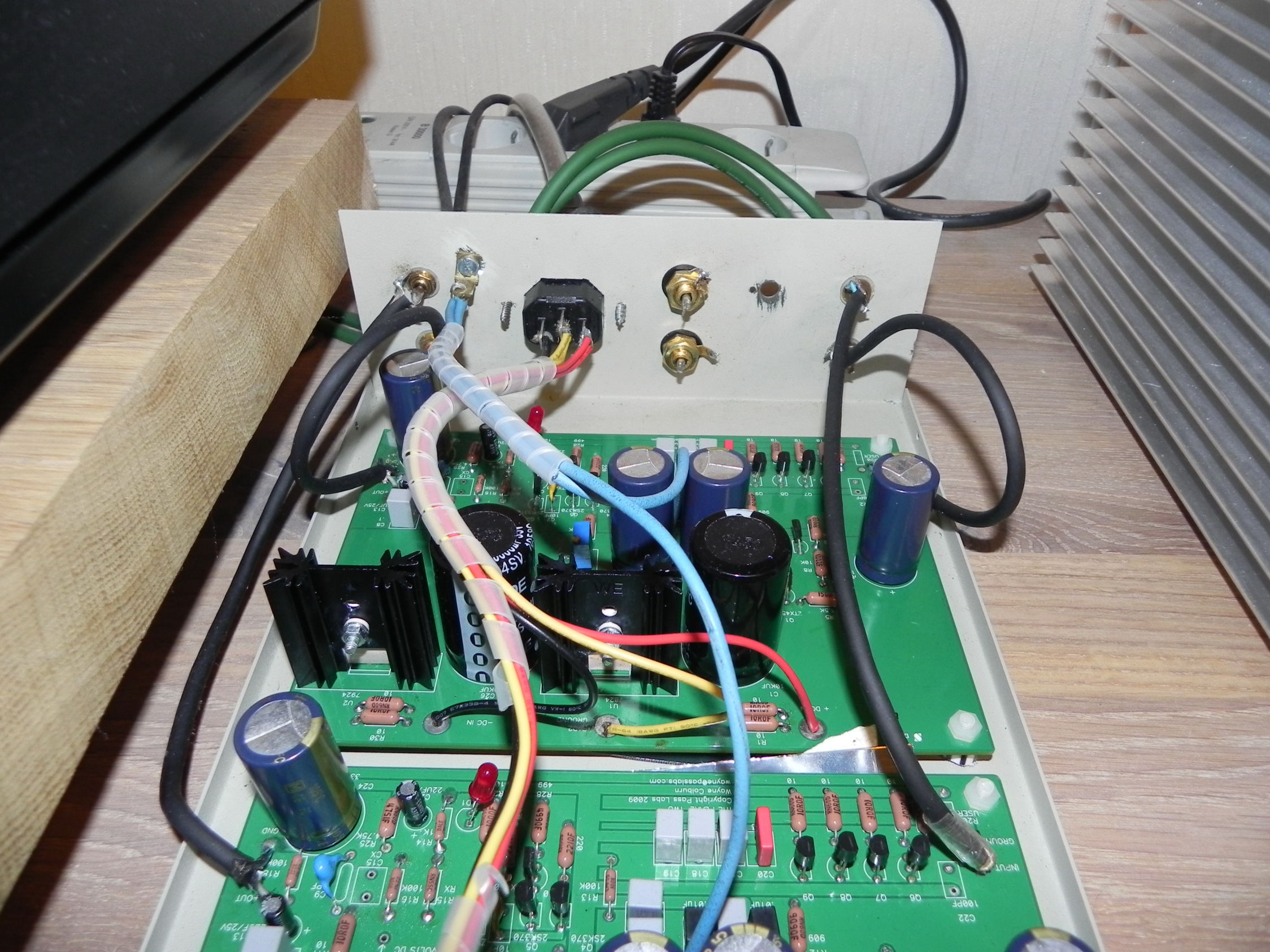

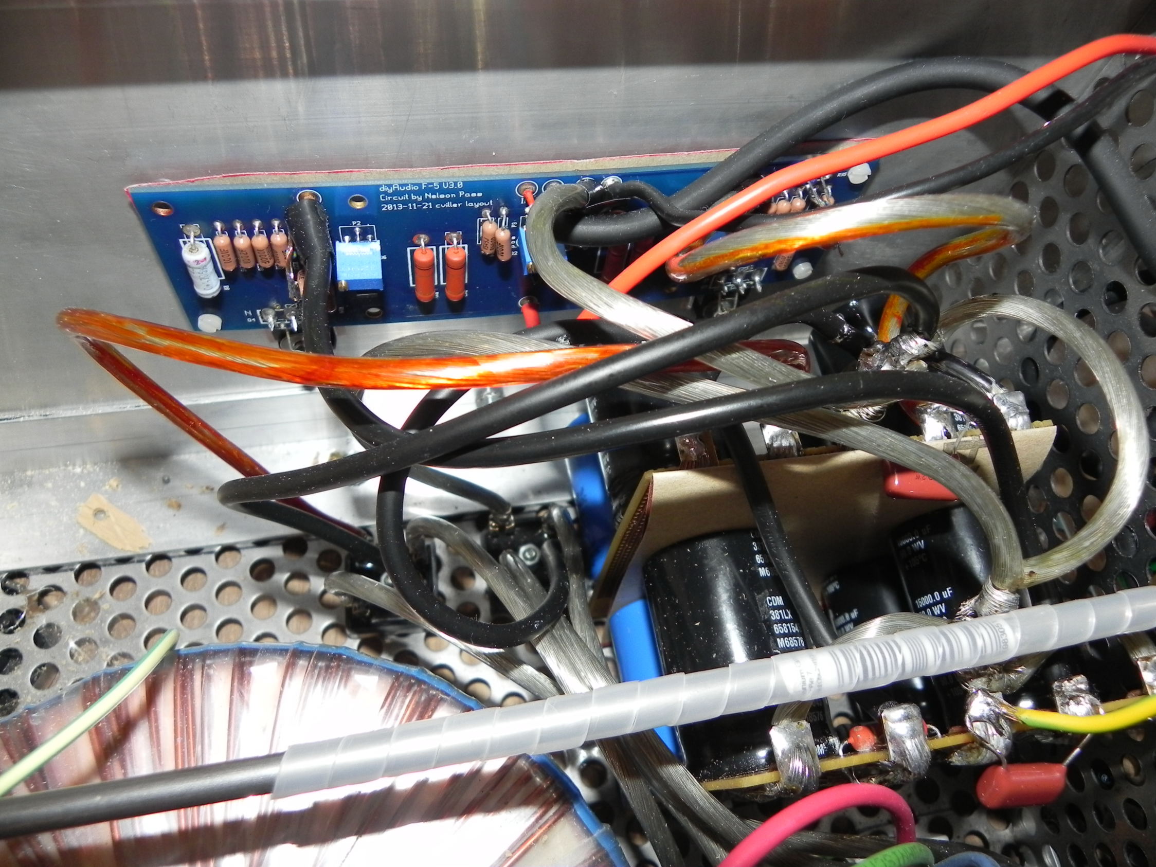

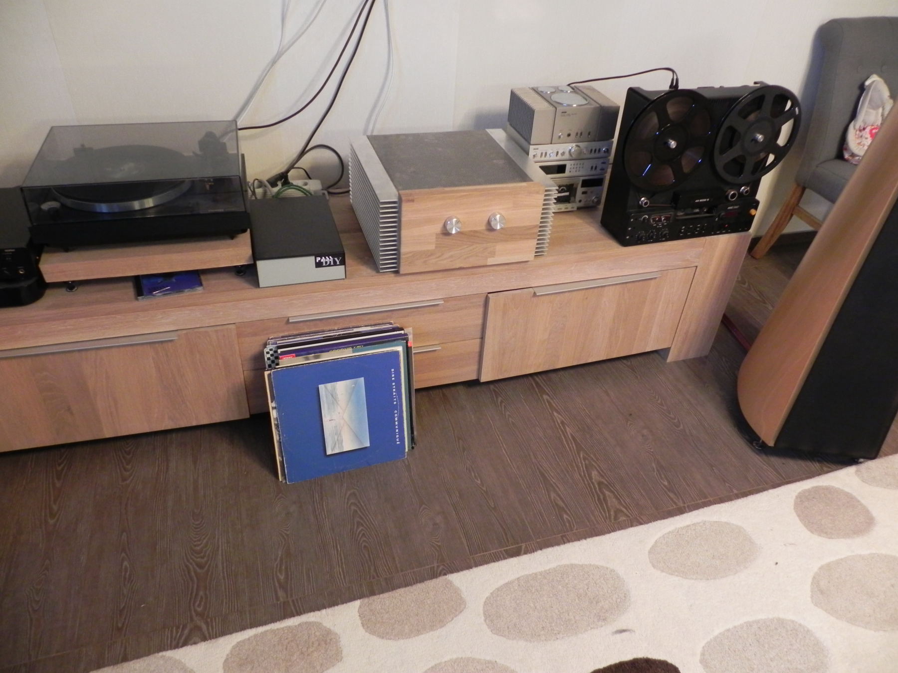

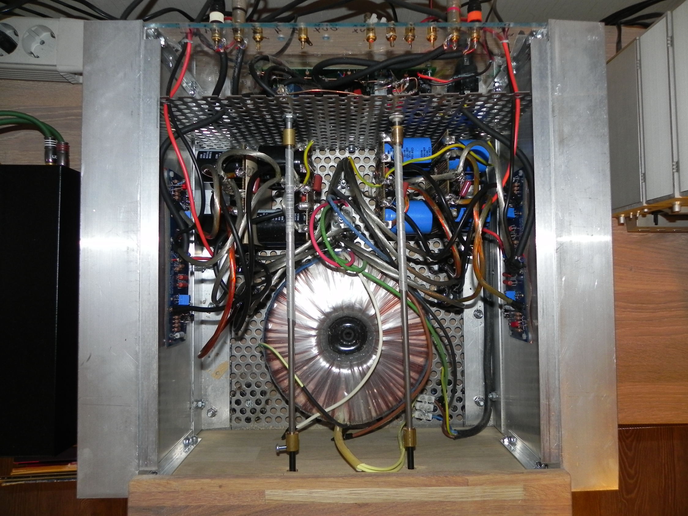

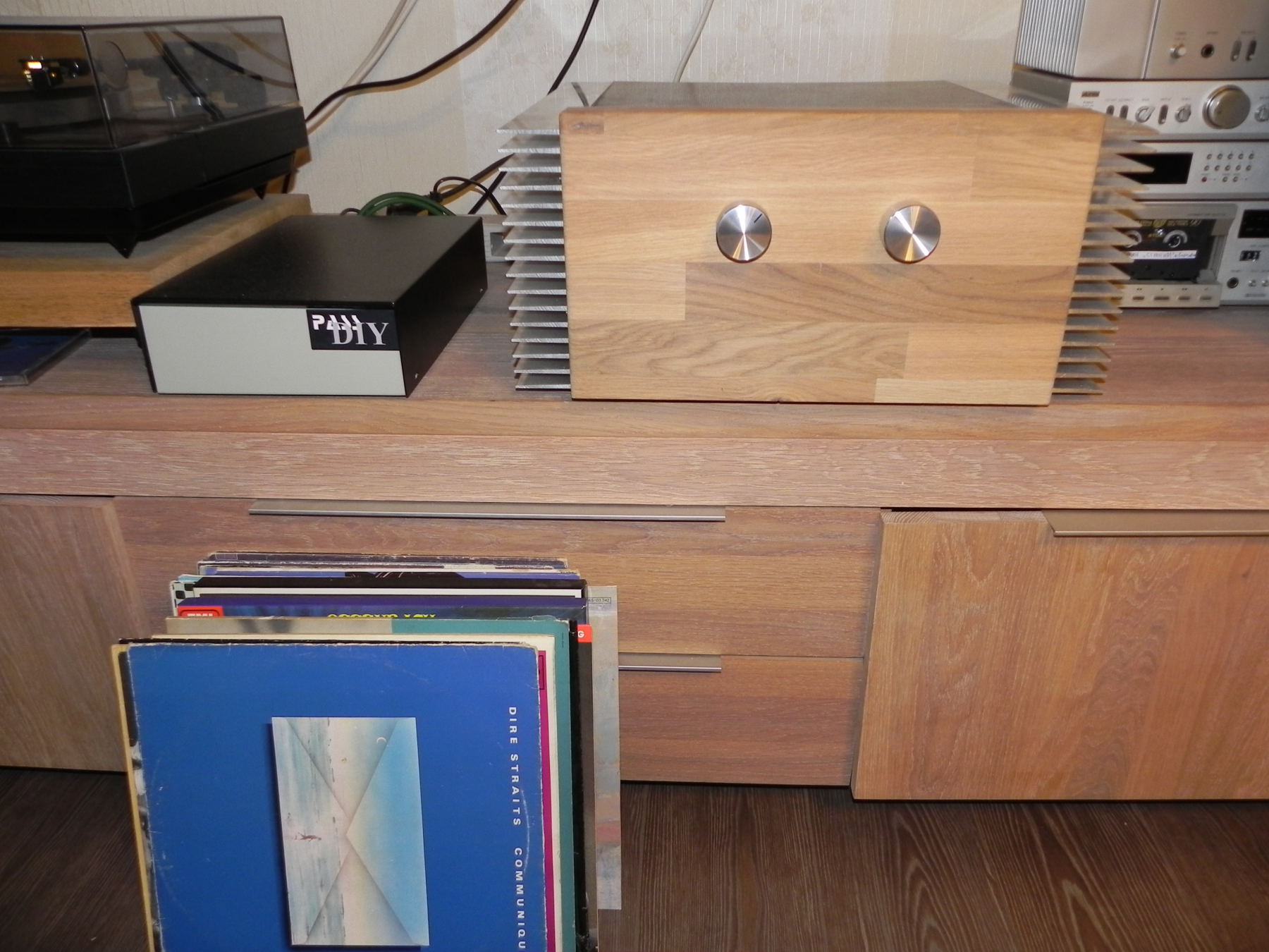

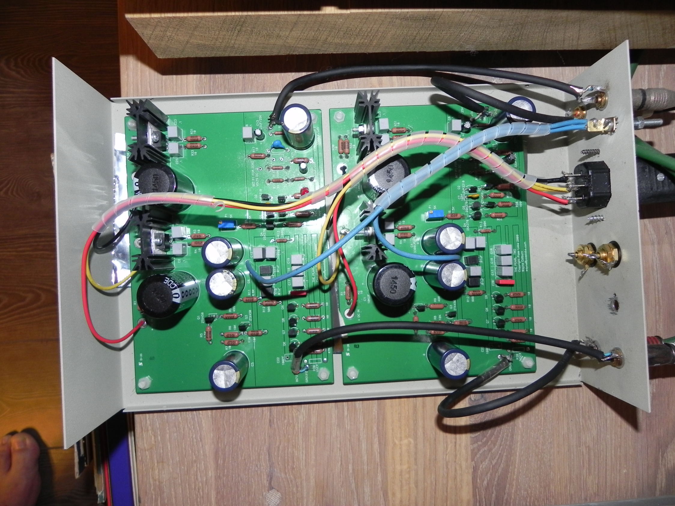

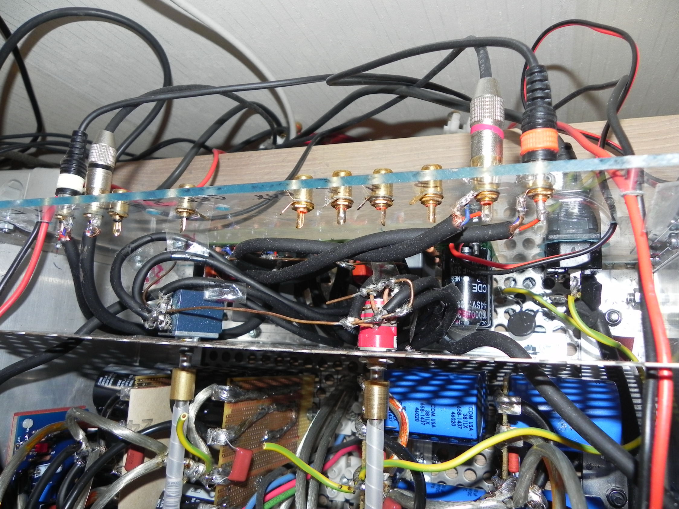

Hi everyone, I'm notifying community that my project is complete. So, Pearl Two, B1 and F5 are up and running. First of all I would like to thank my audiphile god for the possibility to build this schematic! This had taken me four years and brought a lot of experiences. On this audiophile Qualitätsneveu I would never have come if I would buy equal quality. Thanks alot! The rest of the chain are Ortofon MC 30 super II and JBL Ti6K.

Nice job!
If the power supply input of the PearlII is an IEC mains connector, I would recommend changing it to something less risky, like a Neutrik XLR or the like. In the best case it takes only one uninformed member of your surroundings to put 240VAC on your circuit boards.
Worst case is that you plug in a mains cable yourself.
My dad told me that when he was young he'd figure mains plugs were a good and solid connector for his DIY speakers, until my granddad saw a loose plug lying around and decided to put it where it belongs. Carnage guaranteed. 🙂
Hello, this is IEC-60320 C15/C15a and C16/C16a connection, which is theonly one in the household and therewith no one to mess with. It was chep, that's why. 🙂
Ah. All good then 😀
As long as no one can blow up your precious fruits of labour. 🙂
